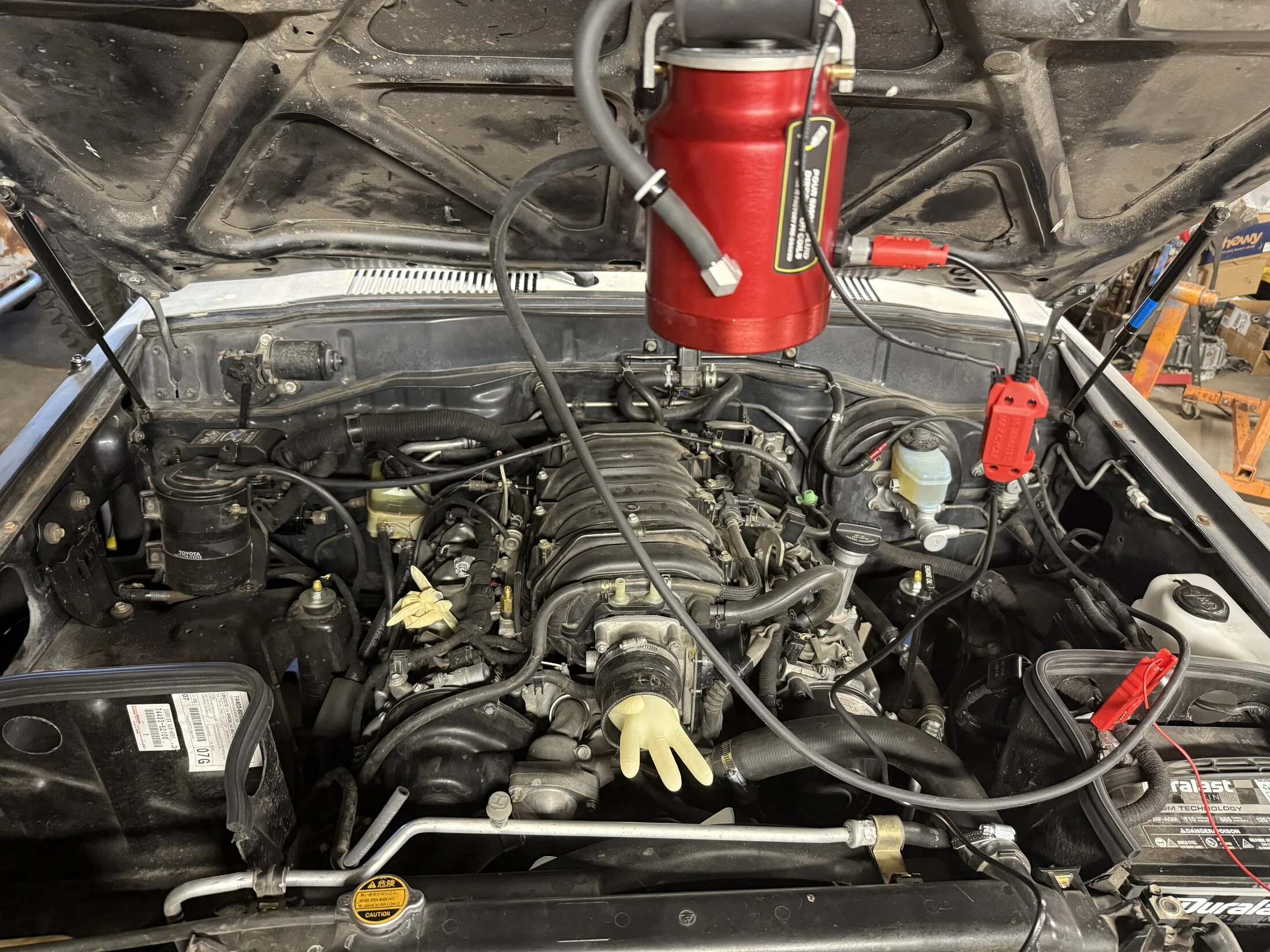

I ran another 15 minute smoke machine test. Not a hint of smoke leaked anywhere.
