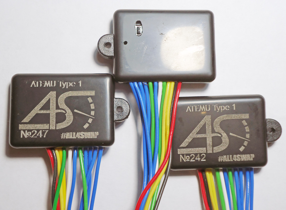

Ran across this over at XAT seems like it might be a possible solution to your issues (albeit fairly expensive one) when they get some in stock
