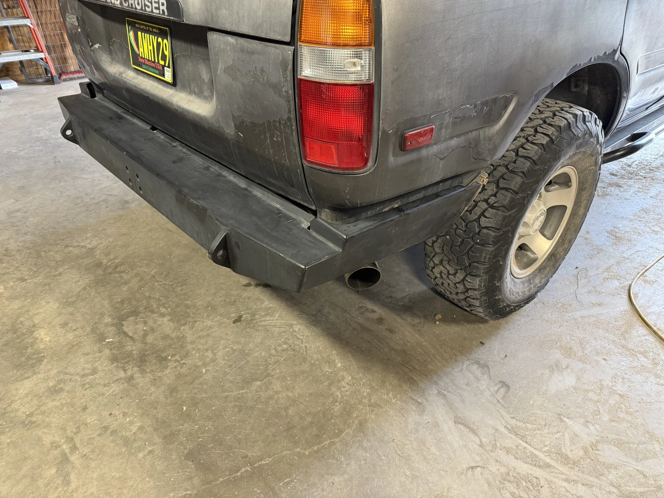

While I am waiting for tools to arrive to continue working through the performance issue, I installed a rear bumper. Sad it does not work with the flaps but like it otherwise.

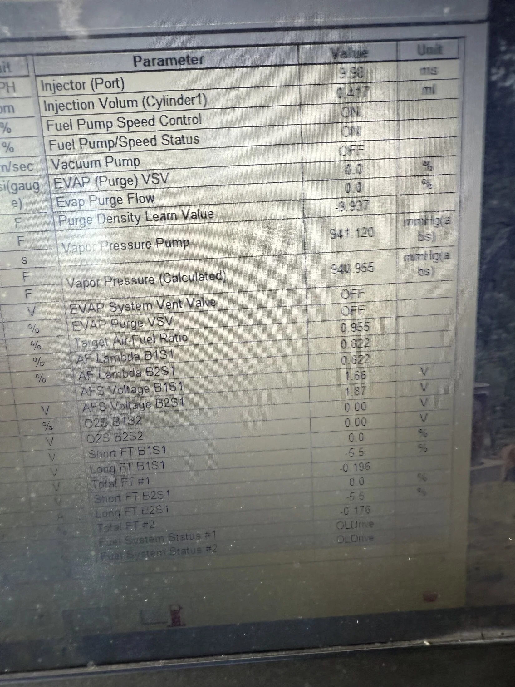

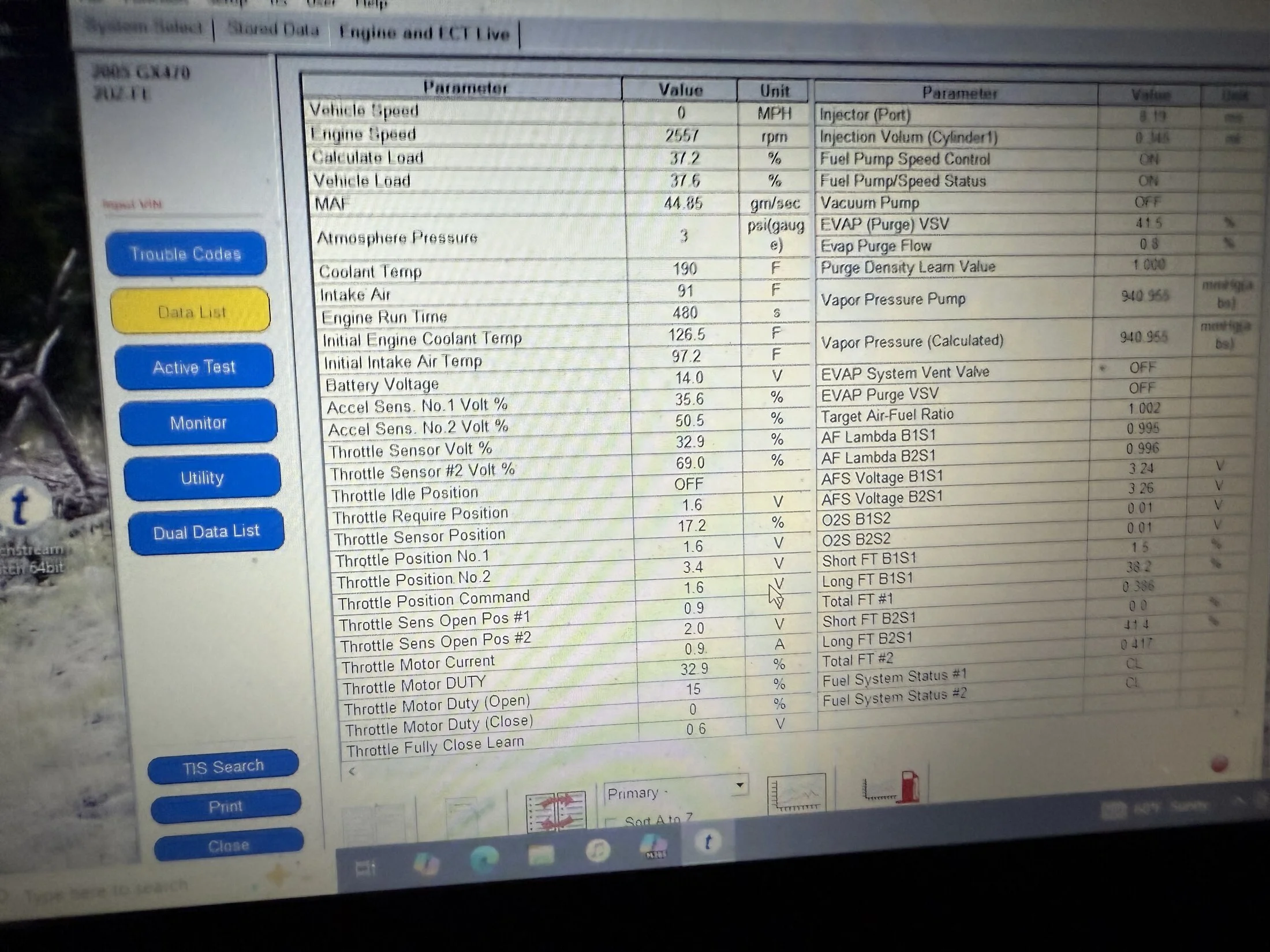

@RivMan you asked for a data log while under load. Best I could do was this shot from the live data while I was doing 60mph in 4th gear.

Your maf reading seems high for idle. I can check the info at work weds. What ecu is this running off of? Stock exhaust manifolds? You’re at 20% short term fuel trims. That’s why it keeps popping the code. Maf diameter must match what factory was for the stick ecu. But seems you’ve figured that out.

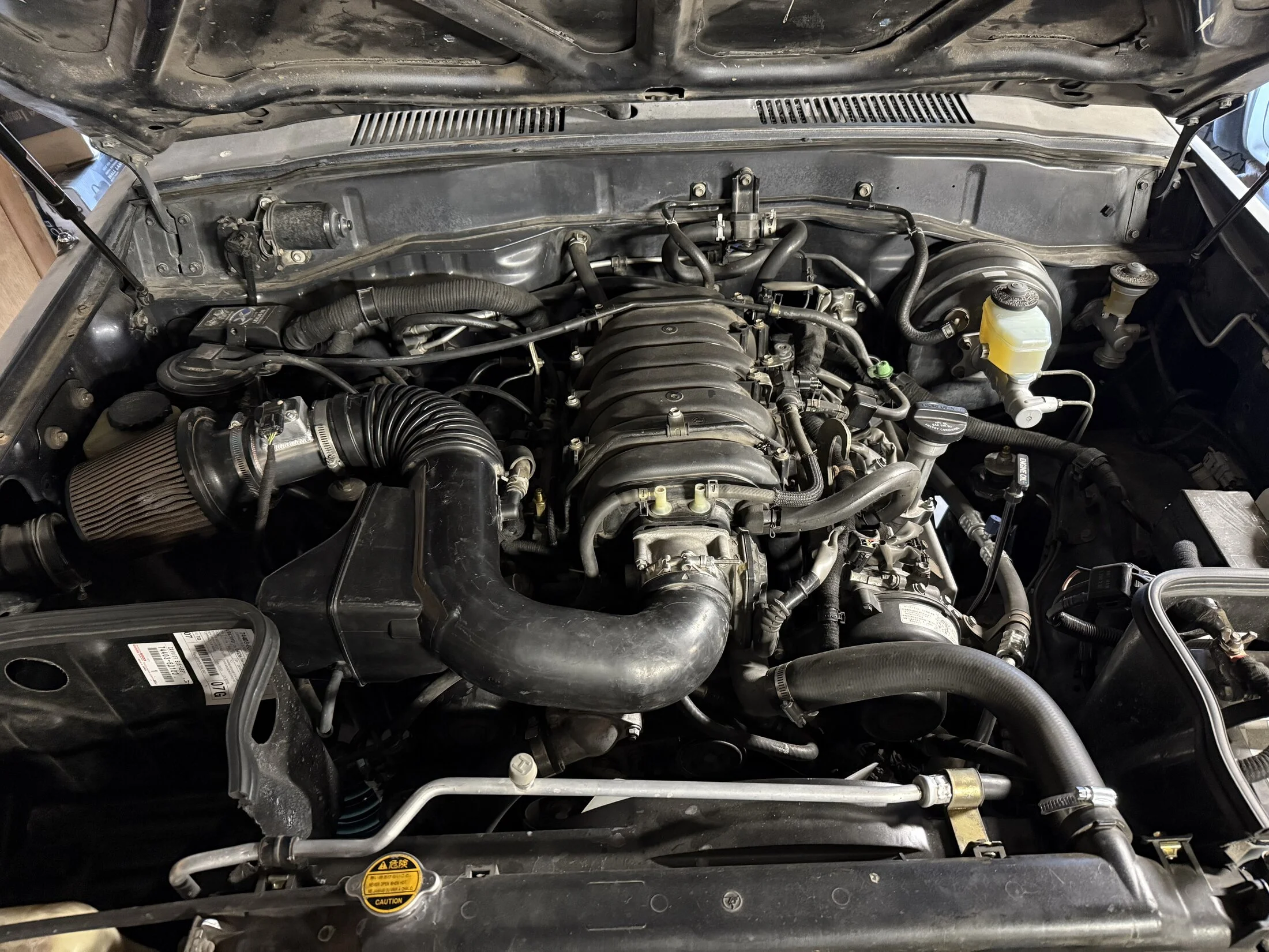

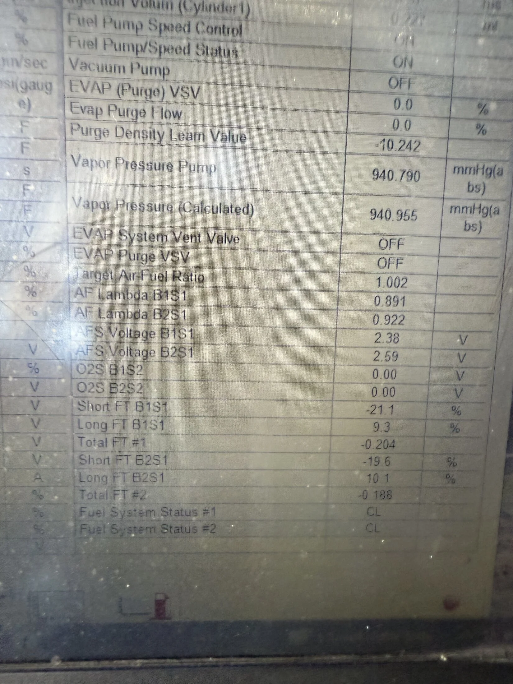

It seems like I may have made some progress. I cobbled this intake using an oem intake pipe with a MAF adapter as close to stock as I have. I used the used MAF that I had as a second n this set up. I will swap it with the new one to see if it presents any different.

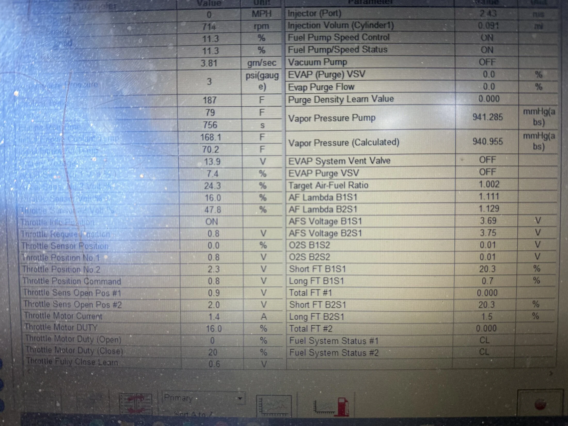

These are are fuel trims after it warmed up.

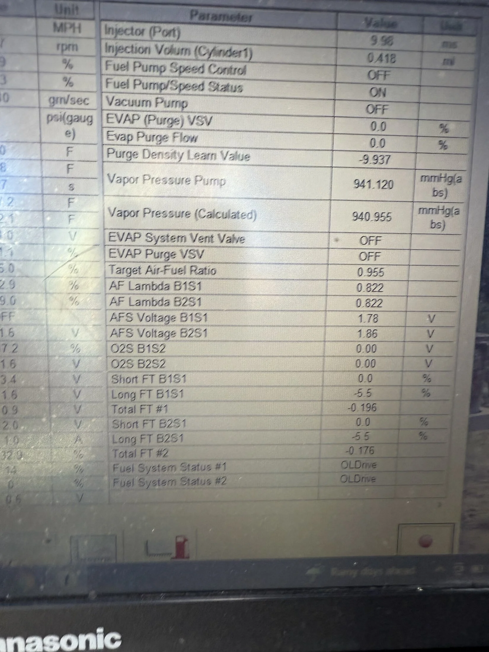

Here it is WOT in third gear going uphill.
Here at 60mph WOT in 4th gear
Off throttle costing in 5th gear

Your ECU is still relearning it's fuel trims, but those screenshots look a lot better.
I'm not sure how volatile the memory is on these ECU's. I know I can manually reset trims with my tuner. You may want to see if disconnecting the battery for a while resets the Long Term Fuel Trims back to default, then see where it ends up.

What I find interesting is that the intake pipe I have is made from an aftermarket K&N cold air intake kit. All I did was shorten the pipe with all the hose mounts and MAF mount, then welded it to an allow that gave me the right angle to connect it to the 80 filter box originally. The K&N kit is made for a 2006 Tundra with the same 2uz VVTI engine. You would think of the intake pipe was too far off from spec. There kit wouldn’t work for any truck it would as on.
It does seem the intake pipe is causing my lean codes although I only drove it about 15 miles, so we will see after I get some more miles on it.

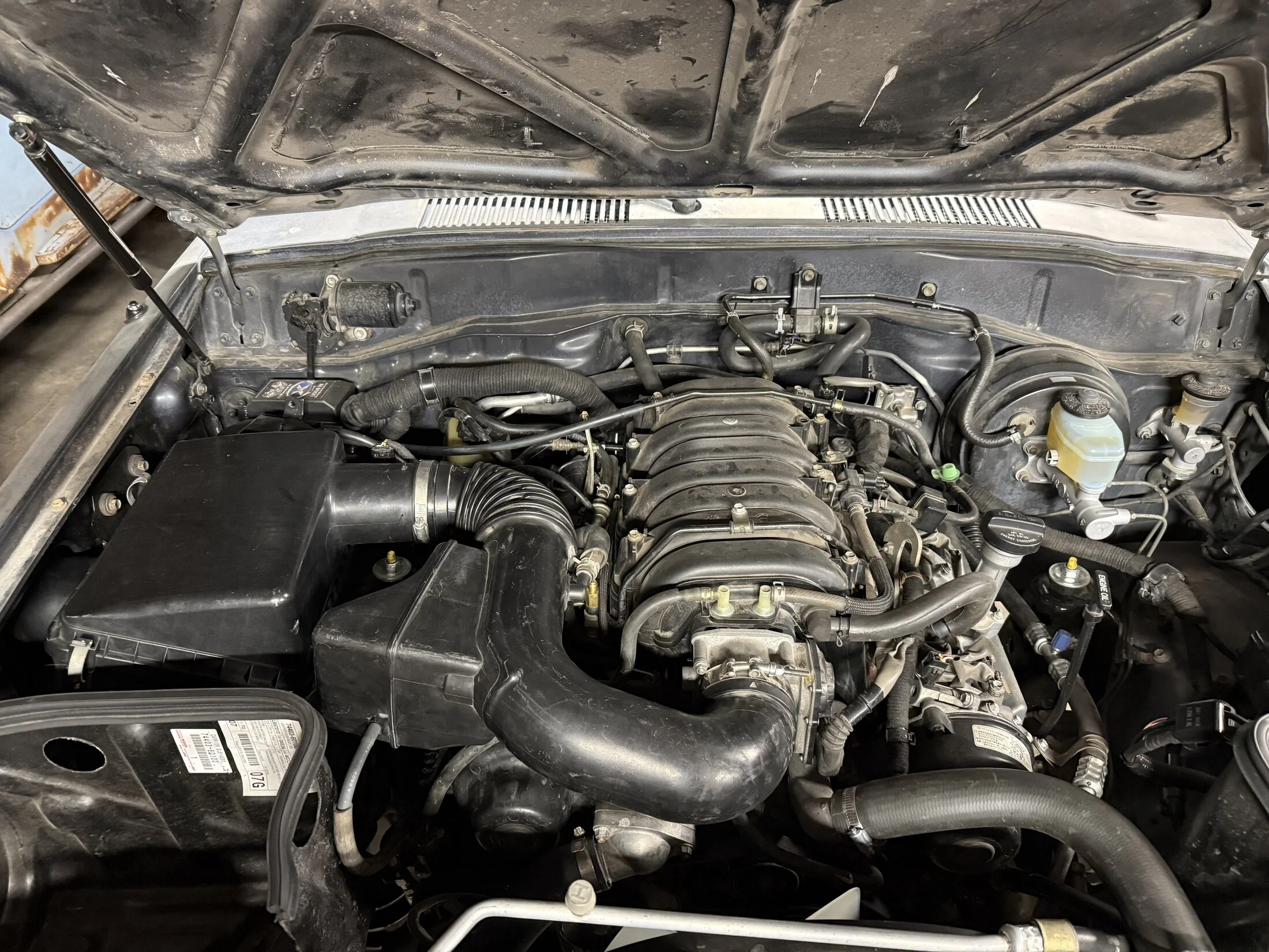

The oem air box arrived today. I was anxious to get it installed with a new filter. The airbox and intake in place.
I went through the whole relearn process just to be sure. Took it for a drive and it is no better. Within 5 miles the P0171 and P0174 codes came back.

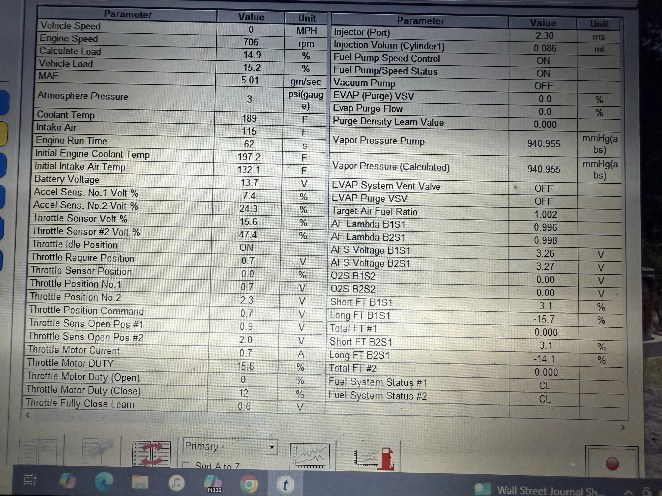

I checked the fuel trims at idle and they showed similar to before.
It would seem something is telling the ecu it has too much air. I have duplicated the air intake, replaced the MAF and A/F sensors. To the best of my ability the TPS and throttle body are working and there are no codes for them.
I’m running out of ideas.
