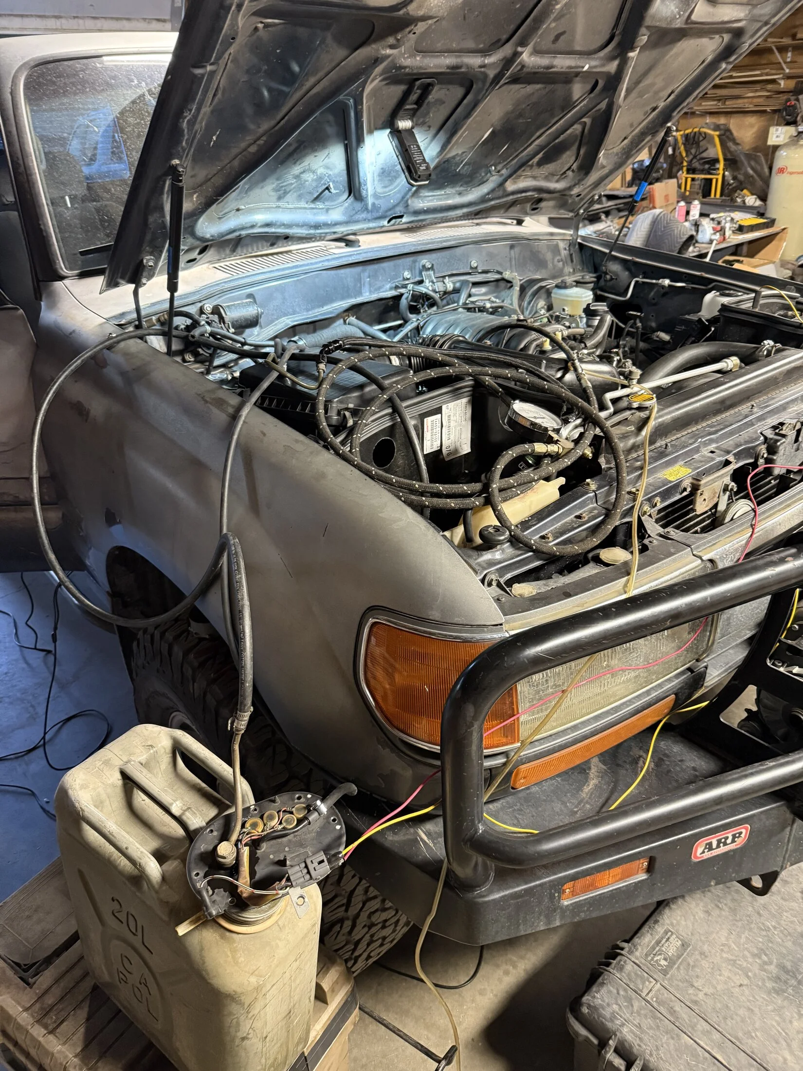

It was suggested my lean issue might be a volume issue, meaning I might have an obstruction or bad pump. In order to test this I took a second working pump for a 2uz that I had, attached to a spare sending unit and dropped it in a gas can. I then bypass all the fuel lines and ran the sending unit directly to the fuel rail with a new filter inline before the rail. I hooked the fuel line up using a canabalized banjo fitting from my other parts engine. So it was delivering fuel at the rail like the oem set up.

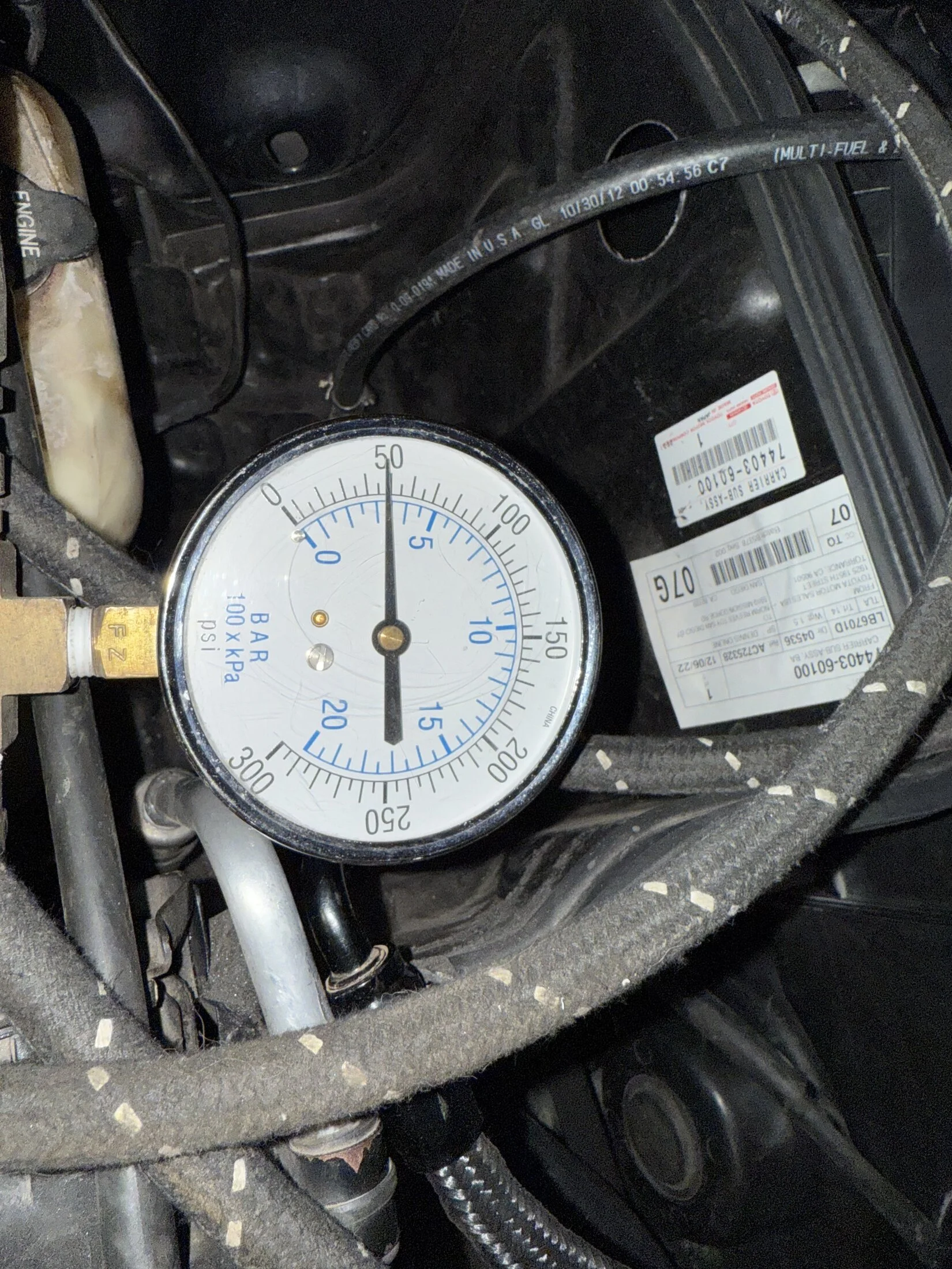

I hooked up a fuel pressure gauge to track that. Fuel pressure stayed strong and consistent. It was reading a little higher this time 49-50 opposed to 45-46.

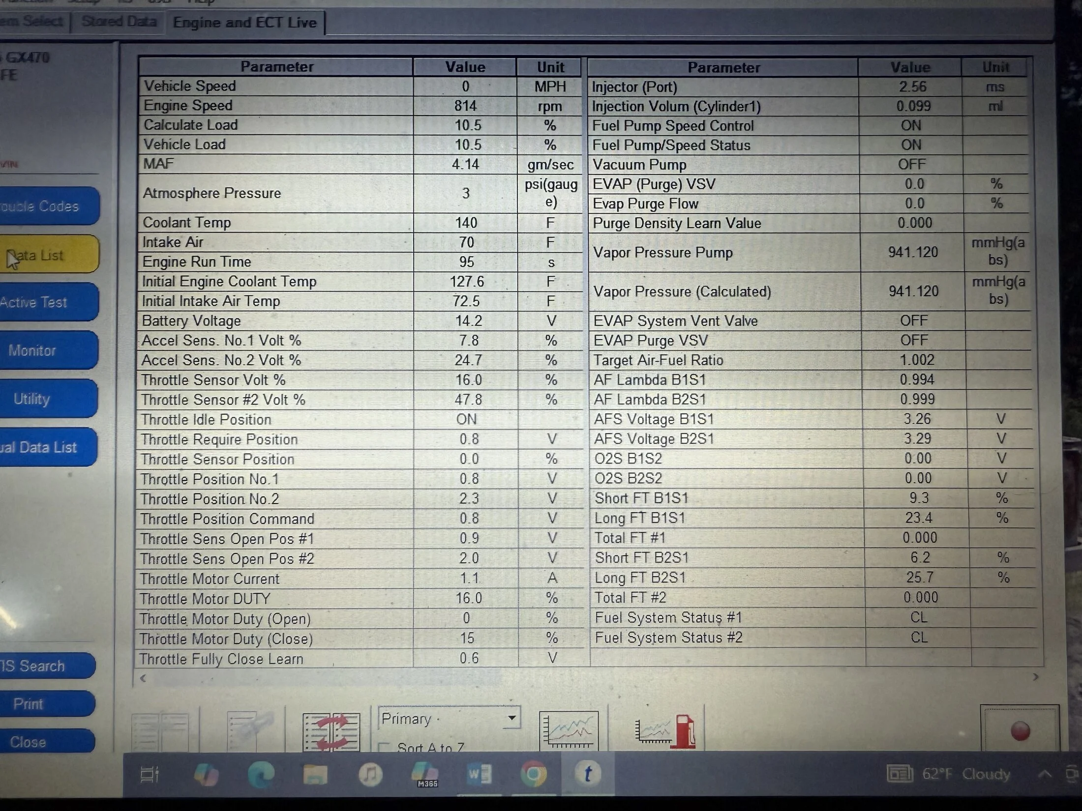

I ran it at idle and there was no improvement in the fuel trims compared to pretest data.
Live Data at idle.
Live Data holding 3100+ rpms for more than 10 seconds to see if the FTs improved, suggesting a vacuum leak. They did not.
I am using the right pumps for the engine. Both pumps perform equally, so I think the pump is working as it should. Having eliminated the entire fuel line to the rail, I don’t believe there is an obstruction.

While watch the tech stream I can view the A/F sensor reading and force them in to a lean reading by continuously pump the brakes. Then as soon as I stop the A/F sensors return to their original reading. This I can see the A/F sensors working in real time to confirm they are functioning properly. I have accepted this test as confirmation the A/F circuit and sensors are working correctly.

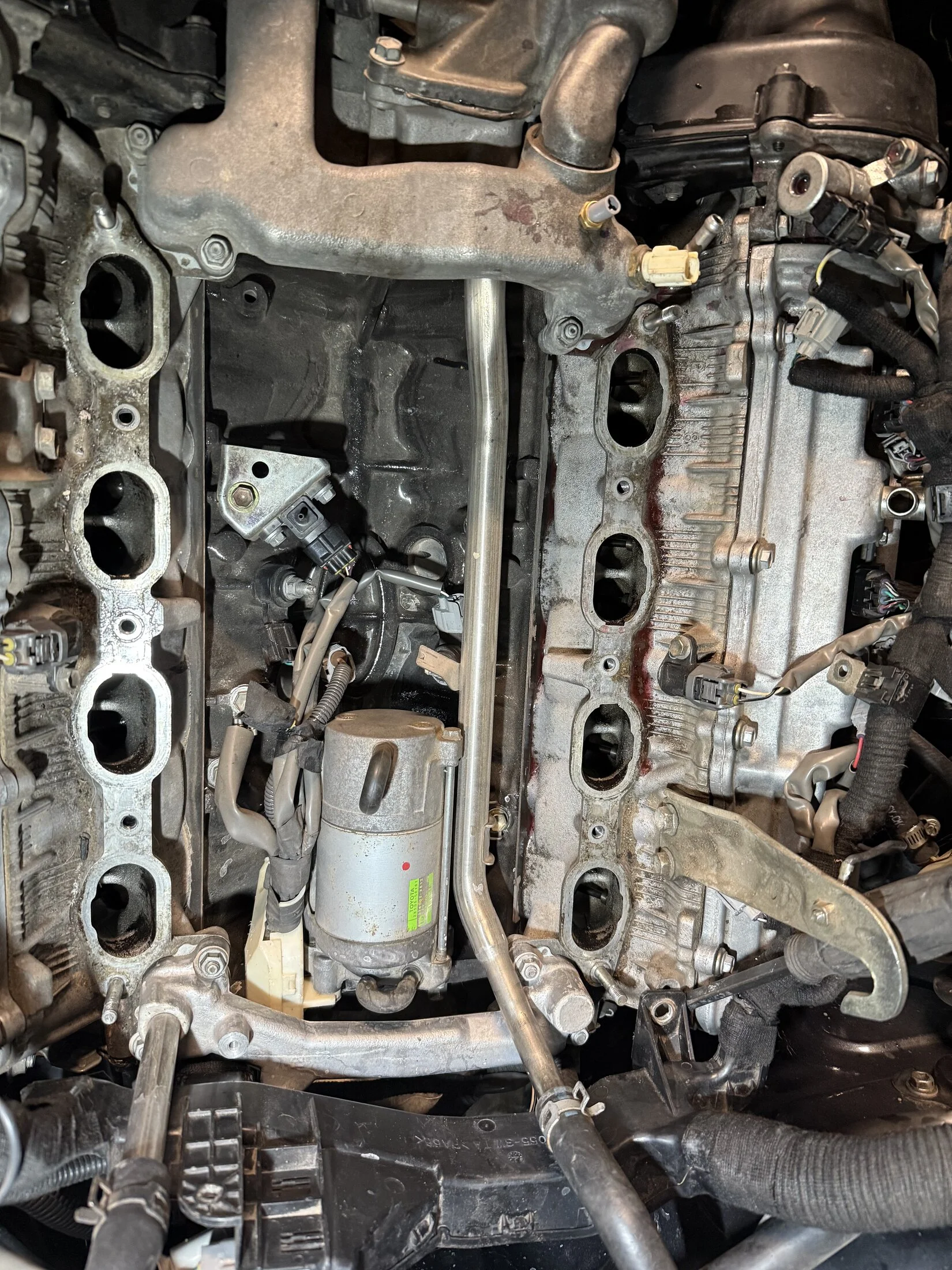

Thanks to @thabruiser who noticed that my atmospheric pressure seemed off and after he talked me through what that meant I had much better understanding of how it should probably read. This conversation sent me researching and I figured out that my MAP sensor is not hooked up to the planum as it should or so I think.
Originally I installed a SAI deleted kit which allowed me to remove all of the SAI parts but the map sensor, I didn’t know at the time that is was the map sensor and figured it was a part of the SAI system that had to stay to make the delete kit work. So I left it in place. Later I learned the the ecu programmer could delete the kit all together, so I did that and removed the delete kit but left the sensor in place because I didn’t want to pull the intake off.
The MAP sensor has been sitting like that taking its reading from the atmosphere and not hooked up to the planum. My research showed that a bad or failing map sensor can produce a number of symptoms like what I am experiencing.
Looking at the diagram that little vacuum hose nipple was plugged into the SAI pump, I am going to hook it up to the bottom of the planum and see what happens.
Will this solve the issue, don’t know and I am not getting my hopes but it appears not to be setup like it should be, sooo…

I was able to hook the sensor that is in place under the planum to the planum but it did not change the engine response, FTs or the atmospheric reading. It is possible the sensor is damaged, so I am waiting on a new oem replacement to arrive and a filter to protect the sensor. When the new parts arrive I will get them installed and know for sure whether it changes anything.
