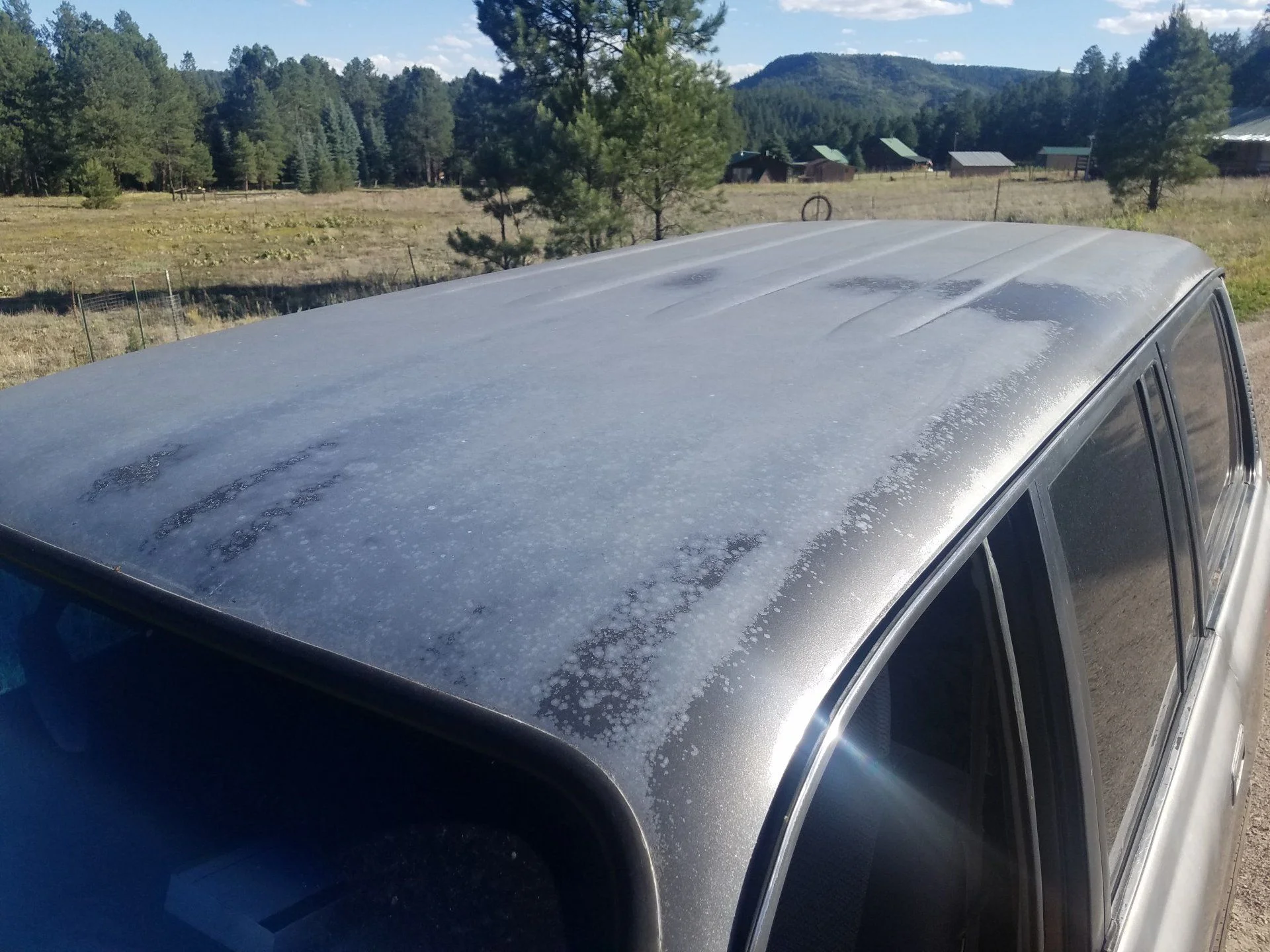

No sunroof
No roofrack
No sliding rear windows
No running boards
No fender flares
No 2nd or 3rd row seats
Cloth interior and manual seats
It needs some love and I am fan of this odd duck all except the 3fe, so I plan to tinker on it to make it a little nicer while I use it as a dog hauler and DD when needed.

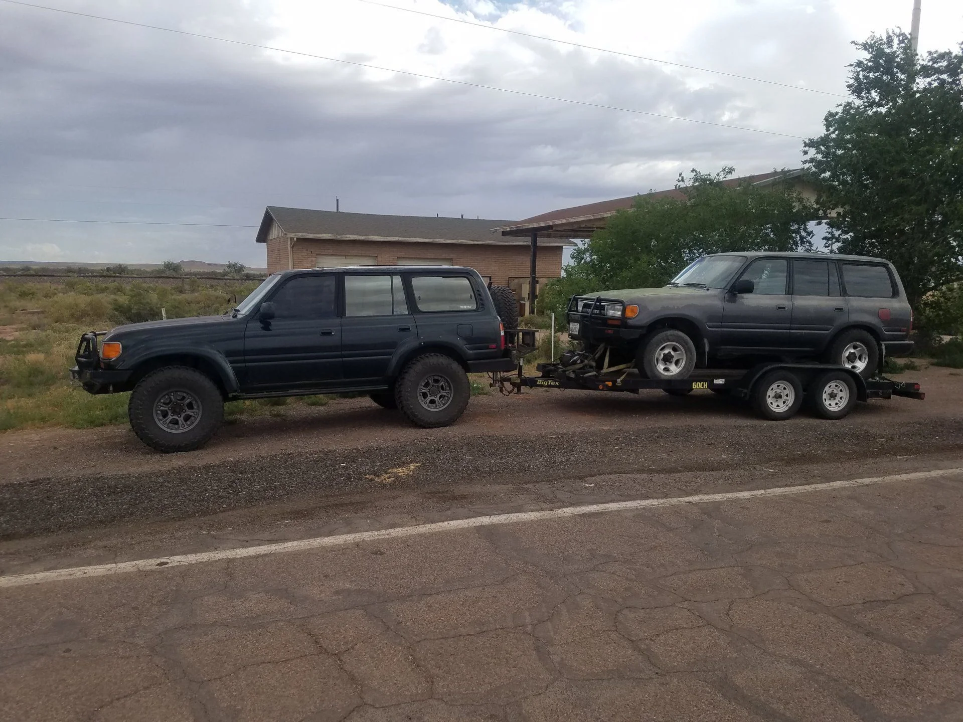

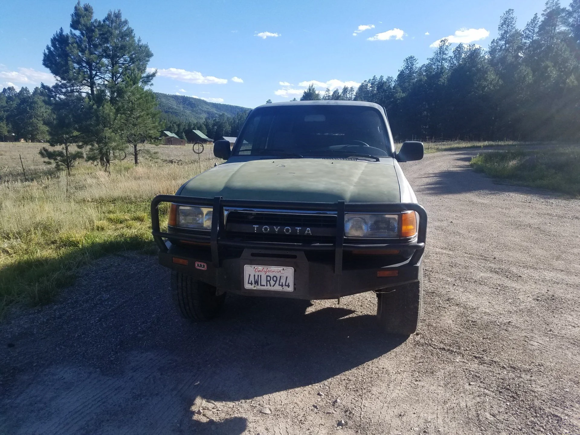

Here it is on the way home and in the driveway.

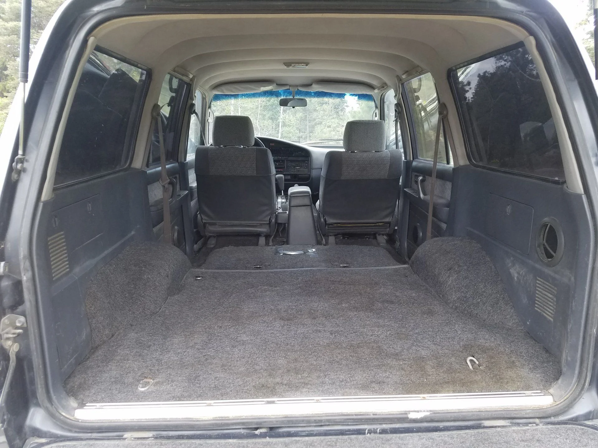

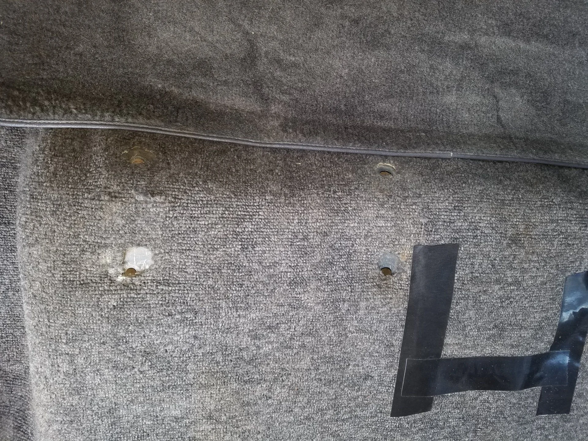

Have any interior pics of the second row seat delete??
I will have to take some. A PO had installed a set of second row seats in it that were removed before I got it. I was told it has holes where the mount bolts should go but they are not threaded, so you have to place nuts and washers to install them.

I actually looked at where the seats would mount today. I found the 6 of the 8 mounting point do have capture nuts for seats two of the eight do not, so I don't know if it would or wouldn't have had seats originally.

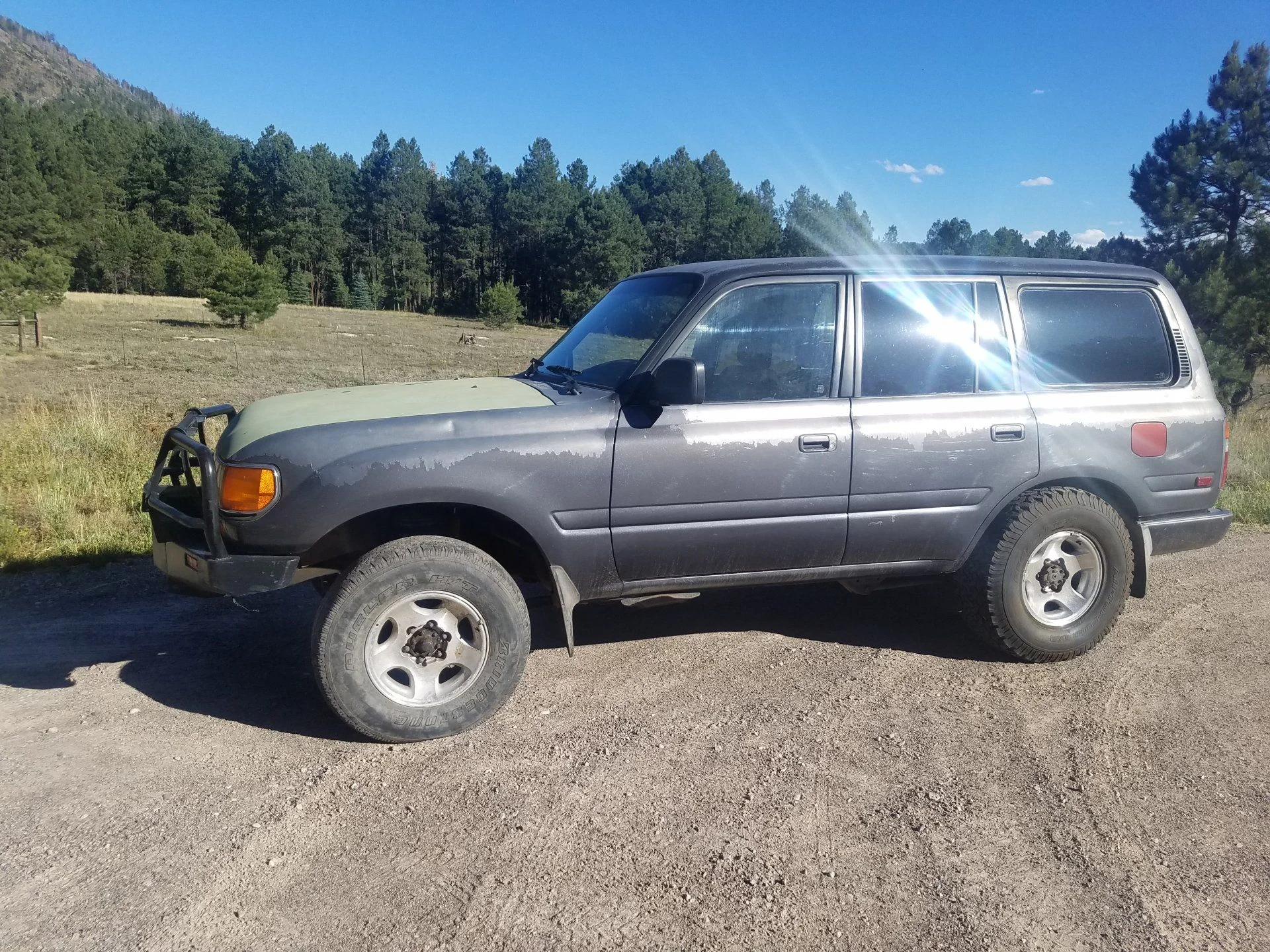

I finished installing the front locked axle and buttoning up all the loose ends and checking torque on everything that was manipulated during the F/R axle swap.
It ended up with Dobinson 2" front springs and new OME 861 rear springs, with a set of used OME sport shocks I had on hand. The new rims are a set 80 40th Anniversary rims with 285 BFGs. I like the stance.
I also added a factory center diff lock button. I still have to get the axle elockers wired but for now I am happy it is drivable.
It didn't come with a front swaybar, so I will drive withoit it until I can get one.

yeah. Looks like the seats were simply removed. Holes in the carpet and screw points for the second row. Still a unique rig.

I agree, I am not convinced it didn't come with second row seats. I do believe it didn't come with third row seats though. There are no wholes in the carpet or brackeys for the seats to mount too.
