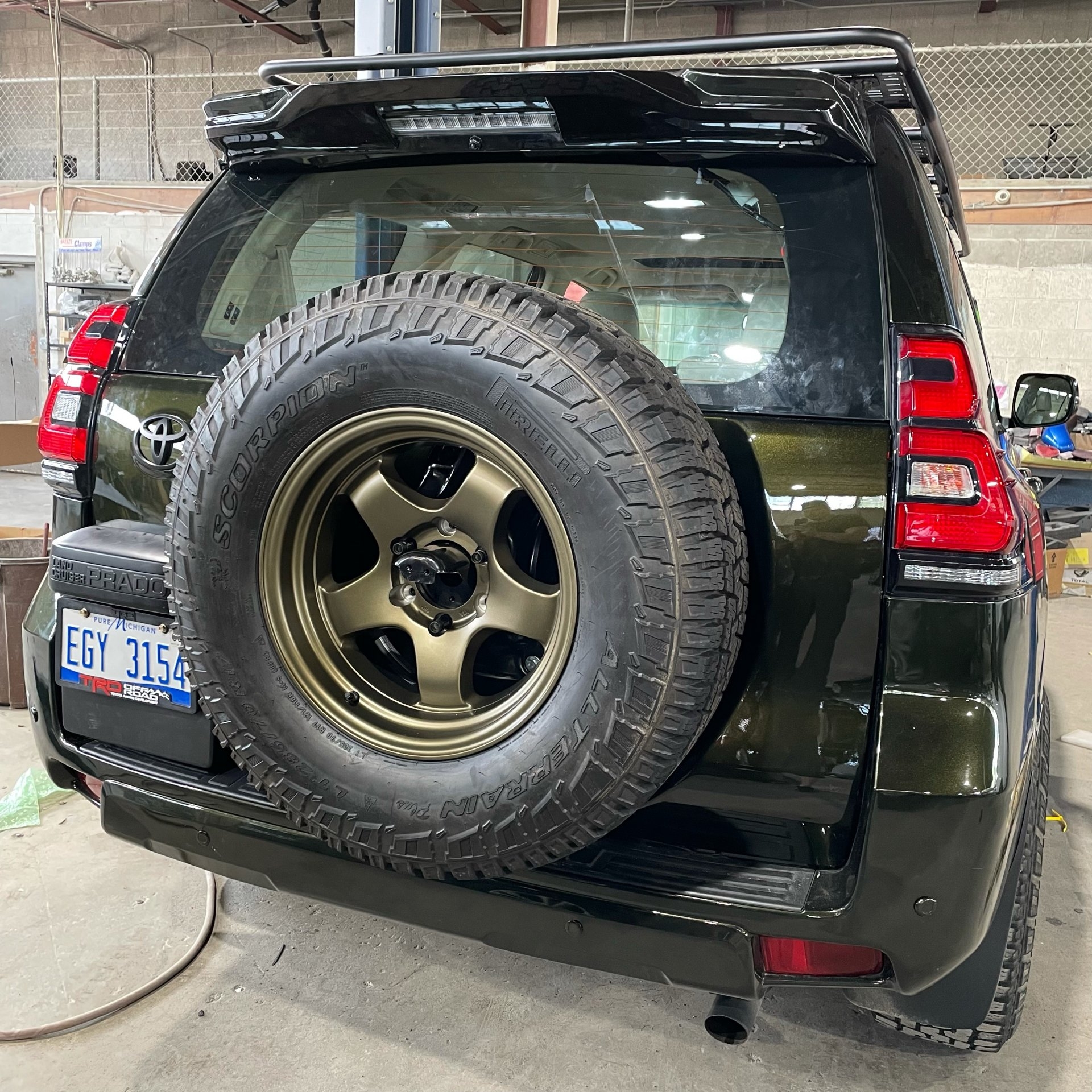

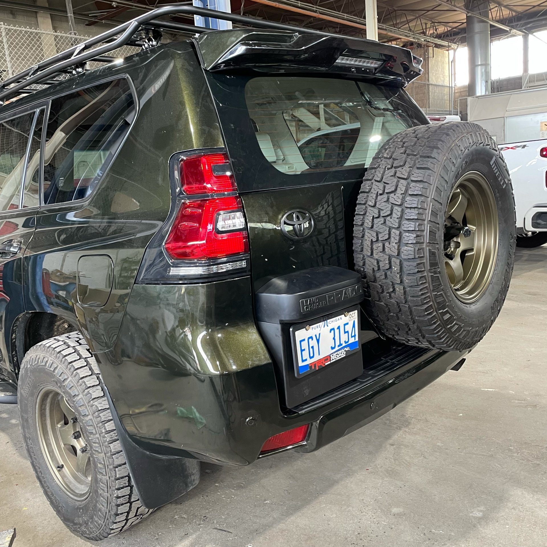

Awesome!! Can I see what the door looks like without the wheel? I’m curious to see how it’s mounted. How strong do you think it is?
Best I can do.
This door uses the same hinges as our OEM door - same shock as well. I didn't snap any pics, but if you look at your door - it's IDENTICAL. 🙃
It seems strong. Doesn't struggle, holds itself open. Seems good. 🤷‍♂️
The Aussies have been running these rear doors with 33s and even 35s for years. I trust it!
