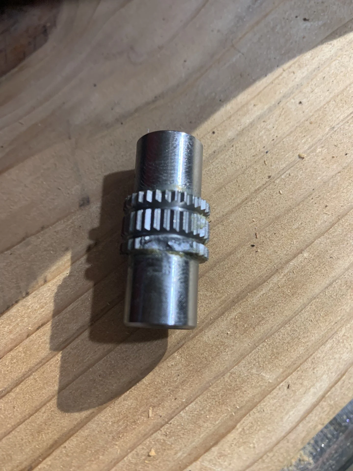

Agreed. When the seat gear in my passenger seat failed I replaced it with the Gamiviti gear and it fixed it. It "may" be nice to have a metal gear tho, I'm curious what, if anything would be to the next part to go with a metal gear installed.And why not?!?

Me and a friend are both about to do Gamiviti plastic as mine arrived yesterday. But we're both waiting to see if the metal gears works or cause problems. I see both sides of the point. I lean towards staying with OEM materials/plastic. That's just me. And I thought about seat swap but want to keep my two tone 40th Anniv leather.

A customer of mine came by yesterday. He had a friend in Georgia install a metal seat gear. The seat malfunctioned because the rails were not aligned. The metal gear shredded and took a chunk out of the steel piece that is supposed to hold the plastic gear. Got it all fixed up.
Note to self, Toyota used plastic gears for a reason.

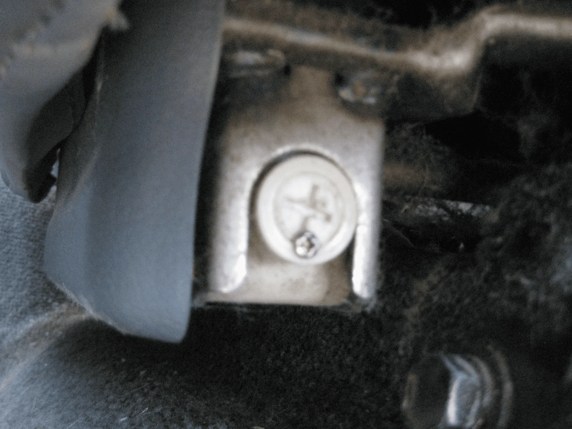

Rifleman, did you just drill a small hole right through the center of the plastic cap and put a metal screw in there? Mine works fine. The cap falls out is all. I thought about using super glue or a screw as you did. If you have a pic, it would be great Thanks!Why reinvent the wheel, those plastic gear failures are due to the plastic centering cap coming lose, and falling off the steel drive shaft. Once that cap falls off the end of that shaft, the shaft has no support.
That will allow the shaft to move off center when the seat is being moved by the motor. Thereby allowing a misalignment between the gears causing the plastic one to strip.
So if you insure that that plastic cap on the end of the steel drive shaft is securely held in place, the chance of the plastic gear failing is GREATLY reduced.
In my case i removed my seat, and pinned my cap in place with a small screw. That mod was done over two years ago, cap hasen't come out, and i haven't had a single problem with my seat gear.
Perfect! Thank you so much!!!A photo is worth a 1000 words, i drilled the hole in the drivers side cap at the interface of where the cap threads into the outer gear housing. One important thing you need to remember, you need to use a screw that's meant to self tap into plastic. Regular screws that are meant for use in wood, or metal, will not hold very well.
