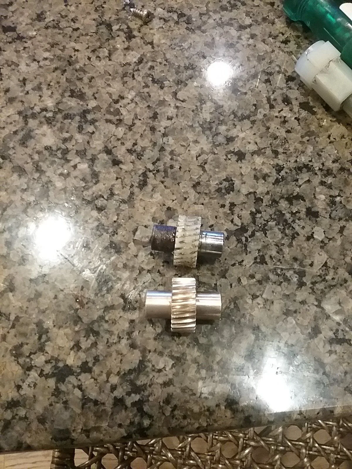

Update on the gears. Received them few days back, tried installing this morning. The quality looks great, they fit in the housing nice also. The inner diameter is too small to fit over the drive shaft though. They would have to be hammered on and likely never come off. Emailed and requested a refund. Too bad, looked like a good alternative. Hope this helps.
Interesting. I can tell you that the OEM and replacement gears are also VERY tight. They need to be pressed onto the shaft. Did you do any measuring to try and determine just how undersized they actually were?
No, the factory gears slid right over with zero resistance. I took the second gear which was not installed yet and tried to fit in on, it got started but would require hammering down. Just seemed extra tight.
I suppose i could hammer it down with the housing cover pre installed.
No reason to force it on. If it slid on i would have given it a go. Too big of a risk breaking the housing pressing it on the shaft. Hopefully a refund coming.

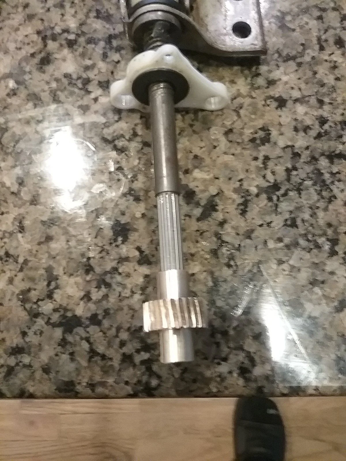

As far as it'll go with forcing.View attachment 1856673
Seeing as that "Made In China" gear wouldn't even slide onto the splines of the drive shaft. That would worry me that the dimensions on their seat gear that's supposed to run against the Toyota seat gear may be way off too.
Correct. The gears did fit on the spline after being hammered down using a 15mm deep socket, i took it back off though. Just took more force than i felt comfortable with. In order to get the assembly back together correctly you would need to install the gear assembly cover on first, drive the gear on to the spline, then reassemble. Without a doubt I'm sure this would break the cover.
