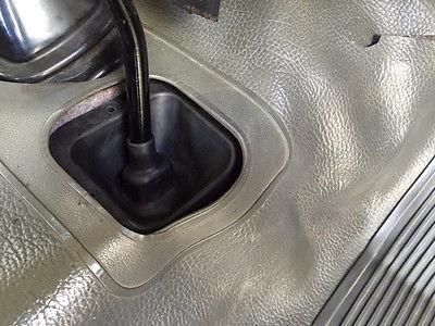

@Racer65 or anyone else with the inner shift boot. Could someone give me an idea as to how far below the plane of the transmission tunnel this boot sits? I'd like to run the boot to further seal up my interior, but my transfer case shift has a dog-leg in it to accomodate my V8 conversion. I'm not sure if this boot would seat, or if the dog-leg would conflict.
Which inner boot are you talking about? Do not believe the three speed had one. Four speed used one. Early to 9/82 and the 9
10/82+. The 81/82 60 series used a flat rubber piece. 83-4/85 not sure what it had. Then 4/85+ used a different inner boot. Being this is the 40/55 section your talking four speed with the pre 10/82 being most common?
