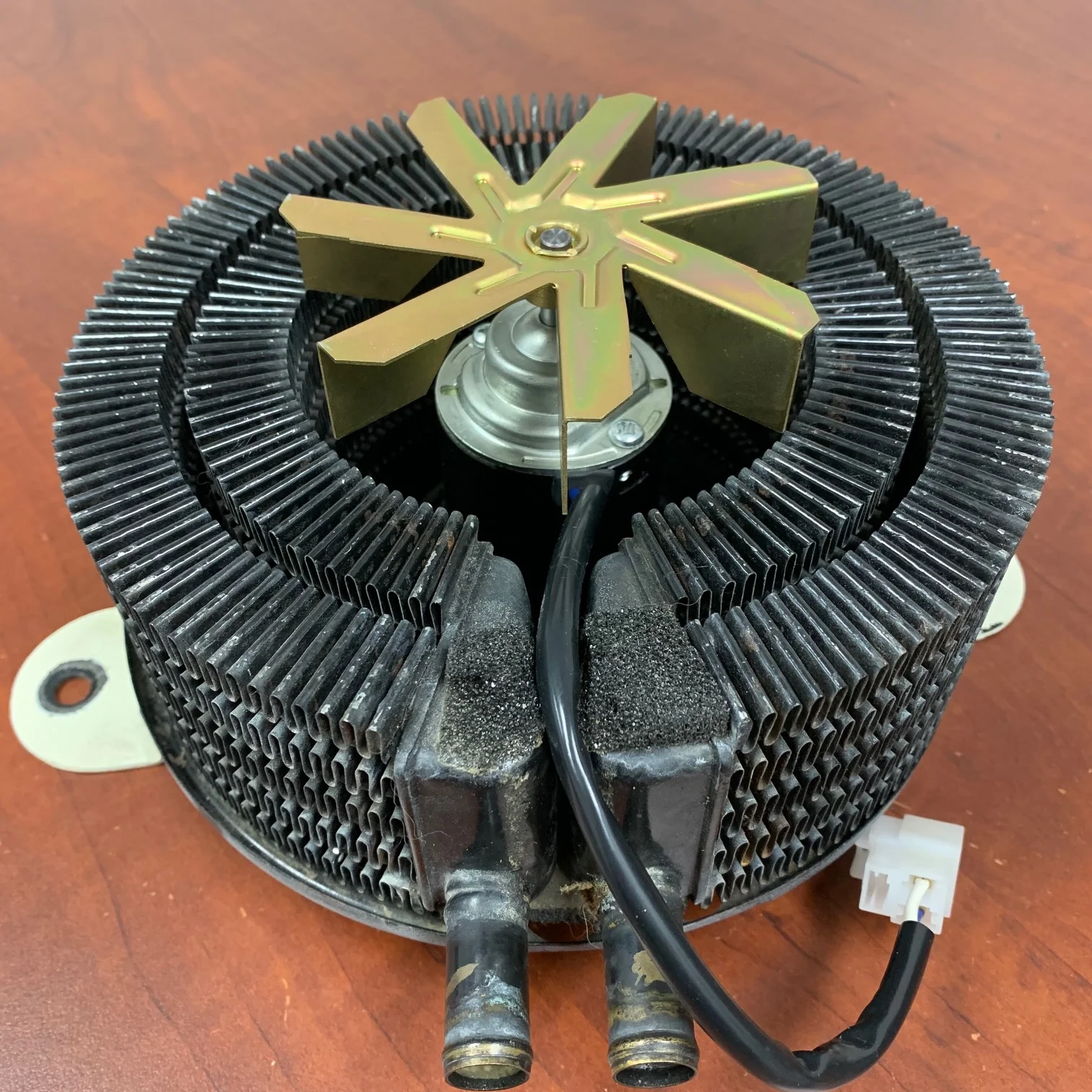

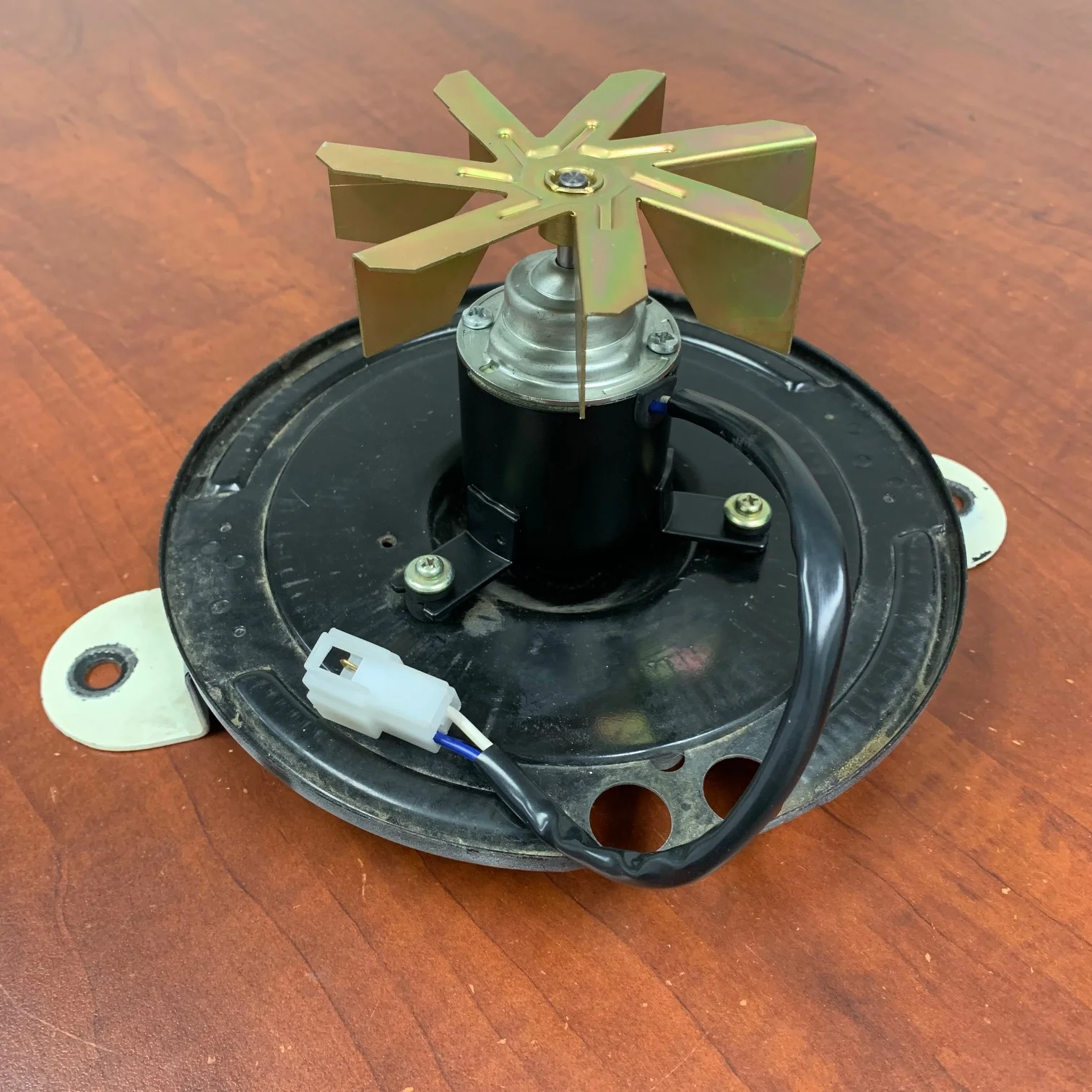

Reproduction rear heater motor with fan. Fits well and works great. Expected to be released in March.
This version is based on the one in my truck ('79-'80), so it's single speed as with all such motors from '74+. For other years the plug is different, but you should be able to swap in your old plug.

Bravo! Looks incredible! :clap:

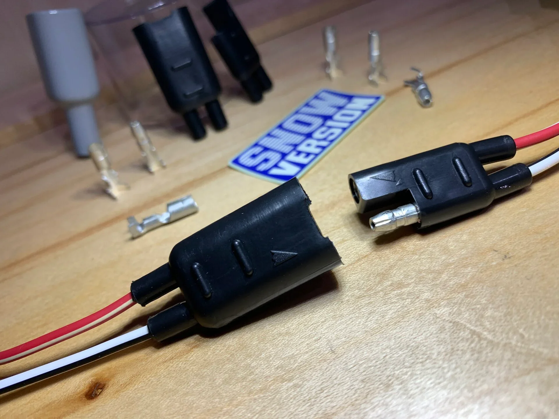

- this would be the 2pin / 2 speed speed OEM male and female bullet connector's Roger ...
- there was NOT a polarized dedicated white w/ black tracer stripe ground till later , maybe not even till the 1982 plastic console ? not exactly sure
- this can now run that updated post 2-speed need to those who like a reliable non-chassis ground reliance
- the H- KNOB switch / fan blower motor in engine bay 3-pin variant is in production now too .....
- i have these 2-pin kits now .....

Racer-X is truly a original professional mechanical TEq Artisan .... 👨‍🎨
- take note of the 3-mini-rubber-motor-mounts he has between the 3 feet and the sheet metal base , secured with the OEM-Period Correct concave-cupped fender washers .....
- 3 J.I.S. P-2 Phillip's head screws too ...
- hence = anti-vibration motor mounts / trans-dog-legs hockey pucks
- this is 100% OEM period correct in every single way ......:wrench::wrench::wrench:
- this details that matter-spec. / matter do details , is in my opinion , the most meaningful and significant parts of what he has crafted , designed and engineered above ...
- THIS IS THE WAY .....

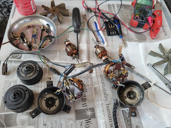

That's pretty cool! It was fun to refurbish my originals, but I def would have picked up a new motor if available at the time.
Seems you could just add a resistor and ground to chassis like the older version to make it 2 speed for those with the older 2 speed "H" switches.

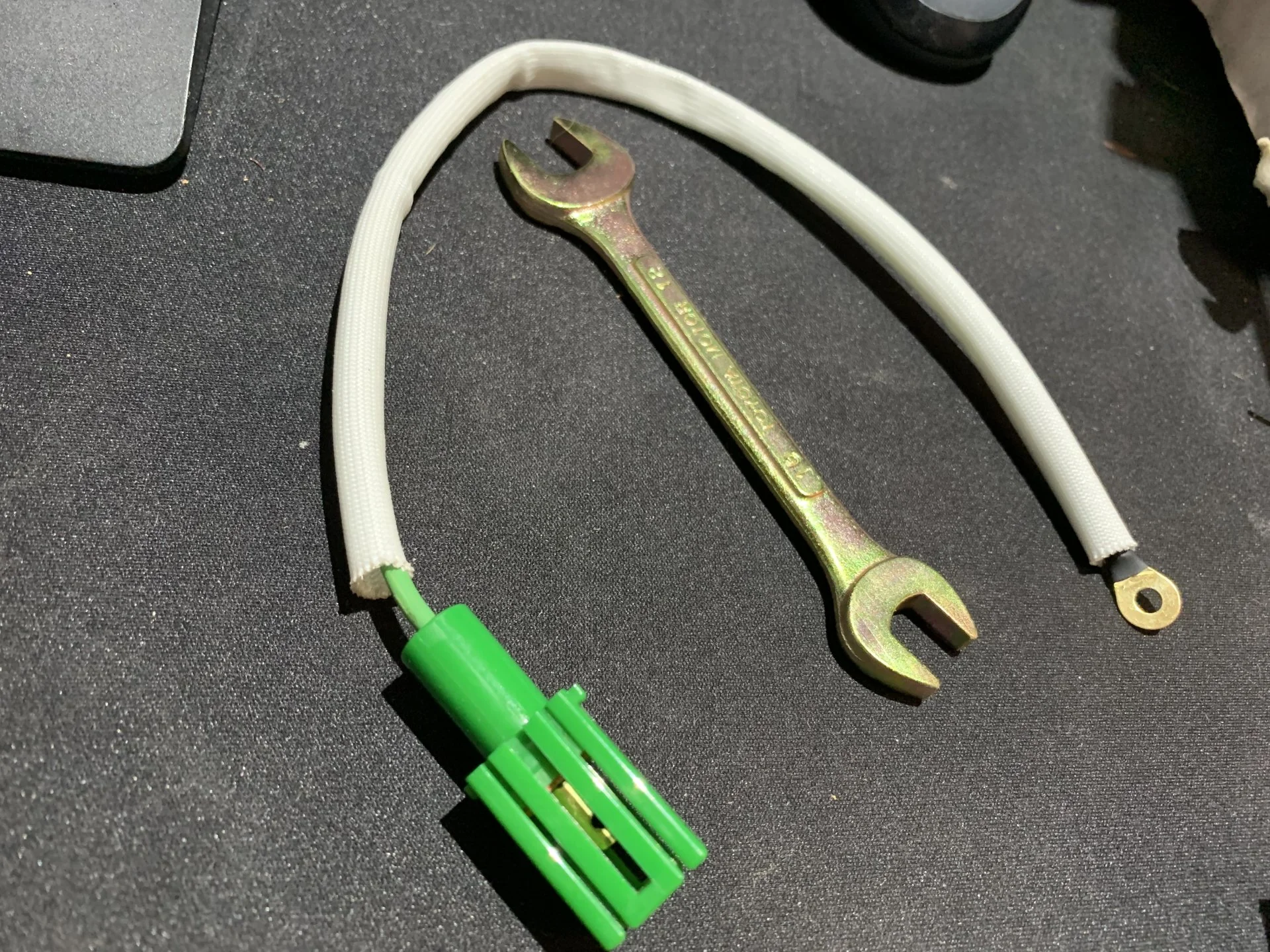

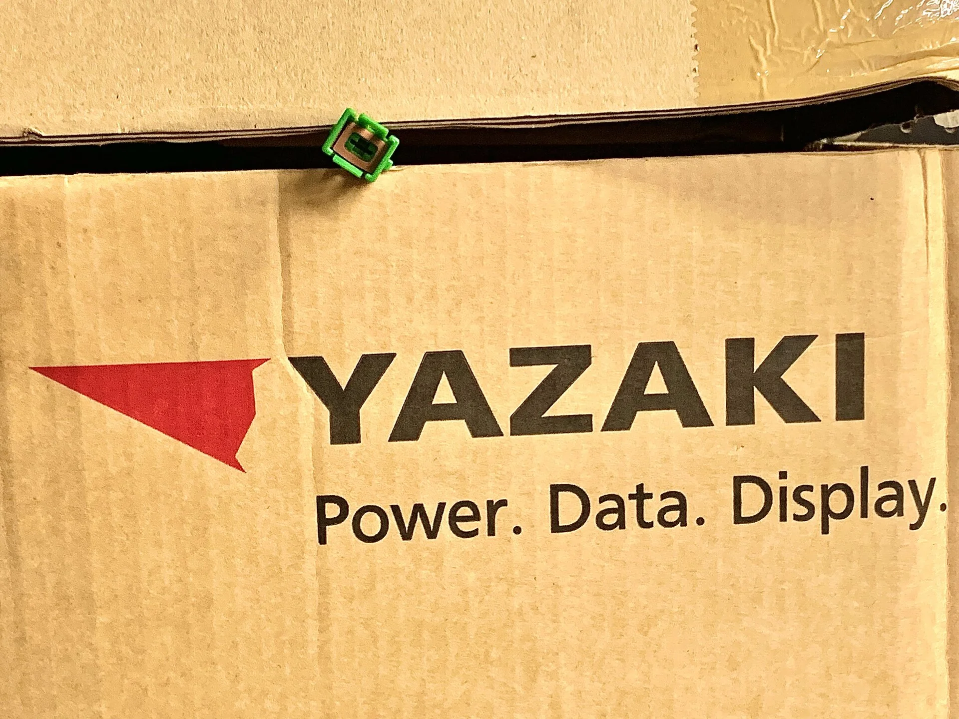

All various 2F and 3F-E Carb. Cooling Fan pigtail sub-harness sections are on the 2024 reality list of mine to bring back from the dead .... :D
- including the harness side mating matching connector housing and extra terminals of course
- OEM Green YAZAKI ........? :rolleyes: . hell yes !
the real question is
: are these like fusible links ? a unique different part # and one each darn modle year ?
guess i will find out ..
