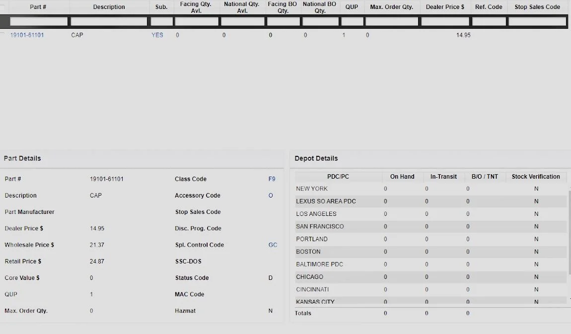

Unobtainium
Good call. JimC is a man who would know what to do with these types of things. :)
Definitely a goner, Kurt.
Thanks for checking!
I actually snagged one that a dealer in Washington state had sitting on the shelf. We sold through our last ones and I wanted to have at least one as a reference point for the future.

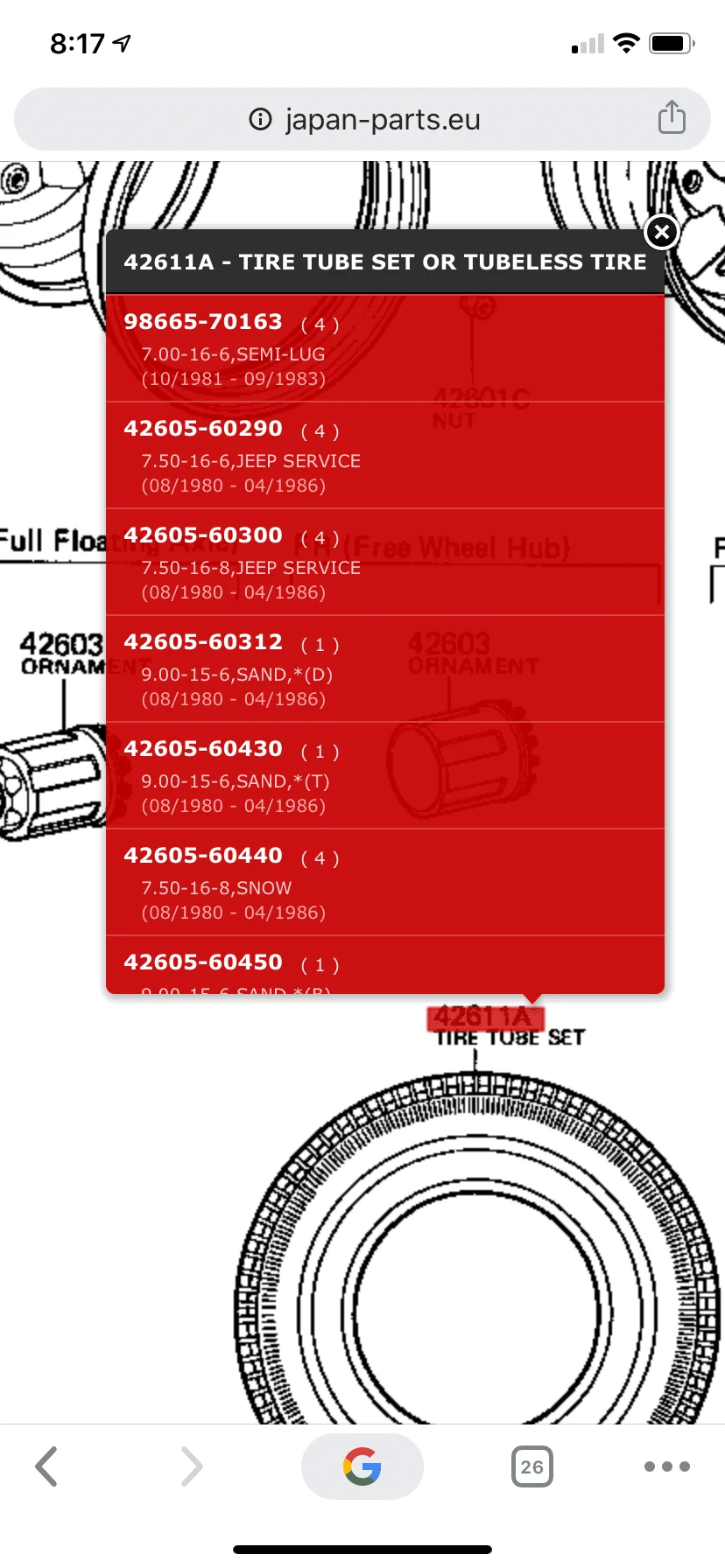

Curious if the tubes or liners on the split rim tires are still available.
I couldn’t find or figure out a part number from the Japan Parts website, though there are lots of part numbers for tires it seems.
It doesn't need to be OEM. I think @JohnnyC can tell you where to get it.
Tubes and flaps (liners) can be bought at most any tractor supply store or truck service center I go to GCR ... they are a national company
Common sizes are the 750r16 ... you can get a 700r16 if that small sizer is your thing :)
900r16 for sizes 35+
TR150 valve is a rubber valve that is bendable (I use that one) firestone tube pn# 552962
Tr75a is the brass rigid valve
You need to get offset valves and flaps (liners) I had not seen a single 750r16 with tr150 come any other way but offset
Tr75a can come either way centered or offset
The flap sizes come in 700/16 or 750/16 or 825/16 .... even 900/16

As usual @JohnnyC provided everything you need to know and more. In this case it's on the liners and tubes for split rims.:clap:

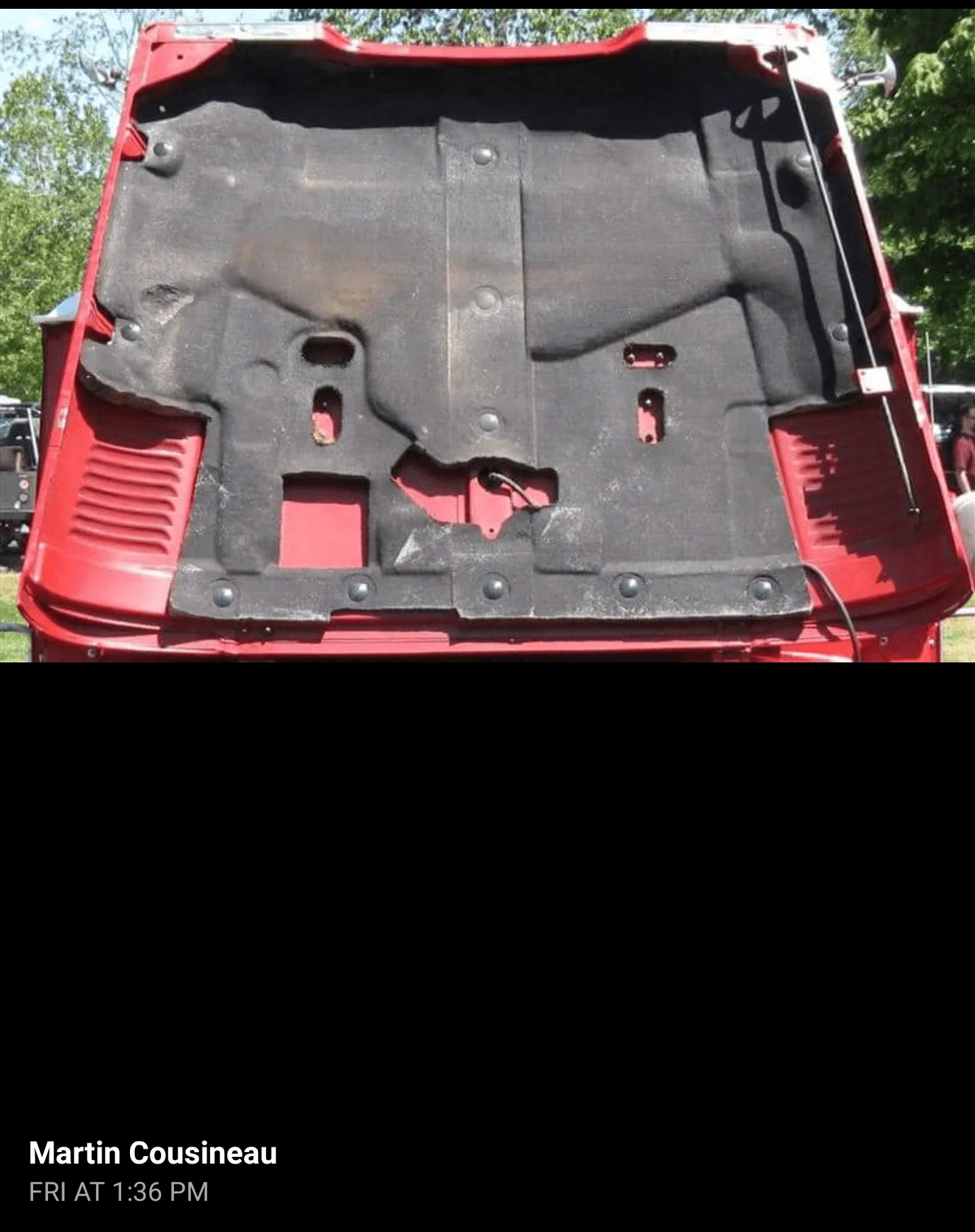

This was on ebay not too long ago...
Diesel-only.
That would explain why they were never on the North American trucks. It seemed odd, to me, to be a non-USA part.
But being a diesel-only part makes perfect sense. Did all diesel 40-series have them, or just the B-series? I don't think I've ever seen one on an HJ45/7.
We have an HJ47 pickup but I do not recall if it has one. The vehicle is on loan to us and I have not studied it very closely. I can tell you that the diesel hoods themselves are different due to the additional insulator mounting tabs that have been fitted. When I get back to the museum I'll have to open the hood on that one and take a look.
