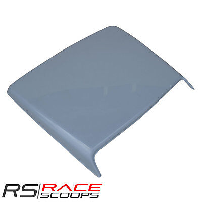

Love that scoop, not sure I have it in me to cut my original hood.
That is what is wonderful about metal, you can always weld it back. If anyone is looking to fill a container from Australia, I found fiberglass hoods down there....
I found some too, but at $1,200 delivered I’m going to have to wait on that for a little Bit. Not sure the price just hopping on a container with someone is. I like that scoop you found
I just ordered one of these for the troopy I am working on and it seems a good fit

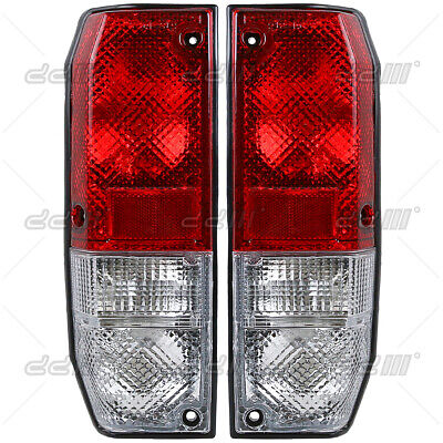

taillight question.... it has a weird fog light tail light - but only on one side. Importer said that is the law in Spain....
anyway, what options do I have for better looking lights on the sides. I expect it eventually I’ll build a customer bumper and I won’t want the lights there. So basically I’m looking to replace the side lights and have them be the stop turn.
Cruiser Outfitters can supply the "normal" tail lamps with red/orange/clear lenses.
Correct, there are a few European countries that are like that.
Double check the new lenses will fit. I seem to remember a post a few years back that showed the recesses the lenses fitted into were a different shape between various models, but that was probably after 1990

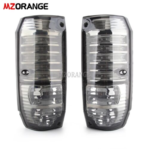

I assume I will need lenses and backs, so the entire light housing.
found these, but don't list fj73
Amazon product ASIN B07XLJKV3W
these say they will work for 73
stock light is still available too...
The bit I was saying is different is the size/shape of the metal on the fender. I wasn't sure if I made that clear. The blacked out lens are slightly larger on the 90- on models. Based on memory from a thread from 10 years ago.
Did you do this yet? I have the same lights, curious about moving the lights from the bumper up to the combo tail light.
not yet, I think I was waiting to see if someone had done it before. @roscoFJ73 comment kind of scared me off...

Other than the wattage, the lenses and the recesses on my former LHD FJ73 was the same as the other two JDM cruisers I got afterwards but then again my FJ73 wasn’t Euro spec.
