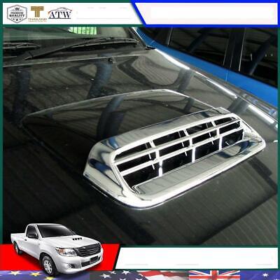

Thinking about hood scoops today... really liked the HILUX scoop I saw in Belize last year....
Think this is it...
Anyone have one of these?
How does it attached? I’m venting the hood on mine. Only due to the Cummins intake horn touching the hood.
looks like bolts through retainer points
