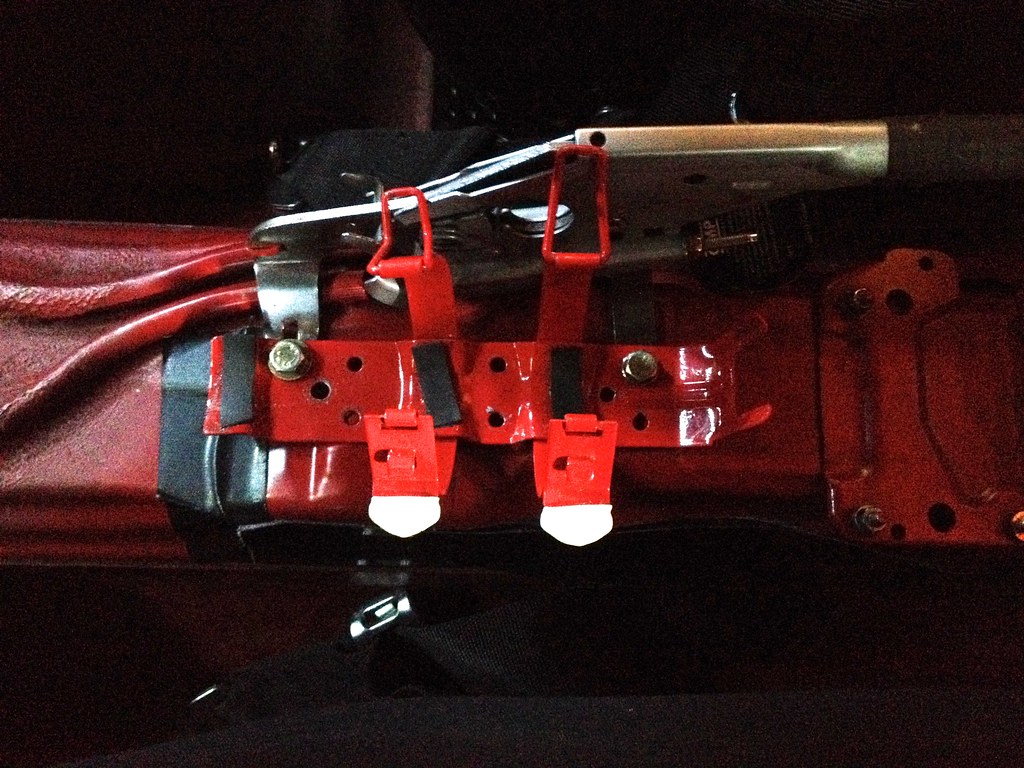

ARCHIVE Under Seat Mounted Fire Extinguisher Mount, need feedback.
How about for a JDM truck....will it mount?
Have you found any mount for the extinguisher you like better. I have been considering the drake one but didn't know if it would push the extinguisher out onto the foot space too much.
I like the Drake mount a lot but it does push the F.E. Out by another 1.5"
I have one here. Later tonight I'll take a pic of it all together.
I have to say as far as mounts go... Simpler is better.... I have a drake style Rennline FE holder for my porsches extinguisher in the passenger side footwell. I have practiced FE retrieval extensively incase I ever have to get it quickly possibly while pinned in the seat and that style mount kinda sucks... It can be a PITA to get to fully release if the FE has jarred a bit.
The basic strap mount I have in my LC will come free every time easily.... It doesn't look as good but it works better.
no not plastic, metal straps with release toggles like this.
Nice thing about these types is they spring out of the way when released.
^ so that is what comes with the H3R Halon F.E.s and its the one that Scottryana was saying is an issue and the one I had issue with because the claps are ridiculously easy to accidentally open unless they were pointed down. But because of the gauge you can't reverse it.
H3R has quick mounts too Joey if you are interested.

Here is the other ones by H3R. I like this design, I will order one up to test:
http://www.h3rperformance.com/vehicle_brackets_nb300.htm
Haha yea the latch is easy to trip.. Guess I've never had an issue with mine because, again, its in the passenger footwell Hhaaha :flipoff2::flipoff2:
I like it. It's much better than the bracket I have tek'd to the passenger footwell (never had an issue with kicking it).

Ok so.... I'm not worried about misfire since its an inert gas, but I am concerned about anything falling into the wide mouth nozzle and possibly clogging it. Very bad....
I'm sure you know @NLXTACY , but I'll point out that while it may be inert, Halon works by displacing oxygen....so you don't want to be in a closed compartment (like a closed car interior) with it where it can build to concentration and you can't get the oxygen anymore :eek:
I'd work to avoid the discharge potential :cheers:
