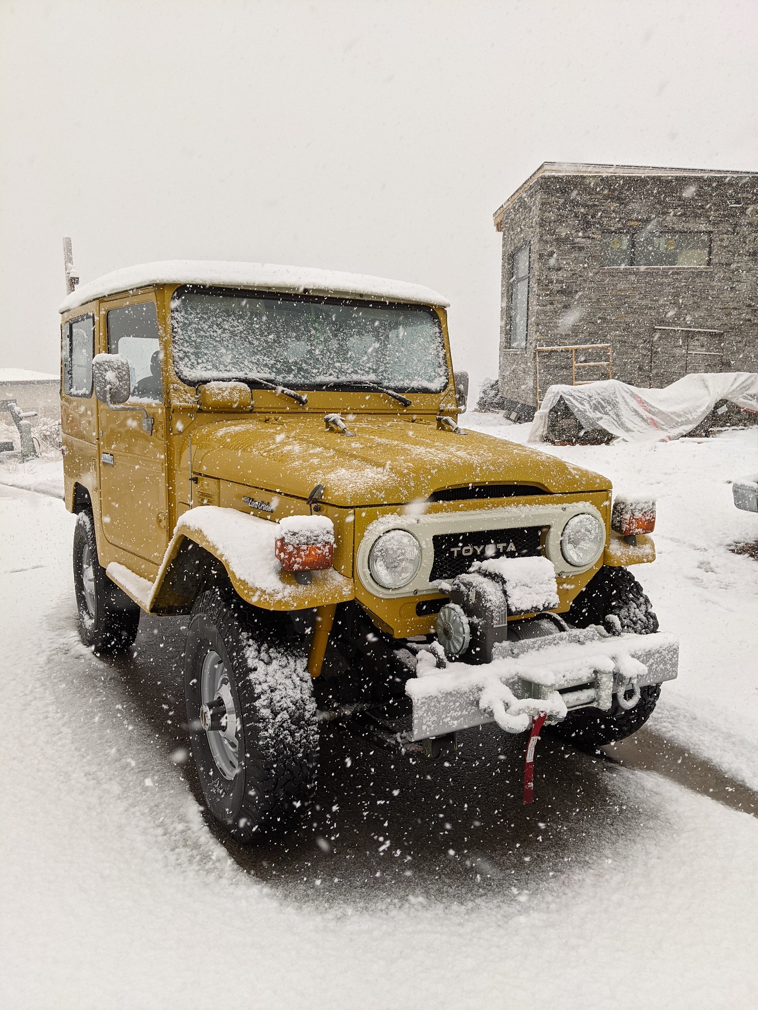

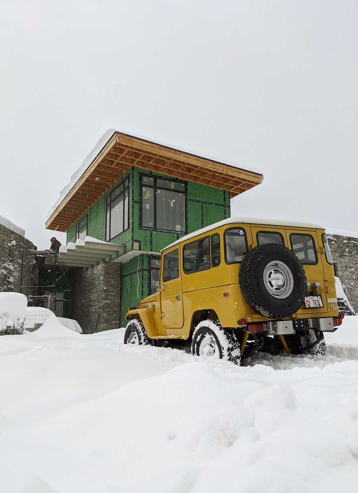

On Tuesday I went for a drive up Little Cottonwood Canyon because it was snowing. I've actually never driven this rig in the snow and was a little nervous about the tires since they've been on her since 2007. They were fine. I know technically they are too old, but they show no signs of rot and only have about 6,000 miles on them. Plus, I understand you can't actually buy 33x9.5x15 BFG ATs anymore and I love the tall/skinny look! The weather provided for some pretty good photos; too bad I didn't have a 'real' camera.
The shop damaged the left front fender previously and had it repainted. The paint does not match. They've agreed to fix it correctly and I'm going to have the rust on the passenger door fixed and it repainted because it just needs to be done. I will drop her back off at the shop Friday...

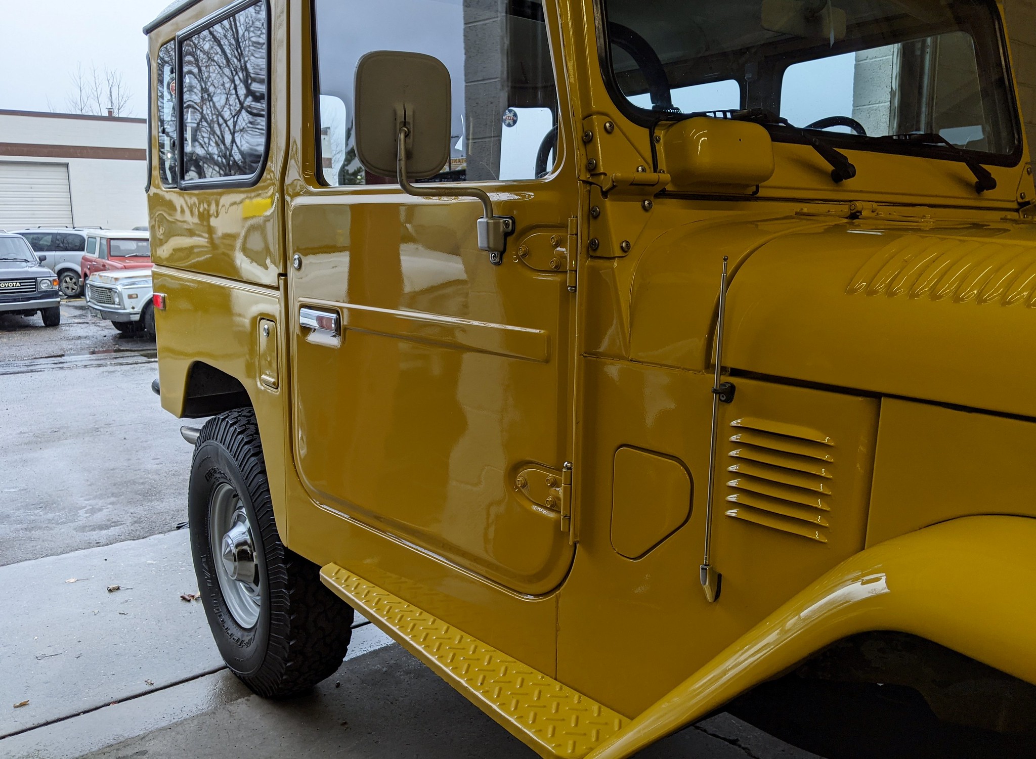

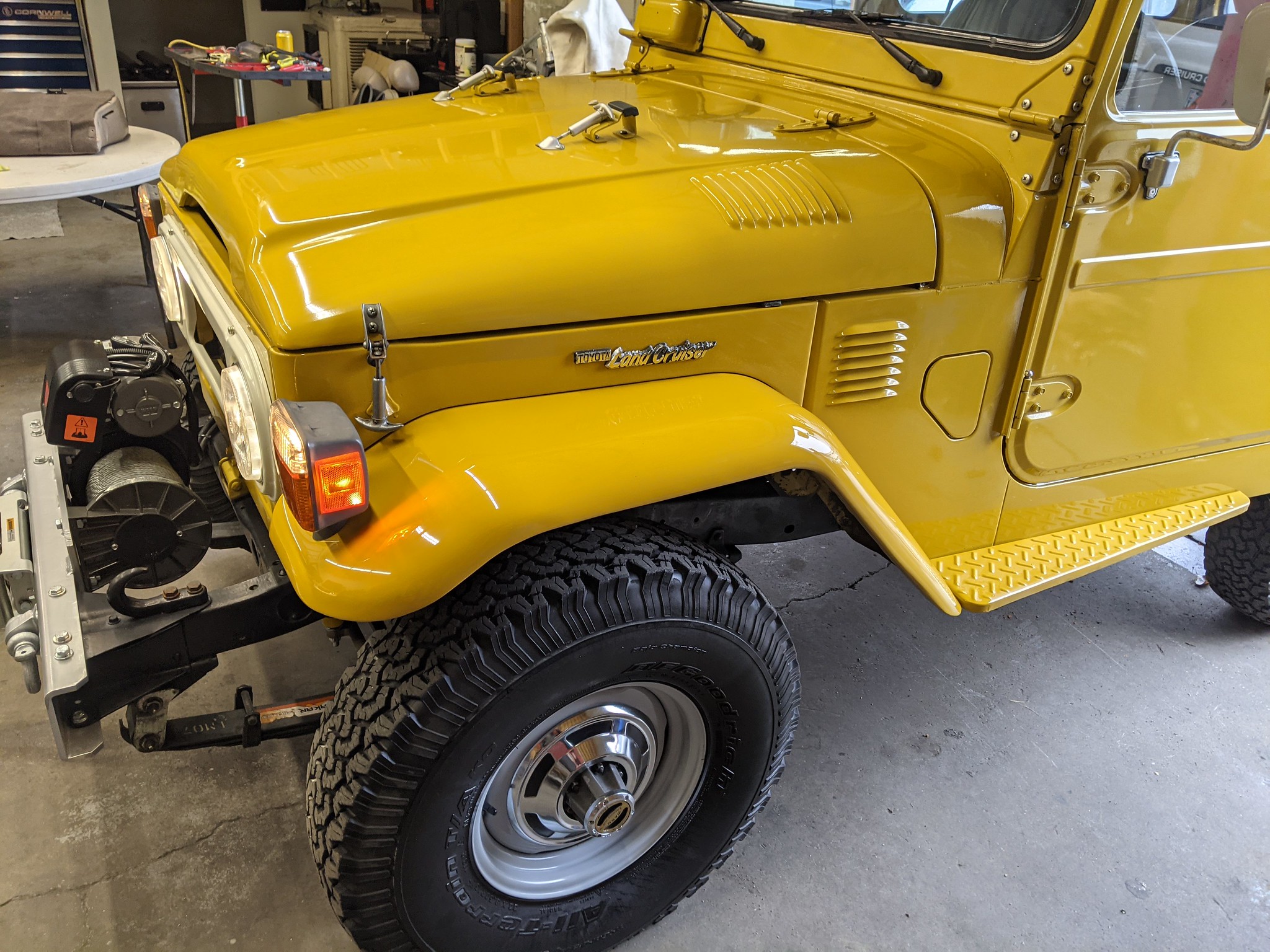

Ok. One more time, back from the shop.
I'm happy with the paint now. My ceramic guy (Dusty at Envision Detail) has offered to re-coat the door and fender and I'm grateful for that.

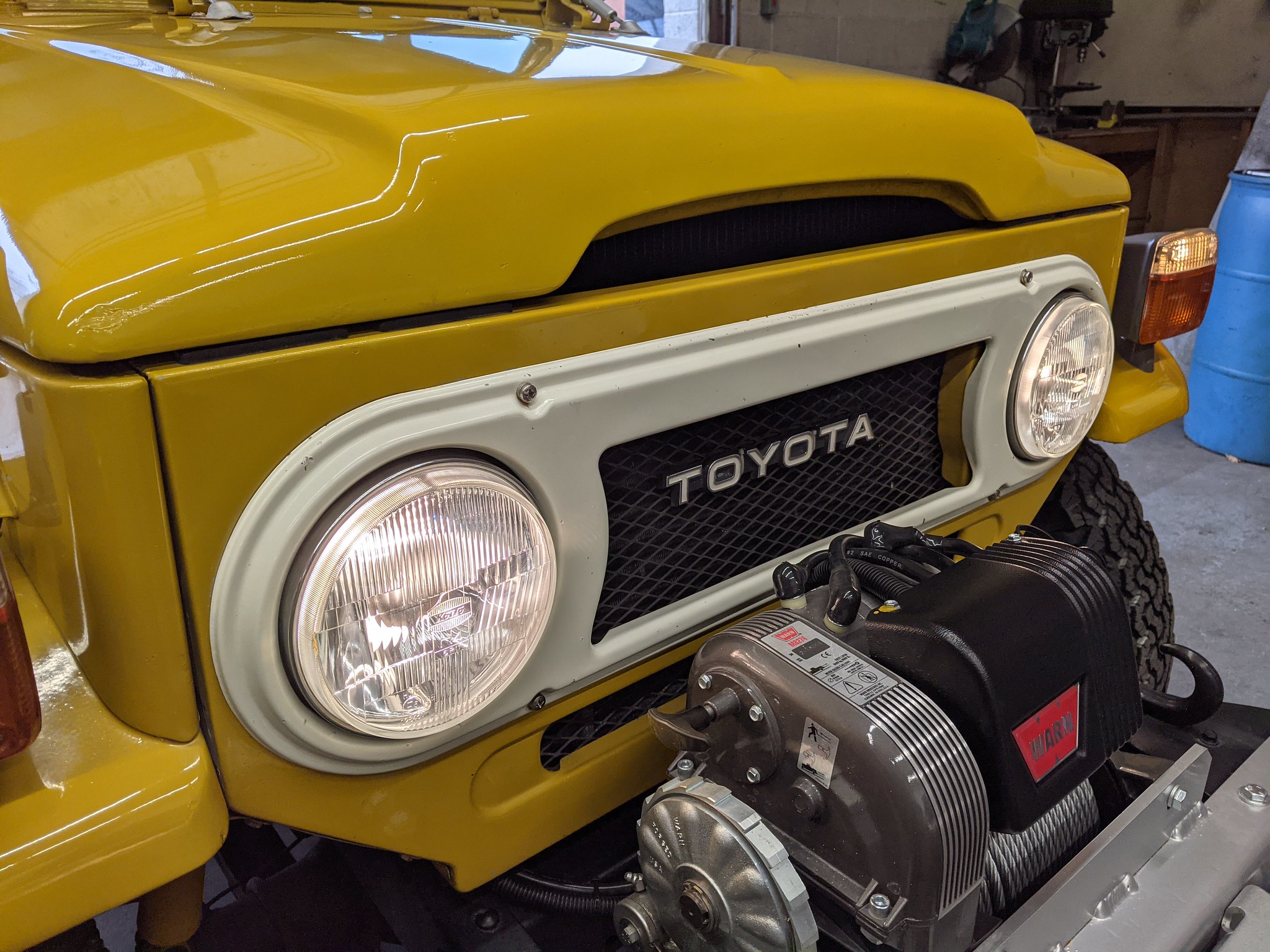

While it was there I had them install a Kioto headlight kit (thanks for the suggestion @onemanarmy).

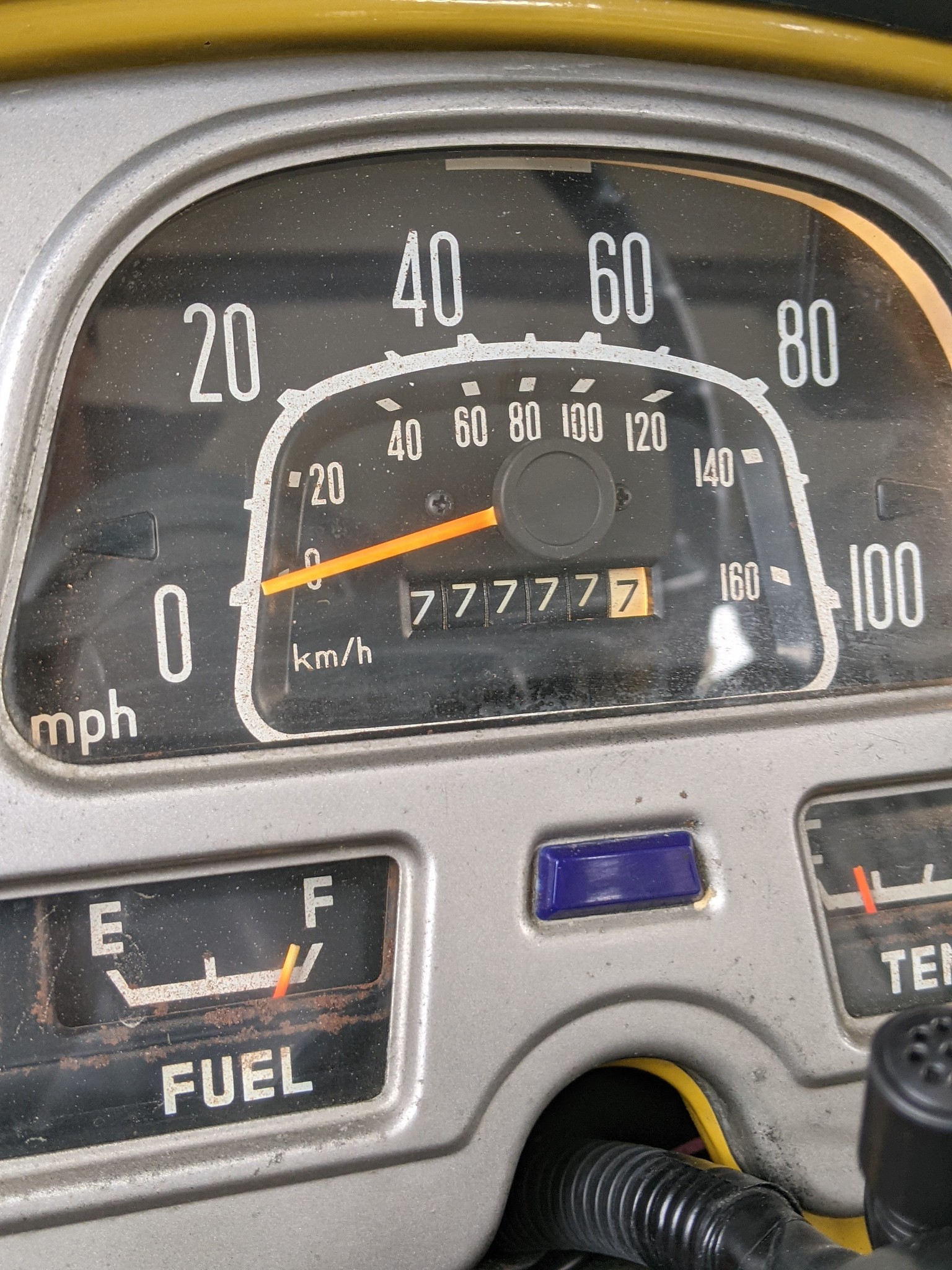

Hit a nice "mile"stone driving around today:

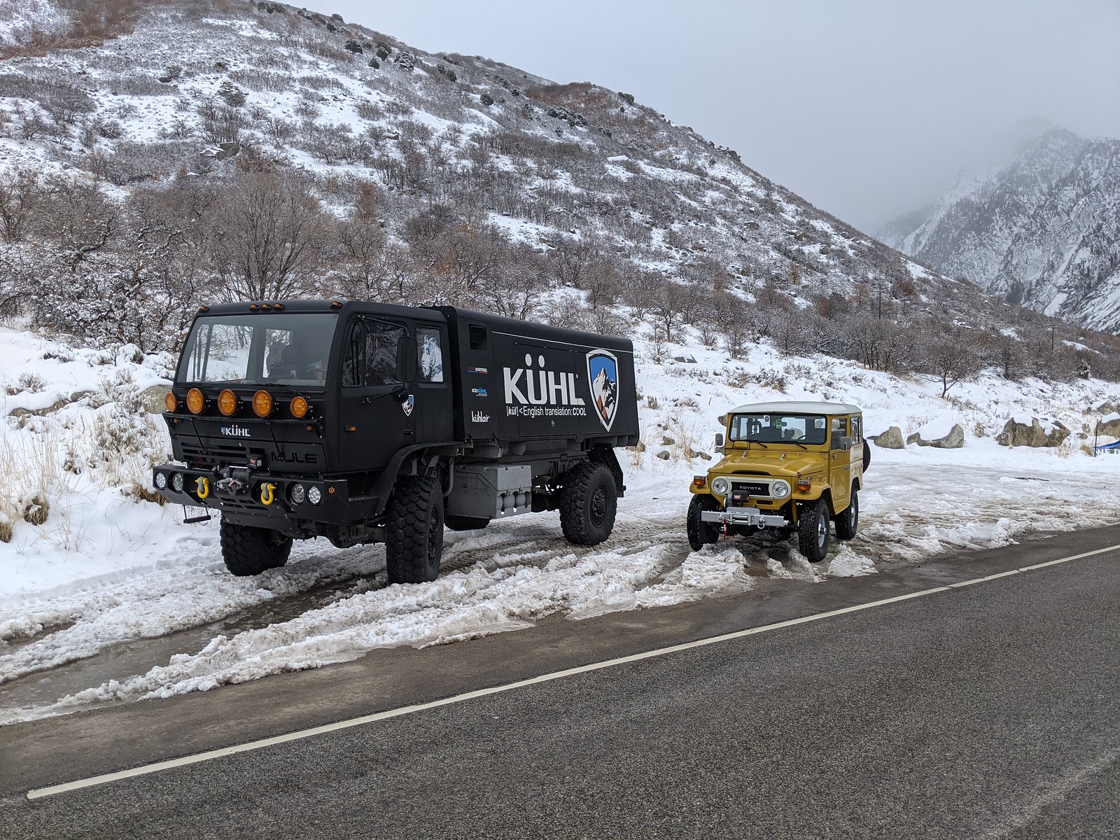

The other day I encountered this marketing ploy by Kulh (built by Mule Outfitters near my real home in Issaquah, WA) near Little Cottonwood Canyon. Amazing how tiny Uglina appears next to it!

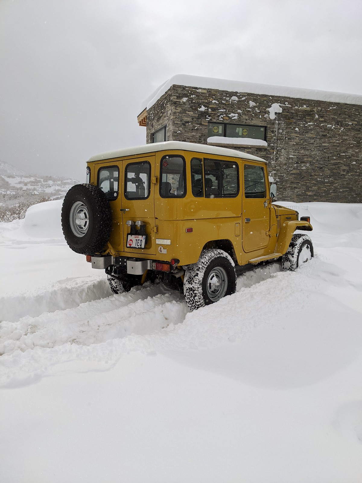

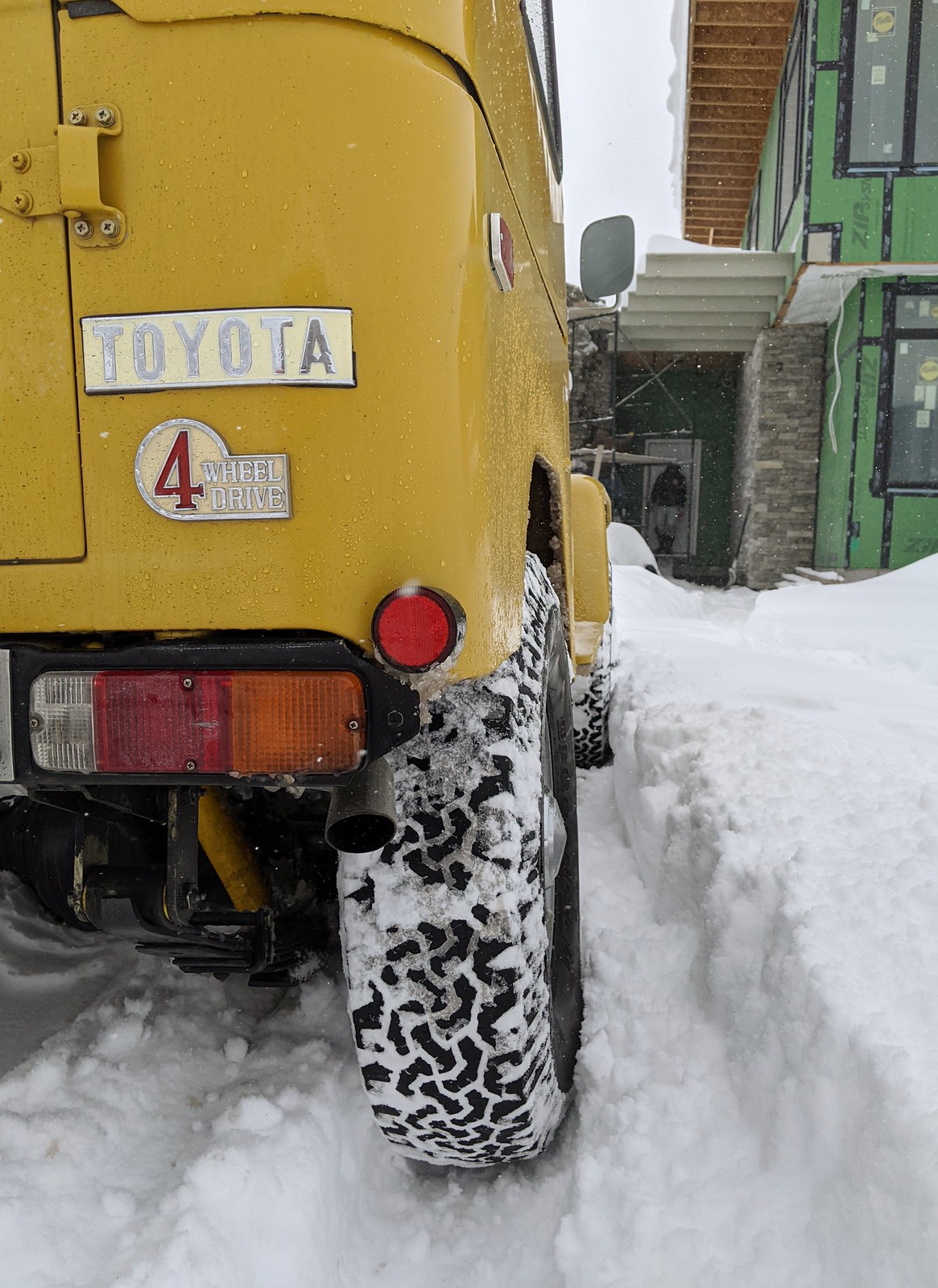

Today was a deep pow day in the SLC area. A perfect opportunity for me to just drive dat bish! I had a hoot just hooning around in the snow...and I didn't even get stuck!
These ~15 year old 33x9.5 tall-boys suck in the snow and ice. I believe a combination of the rubber compound likely getting hard with age, the wear (~10k miles?) on the tires, and the fact they are just an old design contribute. But they are just not confidence-inspiring in the snow.
So now I'm thinking about new tires. It really sucks you can't find 33x9.5s anymore. I want to retain the stock steel 5.5" x 15" wheels.

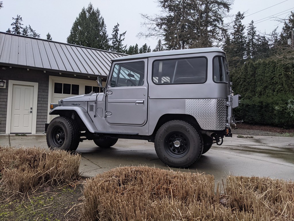

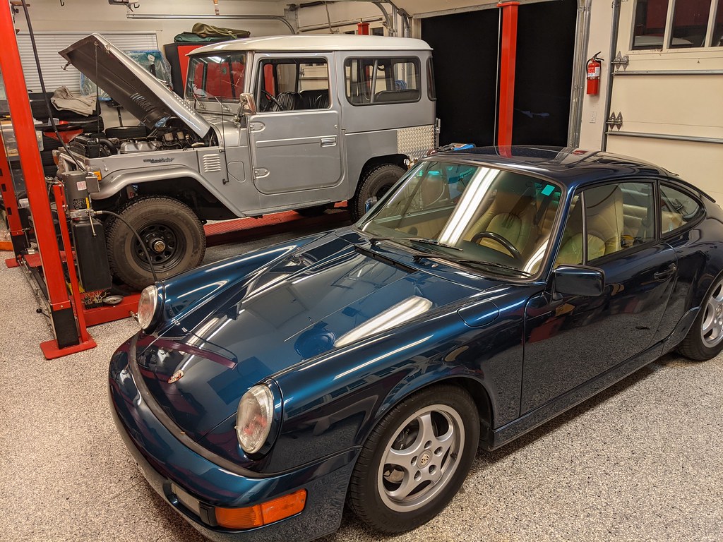

My daughter's boyfriend's boss has similar taste in cars to me. I actually know him from a prior life. The BF has been taking care of a few of his cars, and they somehow both have ended up in MY garage recently.

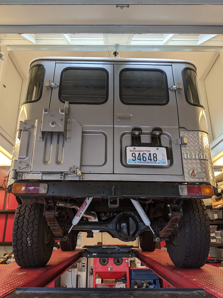

One is a '91 Porsche Carrera 4 in Amazongrun.

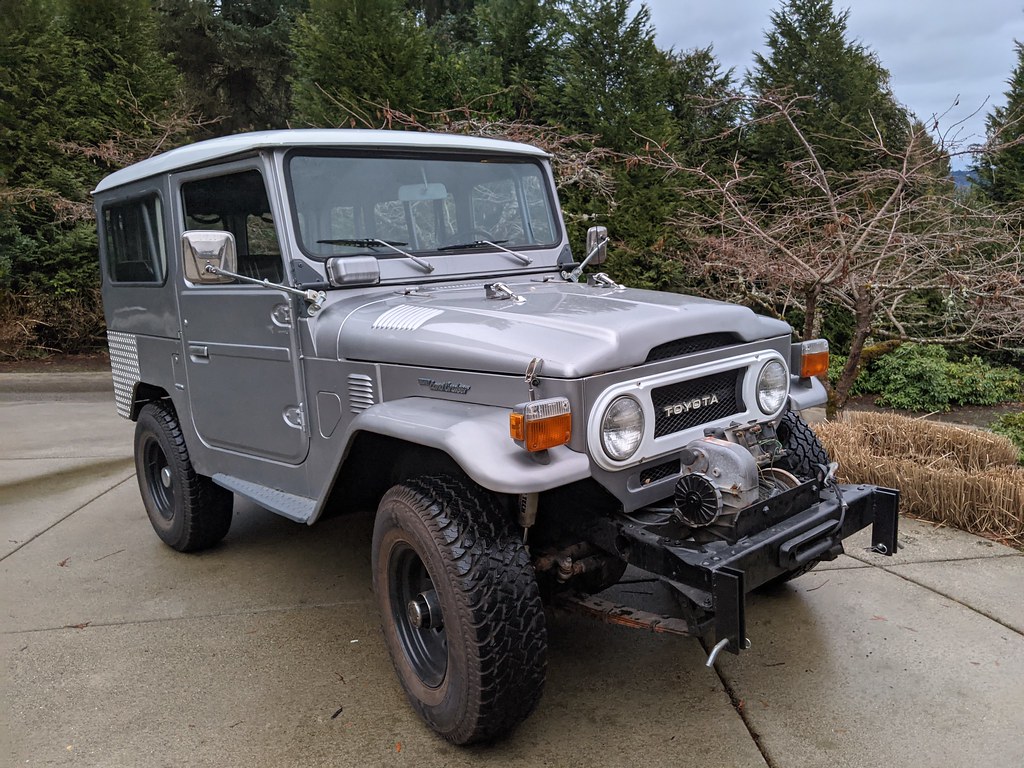

The other is Rin-Tin-Tin, this very cool '76 FJ40.
It's been a LONG time since I've driven an FJ40 other than mine. This rig drives very well and the motor is smooth and strong (def stronger than Uglinas). It doesn't have PS and the roll cage is super annoying. Love.

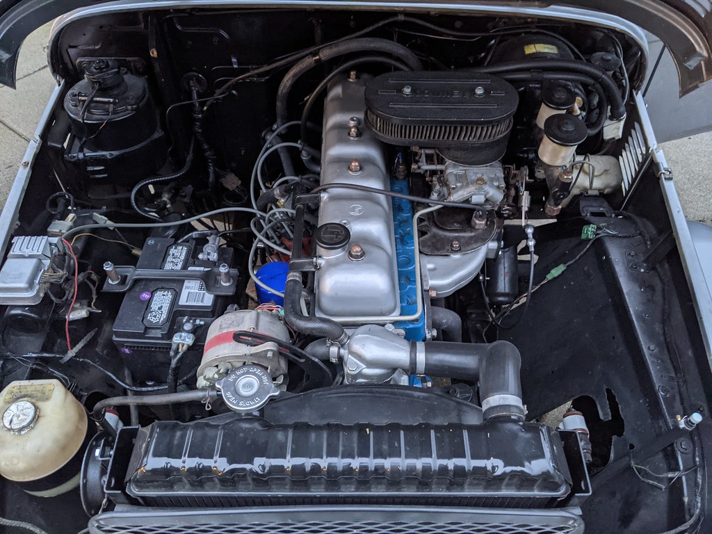

Checked oil yesterday. Was shocked to discover it was super low. I have been driving it a lot, and have not been checking the oil each fillup. I guess she's burning more oil than she used to...
Put this in:
Here's some pr0n:
