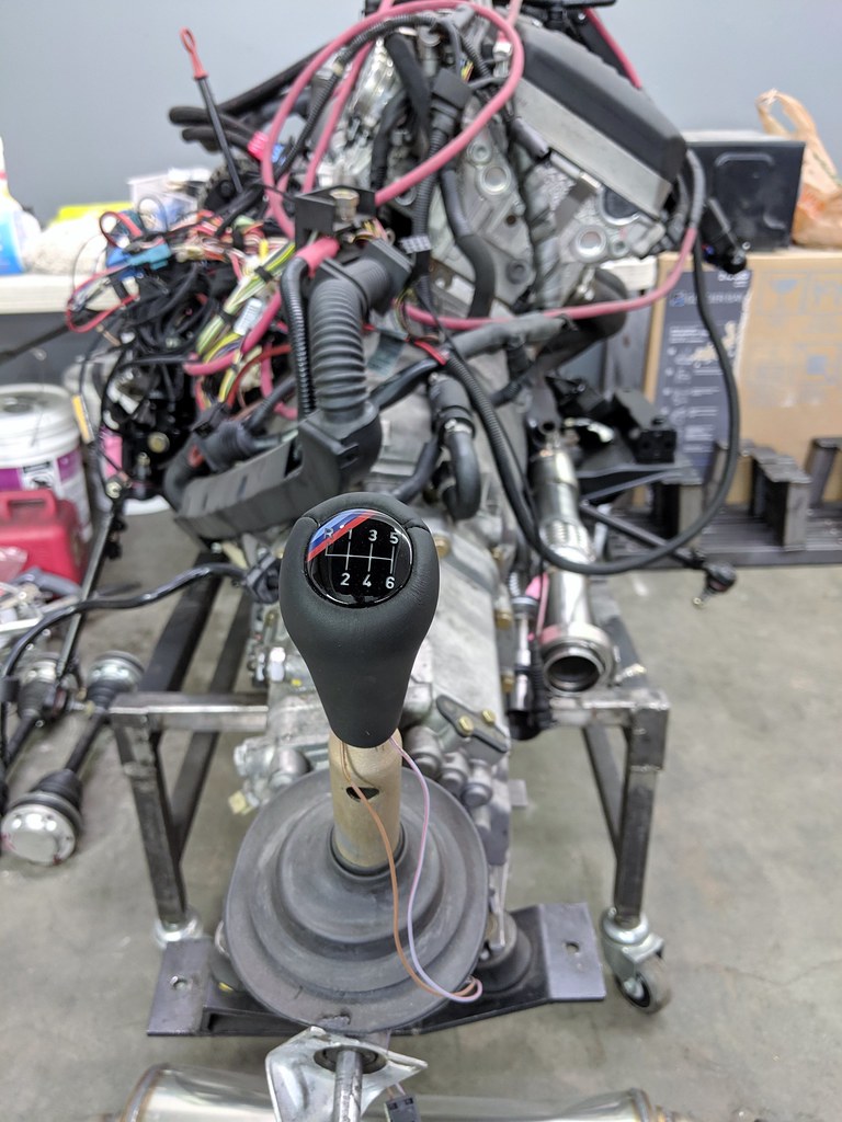

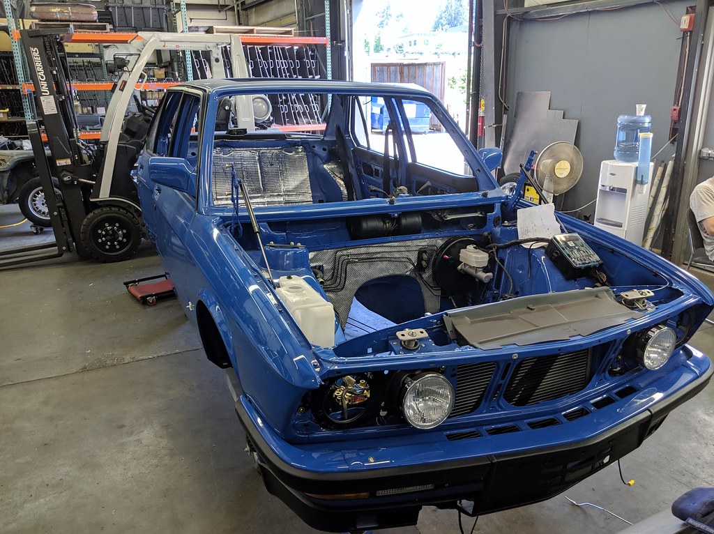

This is Minerva. It is a 1985 BMW 528i (Euro) that I'm building from a bare chassis. Into it is going an S54 motor (from a 2006 M3) and 6-speed. Painted Porsche Arrow Blue....

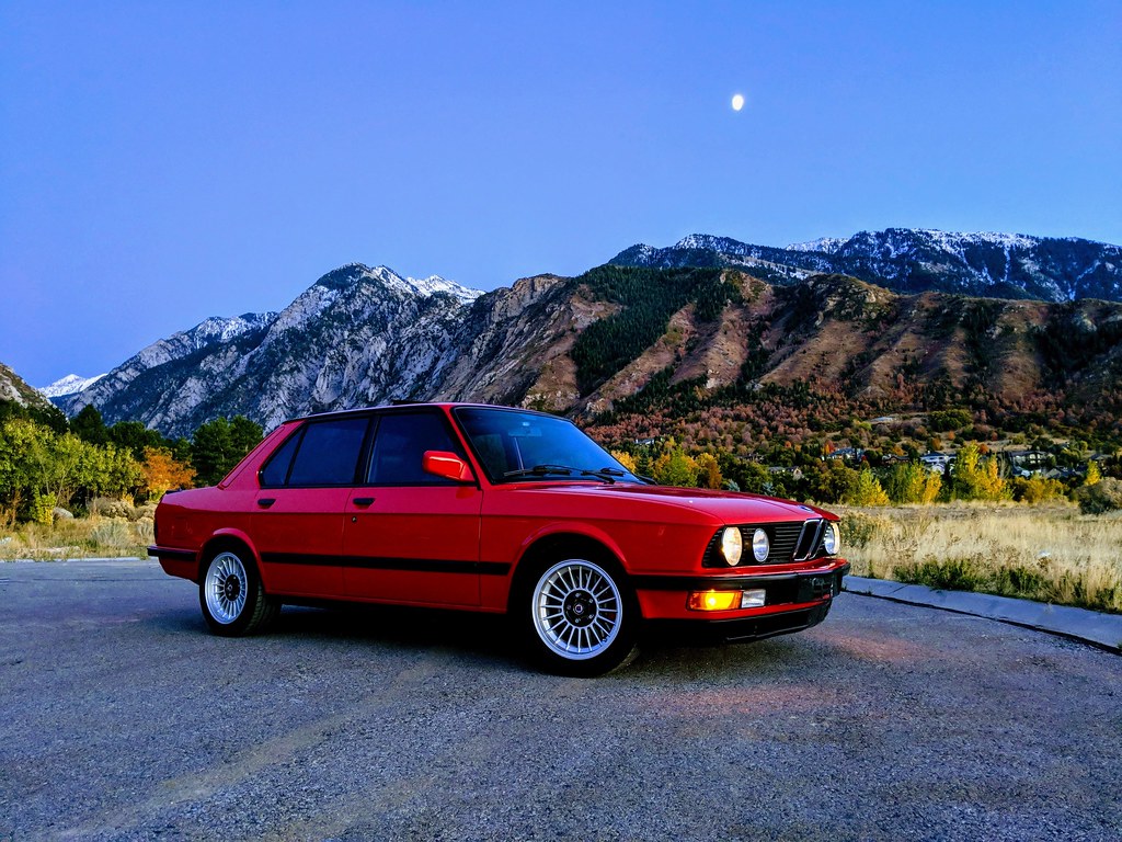

This is the red car (Vlad) from the posts above, it's now in Utah as my daily driver there:
Uglina and Vlad are going to get along very well, me thinks...

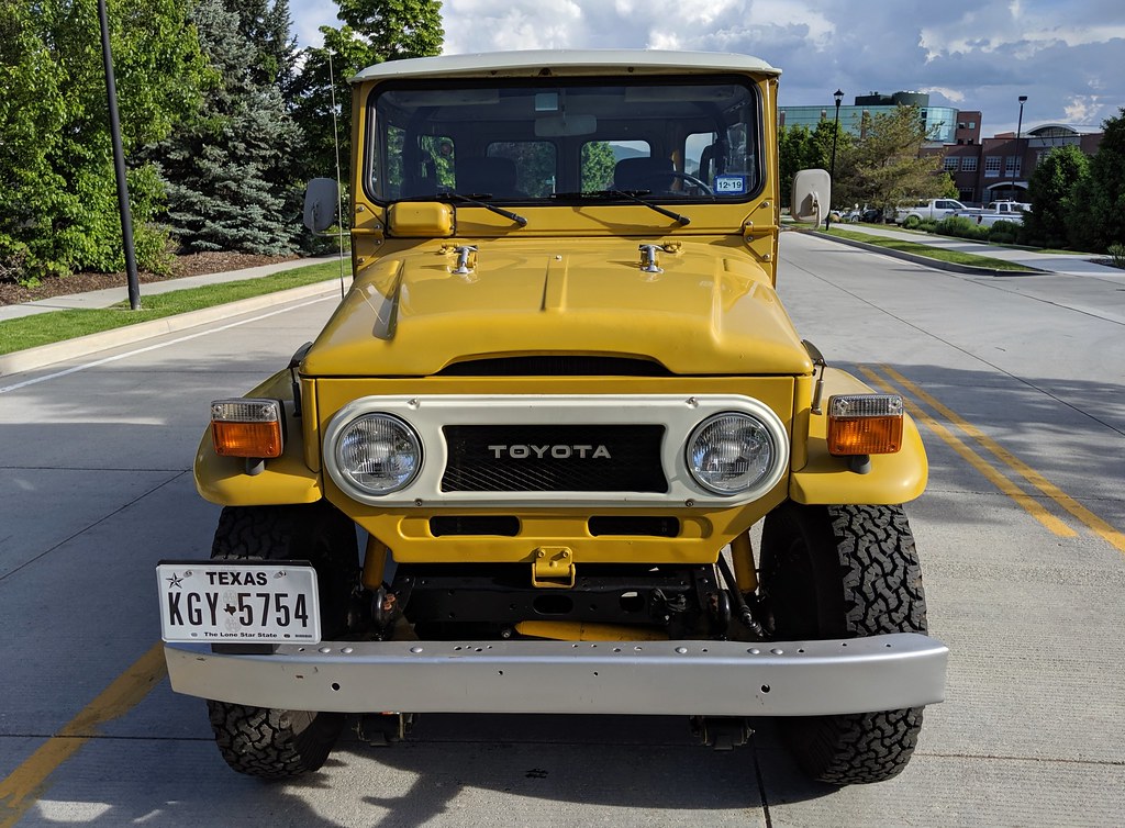

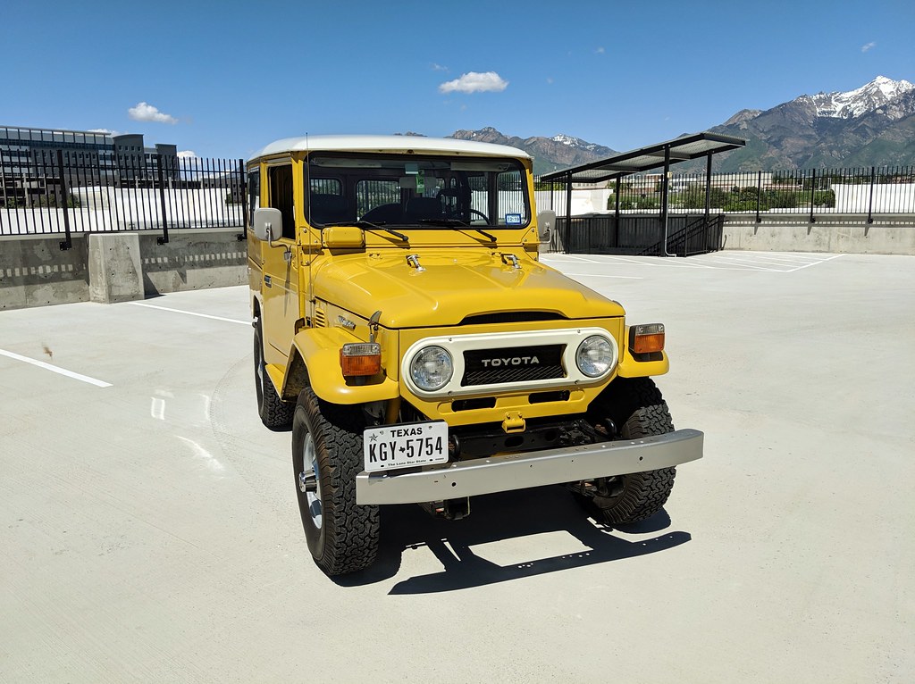

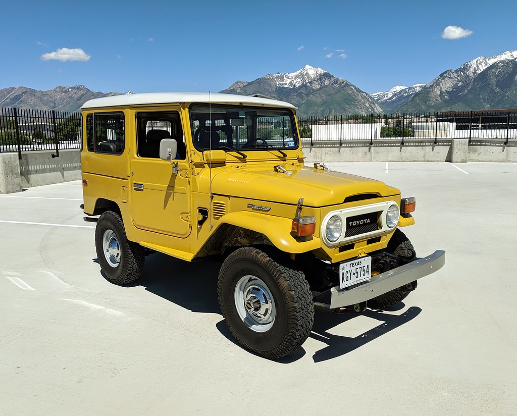

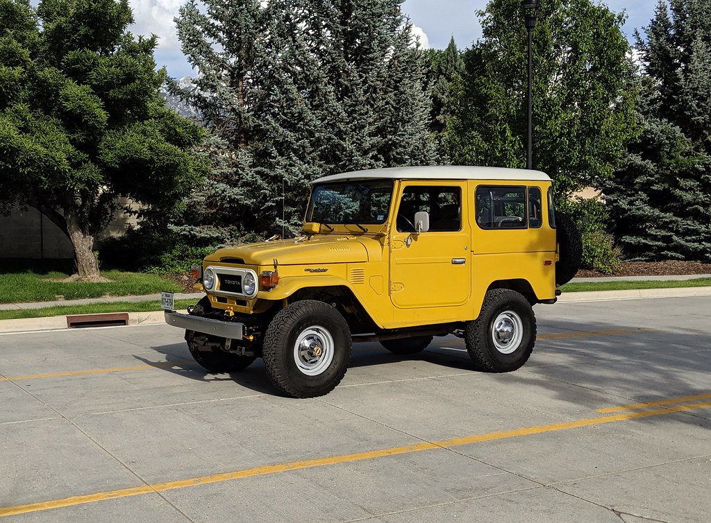

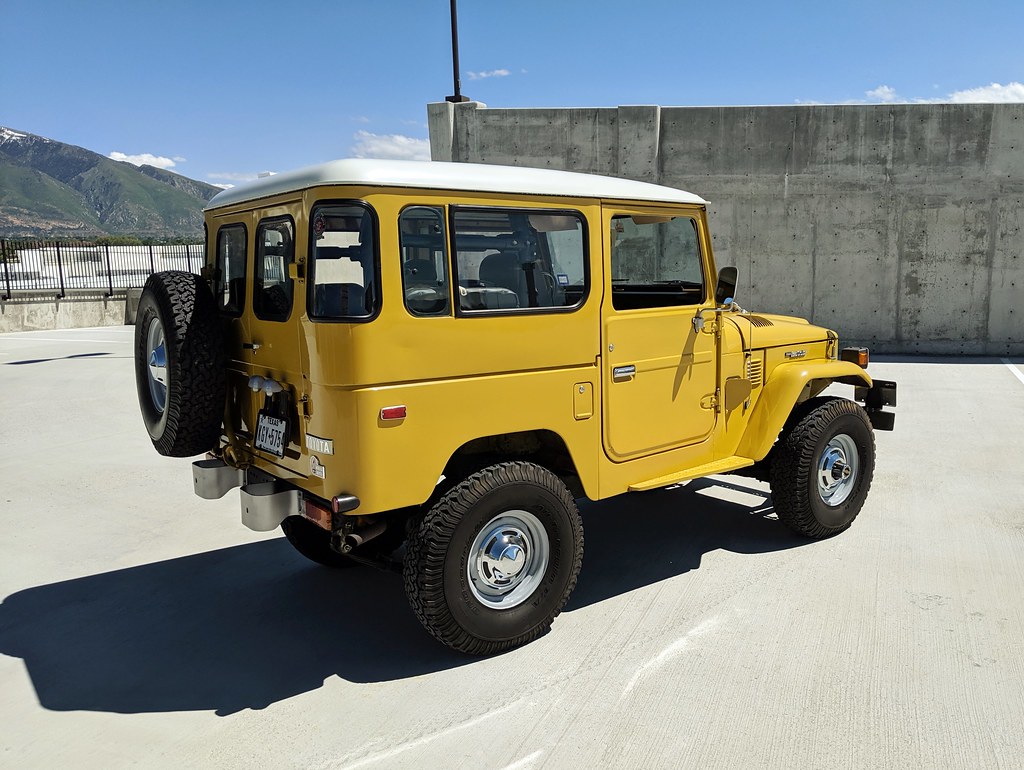

She's here!
I had a hell day. Started with landing SLC and my phone blowing up with text messages that my car (Q7), which I'd parked in the work parking lot over the weekend, had a smashed passenger window. I was able to get a glass guy lined up and by 2pm it was all repaired.
Then I had an all-day meeting at work that was intense. The transport guy called and texted me at 5pm saying "I'm here". I had a dinner at 7pm. I was able to get to my apartment from work, take possession of the rig, and drive to dinner. I showed it off to all my co-workers, many of whom are hard core car guys.

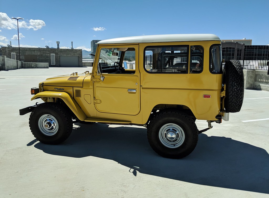

Impressions:
- Drives exactly as it did when I sold it 7 years ago... steering may be a bit looser. Starts easily, pulls hard. Shifts well. Everything feels buttoned up. I don't recall it stalling as much when re-started after cooling for a bit.
- Def has more patina, but it's nice soft patina. The rust bubbles that were JUST starting on the passenger door have broken through and are real rust now. Paint needs to be waxed. But besides that she looks great!
- Dash lights are inop. Shift knob is looser.
- All the parts that went with her, are now back with her: Brand new AATLASX seat vinyl set, half-doors, bimini, etc... Plus some new parts like a steering wheel center!

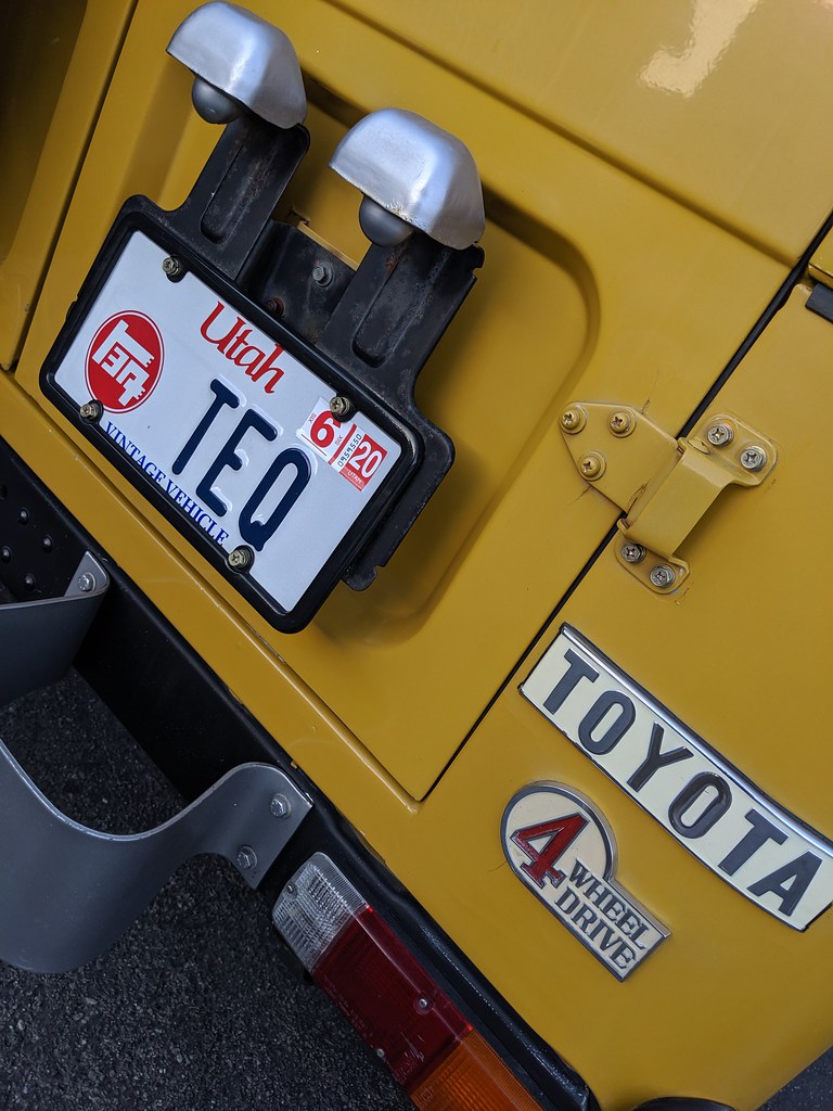

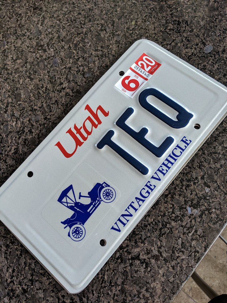

  1. Title and plates for UT.

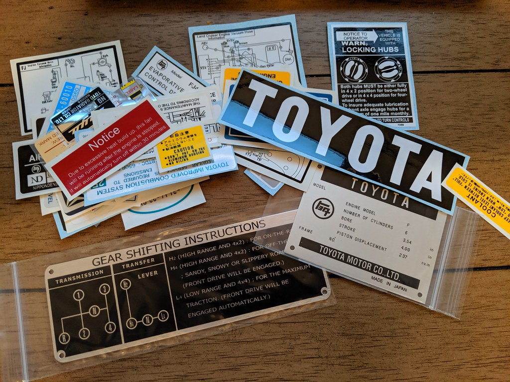

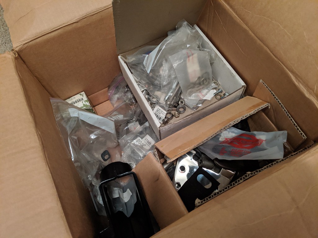

Fun going through all the crap I bought but never put on. For some reason I purchased two sets of stickers & plates...
This is really the tip of the iceburg...

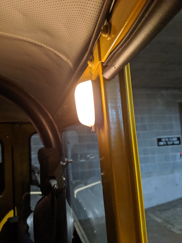

Did my first 'fix' tonight.
  1. Fix dash lights (switch is going bad; a cleaning helped but I'm going to replace it, if I can find a new one?!?!).
  2. Plug in hard-top dome light (which I, apparently, never plugged in when I put the hard top on last; the wire was still zip-tied to the sun visor post).

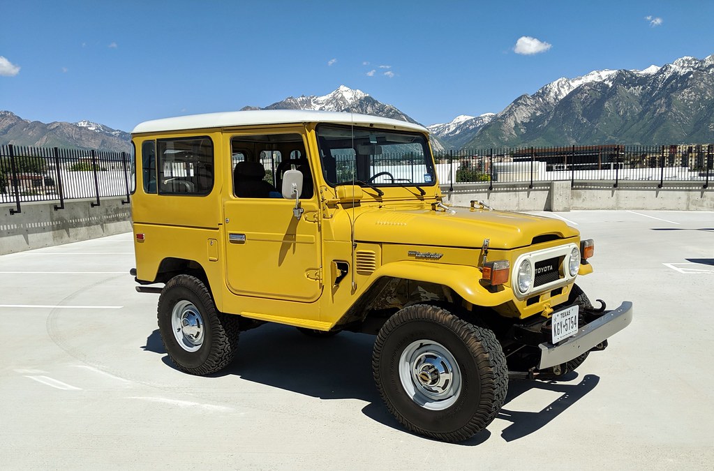

Gave Uglina a wax yesterday. I used Mothers Cleaner Wax. If I were in Washington with all my detailing tools I'd have used a better paintwork cleanser, claybar, and my go-to wax (One Grand Blitz), but here in Utah and the Apartment my choices are limited. I suspect Jack hadn't waxed the rig in the past 7 years. Regardless I got a fair amount of oxidation up. She shines up nicely and is looks GREAT at 10 feet (before she looked great at 20 feet). At least now she's better protected from the elements.
I also setup an appointment with a local shop to get a high-altitude tune (and to address the fact she stalls at idle when hot). Also to get the AC fixed.
I really hope I can find somewhere to store the top, because I'm itching to take it off!

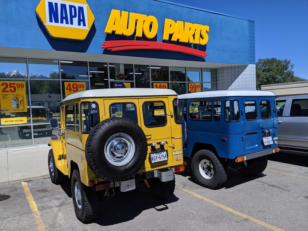

Went to the auto parts store yesterday to get some supplies to fix the rust bubble that's forming on the passenger door.
Made a friend. '83 that's been owned by "Kenny" since '95.

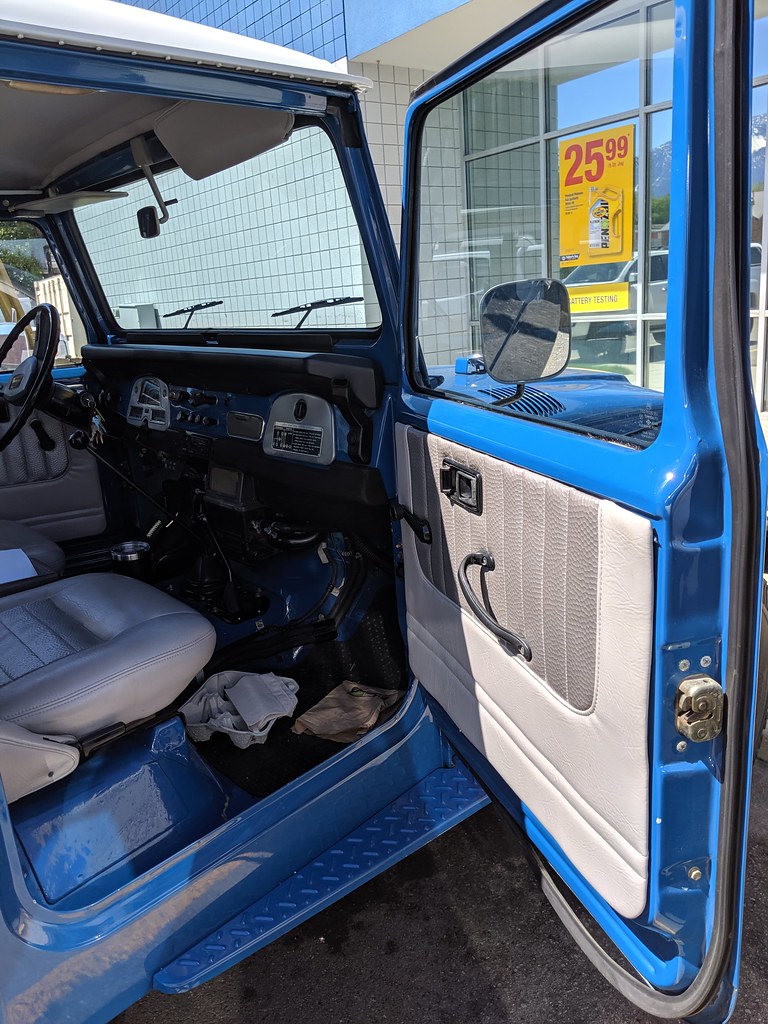

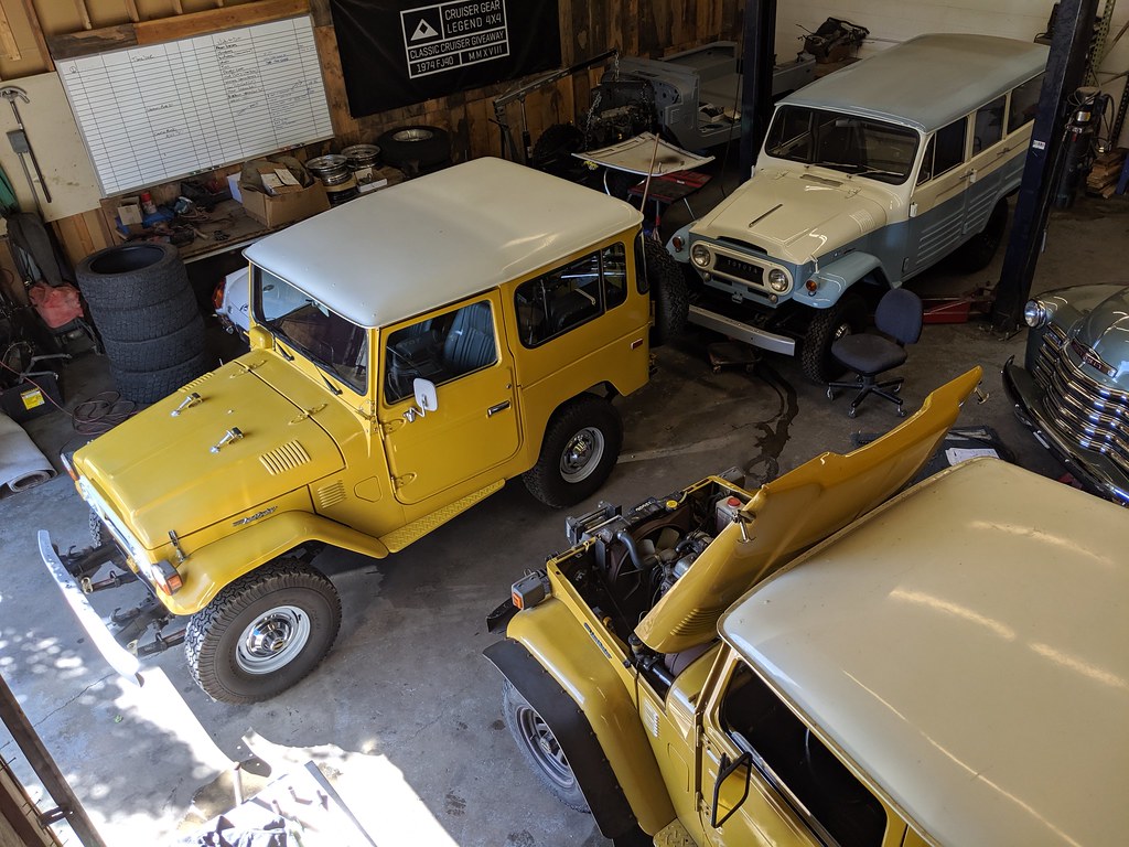

Picked her up from Legend 4x4 today. Nick took care of installing the new seat covers I bought from @aatlasx about 10 years ago. We put all new foam in too. They look and feel great. Drove around a bunch in the Salt Lake heat and was disappointed to find that I still have a stalling issue at idle when hot. I'll be calling State Automotive tomorrow to have them look at it again.

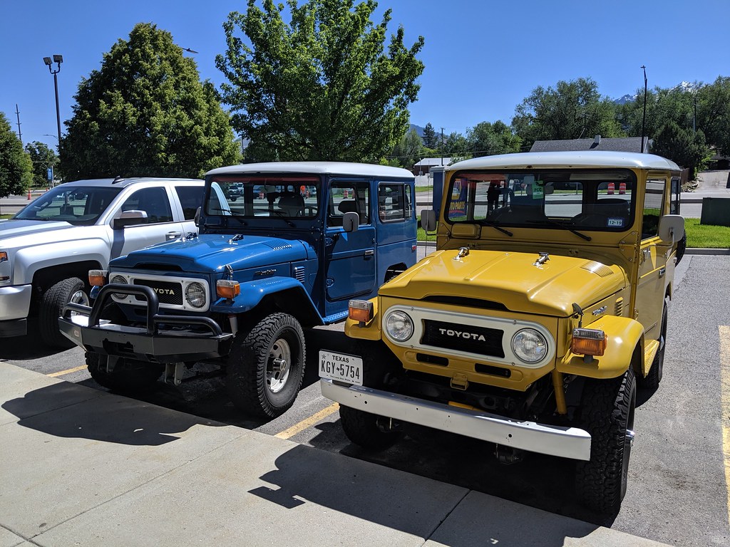

I met up with TexanFJ40 it was fun comparing our two rides. I seem to recall the carb cooling fan was disconnected. Not sure if that’s still the case but if the cooling fan is still not working that could be causing a vapor lock when hot.
