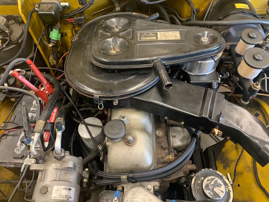

This led to the EFI solution and it was a toss up between the Holly Sniper or the FiTech. The shop I choose had experience with Holly so that sealed the deal.

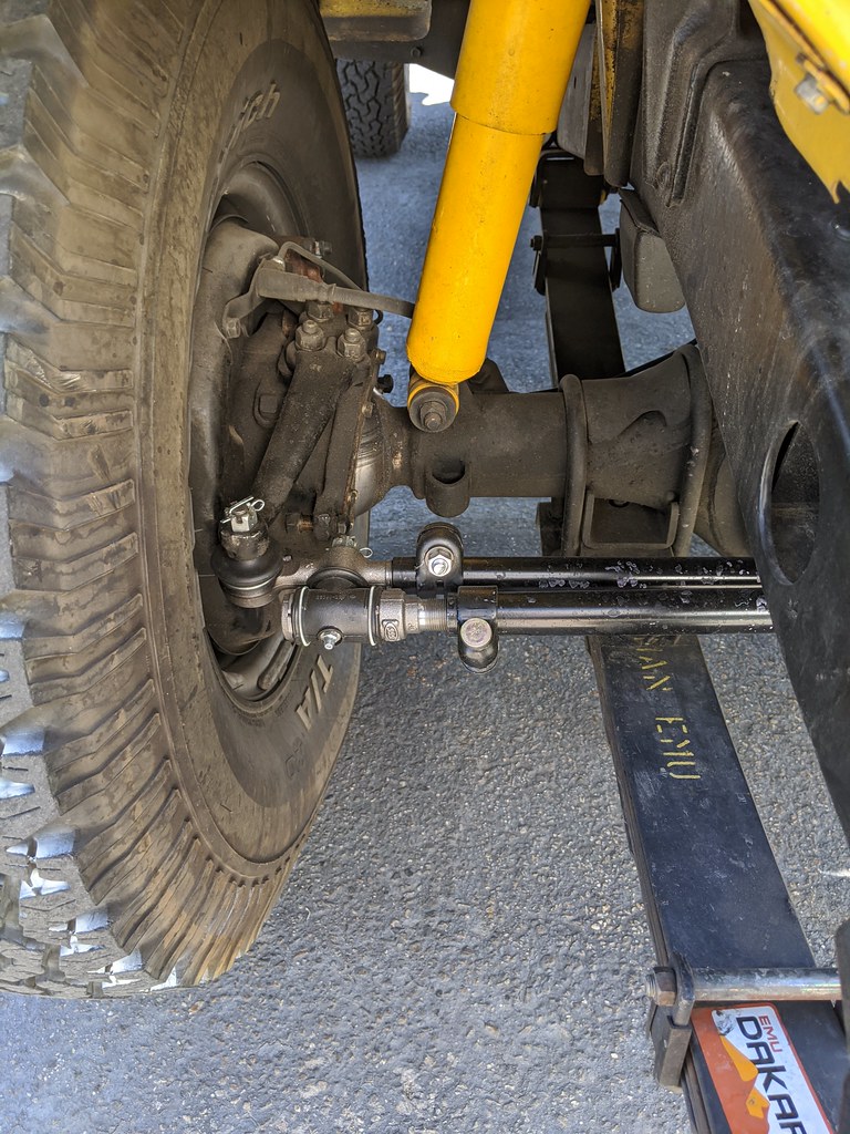

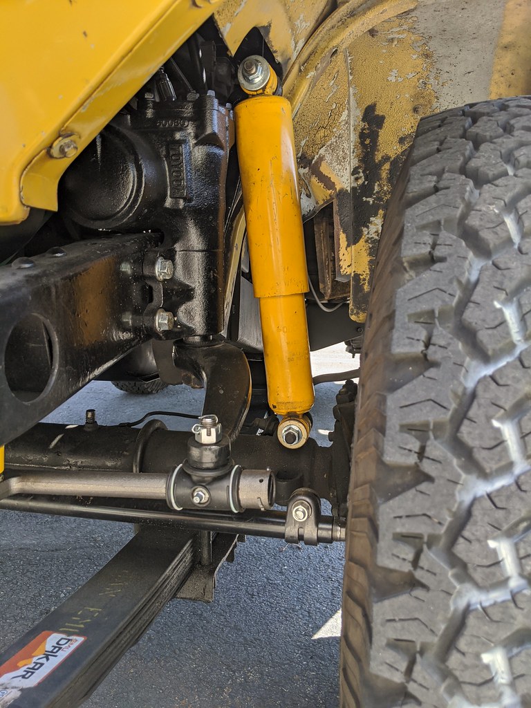

I also decided the only way to fix the CCOT hacked-up-power-steering system was to rip it out and do it right. Right or wrong, I decided the "right" way to go was to do the FJ60 route after seeing several rigs with that conversion.

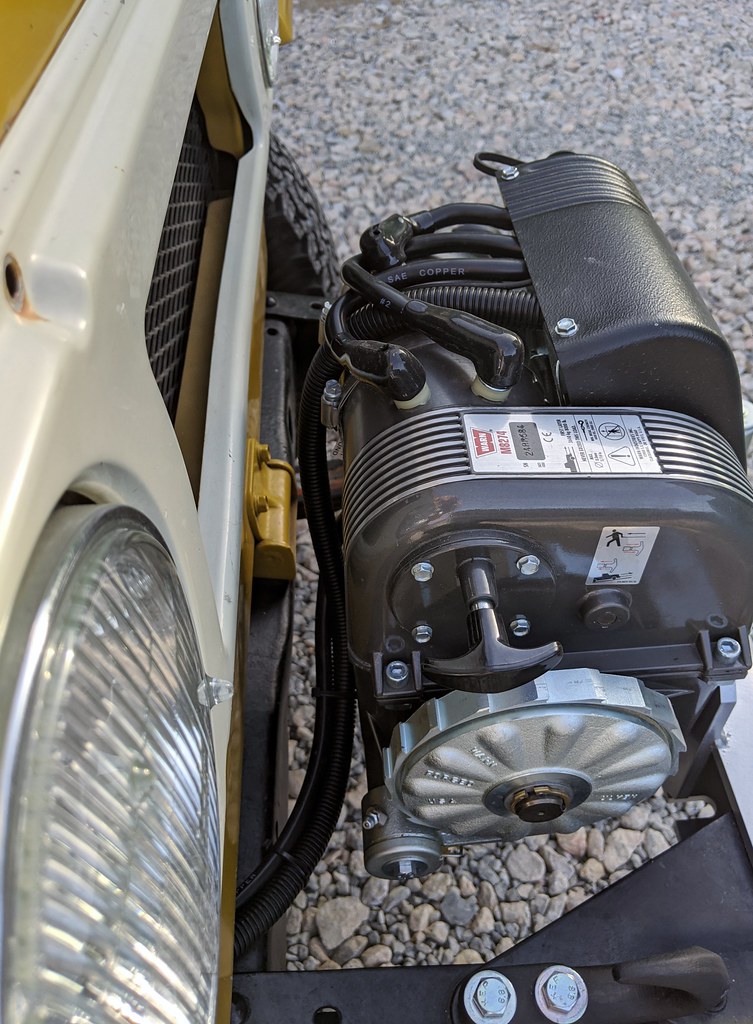

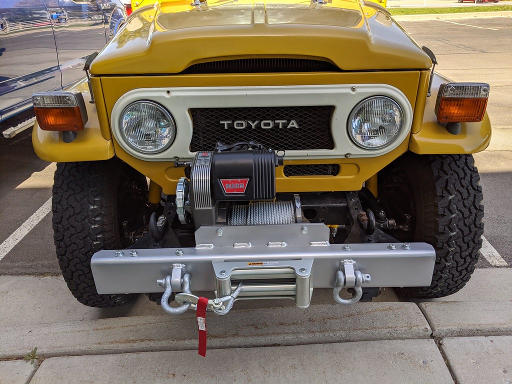

Finally, because I plan on actually adventuring out into the Utah wilderness now, I wanted SOME recovery options, so I decided to add a winch.
  • Holly Sniper 2300 EFI - Replaces carb; self contained and looks almost-factory once installed.
  • Mosley motor in tank fuel pump weld in ring
  • TRE in-tank fuel pump
  • Red Horse black anodized A/N fittings
  • Reed Horse -6 black braided high pressure fuel line
  • Mosley motor aluminum factory air cleaner adapter
  • Red Line Cruisers throttle cable bracket
  • Steering box rebuild seal kit form Cruiser Outfitters
  • Steering pump rebuild seal kit for Cruiser Outfitters

  • Ssteering shaft- made in house with Borgison 36 spline joint at box keyed joint from fj40 at top end
  • Column bearing kit from cruiser outfitters
  • Fittings for box made at House of Hose
  • All steering joints are 555 from Cruiser Outfitters
  • Steering tubes are OEM fj40/fj60 mix

  • Warn 8274 winch

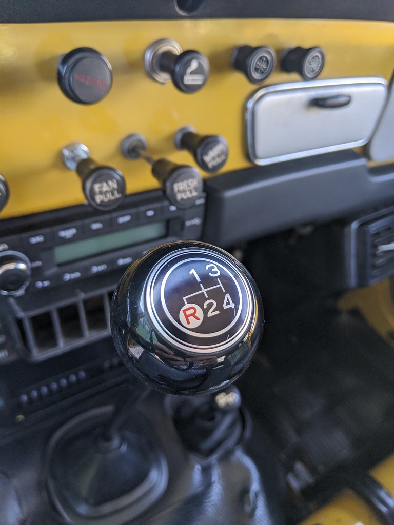

  • Adjusted shifter to not be so far forward (I had previously adjusted it too far after installing the center console ages ago).

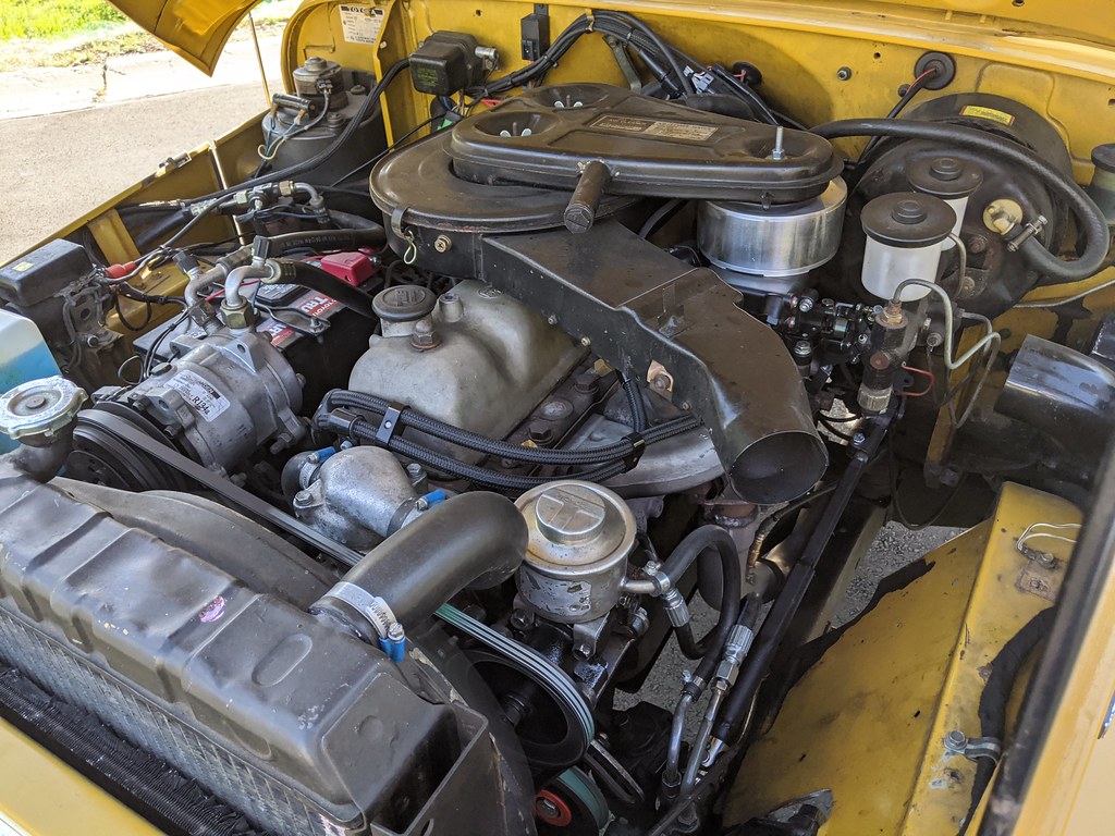

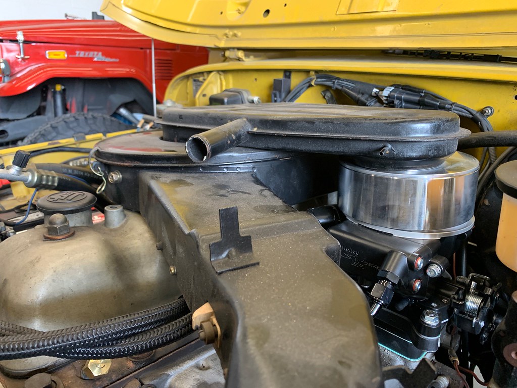

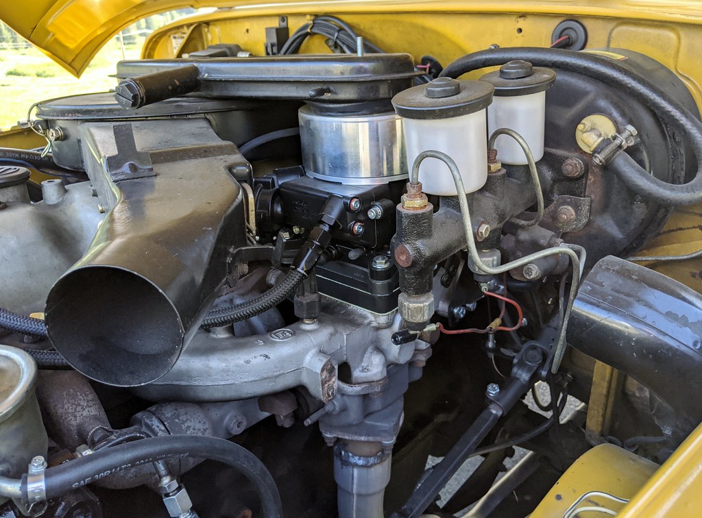

Gotta see under the hood!!

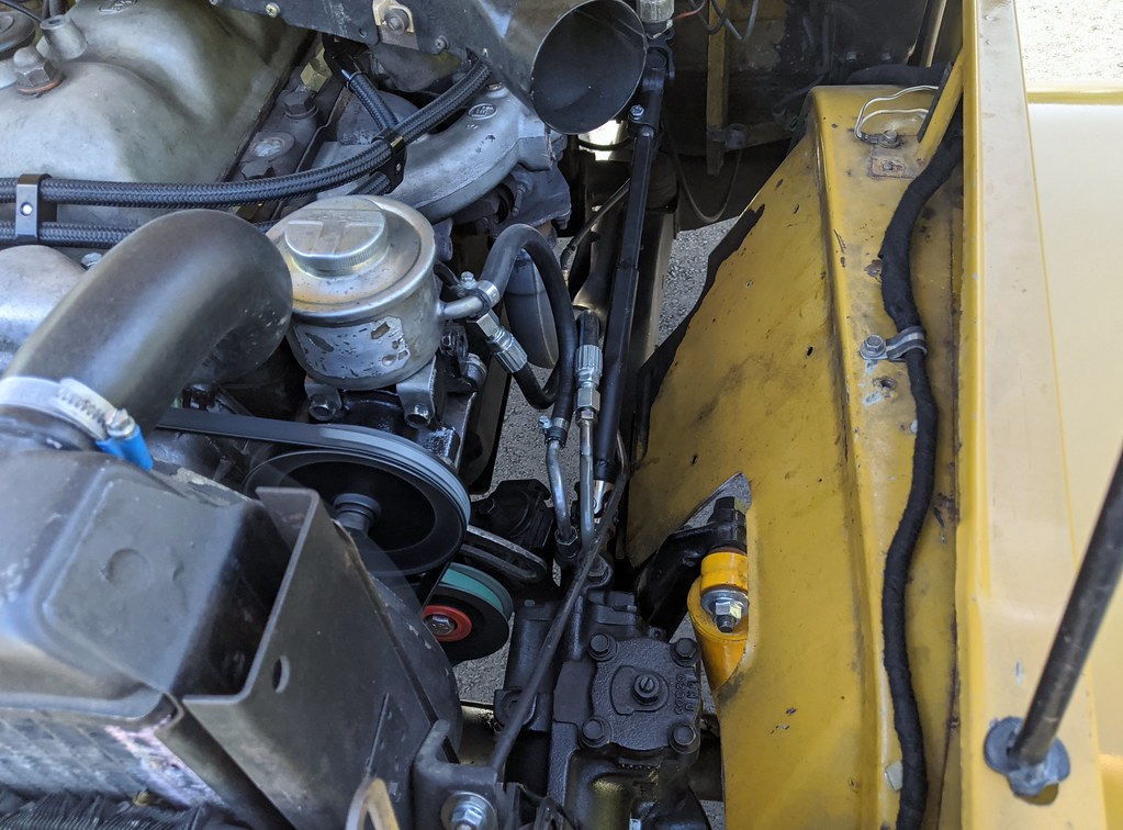

I'll take and post more pics for sure. But scroll up and you'll see what it basically looks like with the EFI in there.
Gorgeous rig sir, yes under the hood pics please👍 I am considering the Sniper on the ‘76

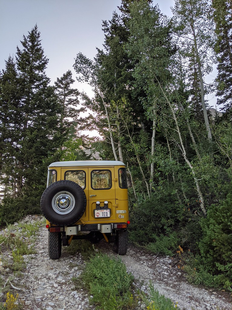

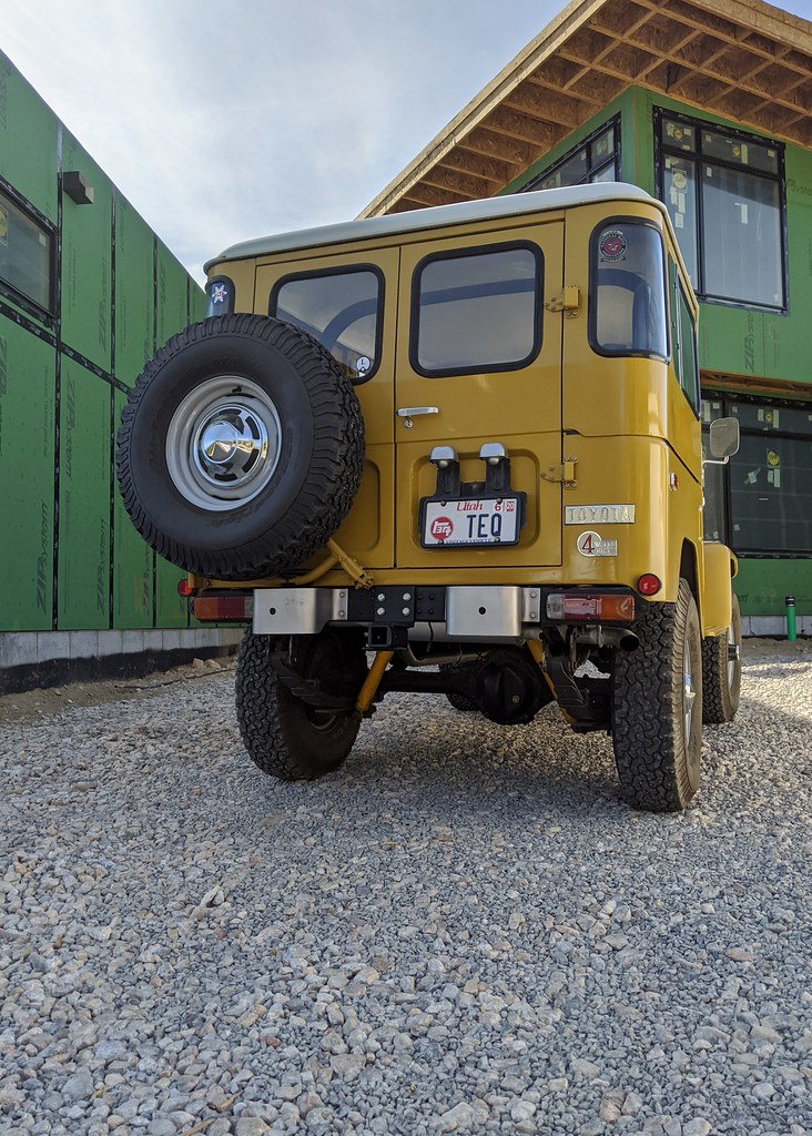

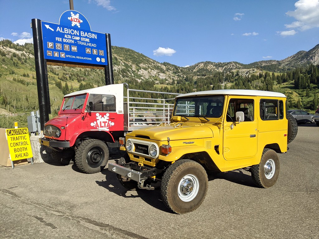

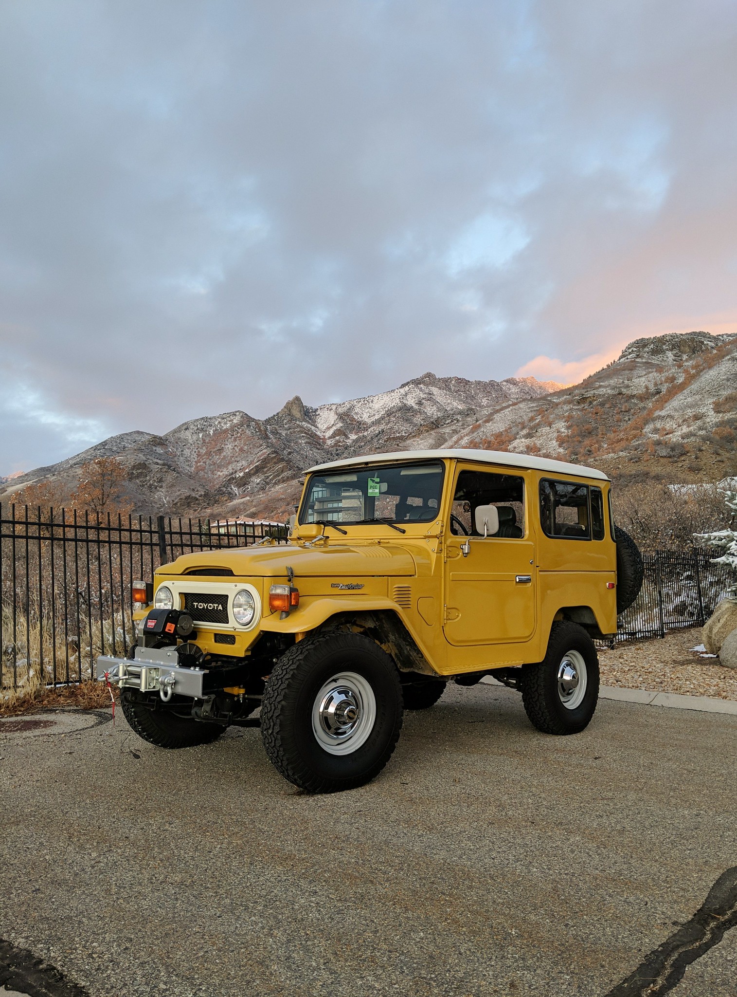

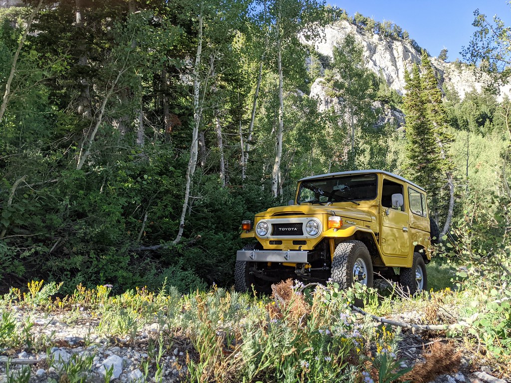

Yesterday afternoon I had one of the most fun "shakedown drives" ever.
I wanted to exercise the rig at altitude, ensure it worked well in traffic, and see if I could get off road a little. I succeeded on all fronts.

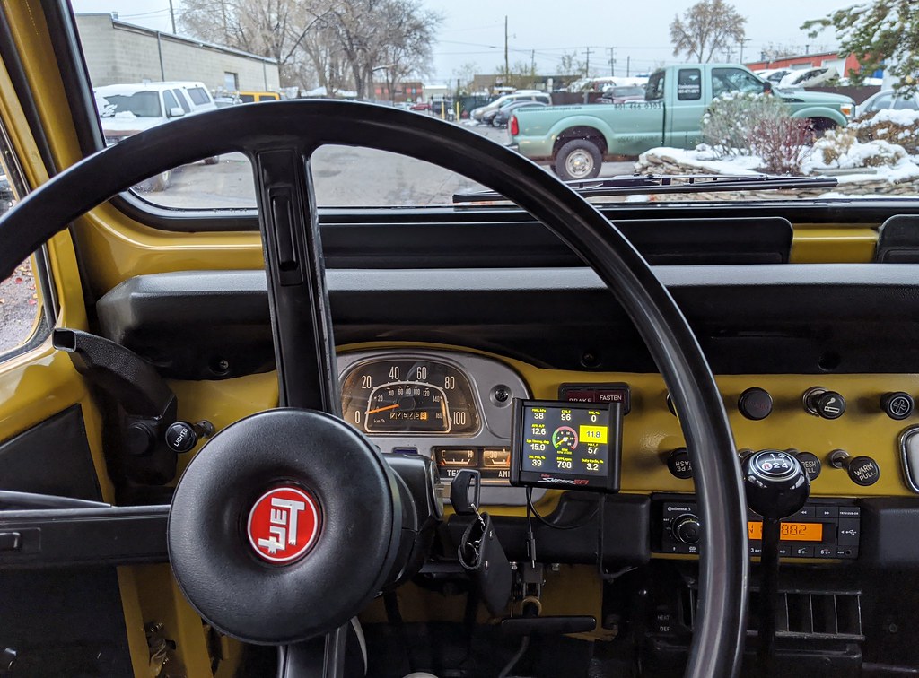

She drove great. I have a minor punch list of things to fix, but so far I'm very pleased with the investments I've made upgrading both the steering and engine. The Sniper 2300 EFI is still in learning mode and I'm not sure it's quite right yet (a little rich), but I had no issues driving up to Alta. Once up there I saw the sheriff and asked if he knew of a trail I could go on to quickly shake her down off road and take some pics. He said "follow me!". Yes!
Here's some pics for y'all to enjoy and comment on.

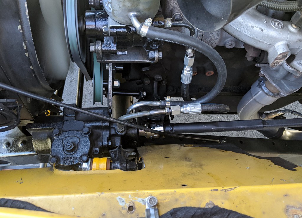

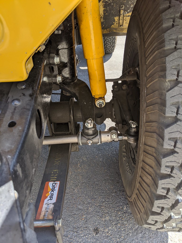

Tell me more about the FJ60 PS conversion. I have factory PS and it is very sloppy. Trying to figure out the issue.
I'm no expert. And I didn't do the work, so I can only speak in generalities. Perhaps someone can point to a thread with more details?

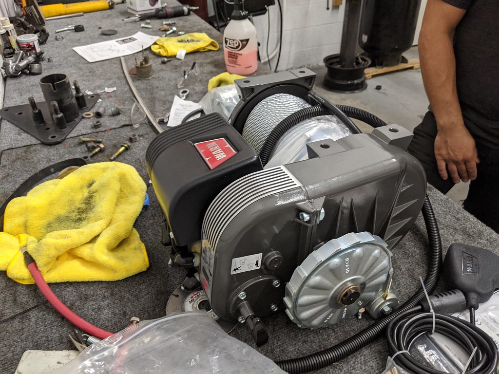

She's back (again). For the past two weeks the shop has been tackling a healthy punch list:

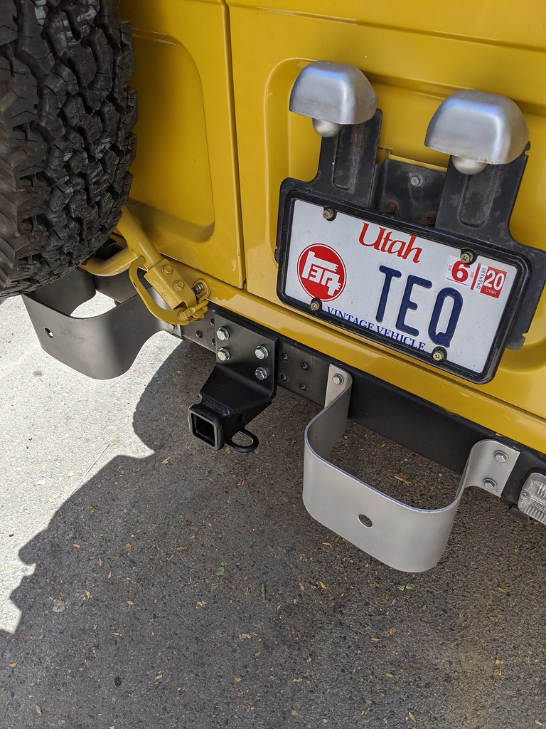

  • Add Rear hitch receiver

  • Install Warn 8274 winch

I picked her up yesterday and drove hard. Hard enough to cause one of the speakers to break from it's (lame) mounting. Tee-hee.
Found a few more issues that I'll really need to address before I can declare this phase complete, but none are major (fuel gauge stopped working, heater fan inop). I'm loving driving her around (and looking back after parking).

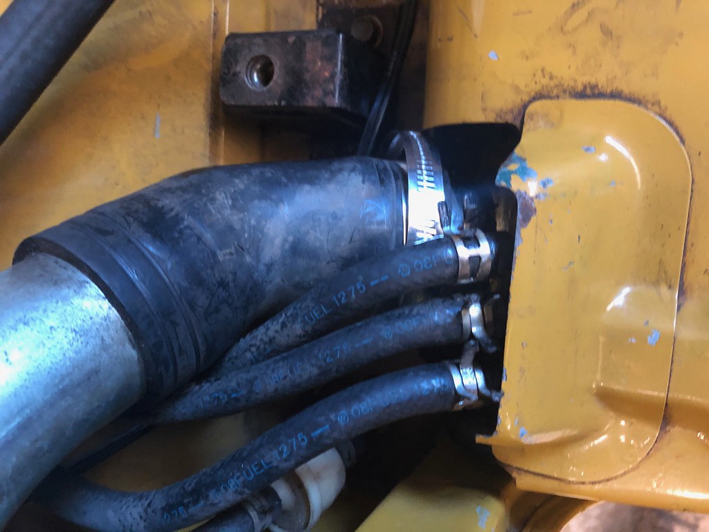

  • Really fixed fuel smell? - Changed out check valve, re-did fuel hoses (all vent lines with new clamps), fixed cracked plug on fuel tank line, removed the VSV valve from between canister and manifold, swapped vacuum line from charcoal canister from throttle body to correct port on intake housing.

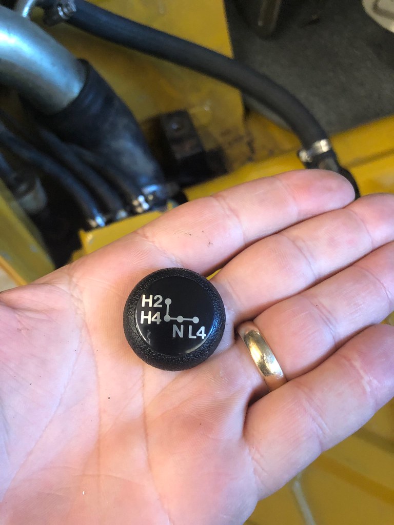

  • Found and reattached cap for transfer case knob.

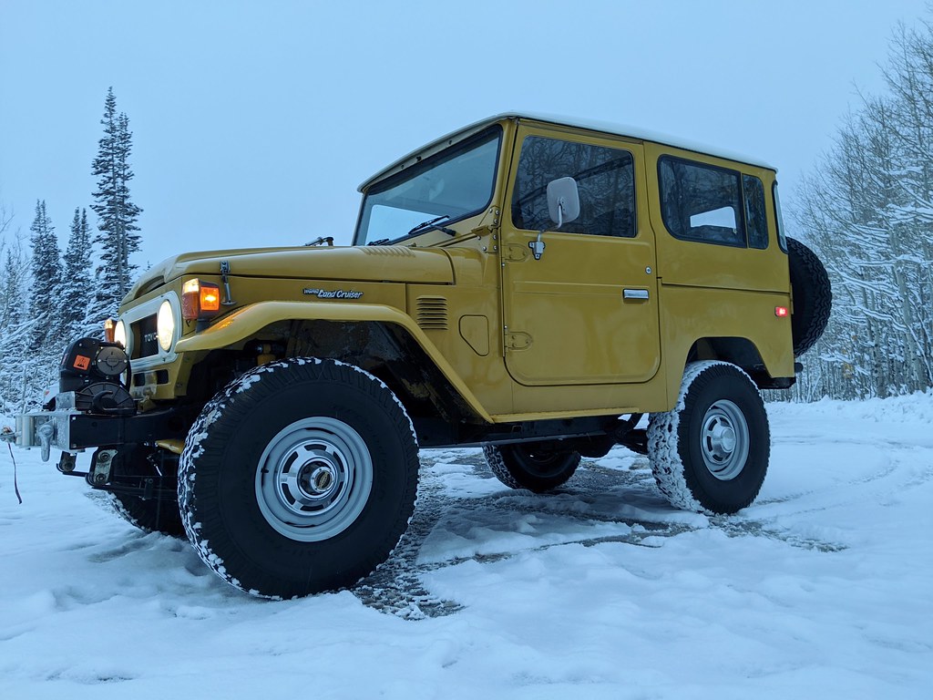

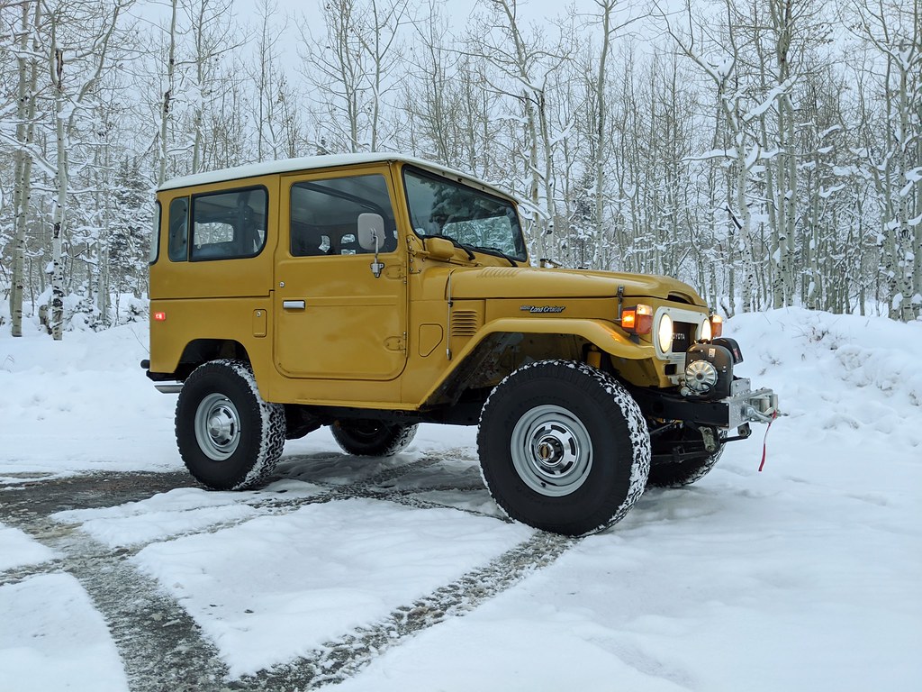

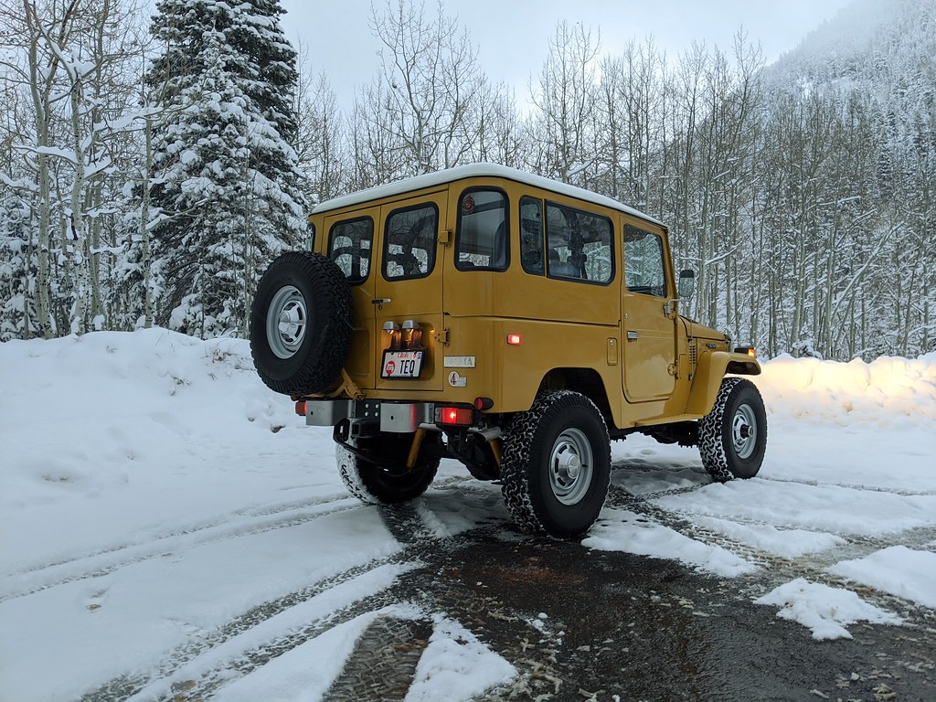

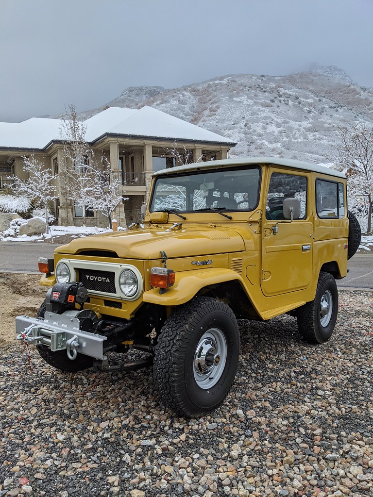

On Tuesday I went for a drive up Little Cottonwood Canyon because it was snowing. I've actually never driven this rig in the snow and was a little nervous about the tires since they've been on her since 2007. They were fine. I know technically they are too old, but they show no signs of rot and only have about 6,000 miles on them. Plus, I understand you can't actually buy 33x9.5x15 BFG ATs anymore and I love the tall/skinny look! The weather provided for some pretty good photos; too bad I didn't have a 'real' camera.
The shop damaged the left front fender previously and had it repainted. The paint does not match. They've agreed to fix it correctly and I'm going to have the rust on the passenger door fixed and it repainted because it just needs to be done. I will drop her back off at the shop Friday...
Pretty safe to say Uglina likes Utah. And I like having her back. I'm excited about being able to wrench on her myself in a few months when the house is done and we're out of the apartment.

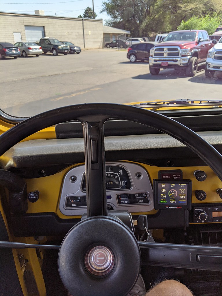

  • Figure out a different mount for the Holly Sniper LCD; that's where my phone goes.

I'd like to see/hear more about that active charcoal vent setup.
Have you done the Koito headlight upgrade?
I don't fully understand the charcoal vent setup myself, so I can't really help there yet. That's one of the most frustrating things about having to use a checkbook wrench!
