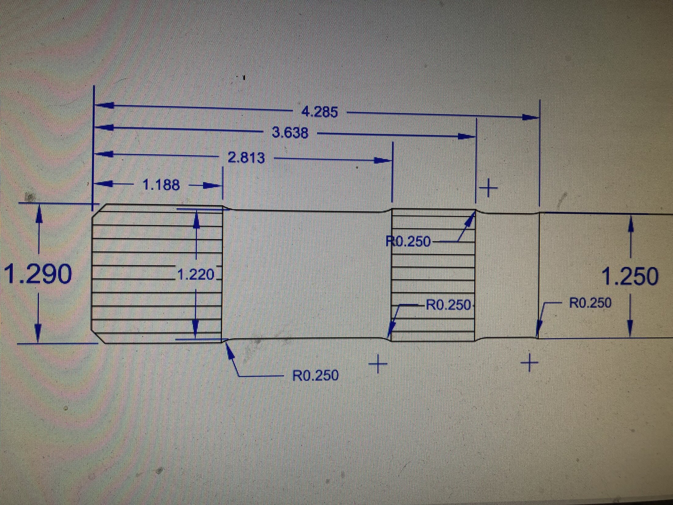

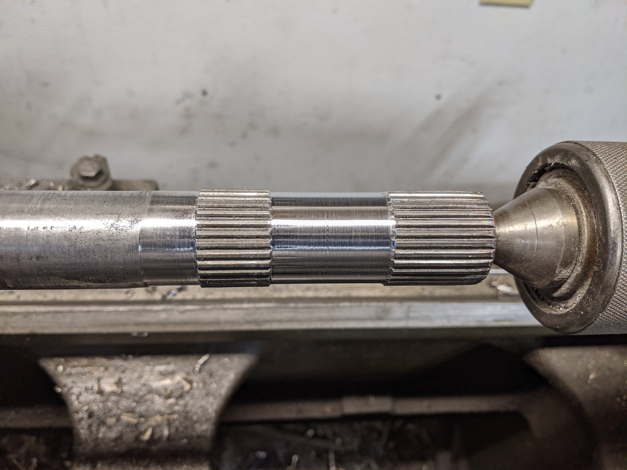

Any of y'all have experience twisting the splines on a 9.5 locker and not being able to get the shaft out? I've heard people talk about it, and have heard of trimming the shaft to avoid it, but just looking to see if anyone has experience with it happening.
My buddies and I have a trip to Moab planned for next September and I'm tentatively planning to take my 80 since the 40 needs an absolute boat load of work to make it worth hauling across the country and I'm in the middle of house shopping and moving states and have vehicles everywhere. I have e locker axles I plan to swap under the 80 and I plan to go through them before install. And was considering trimming the shaft.
Trimming the elocker shaft is not the solution to that problem. Machining the splines out of the middle of the shaft is. Like this.
If the long spline twists while locked, you're screwed. Gotta cut the housing apart to get to the shaft, to cut that apart, so you can get it out.
Johnny is correct as usual. I think this is a good mod to do, especially for a place like Moab with lots of traction. I did this mod to my 80 prior to a Moab trip a couple of years ago, and I highly recommend it. Just to be clear, this mod is for the rear passenger side axle shaft.

Some more info on the subject of turning down the axle splines:
Thank you for the clarification!

You dont really have much to worry about then, if you arent going to wheel it hard with huge tires. But since you have the axle loose and want to stay with the oem elocker then it may he worth following landtanks guide for piece of mind.
