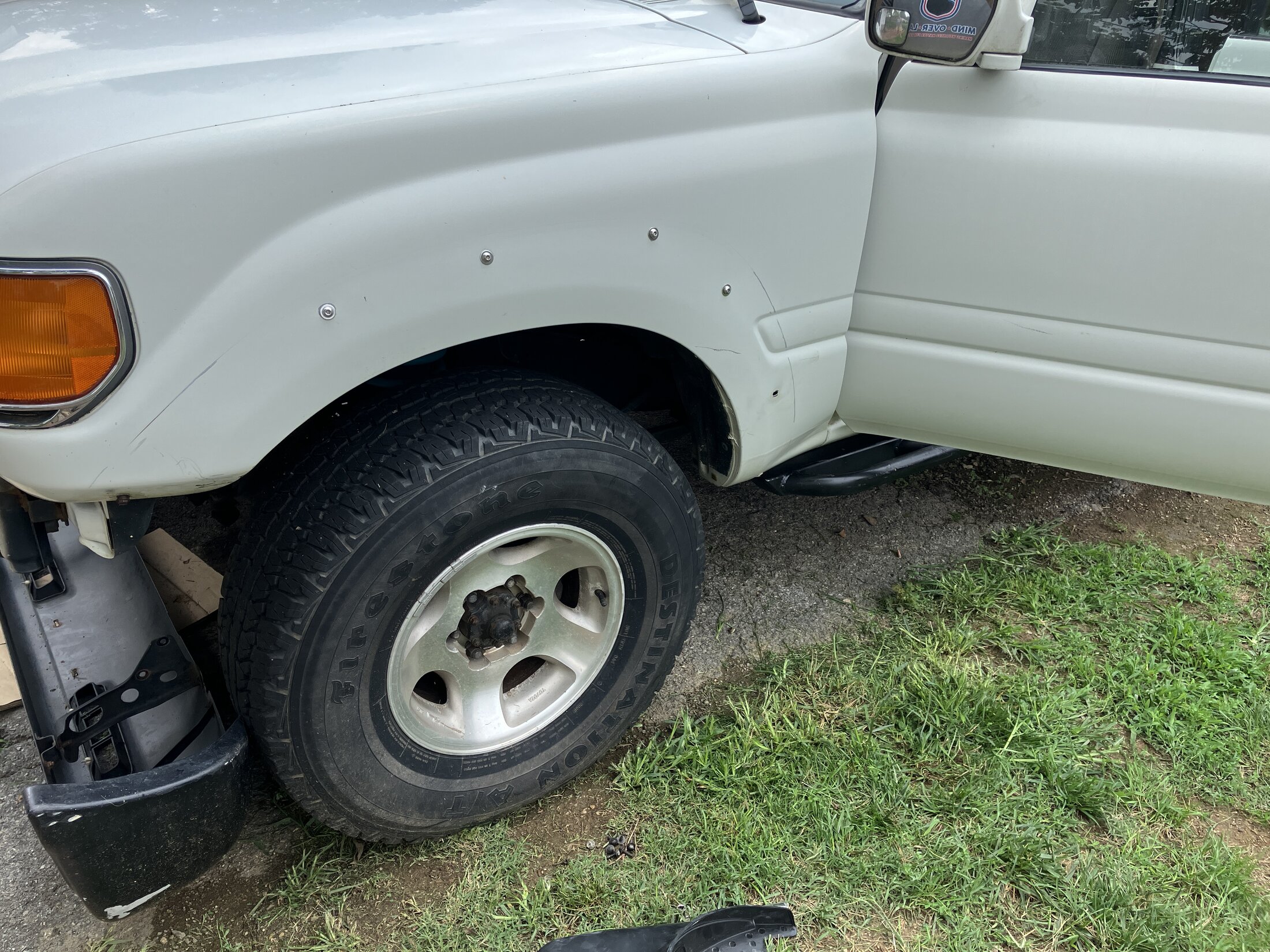

Eventually put all this in one spot but for now it’s here. Front mud flaps made fir an earlier cruiser. Boom!! Always liked OEM where possible so the front bumper donated to me by @Axe55 (I think) a few years back was massaged yesterday to loose a little gurth. Planning on the harbor freight winch plate and integration into the stockish bumper soon enough along with recovery points poking through the front eventually.

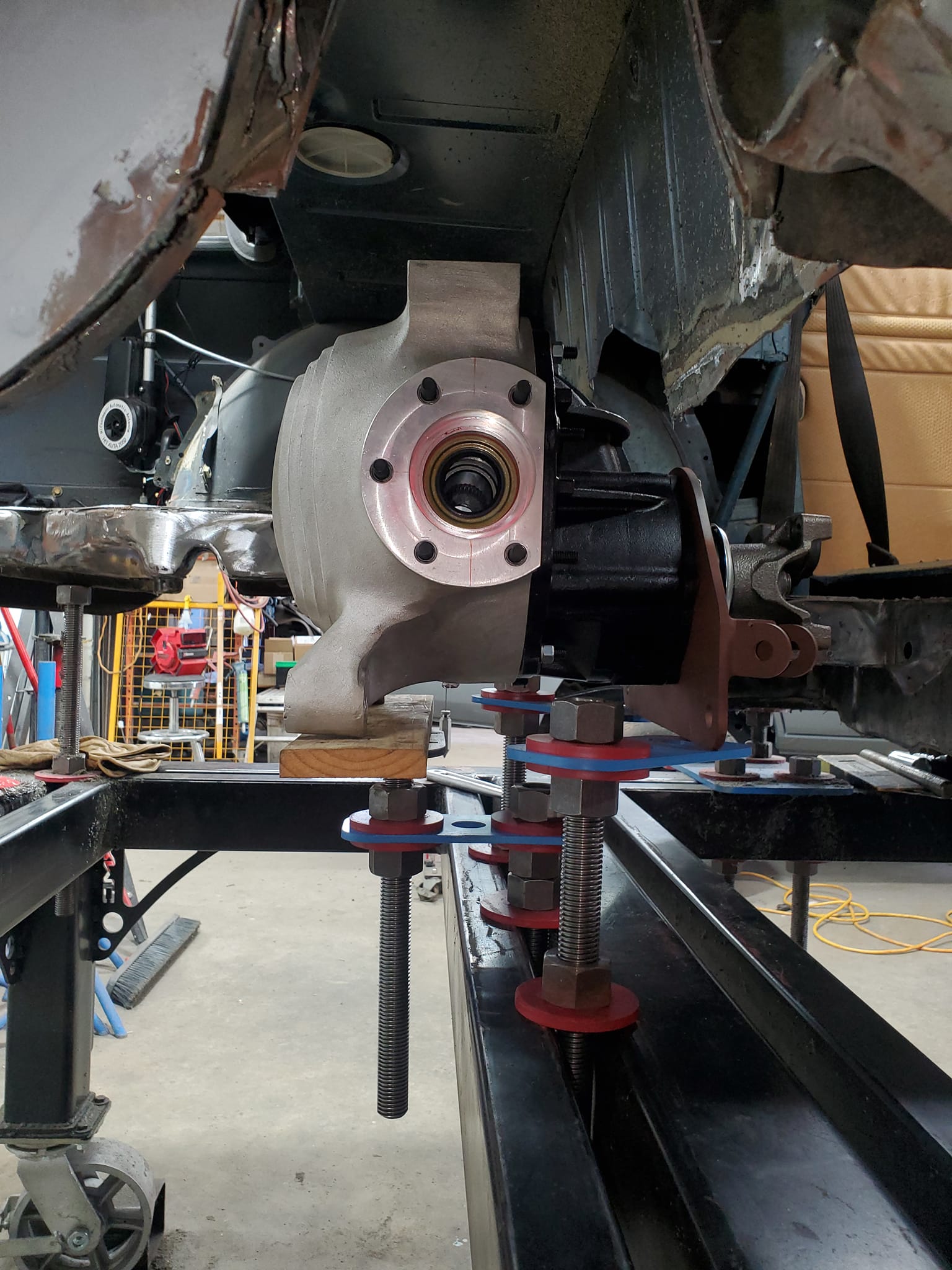

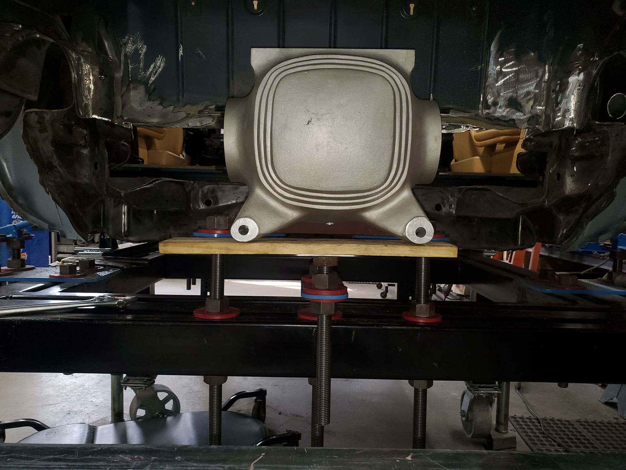

A little non cruiser wrenching. Setting up the center chunk in the Mercedes to check out the upper frame member location. Trunk is cut out to the frame rails. I'll be adding a frame rail just behind the chunk to replace the one I removed. Also adding what amounts to half a C notch above where I cut out for the upper links.

I am looking forward to getting this running. I imagine this truck is going to be a hand full. Just a thing of beauty sitting there.
I'm using the same front drive assembly on the Mercedes, sans the blower. Not interested in a hole in the hood.
