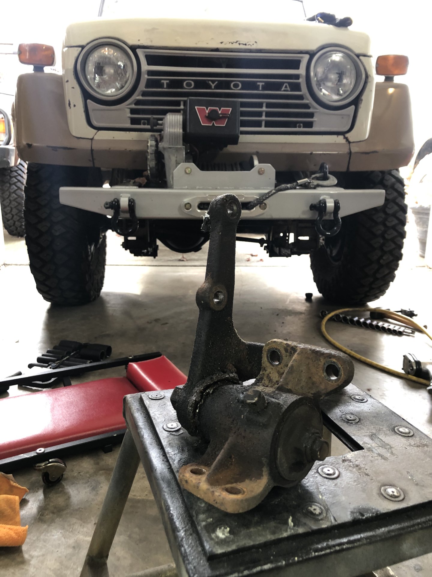

This week’s wrenching: FZJ80 oil pump cover seal, FJ55 center arm rebuild and square bezel 40 wall art.
