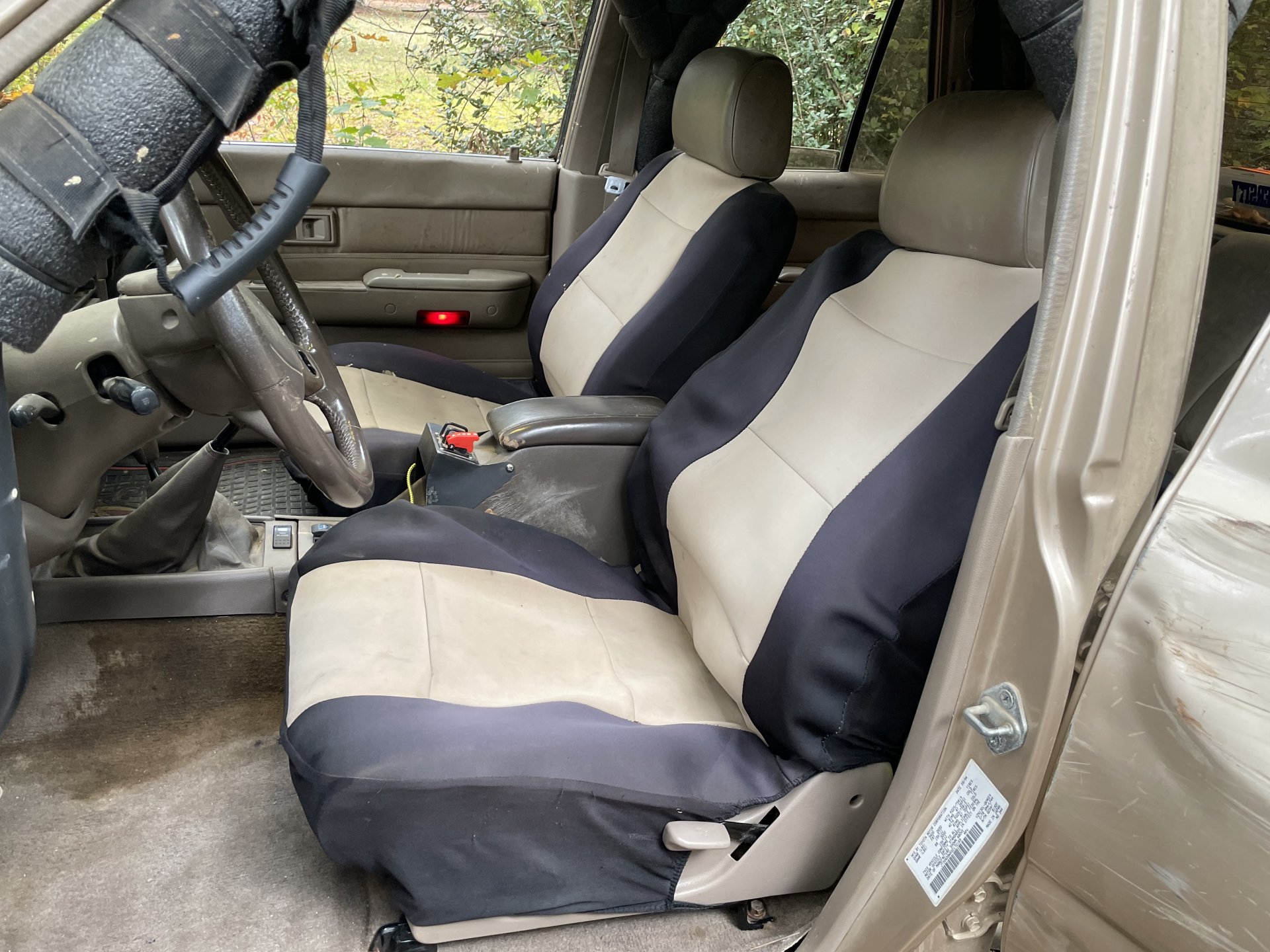

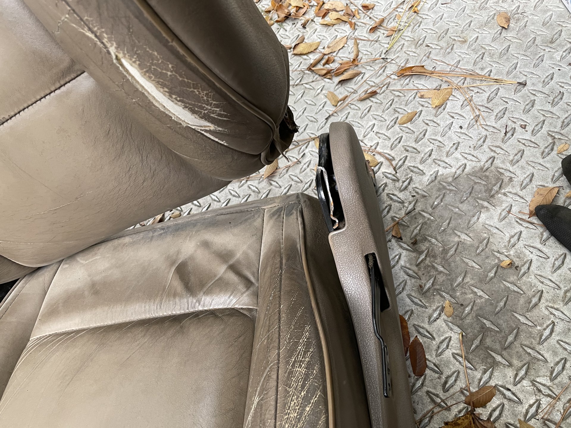

Almost made it 200k miles on the original driver’s seat, and a good few of those were rough miles.
Out with the old, in with the new….ish. Ok, so the “new” is technically a year older than the “old”, but let’s just keep that between you and me.
Gotta love breaking your damn SEAT in the first few hundred yards of wheelin’ for the day.
The new one is cloth instead of leather, so I thought about buying the other seat, but my passenger side seat is in pretty good shape, and besides…..you can’t really tell the difference between them with the seat covers on anyway.

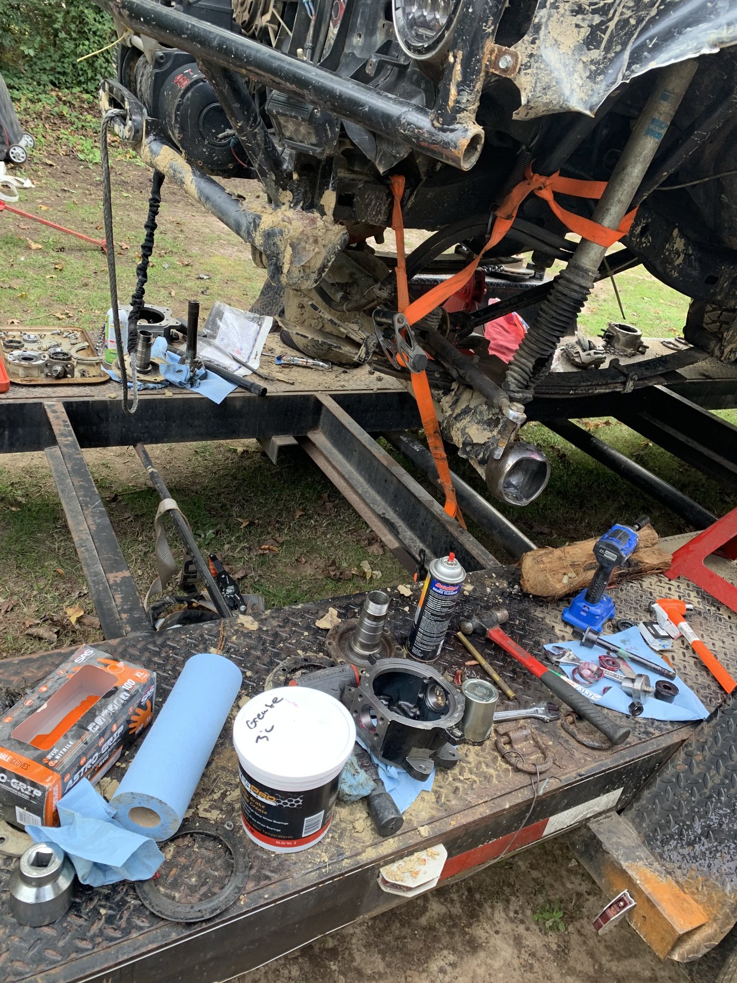

Thanks to Johny and Ryan for coming by to help me out with the new 6 shooter knuckles and front axle rebuild.
Also, thanks to Eric for letting me use his hydraulic press and drill press to press in the trunion bearing elimination kit on the new knuckles.
Missing the two outer C clips and one control arm knuckles stud but we got 99% of it done.
It’s on all four tires but got too dark to take a picture.
Still sitting in jack stands because I have to drill out one knuckle to put the new calipers on so will have to pull the tires off again but I’m very happy with the amount of work we accomplished today.

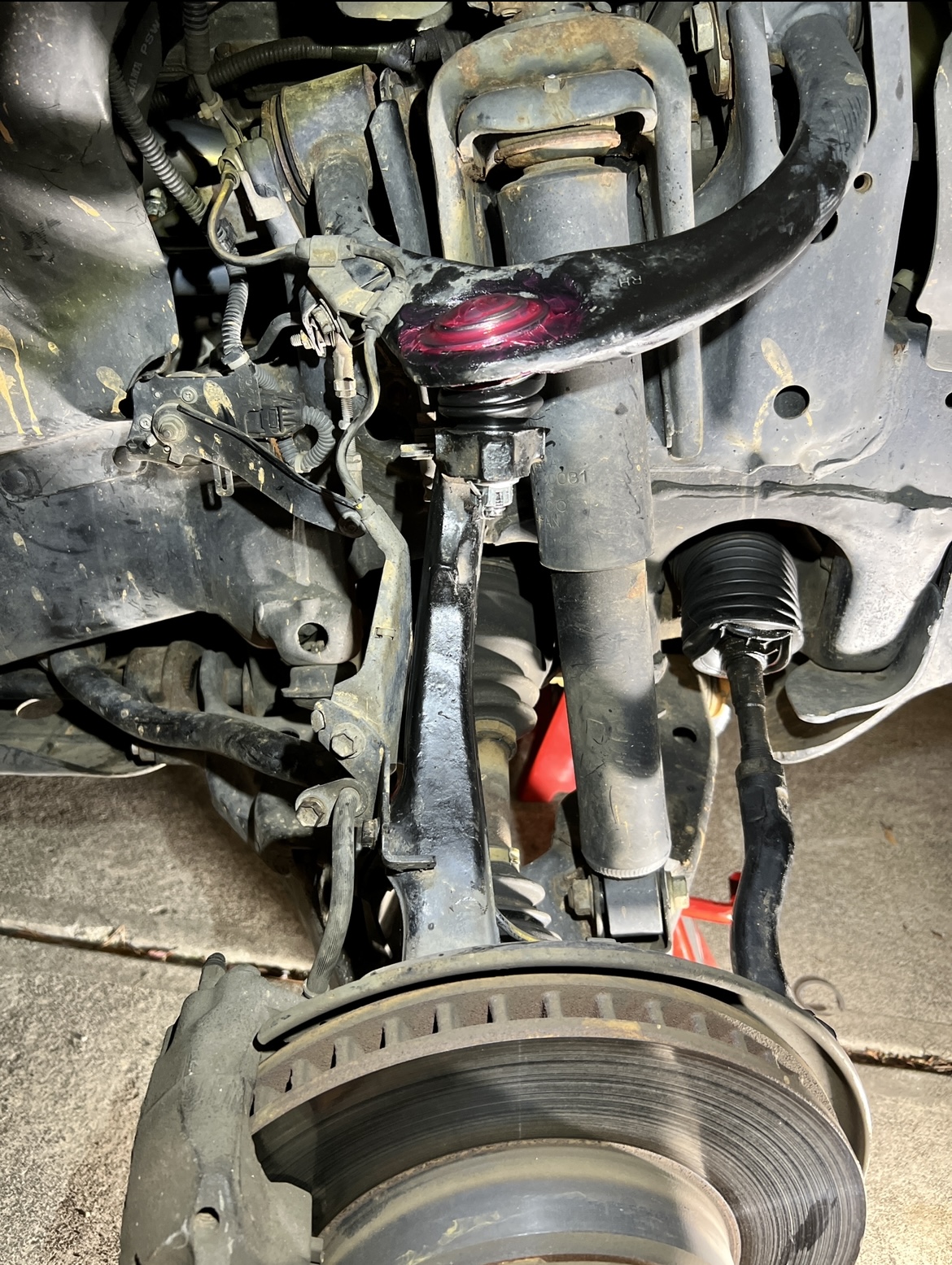

Did the front ball joints today. I got the wrong kit from Advance auto that only had longer ball joint press cups so that made it interesting. Mcguyvered the one side with it and then went and got the correct kit for the other side. New ball joints and my clicking noise is gone! Next up are tie rods. Also cleaned up the engine bay from Uwharrie and gave the whole truck a bath.
View attachment 2835677View attachment 2835678
Great work!! I've got to do our '11 GX soon
