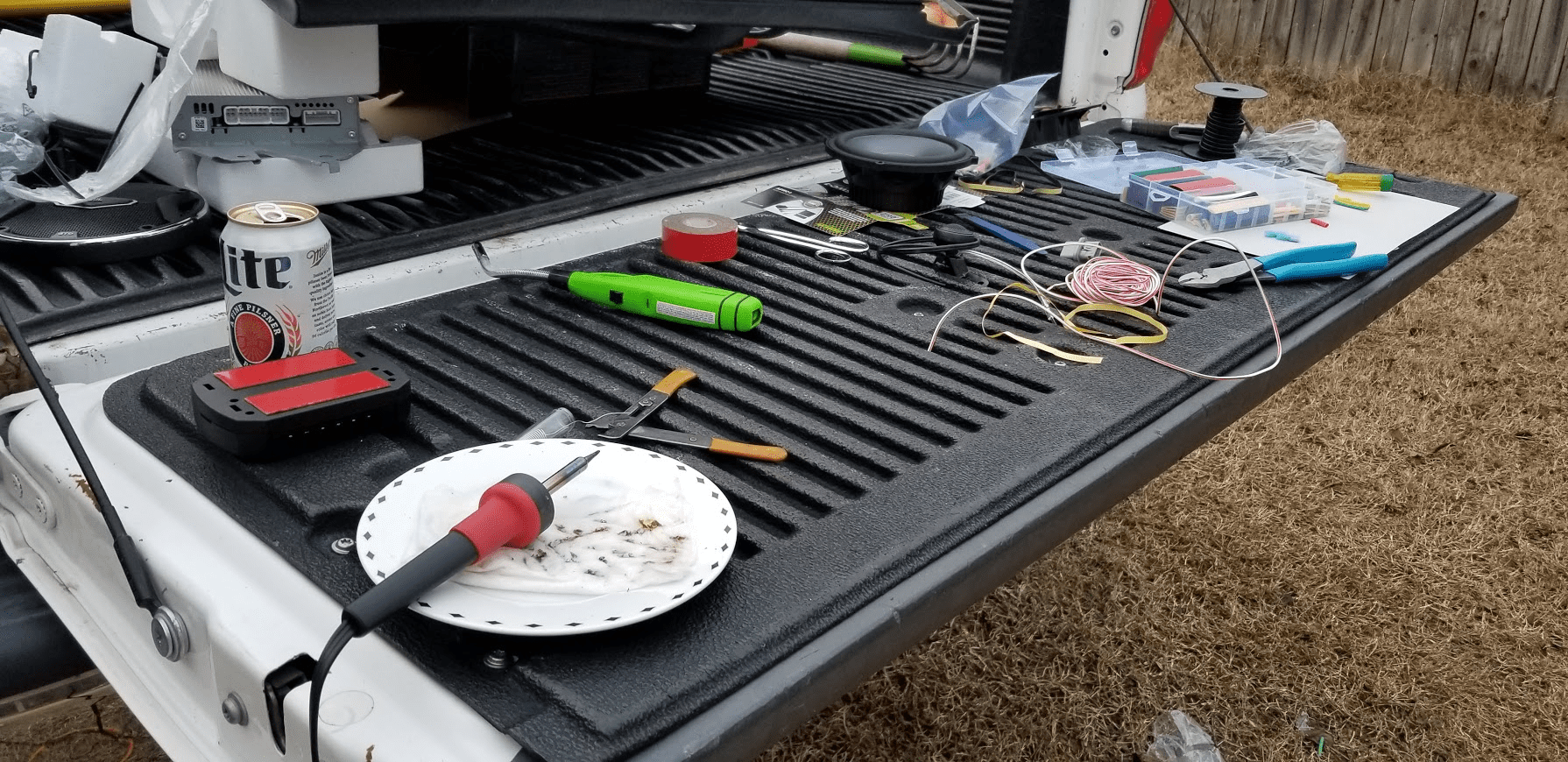

The Tundra got all new speakers, steering wheel controls, and factory amp bypass. When we purchased the truck, the stereo was shot and the tweeters buzzed loudly. The truck came with the upgraded JBL Premium audio system. Yeah it might have been awesome in 2006 but in 2019 the front speaker surrounds were shot and the back speakers didn't work. After several days of building a giant bird's nest of wiring, the stereo is done and it sounds great.
  • Pioneer AVH-2550NEX
  • JBL GTO Components in the front and coaxials in the rear
  • Parking brake bypass installed to defeat limited menu system in the radio
I've ordered another Parkvision backup camera for the tundra but this will be an easy install.

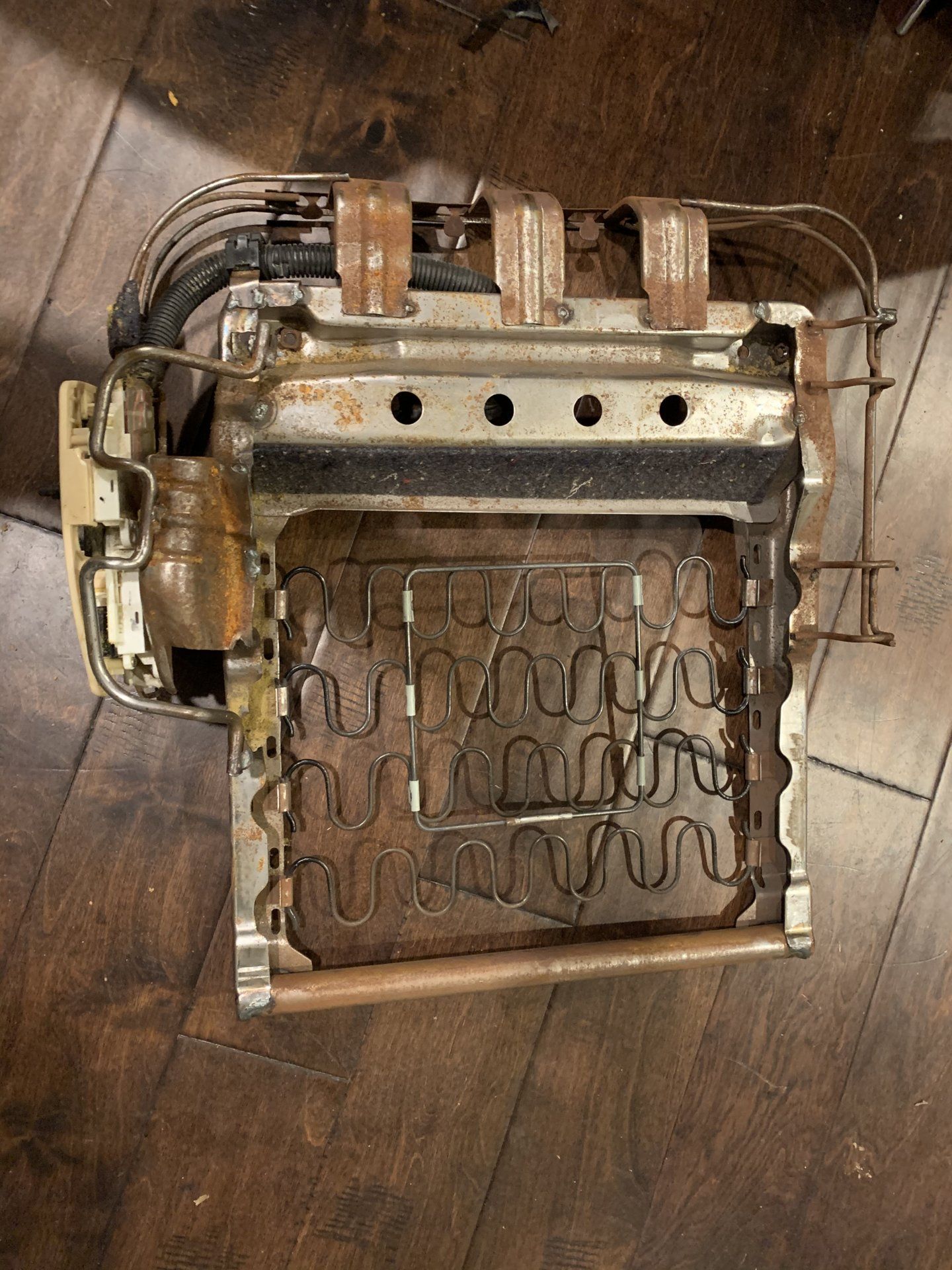

I removed the driver seat to strip it if it’s old leather and once I had it all apart I noticed the bottom foam cage was broken in 3 spots and the foam was pretty messed up in the door side.

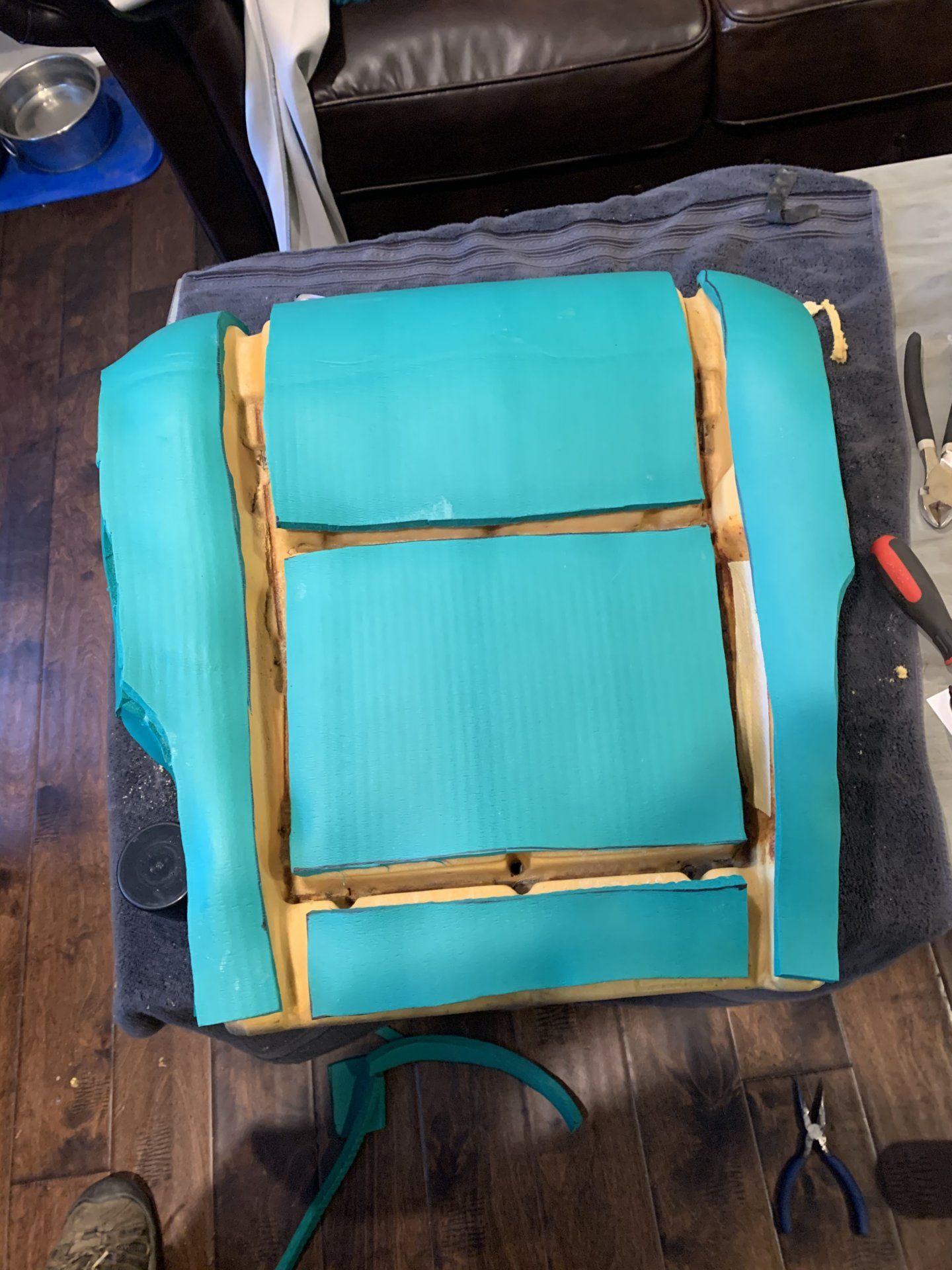

I improvised and was able to salvage the foam and the basket. I weldedand bent the basket back to its original shape and I used my wife’s yoga mat to reinforce the foam. This def made the new leather much tighter and gave the bottom half of the seat a much firmer feel.
Not very easy to see but the left side is bent and broken it was barely hanging on. Welded it, cleaned the surface rust, and painted it.
Here is how I reinforce the stock foam with 1/2

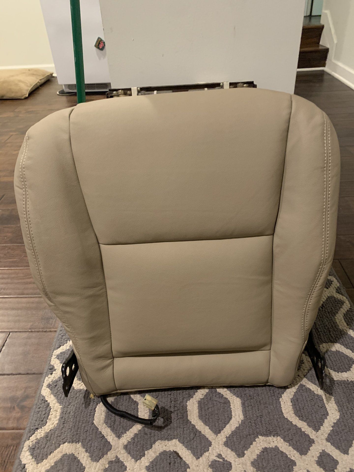

Here it is with the new leather. You can kind of see it looks a little more puffy than before. But now I don’t feel the metal on the left side and the yoga mat feels nice and firm.
looks nice, good work Del.

The guy who redid the 80 seat used carpet to reinforce the sides ,or it was going to wear through again.
if it does. Which I’m sure it will I now know that it is four bolts and three hog rings away from a quick fix. I should do add the carpet or something similar for protection agains the metal but my hands are toast from messing with the upholstery on the two seats. It will have to be done if or when it wears out again.My son will own the truck by then so maybe he will deal with it if it bothers him enough. That’s a good tip though. I wouldn’t have thought to do that.
