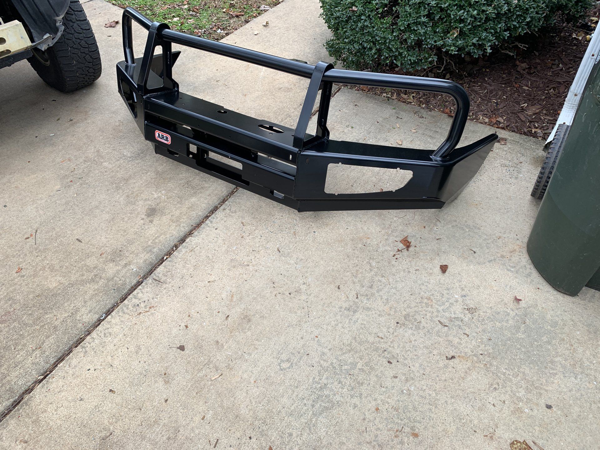

Got the arb bumper today for the Tacoma and tore right in and got everything off only to find there was no mounting hardware or brackets.... but got the new 2014 stuff on the truck and it looks a lot better now I just need the matching hood!
@WhiteTiger911 thats going to look sweet!!
Thanks man really looking forward to getting it together hoping to find a hood in the next week or so, but good news was all the lights swapped over from my old headlights plugs and all, can’t wait to get the ARB on whenever they get back to me with the brackets and see how it looks .

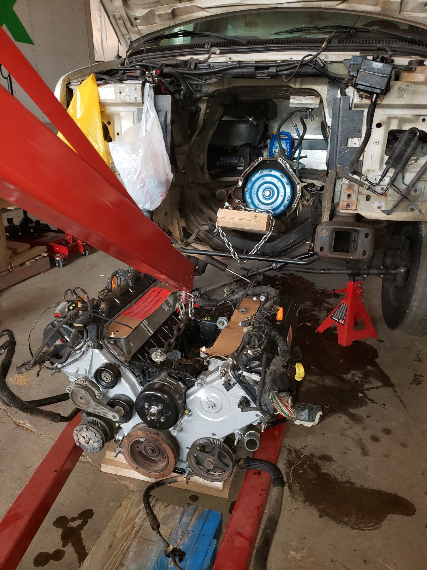

Several folks already know I took a part time job wrenching on FedEx trucks while looking for another teaching gig (which is becoming iffy since this pays better).
First assignment was an engine swap (no biggy) on a Ford (well chit) into a van (dammit to hell, really!?).
Anyway, it drove out today.

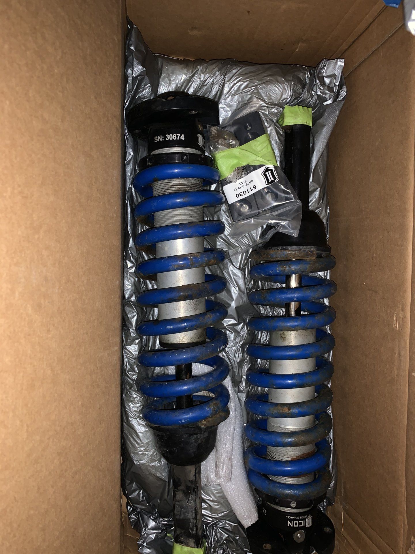

Got a little Black Friday deal for the Tacoma

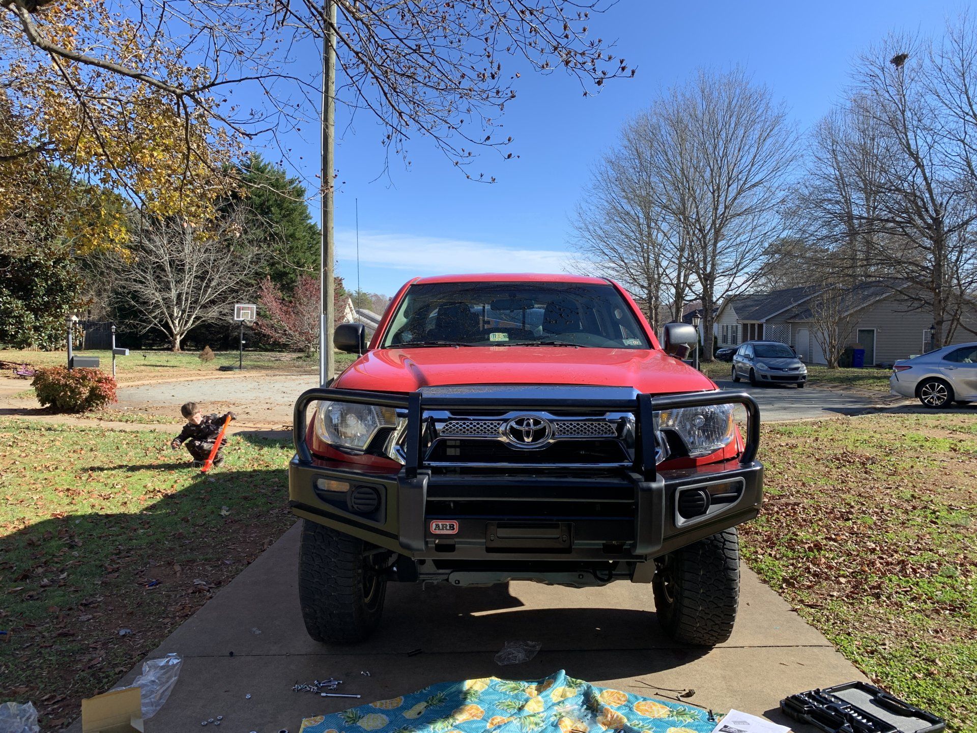

Also got the hardware so managed to get the bumper on today. As for the hood since it all closes and is the same color plus I don’t think it looks to bad so just gonna leave it as is for now. .....plus kinda bought a Black Friday TV instead of a hood. Oops
