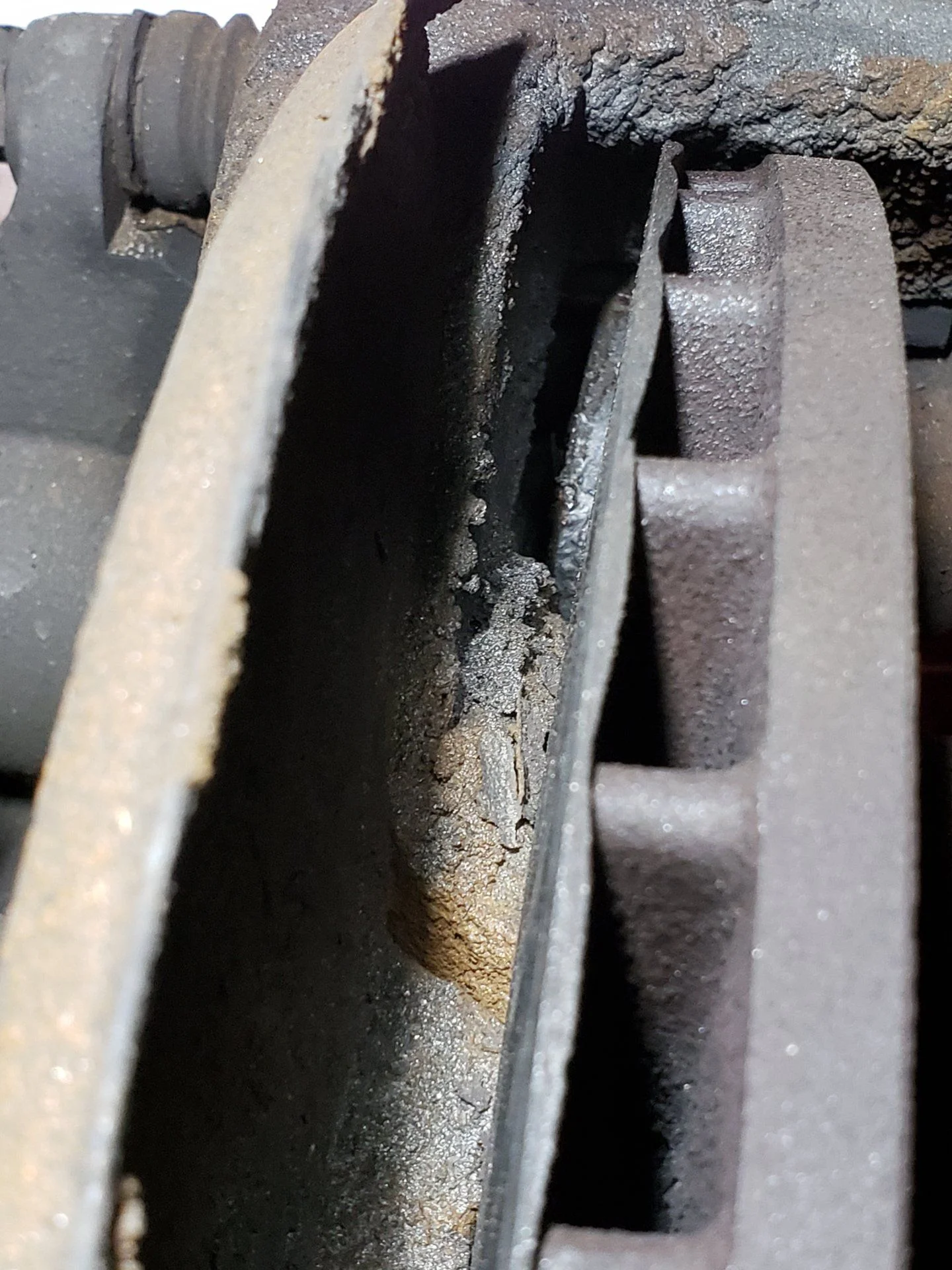

Those ridges are wear indicators. The owner must have opted for the foot massaging brake pedal.

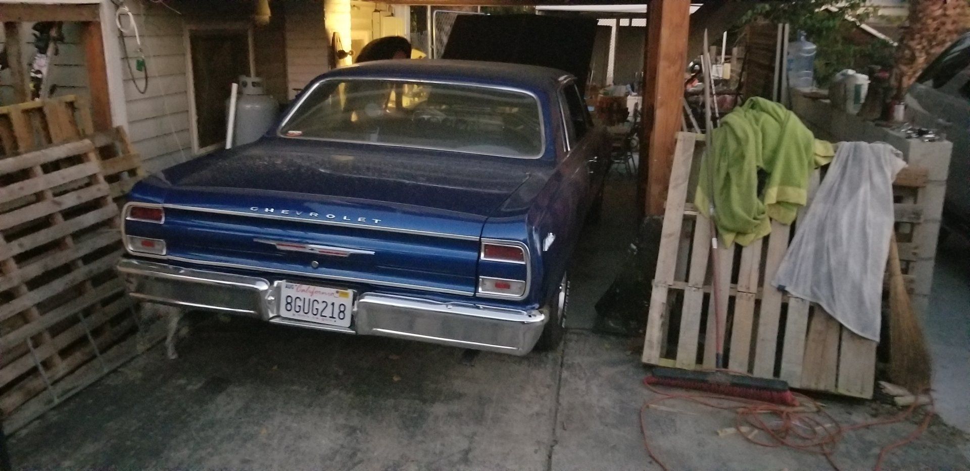

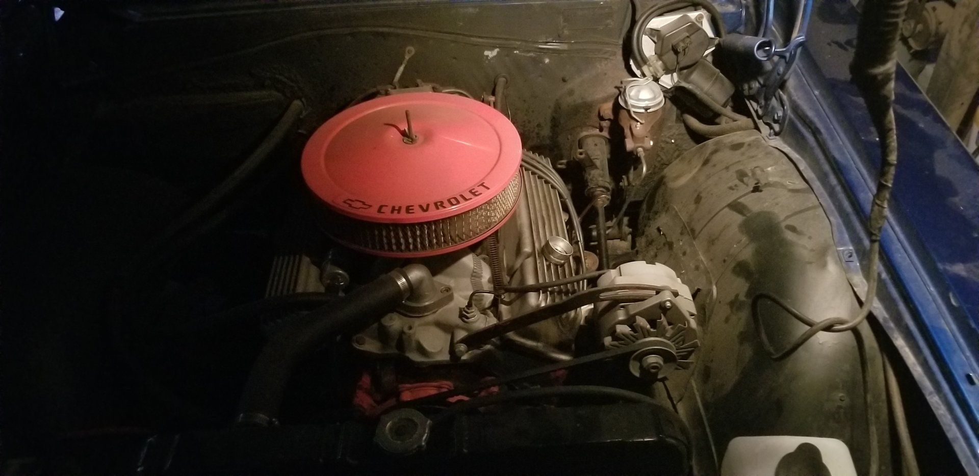

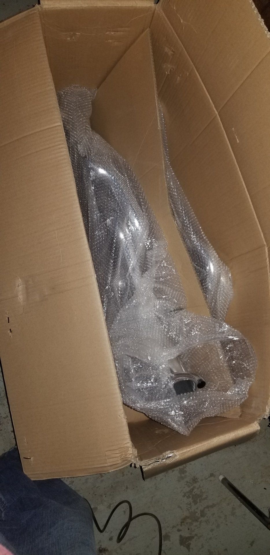

Installing long tubes on my brothers Malibu tonight
Tomorrow installing a new fuel pin on the D90 and then may take it to the OHV park to see how it changed.
forgot to update this. We got the long tubes done, but the drivers side proved to be a little more difficult and bled into the next day so we didn't touch the defender other than drive it around my brothers property. So much nicer than the 110 I sold. Panorama back glass installed.

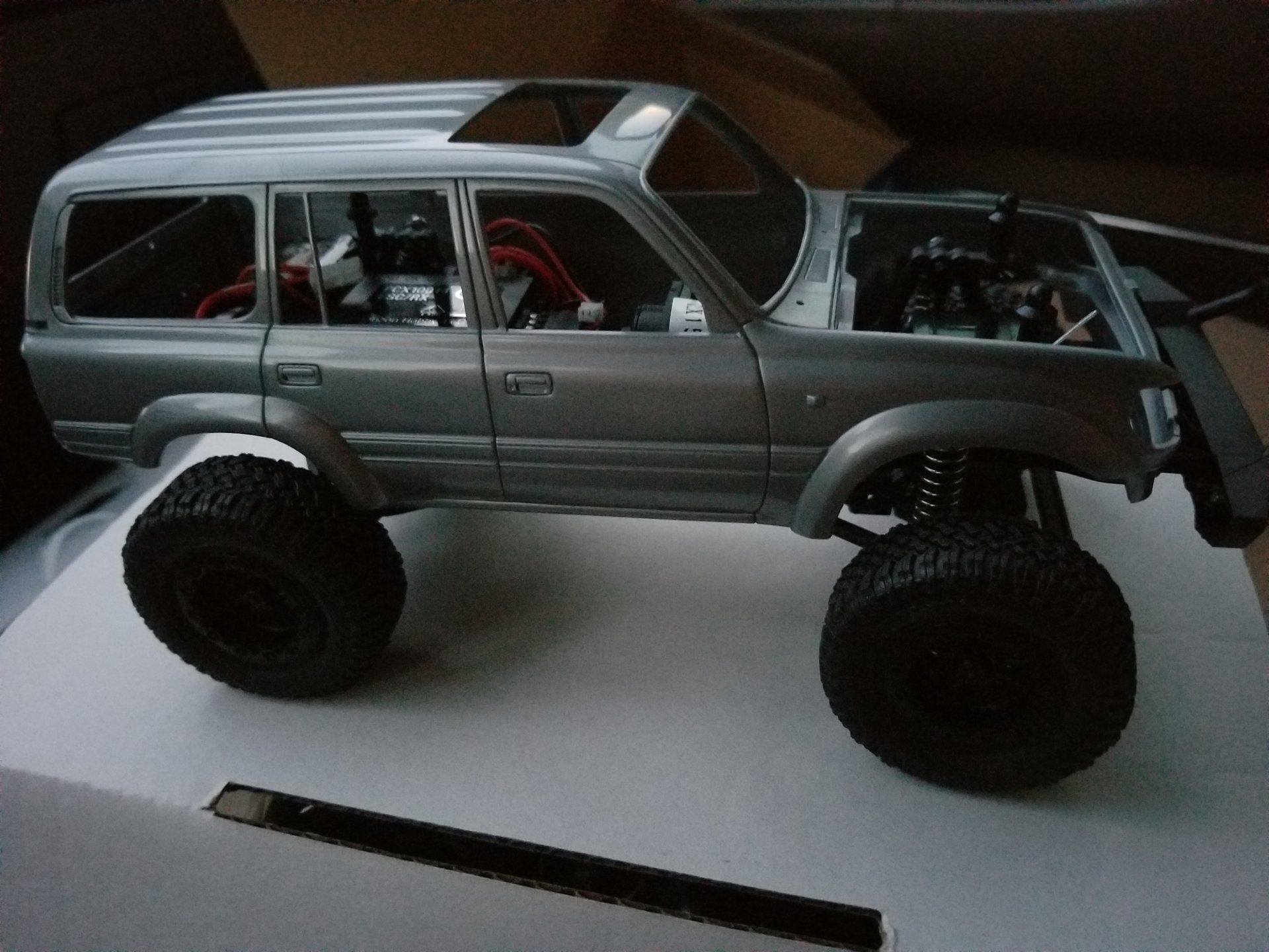

tamiya body with a micro crawler drivetrain?
I got the same body sitting on a self and the crawler in storage
yeah, tamiya 1/24 model on a 1/24 ecx barrage chassis. I'm not sure it will be worth all the mods. it needs a smaller pinion gear to run slower, the reciever/esc is bit wonky, and the axle width is too wide for more than a semi, semi scale. .
your kit is the sports model, with all the aftermarket addons that an 80 series would need. mine is the cheaper basic kit.
