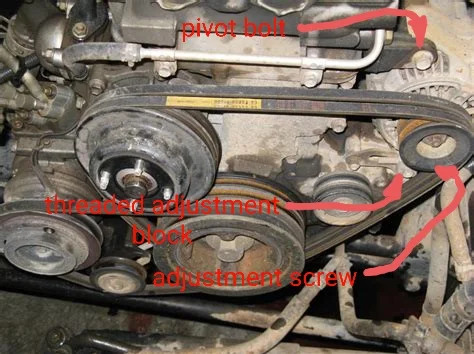

What is the pivot bolt and where is it? All instructions I can find (FSM strikes out again) say to loosen the “lock bolt” on the forward side of the bracket, and the adjustment bolt on the driver side of the alternator. Both are completely loose, alternator won’t budge.

The pivot bolt is on the top left of the alternator. Loosen that and, if it still won't budge, give the alternator a few taps to get it going.

- Slacken of the pivot bolt at the top of alternator.
- Slacken of the bolt going through the threaded adjustment block at the bottom of the alternator.
- Slacken of the adjustment screw/bolt accessed from side of the alternator.
You might need a pry bar against the frame to get the alternator to move.
Is a good idea to replace the adjustment bolt, and the threaded adjustment block.
The tend to get galled badly from being adjusted dry, and caked in dirt/grease paste. Dirty, along with a decent amount of tension on the thread trends to destroy these.

Apply copious amounts of copper anti-sieze to threads a you reinstall.

But, that pivot bolt you picture is definitely not on my alternator. Some reference above to “below” the alternator. I think I have it solved. We’re about to find out. (Maybe you have a different truck?)

Yes, the picture is from the 1FZFE

Pics of your engine may help then.
Pic above is standard for 1fz-fe. It's a typical arrangement for other Toyota engines in cruisers too
Got it, managed to fish out where it’s located as referenced in the third-ish reply. Just couldn’t wrap my nugget around which bolt could possibly be holding it fast, just couldn’t see it.
