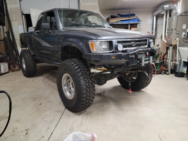

Truck ADD strikes again... '93 X-Cab SAS

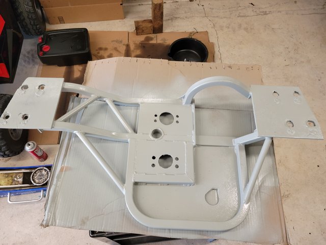

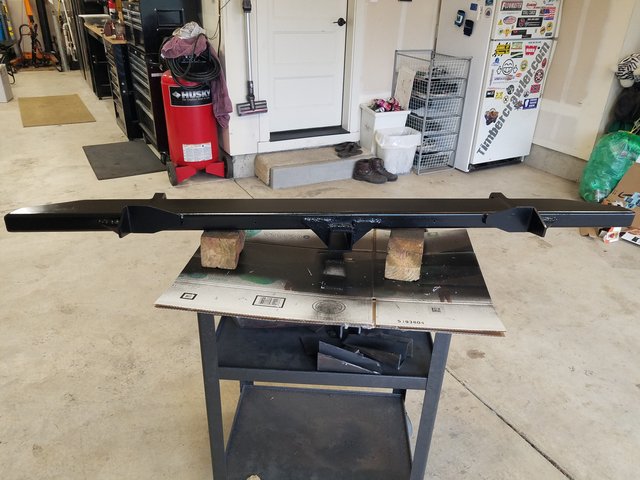

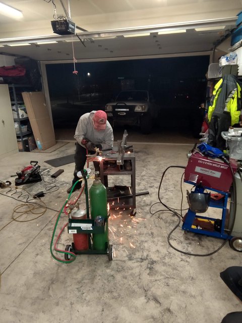

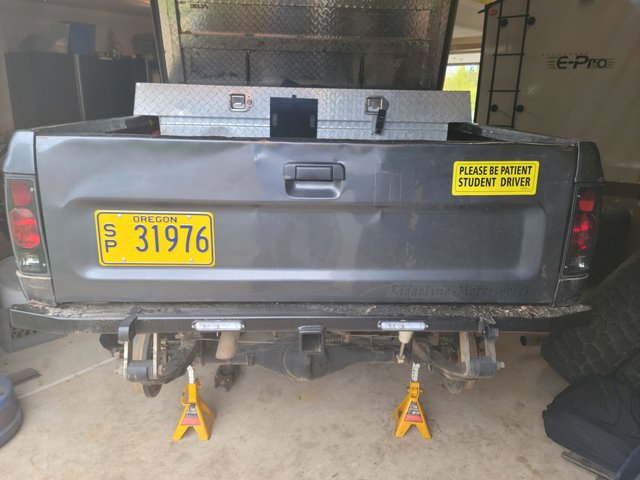

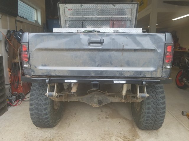

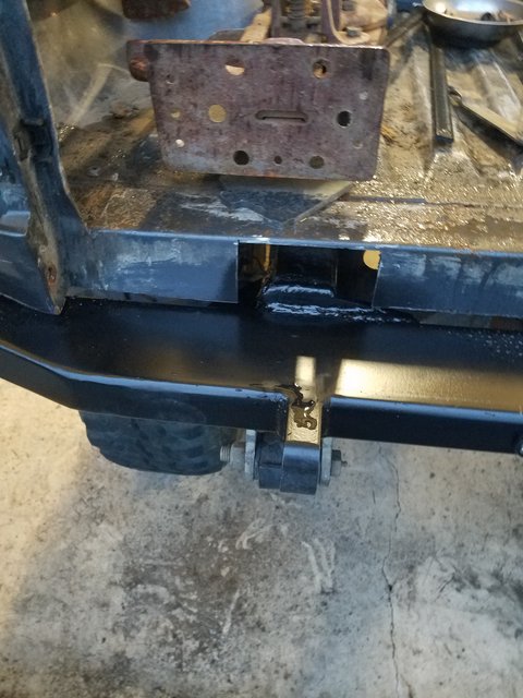

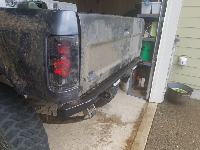

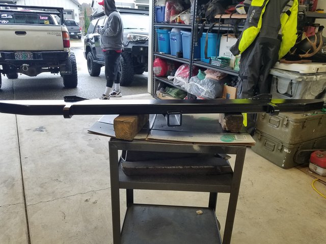

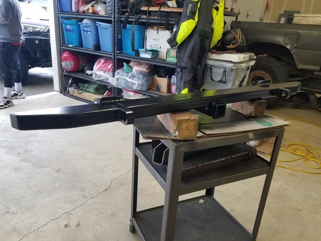

I had a very productive Saturday! With the help of my buddies Mike (@Notontheforum) and Jeremy (@Darksideyota), I was able to get my rear bumper built! Now I just need to add the reverse lights and weld it on the truck. I didn't get many pics of the build since we were going as fast as possible, but this is what I got:

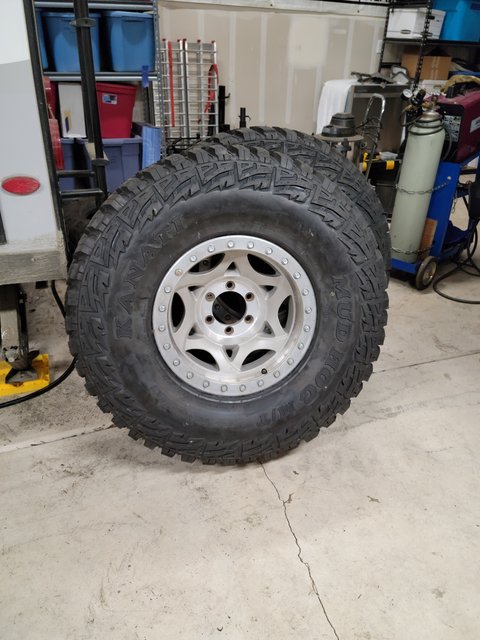

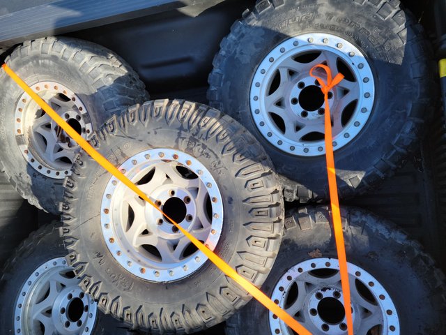

Two months (!) into waiting for my "in stock" cases, I scored a deal on some used Walker Evan beadlocks. I have wanted a set ever since I first saw them years ago, but they were always out of my budget. I was able to snag a set of five with good tires that I plan on selling.
I think they are going to look amazing!

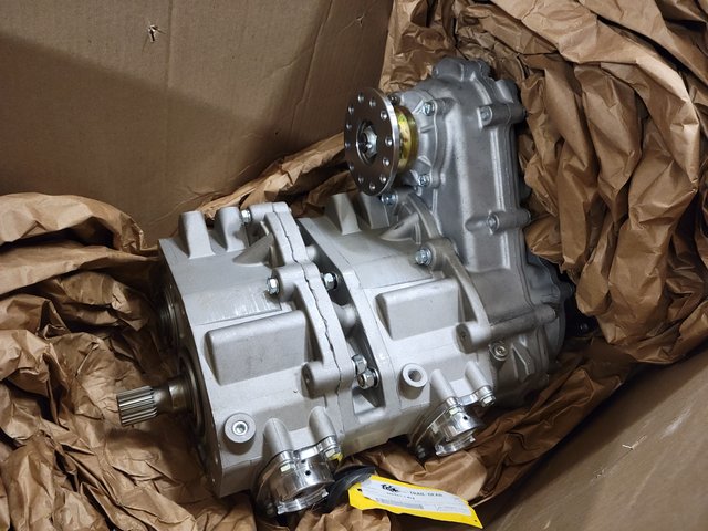

Fast forward another few weeks and I get a call that my cases are in. Just in case you haven't done the math, I waited almost THREE FLIPPIN MONTHS to get my "in stock" cases from TG. But, I got them!

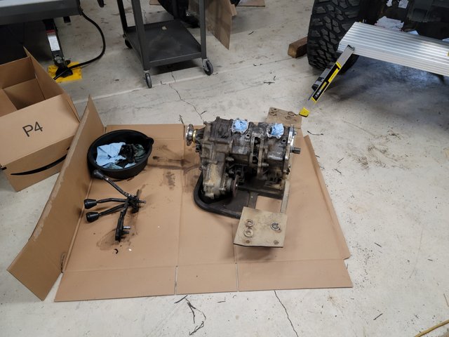

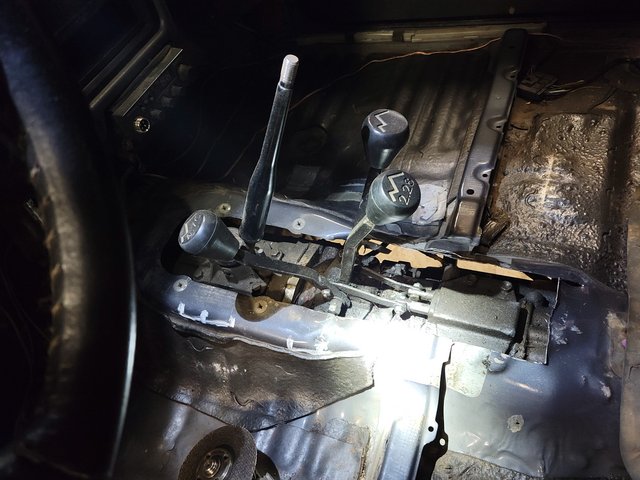

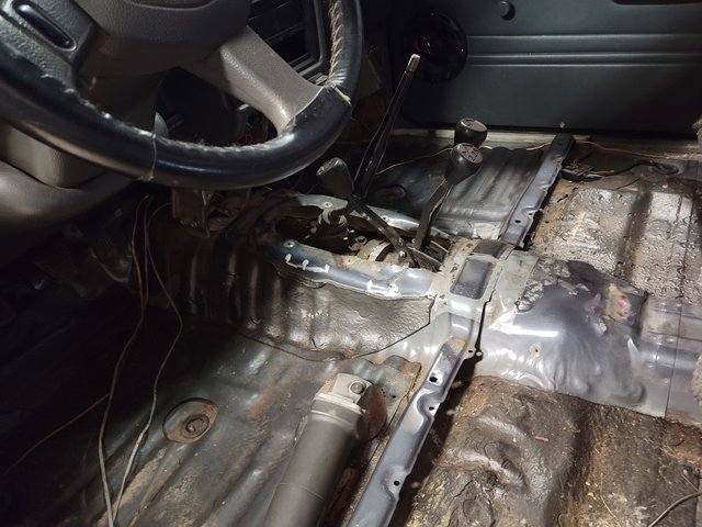

And last weekend the real work began. I couldn't find anyone to help me, so I was flying solo. The first hurdle came when I went to remove the shifters off of the cases.

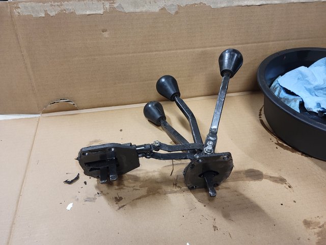

How in the heck did they get that on! I'm planning on building a new trans tunnel cover and center console, so I started hacking away.

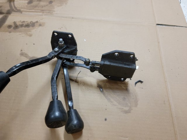

I have never seen a triple stick setup like this. The closest I can figure is maybe this is an old Dr Smash set-up. If anyone knows, please tell me!
And with some swearing, balancing, and redneck ingenuity I got the cases out. These will get cleaned up and put up for sale (shameless plug).

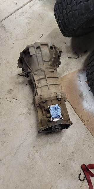

And now onto the trans, which is where the second hang-up showed it's ugly head. After a lot more swearing and an hour of fighting, I finally pulled the backwoods, cobbled mess of an exhaust out with a Sawz-All. I honestly have no idea what the person was thinking when they "built" this pile of poo. Add yet another thing for me to fix...
And then comes hang-up number three. The trans jack that I borrowed was 2" short of reaching the trans. Remember, I am by myself here! I use two 4x4 blocks to make up the difference and ratchet strap the trans to the jack. Lowered it down enough to get the upper bell housing bolts using every socket extension that I own and started praying... By God's grace I ended up not hurting myself or the trans!

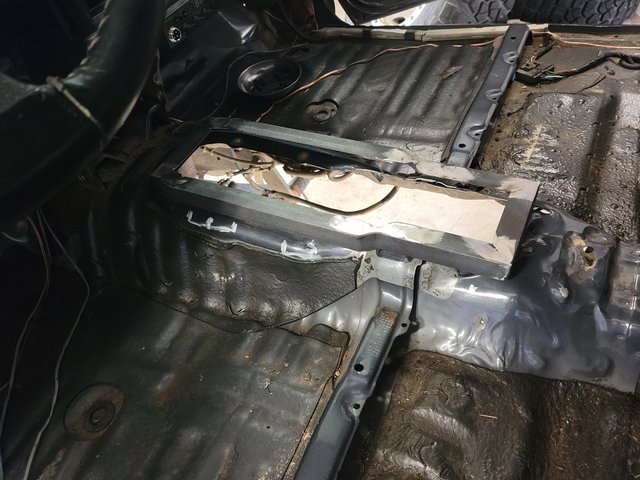

My flywheel bolts didn't come in before the weekend (which is seeming to be par for the course), so I started working on the trans tunnel. I'm pretty happy with how it turned out, except for the welds. I forgot how much is sucks to weld sheet metal with .030 wire!

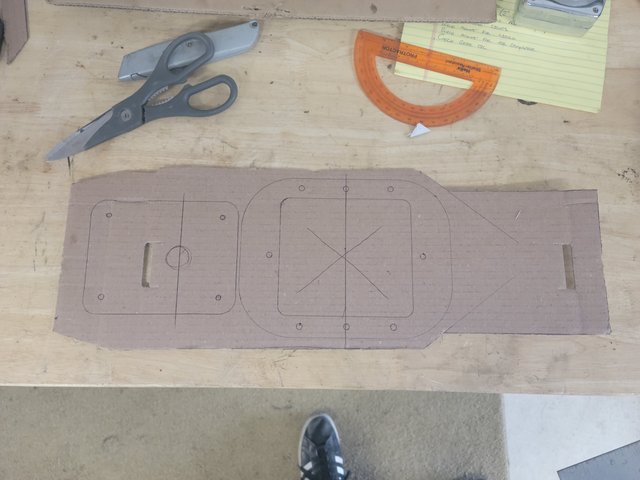

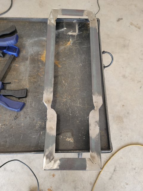

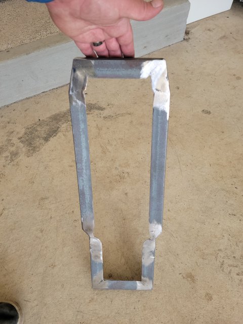

Started out with CAD (cardboard assisted design):
Then I used super thin angle and cut it to match the profile:
Took my time and mirrored it for the other side:
Got her square and welded it up:

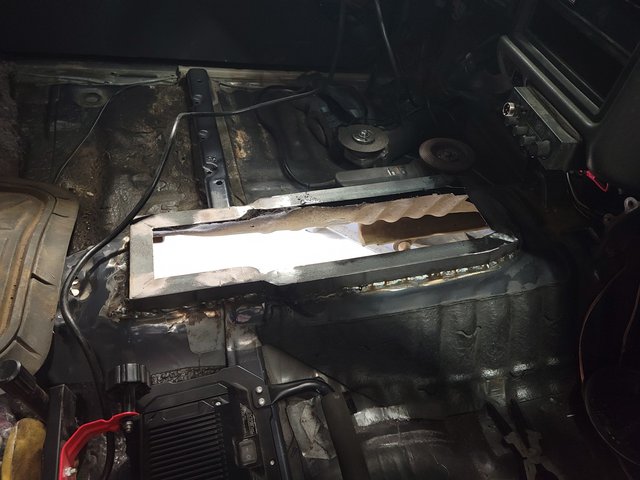

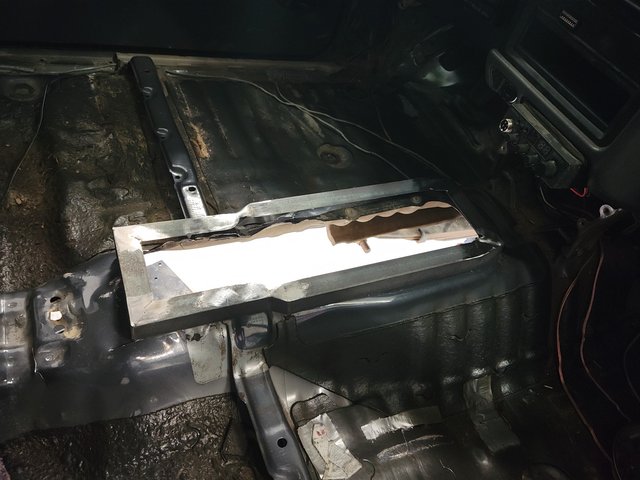

With some cutting and hammering, I got it to fit pretty well:
Then I booger welded it in... Only one pic of this because I was blowing holes through it like crazy. LOL!
I then coated the underside with rubberized undercoating. I think that should keep the noise down a bit. I still need to make the cover with the shift boots, but that will get finished once the drivetrain is back in. Luckily my ugly welds should be covered with the carpet... I also need to add the center console box and cup holders, but that is not a priority to get her back on the road.

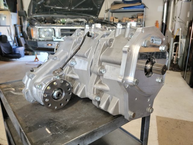

Cleaned up the trans to t-case adaptor and got it installed on the cases.

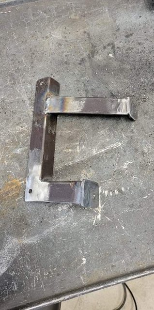

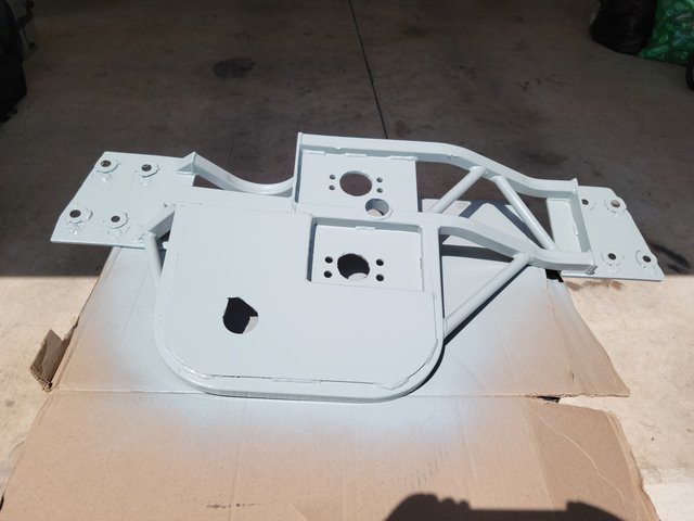

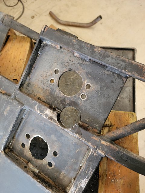

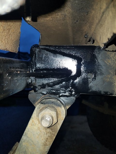

Then I set myself to modifying the cross member. Originally there wasn't a spot to access the crawl box's drain plug. Mainly because it was right above the 1" square tubing that was the backbone. With some careful measuring, I figured I could save one side of the tubing and out came the hole saw.
Then I cut a piece of tubing that would fit and give all of the structure back.
I welded it all up...
And gave the whole thing a fresh coat of industrial gray paint.
It's been pretty warm, so everything should be dry now. I will bolt up the cases to the crossmember and get it all back in the truck this week.

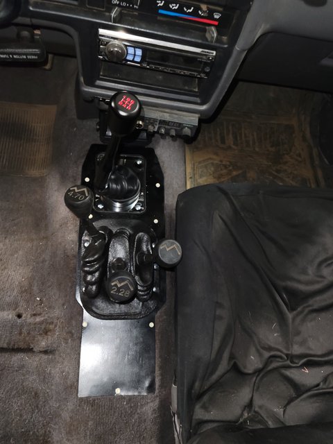

I got the cases in and everything buttoned up with those. I even got the tunnel finished.

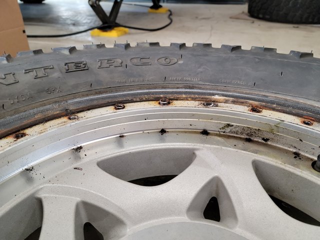

However, there was a huge issue getting my wheels done. I was hoping to use the truck at an event I was volunteering for the first week of June, but she was on jack stands... So I moved on to other projects to knock off my list. I installed my ham radio:

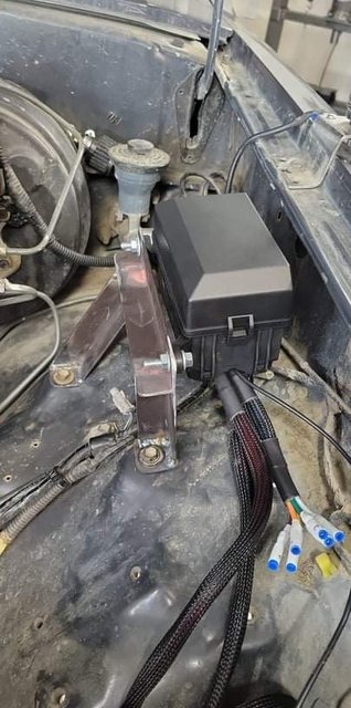

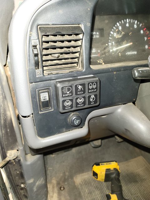

And finished up my aux switches and wiring the lights. My air compressor is on backorder, so that didn't get installed. Air lockers will be happening in the future, but I got the switches all set up for them. But my bumper lights, rock lights, and back-up lights are functional.
And I finally got my wheels and tires back last Thursday. I must say, these ended up being a poop show... That being said, the shop that was doing them (Bones Custom Creations in Oregon City) really bent over backwards to get them to me as quickly as they could. They are stand up guys and I really appreciate all of the hard work they put in... And they look amazing!

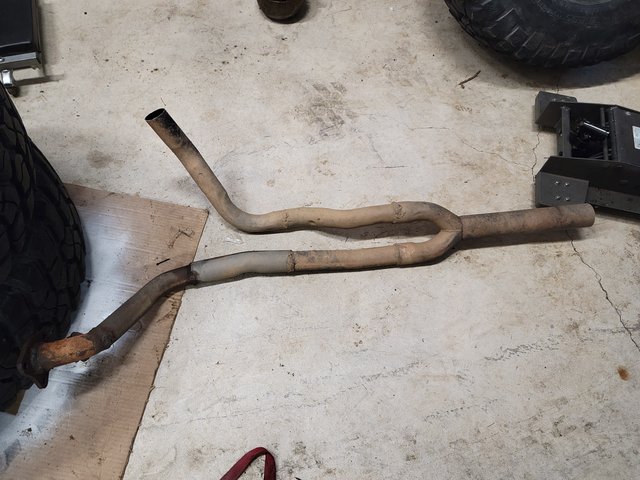

1) When I went to weld up the exhaust I cut off, I found coolant running out of the passenger side. Not much, but it is obvious I have a leaking head gasket or a cracked head. There is no coolant in the oil and I'm not blowing bubbles into my coolant overflow. Also, the truck runs amazing. My solution to this is buy some head gasket in a can to throw in the toolbox just in case and run it for now.

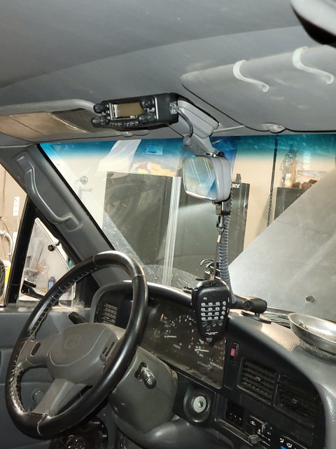

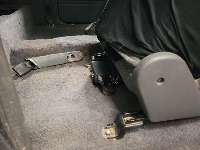

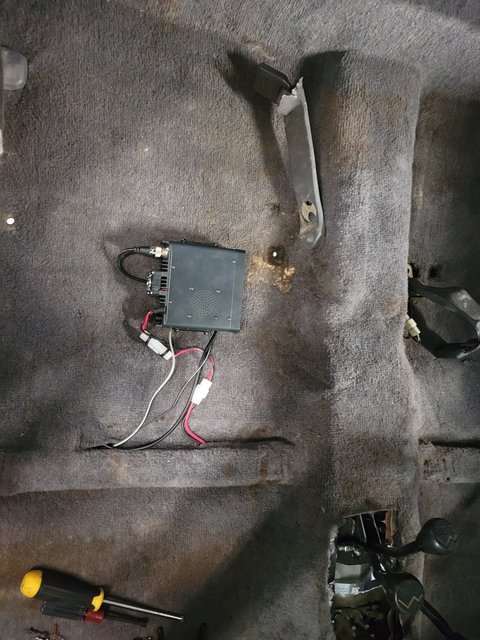

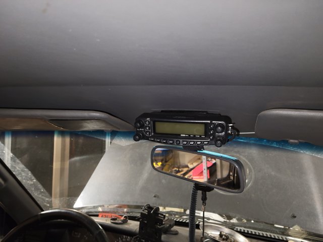

3) My fancy ham radio won't turn on. I'm really hoping it's the cheap Chinees cable I used for the remote face.

6) The exhaust leaks where I tried to weld it back together. It's a POS, so I will probably just wrap exhaust fix tape around it for now since it will be replaced eventually.

3) The cable I used to remove mount my Ham radio face is faulty... Radio works fine attached to the base. Easy peasy.
