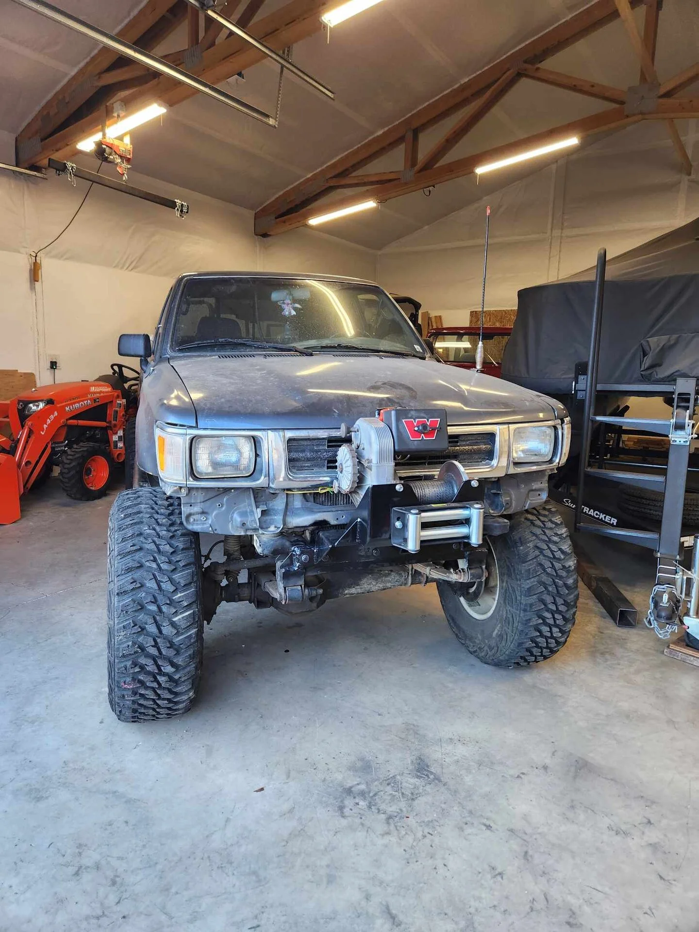

I ended up getting a Warn 8274 with a 1980 build date about a year ago. I slowly (really, really slowly) rebuilt the winch with some upgraded parts. I have always wanted an 8274 on my own rig, so I figured it was going to go on the gray truck... Eventually.
The winch has been mostly done (it needs power wires made and the rope spooled back on), but that is where my motivation stopped. Oh! I also sold the bumper and winch that was on the truck to help pay for the 8274 and rebuild. As a result, the truck has sat pretty much all year. My sorry excuse for a garage doesn't allow much room without moving everything around, so I wasn't very motivated to finish the project.

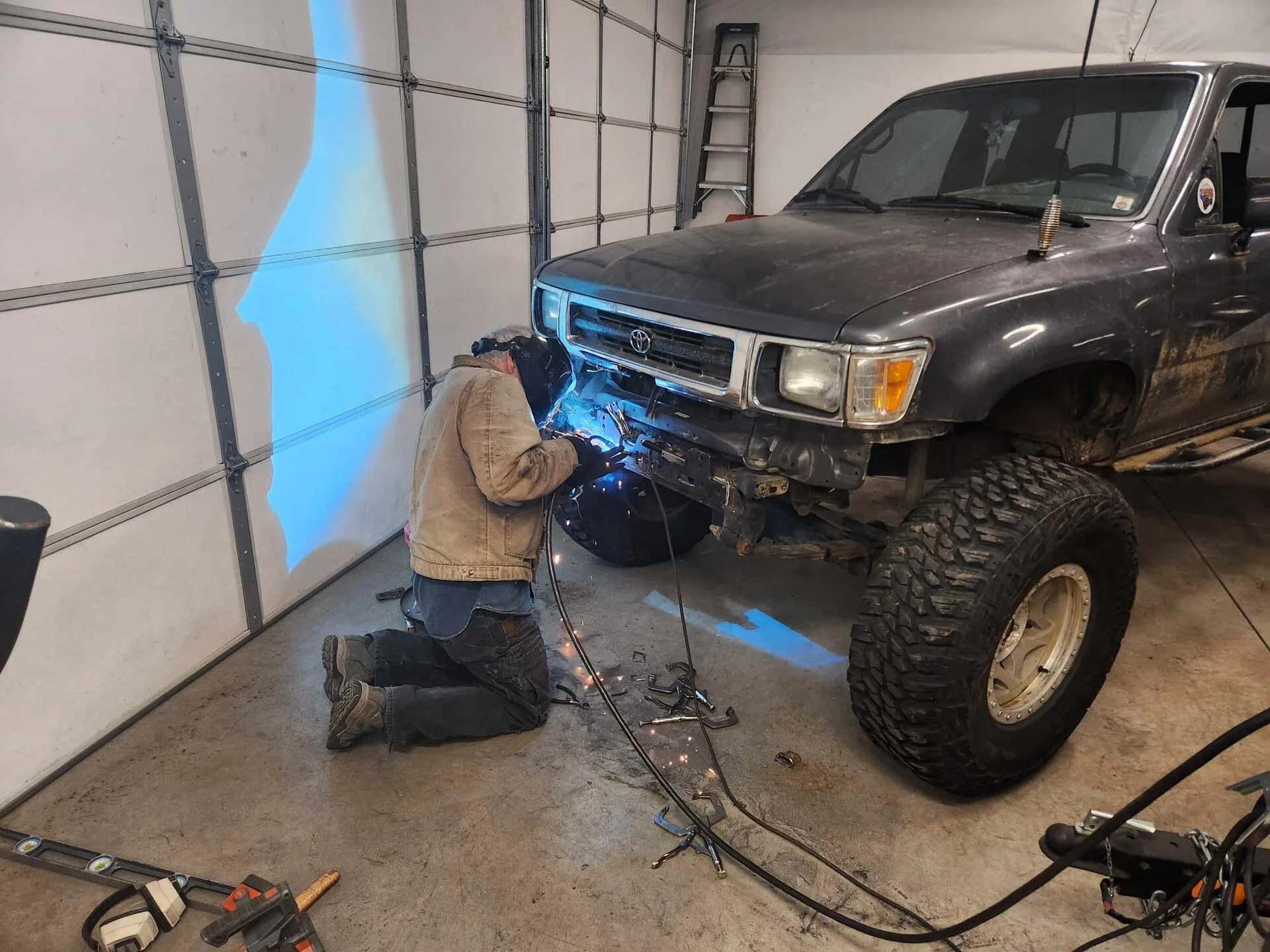

As a result of the guilt trip, a hairbrained idea was formed: I called my Dad (who actually has a shop) to see if I could trailer the gray truck out to his house, stay the weekend, and start a new bumper build. He was in! (I think it is important to note that my Dad lives a little over three hours away. And the most direct route is over Mt. Hood. What could go wrong?!?)
So I loaded the trailer and left Friday afternoon to shoot over the pass... With the first big winter storm nipped at my heels. Maybe we should have done this four months ago when I finished the winch. LOL!
By God's grace, I did actually beat the storm over to Dad's, but the pass was supposed to get hammered all weekend. The forecast called for measuring the snow in feet, not inches.... But anyway, back to the truck.

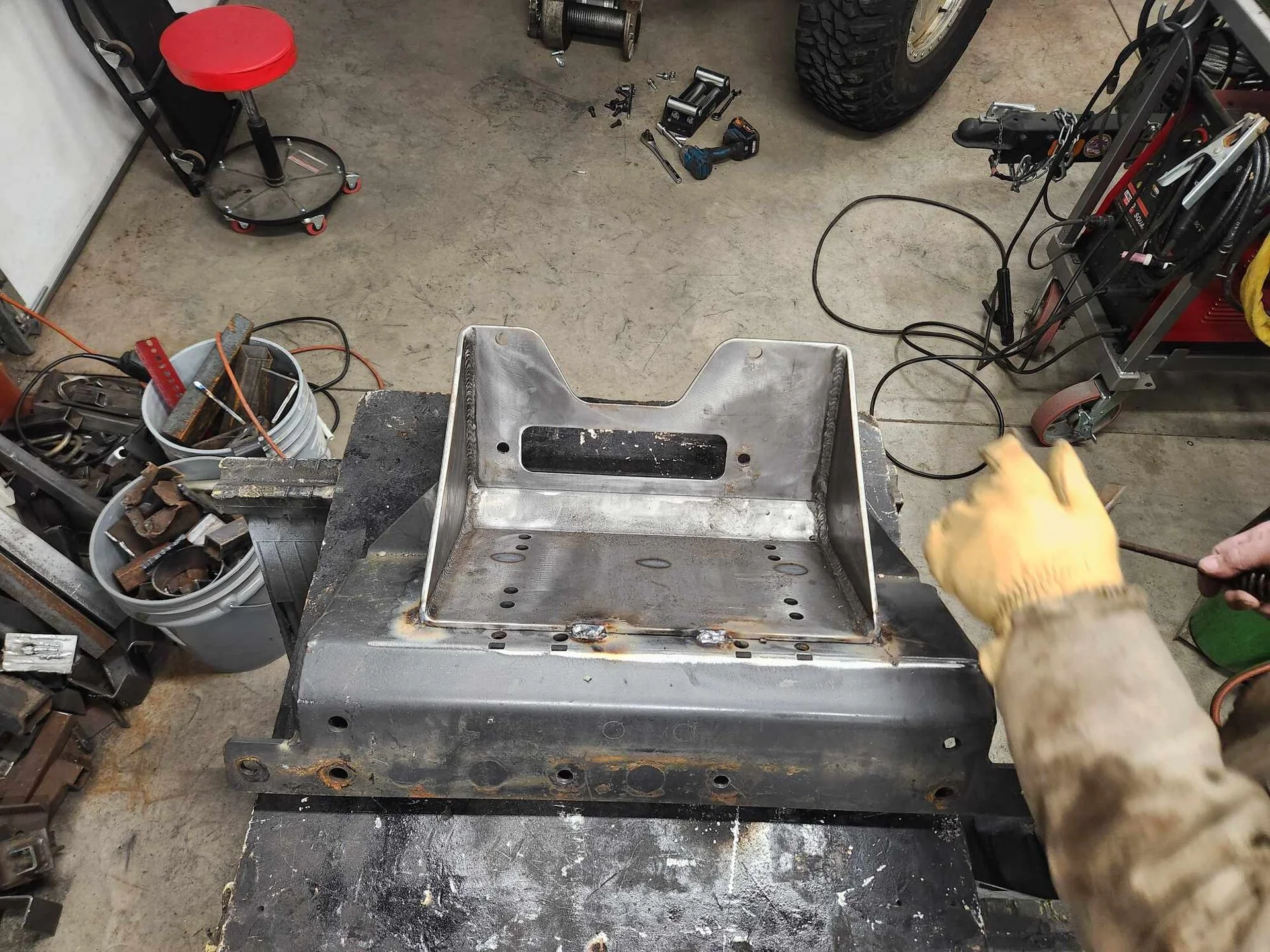

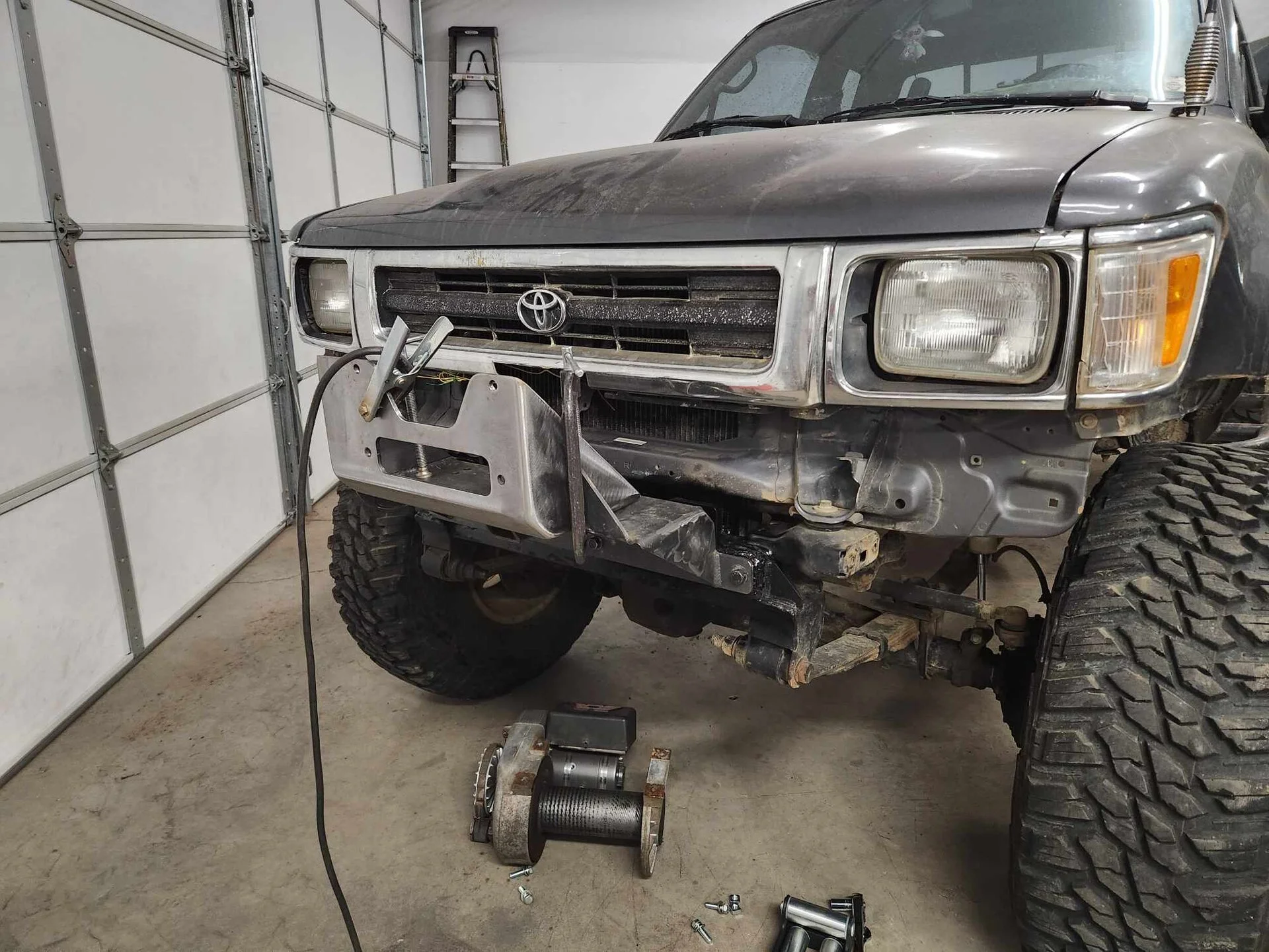

We started by adding NW Trail Innovations frame reinforcement bracket that I ended up acquiring somewhere. The old bumper had mangled my front crossmember from hard winch pulls and I needed all the strength I could get for the monster 8274!
Then we cut up an old Trail Gear bumper I acquired somewhere for the mounting placement and winch plate. After a lot of careful measuring and adjusting, we stacked an 8274 winch plate I acquired off of eBay.... And did a lot of burning metal.

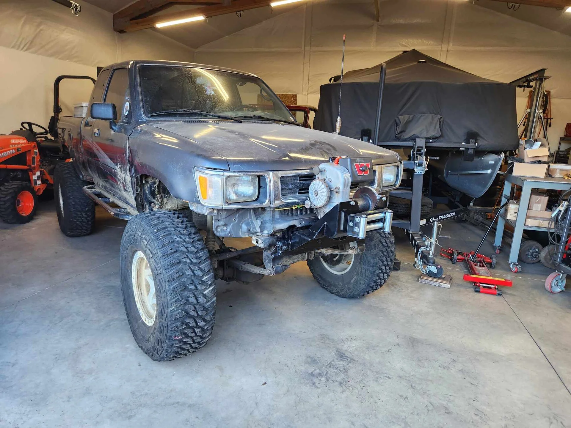

And here is the end result!
A Warn 8274 is a HUGE winch. It is very tricky to make it look right on a Toyota Pickup without butchering the grill and radiator support. I think we got it pretty good. Maybe next summer I will decide on how I want the wings to look. LOL!
After a blitz fab weekend with my Dad, I loaded everything back up to head home. Due to the storm, I was forced to take the long way and avoid the pass. I'm happy to say the LX did great and I made it home safe. Seriously, my only complaint with the LX is the 8.5 MPG towing. LOL!
