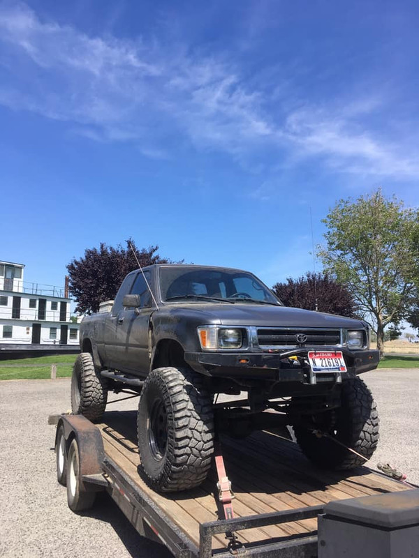

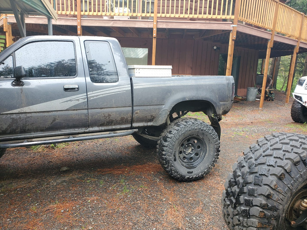

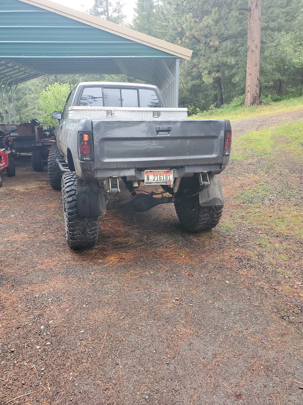

The day I posted the 40 up for sale again, I was contacted by a guy on FB asking if I would be interested in a trade. I told him honestly that I really needed to get rid of vehicles, but I would entertain the offer. He sent me these pics:
Let's see.... Favorite generation, extended cab, bobbed bed, 3.4l V6, SAS, dual cases... Dammit! Now I'm interested...

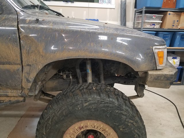

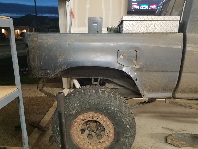

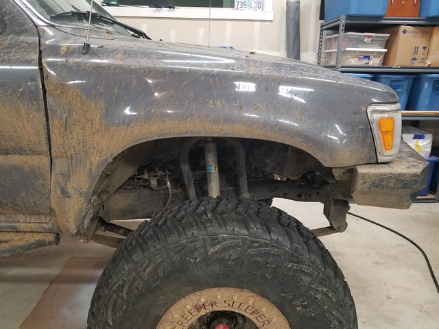

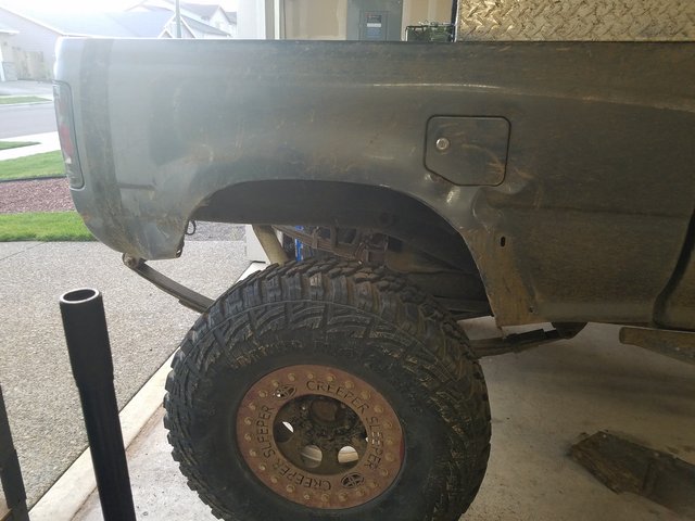

We messaged back and forth talking about the trucks. He bought this rig built for his wife to follow him around in his buggy, but she just rode with him anyway. It has 300M RCVs, 4.88 gears and Detroit locker in the front end. 4.88s and spooled rear. The rear case has a 4.7 gear set. Everything works well and runs good. He said that it was built around 35's and when he put 37's on it, there are some clearance issues he hasn't fixed yet. He took it wheeling and bent up the passenger fender...
Darn! Oh well, I'm just going to beat it up anyway... I called another buddy of mine who has been bugging me to sell him my '85 and asked if he was still interested. He was more than interested, he was enthusiastic. I guess that takes care of me needing to get rid of something...

My first order of business is to move the front axle forward about an inch, pull a leaf or two, and cut for clearance. After that, we will see where it goes...

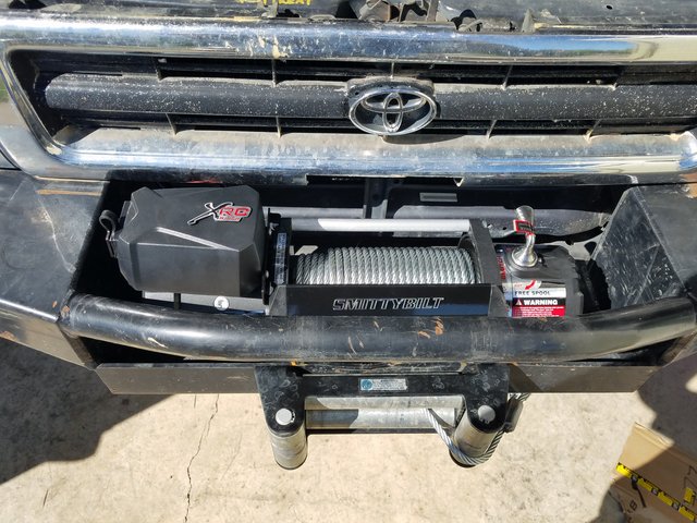

Also, I bought this truck with a broken winch. The wireless controller box shorted out and the winch ate itself. (Yet another reason I don't like wireless controllers, but that is a long rant...) The hook got pulled through the roller fairlead, hooked to the bumper, and the case of the winch broke. I pulled it out whole, but there is nothing holding the winch together:
It did bend the bumper a bit, so I got that straightened out enough to work. Luckily the damage is behind the fairlead, so it isn't really noticeable. Then I installed a new Smittybilt 9500. I have had such great luck with these winches that I am confident it won't cause me any issues.

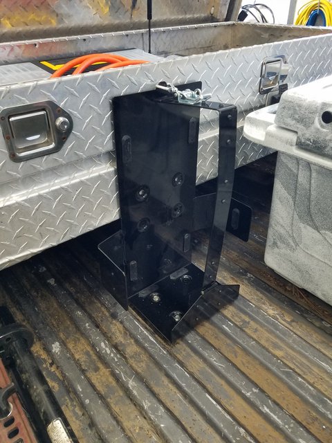

I have ordered mounting brackets for my Hi-Lift to go here. This gives me enough room for my camping box. I can actually stack two of them here while still having enough room to open the cooler.
I ordered a front loading jerry can holder for my NATO can. This gives me just enough room to hold my camping box against the tailgate. That way I only need to throw a strap over the top to hold the box in place.

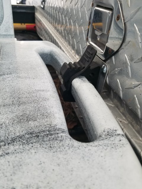

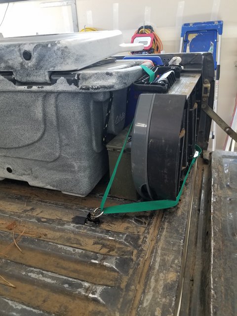

Trying to mount the cooler was proving to be a little more challenging. I could use a ratchet strap on the end towards the front, but it would be rubbing on the toolbox and would be super hard to get to. I also wanted to leave the space under my toolbox for firewood or my chainsaw. Quik Fists were the solution to this as well! I just mounted one to the toolbox to hold that handle.

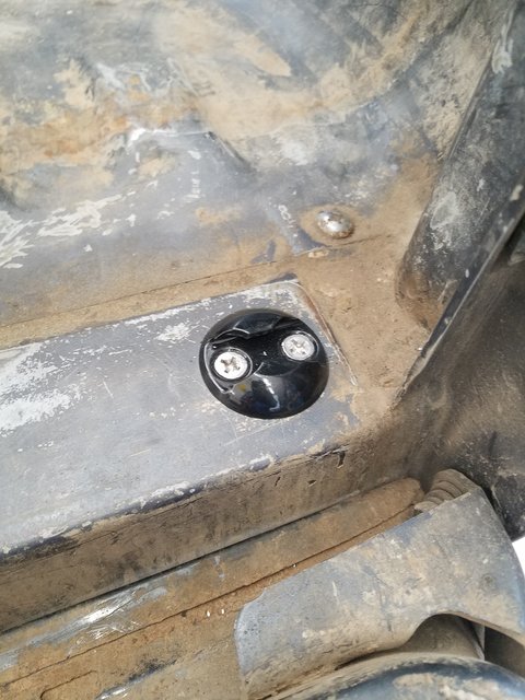

As for securing the other end of the cooler, I needed to find a way to also wedge my water jug against the bedside. This would make it to where I didn't need to strap down the jug. I ended up using a quick disconnect tie down point, which worked out perfect.
The water jug cannot be lifted up because of the bed rail and the end of the cooler, but I can just disconnect the tie down point instead of needing to loosen the strap. I ended up putting another one of those tie downs in a spot that I can strap down my camping box(es) AND secure my PETT toilet and supplies.

I got a couple more things done this weekend. I found a stupid cheap Hi-Lift mount that is designed for the hood of a Jeep. I just mounted them to the bed and it worked well.
I also got my front loading jerry can mount. I'm happy I spent the money on this one! Super solid and fits perfectly.
