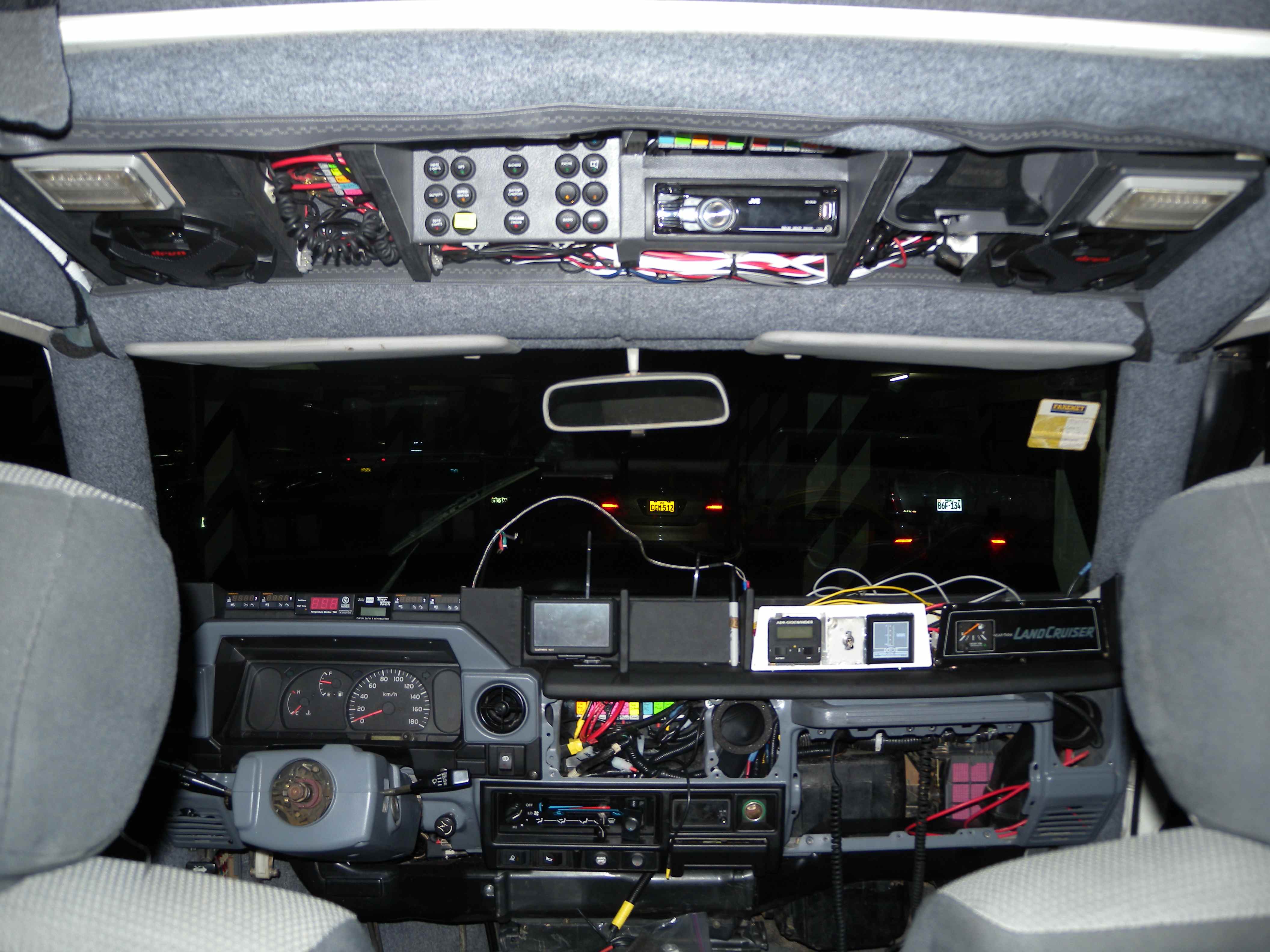

is the front dash above torn apart or is it used in this condition?
at that point in time I had removed the entire dash structure to build (precisely on the bench) a top dash extension for all the crap you can see in the photo, as well as to remove/clean/refoam all the vents and vent trap doors. i haven't yet done the finishing off with cover plates, but it will all have a factory look when finished.
i don't mean to hijack, i hope to get around to doing a build thread eventually but i'm pushed for time until i finish!
