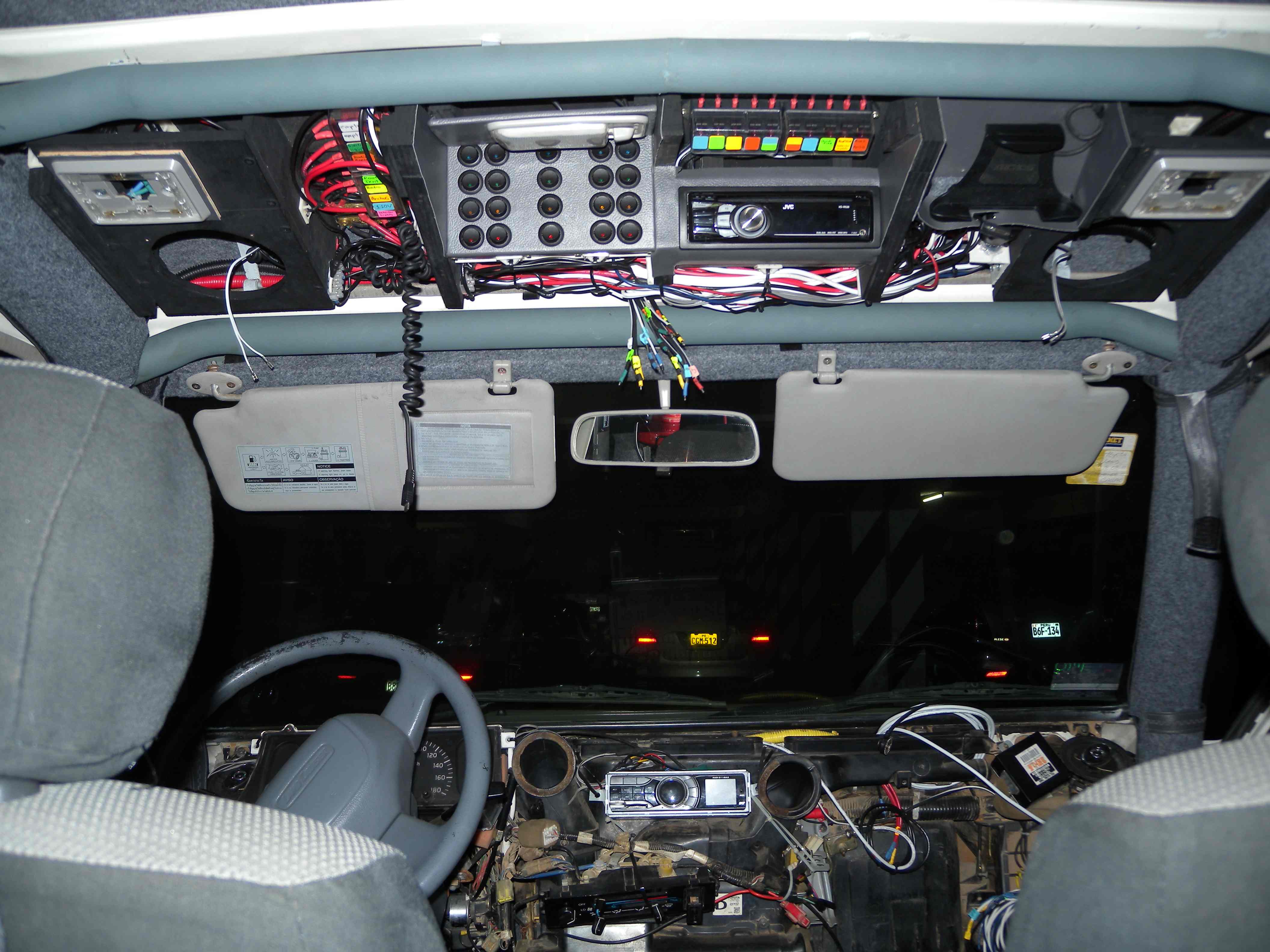

there are speakers facing down and ones facing back, since he is doing the trip mostly by himself he can fine tune the fader and the balance to what he likes.
he also has the option to add an additional speakers in the door and in the rear upper console to give the full bodied sound.
we did try the system installed, but sitting still in the shop, and the sound was real nice.
once the speakers and deck is installed in the BJ70 refurbishing build ( https://forum.ih8mud.com/70-series-tech/556189-1985-bj70-cnd-refubishing-modifications.html ) then i will transfer it to my removable hard top 70 to test it on the highway and will report back.
cheers

did you ever test the overhead console speakers? i ended up putting some speakers in the console i made up recently, but to be honest it doesn't sound great on its own from the front seats as i suspected and I'll be installing another set of rear roof mounted speakers to compensate. If it any help to the owner, i tested the position and it sounds good with another set on the roof in the corners at the pillar between rear windows, vertically angled near flat, about 15-20 degrees, and horizontally angled in a crossover fashion... i.e. rear right facing front left visa versa. i got the best results with a 80/20 rear/front fade config.
i don't have a photo on me with the speakers fitted, but you can see where they go and the angle, though regardless of the angle and amount of speakers I think its just too raw reaching the ear without any reverberation and softening off other surfaces.
Cheers,
daaammmmmnnnnn, not THAT is a console!!
yah, i gave it a quick test before parking the project and it sounded acceptable. when i bring it back out from storage in the spring, i can test it better. I might need to add a small amp to the system.
the one in the BJ70 build will be tested sooner, we were fine tuning the system, 2 amps with sub and 4 speakers and 4 tweets, and it sounded really clear and crisp. this owner listens to easy music, C&W and light rock. he wanted clear and loud wasn't the requirement. i think he will be pleased with the result.
you're right there, liking my music a little loudish certainly doesn't favor relying solely on roof console mounted speakers, but i still love the fact that they're out of harms way.
I'm really looking forward to seeing the finished product for more ideas for my own, but it looks like I may finish mine first, I'm shooting for end of March fingers crossed.
