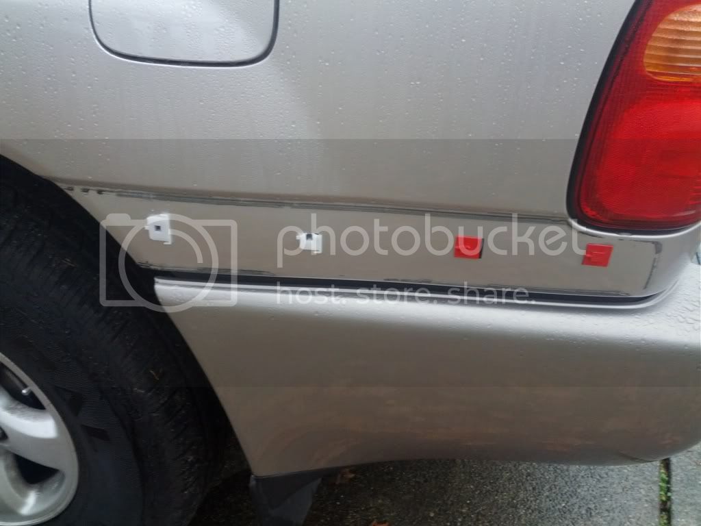

I ended up just ordering the 10pcs (plus clips and adhesive preinstalled) of side molding brand new from a local Toyota dealership. I really wanted the stock look back. List price for all 10pcs came out to over $1,000 for my 2000 LC. Ouch. No discounts for TLCA members but he dropped the price in 1/2 after I thanked him and started heading for the door.
Before that I had stopped by and gotten 2 more estimates for repainting instead of replacing. This time both just slightly under $400 for refinish/repaint 1 color (not the original 2 tone).
One guy swore they needed to be removed to be done right. Thats why his estimate was $675. He said the adhesive all had to be removed, moldings refinished, painted, put on again, etc.
The other shops with $400 estimates said they'd tape it off.
So now I'm going to figure out if I need a stripe off wheel and remove the current moldings and put the new ones on myself...hrmmm...appears easy enough.

The new parts came out to $575 after tax for me.
I was prepared to let a body shop do the repaint for $400 but am happy to pay just a little bit extra to get brand new parts on there. My LC isn't perfect but the condition of the current moldings are by far the biggest eyesore and I'll be happy to look at her now :popcorn:
