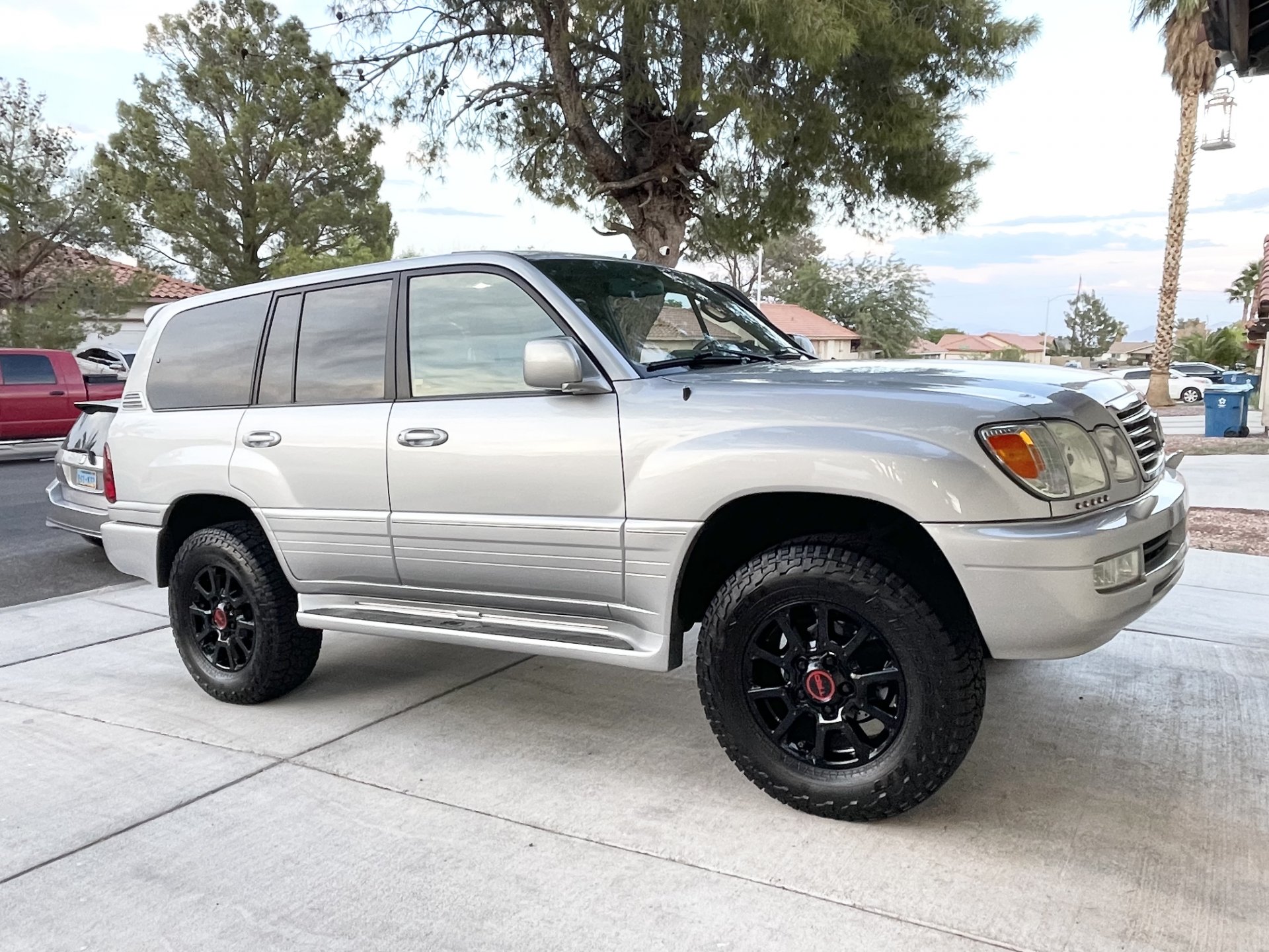

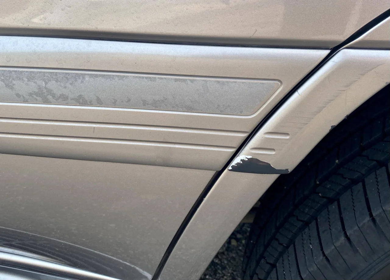

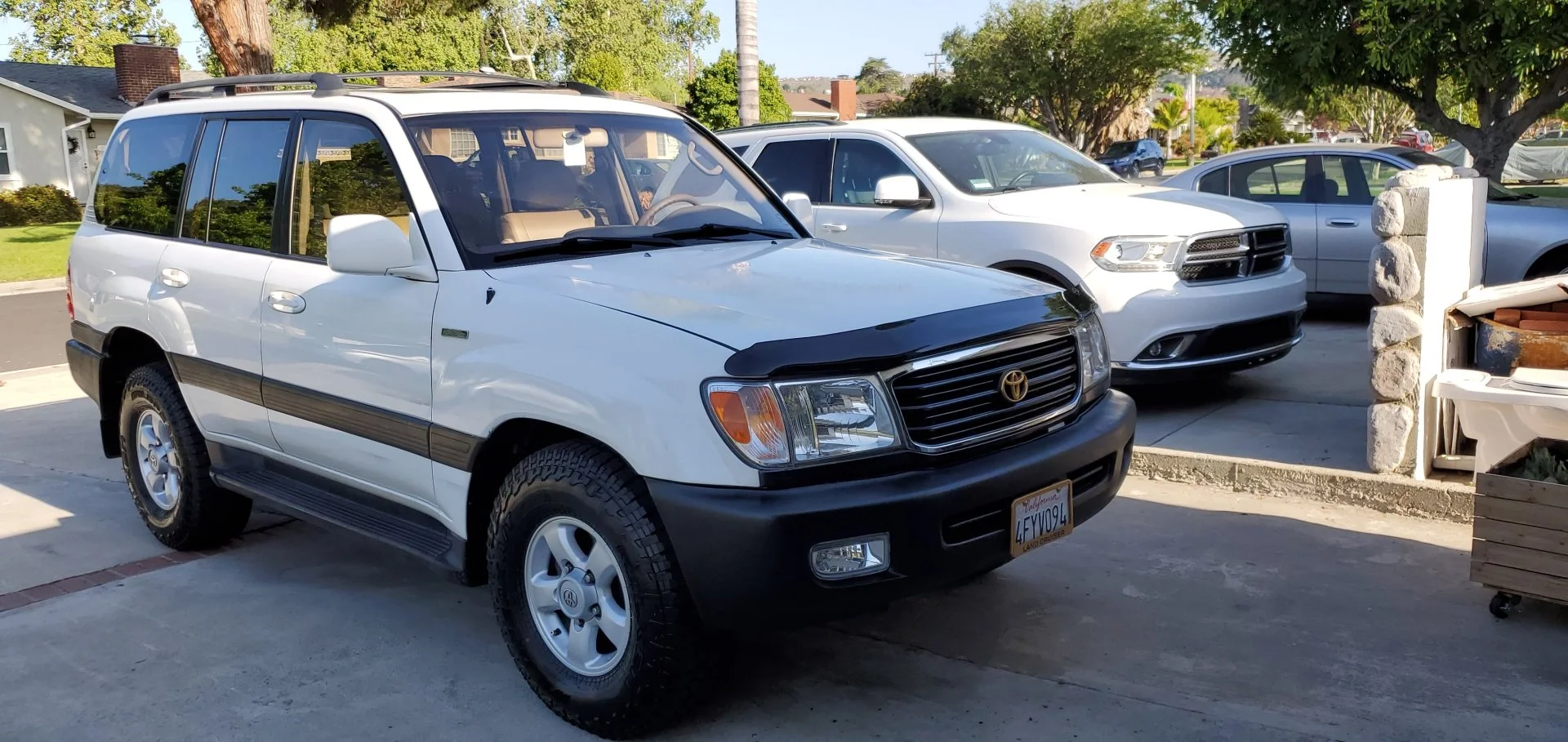

I painted my trim multiple times over the year, but ultimately, decided to delete it during the repaint. One of the best decisions I ever made regarding this build:

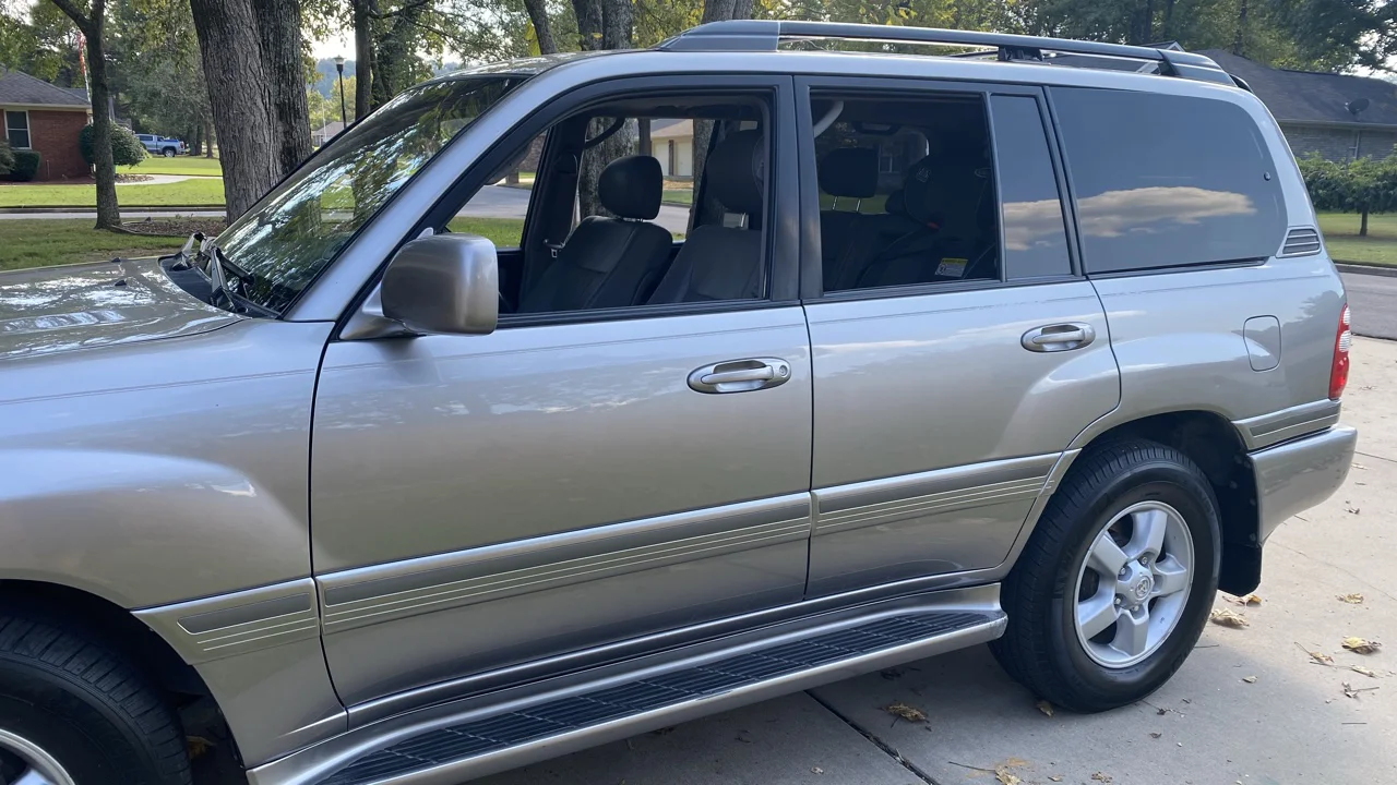

@fro20fow … where did you get your new trim? Is that aftermarket or did you find a good source for oem? I have same colors as you and still looking. Thanks in advance!
- Jeff

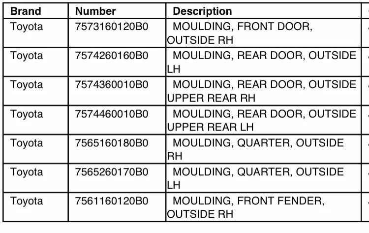

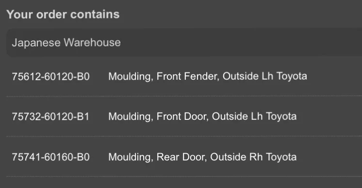

Excellent question.. to source OEM pieces I used: partsouq (uae) , megazip (Japan) and Roseville Toyota (California)..
Do you have part numbers / paint codes to share, I just can’t seem to nail down which one I have but it’s the same as yours and when I try to use partsouq I get lost. Thanks so much!

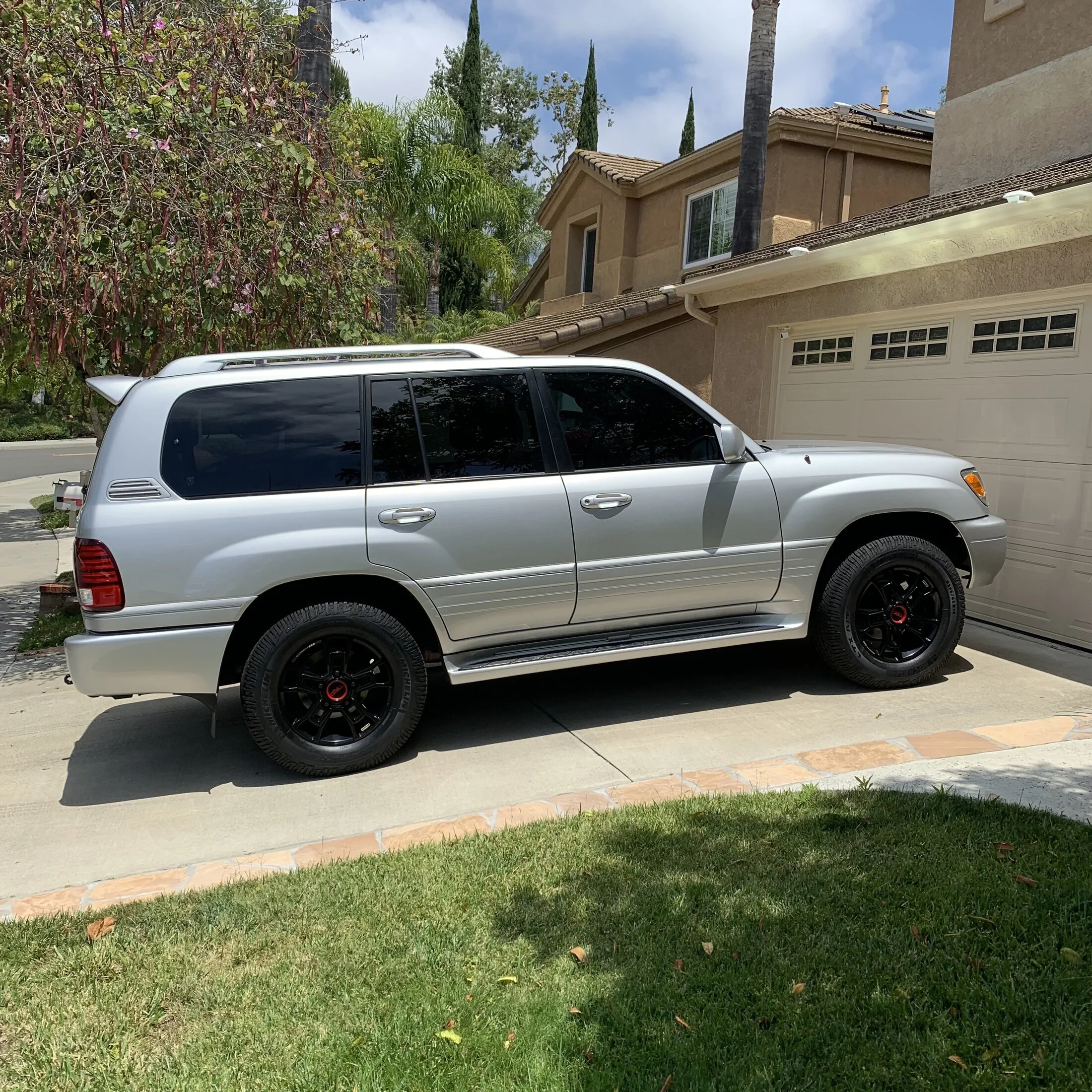

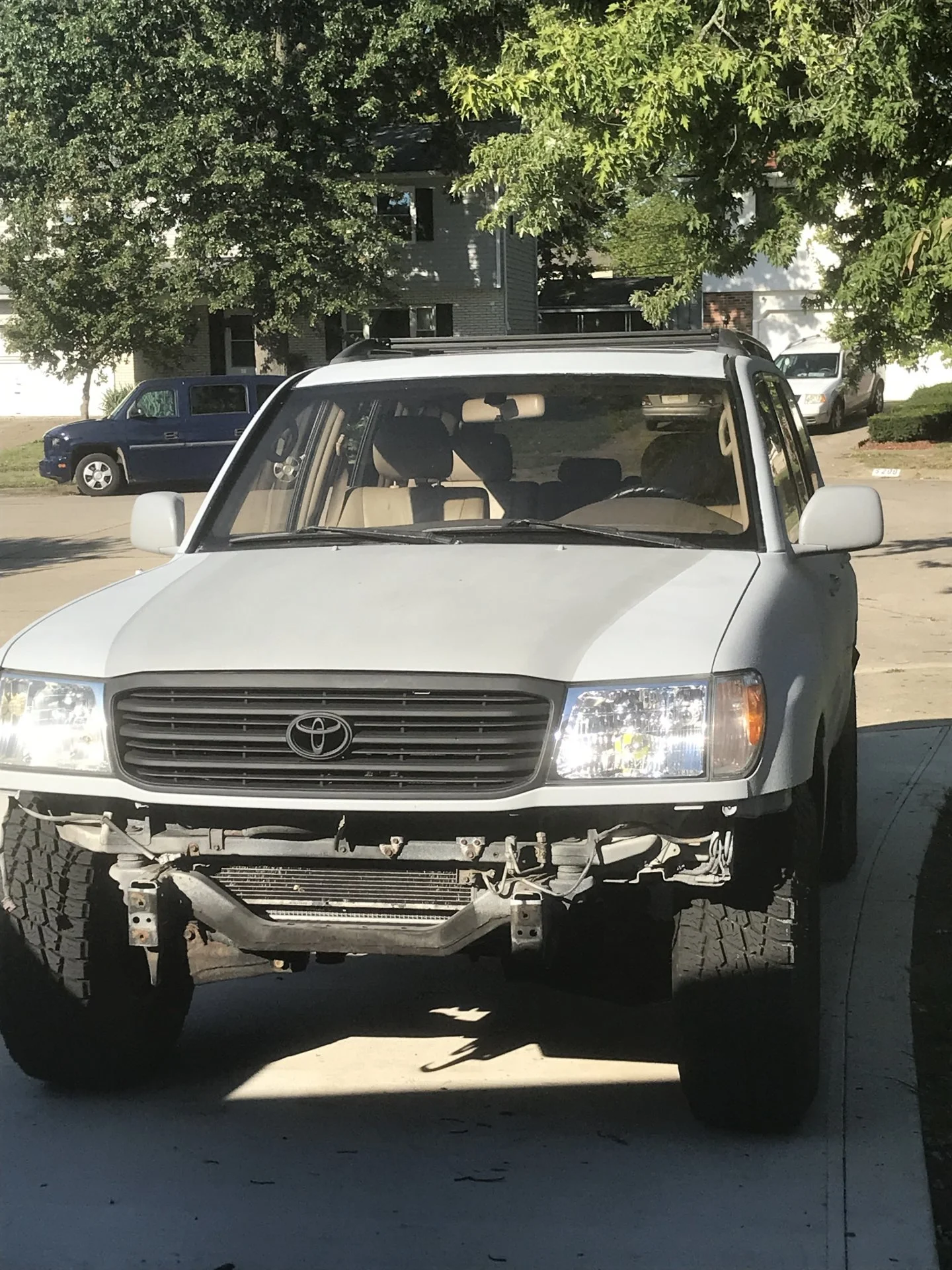

Just finished up my rattle can resto. Looks good from about 5 feet. Definitely could’ve spent a lot more time sanding between coats, etc., but for a few hours work and less than $100, I’m really pleased!

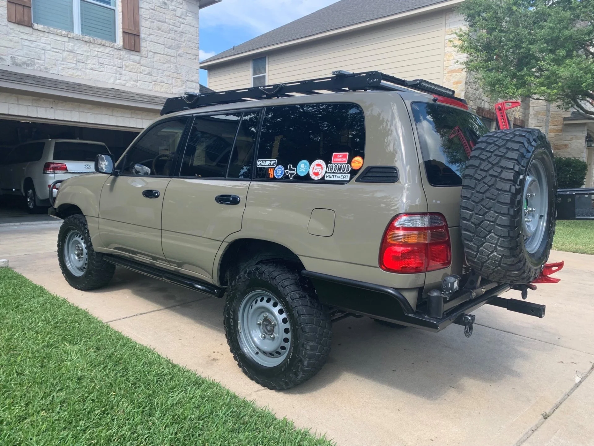

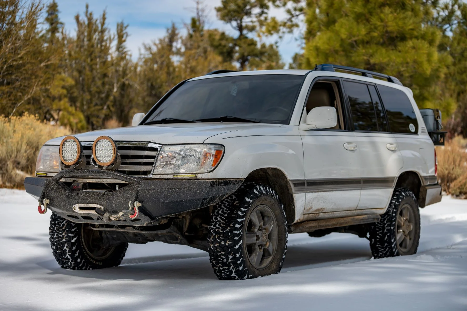

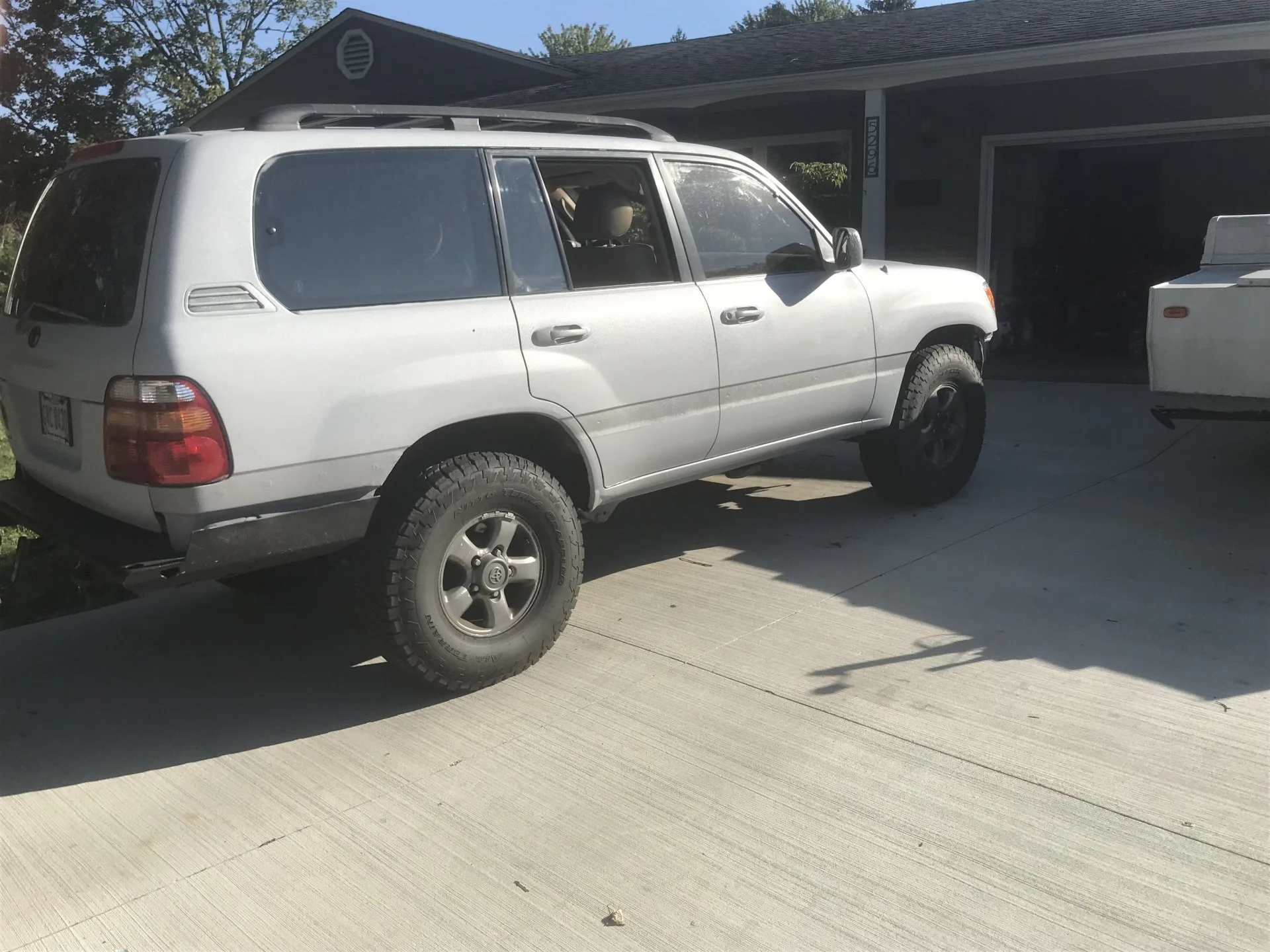

I just used some black wrap about a year ago, ties in the bumpers and sliders and was super cheap and super easy to apply.

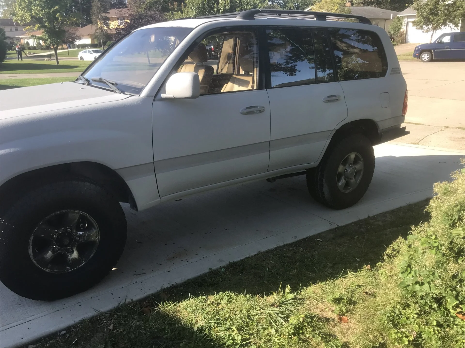

I just sprayed it black with truck liner. Holding up well so far. Only did it to match the raw bumper covers when I replaced the damaged ones.

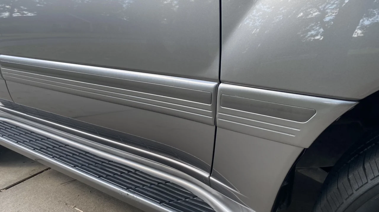

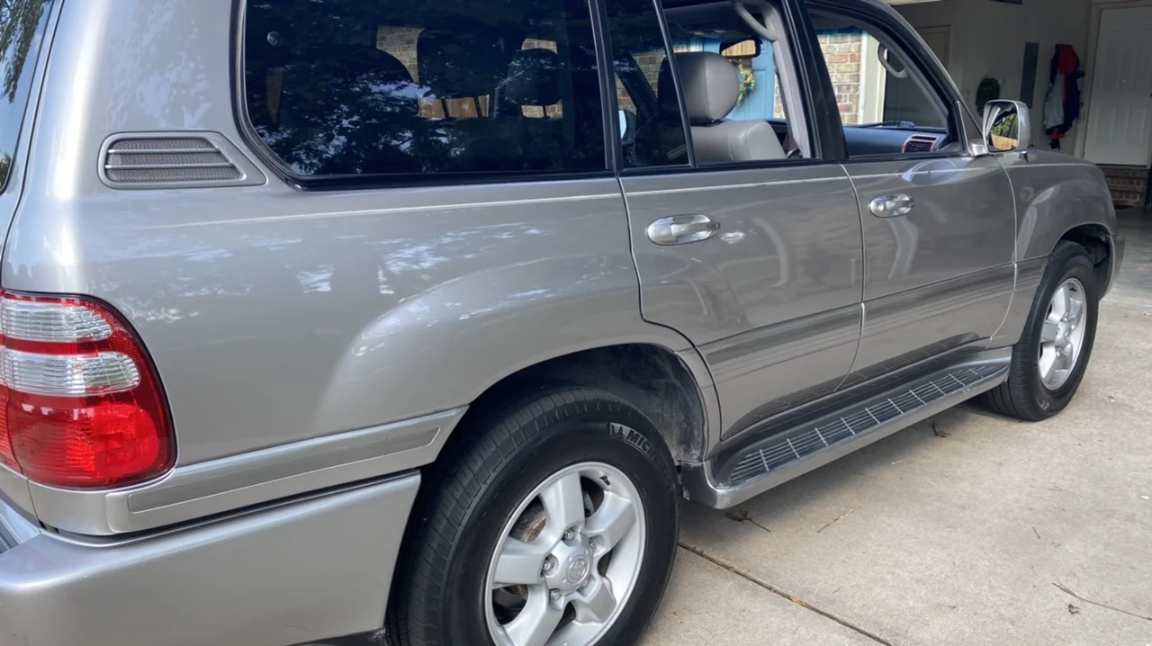

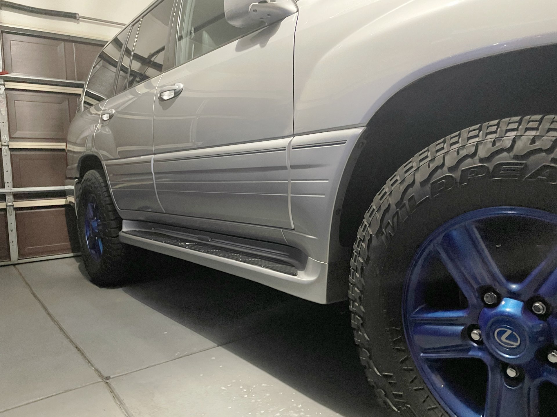

My contribution (not just the trim but the whole door cladding and factory step boards):
Fully cured and ready for cutting to remove any orange peel.
Did a single pass cutting polish, have a few more passes to go but mtb is life so until the next episode LolView attachment 2798870
All pictures showcasing only the passenger side, rest assured the driver side was equally done too :rofl:
This looks great! What paint did you use? It’s time for me to do mine. Our rigs are nearly twins!
They are twins indeed! I used 2k base and 2k clear. We have a local paint supply shop in Vegas that preps one up in an aerosol can, ours is the 1F7 code, Duplicolor has one ready as well. Take your time, painting is 95% prep work and 5% actual shooting paint. Curing time is just over night.
