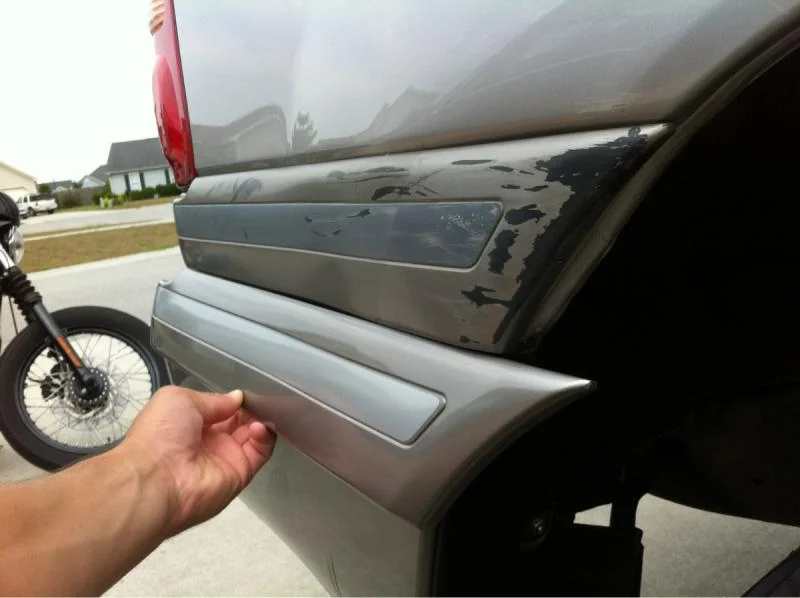

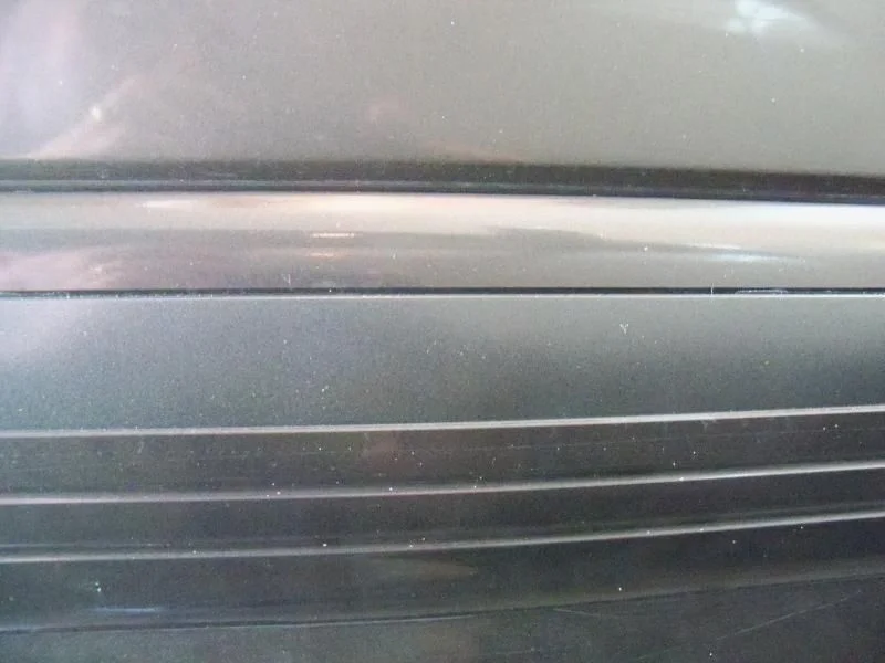

Just wanted to share - finally after years of looking at the splotchy and faded center side molding trims, ordered the base and clear coat aerosol spray cans from Automotivetouchup.com Touch Up Paint, Aerosol Spray Paint and Touchup Paint Accessories | AutomotiveTouchup | 888-710-5192 to match my '99:
Description: 12 oz Aerosol Spray Paint, 1999 Toyota Land Cruiser: Riverock Green Mica 1C3

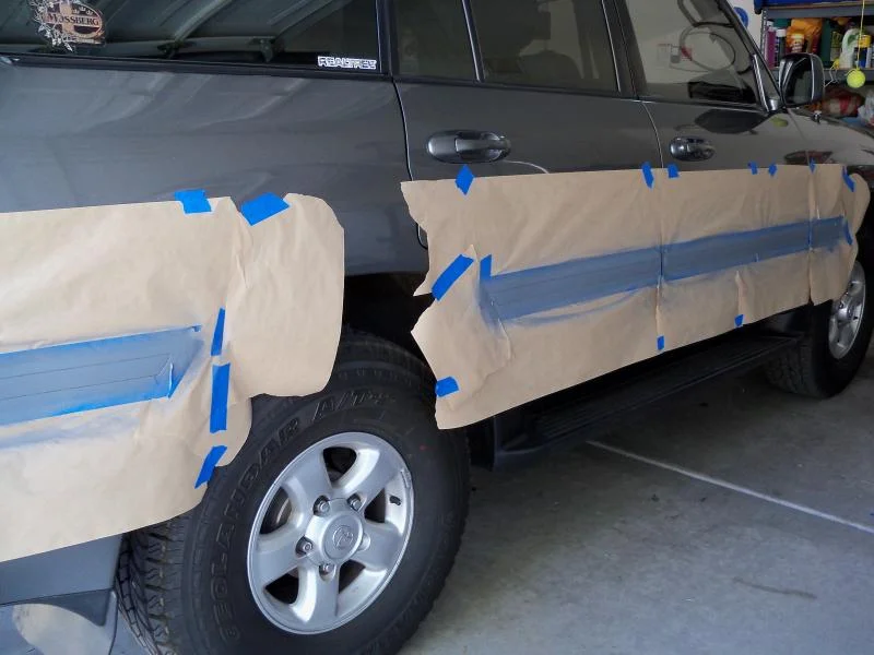

Taped the centers, sanded with 220 grit then some Simple Green, wiped with damp paper towels then dry, then a micro cloth. Used Rustoleum gray primer then sanded after a couple hours with 600 grit. Wiped-down again.
Three coats base paint, three coats of clearcoat.
Just done two days ago so we'll see how it holds-up.
In a couple of weeks I think I'll tackle the front and rear bumper corners where I've got some scraps and chips.
Don't know if you can tell from the pictures, but the color matches the body exactly, it's a bit of a different shade from the "outside" of the plastic trim. The slight contrast looks good IMHO.

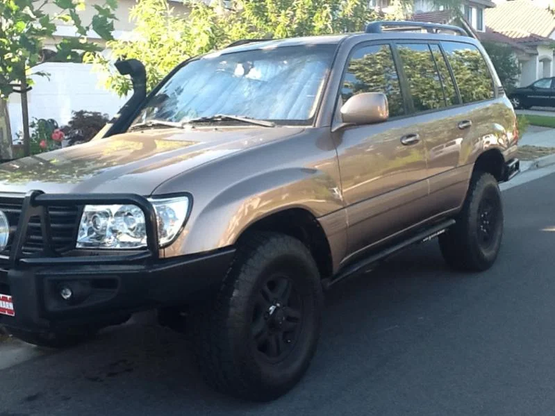

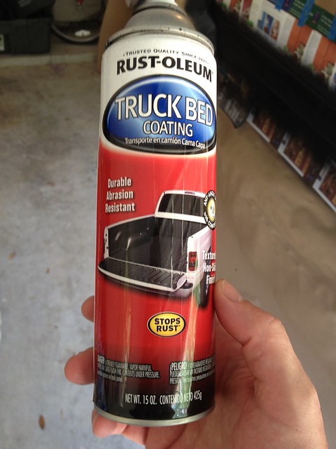

Ok so I finally got around to doing this. I decided to go with truckbed liner paint because it matches the finish on my front and rear BIOR bumpers and because it requires almost zero prep (cleaned with simply green, did no sanding). Here is what I used:

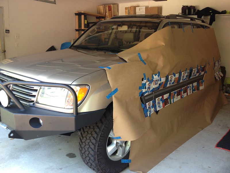

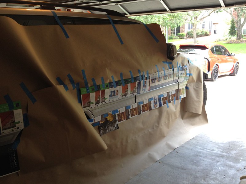

I wanted to make sure I didn't have any overspray, so I spent a lot of time taping and masking off the 100. I also borrowed a trick I learned on the Subaru forums and inserted cards behind the trim piece to help keep paint from getting on the metal.
The painting itself was easy, I put three coats on and let them dry for about 10-15 min between coats. One tip I learned was when using a new can, spay it first on a piece of scrap paper, and shake it twice as long as you think you need to shake it.

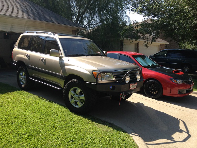

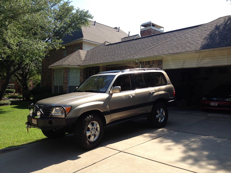

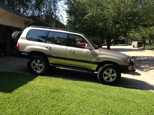

I'm pretty happy with the final result:

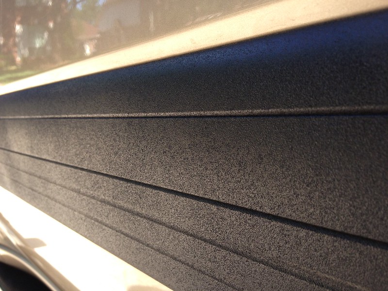

You can see that its a flat black with a textured surface:
Hopefully this will hold up well. Since it is meant for truckbeds I figure it will be durable. I'll let you know if that doesn't prove to be the case. Thanks to all of you in this thread that did it before me, I don't think I would have had the guts to do it without your advice! :cheers:

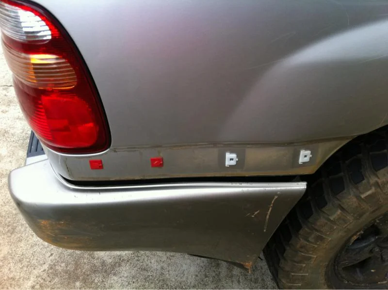

Anybody have pictures with the trim off showing where the adhesive is.
Also, anybody have a part number for the plastic clips.
I'm planning to paint mine but have a rear door piece that is falling off (some PO just put a drywall screw in the door jam area to fix but I'm not real crazy about that!) and want to re-attach as correctly as possible. I also have plenty of 3m PSA tape for emblems and such on hand so if it's easy I'll remove the whole set.

Looks like the re-tape will be worth it to avoid all that masking. Would you say the clips are generally re-usable with care or is a replace them all thing?
Thanks for the pics and the diagram!
Thanks guys!
the clips are not reusable, if you are careful enough you might be able to reuse them. I just ripped mine off and put the new one on, so I can't say much about careful with it.
Definitely not reusable, I just masked off the area then painted to match the body! Much cleaner than the black trim I had before
