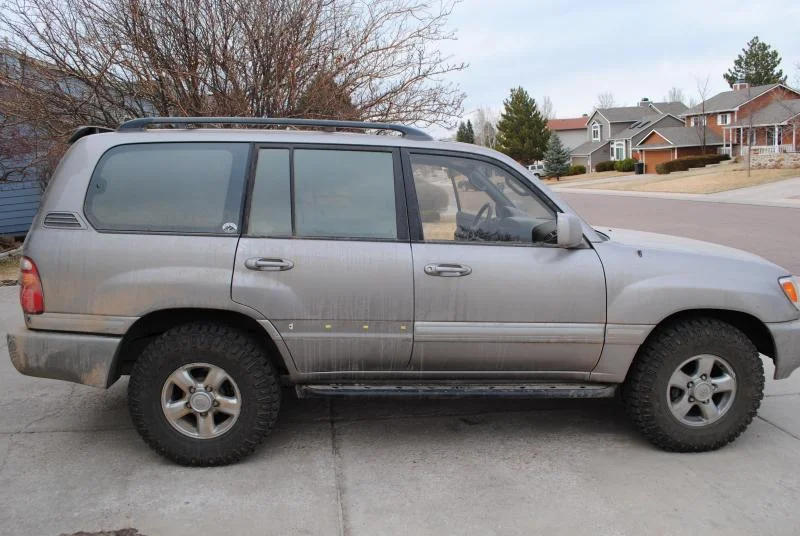

Here's a pic of mine after they were sprayed. Wish I had taken some close ups before I did them. They looked terrible; really made the whole ride look junky.
I'm surprised how well scratches, dents, and dings in the moldings smoothed out with the 400 and 600 grit.
By the way, I know I have the stink bug thing going on. I need to level it out...

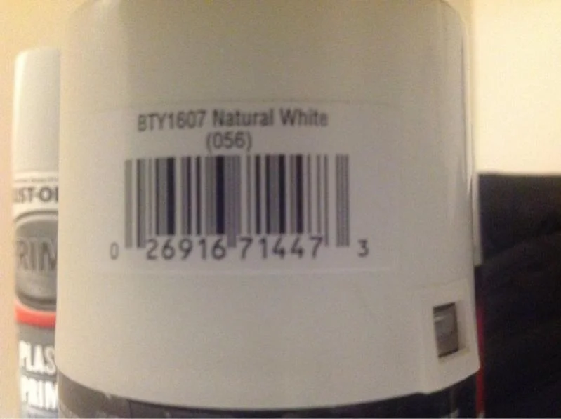

GaFJC and Deltapine1 what white did you guys use to match the white body color? Epoxy paint and epoxy clear coat? Did you just choose a close match at the store or did you have Napa mix you up an exact match in a couple cans? Both trucks look good! I have to also do the fender flares on mine...errr. Would love to remove the flares but they've rubbed significant scratches in the body since the PO never removed them.

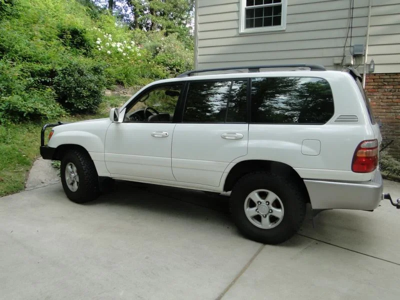

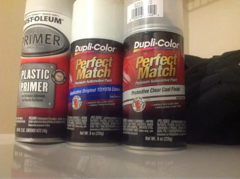

These are the products I used early last summer, purchased from Advance Auto. They didn't have the quantities in stock but were happy to order them in for me. For a rattle can job it came out far better than I hoped. 99% of people wouldn't know it wasn't OEM.
Take time with the prep; buy some 400 and 600 grit sand paper. Blue painters tape will slide in between the trim piece and the respective body panel. Take your time and let each coat dry properly before the next.
My 100 isn't garaged and not washed every month and the rattle can has held up very well.
