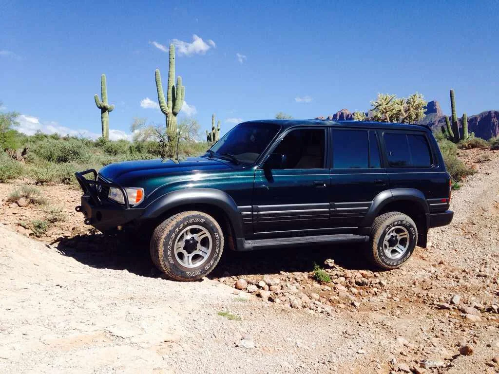

No my cruiser is a 1996. My username is Bella 1992, because my very first Land Cruiser was a 1992. That's when I first joined mud, but now I have upgraded to the 4.5 L motor!
