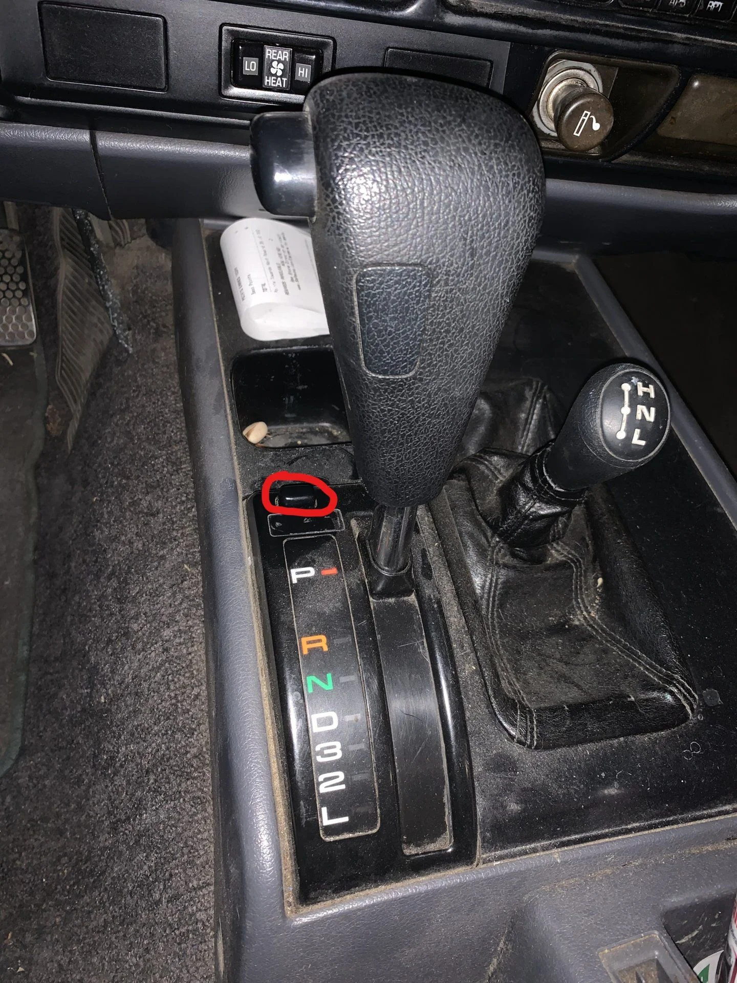

Recently I've been unable to shift from P to R without pressing the manual release button, the thumb button just won't go in. This is a new development following the fluid+filter replacement.

Do your brake lights work? If not, that could be that cause of your shifter button not releasing. Supposed to step on brake to release the button. If brake switch on pedal is loose or misadjusted, it could cause this. A bad harness issue with brake lights could cause this issue.
Nothing to do with flush or slipping.
Thumb button won't go in unless I press the button circled in red in image below.

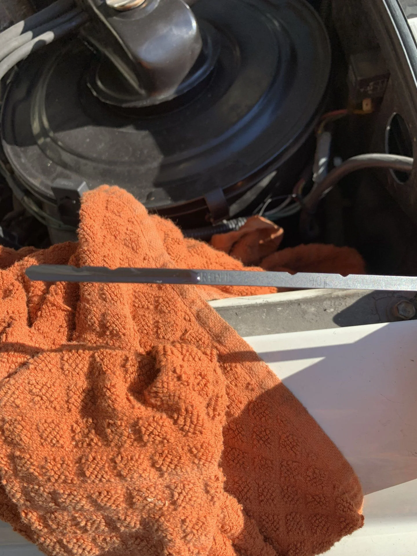

Went for a 30 min freeway drive, came back, parked level and pulled/wiped/pulled transmission dipstick a few times and it seems VERY low for where you say it should be when hot. It's pretty far below Hot. Does this mean there is too little fluid? Picture below. This may be a stupid question but would I be able to add more fluid by pouring down the dipstick? I imagine if I did that I would want the same ATF the shop used which I could find out. How much to add in this case if so?

For a A343F transmission that level would not cause shifting problems IME, but I have no experience with low fluid in the A440F (it is a bit low), wait for those guys to chime in.
That level caused shifting issues in my A343F. I’d dump a quart or whatever to get it up to full. Couldn’t hurt any thing, unless you want to take up a case with your mechanic.
A440f trans are very fluid level sensitive.
Only add a pint at a time. It's easier to add multiple times than to try and suck or drain some out.
Trans should only be checked when running, in park, and having been driven for at LEAST 15 miles, and on level surface.
Add a pint, drive it and check it. Do not overfill. Really try to get it right on the top of the hot mark, even if you have to add fluid 4 times.

I assume that you checked the transmission fluid level with the ENGINE RUNNING.
Yes, the level is low.
Yes, you add ATF through the dipstick tube. You will need a funnel with a smaller than normal tip to fit the dipstick tube.
Add the fluid VERY slowly, just letting it dribble in from the container or you will make a mess.
It is difficult to get an accurate reading on the stick after filling, as the AFT clings to the tube. I typically wait a day or so and continue normal driving and check periodically until it's correct. Do not overfill. It won't cause damage, but it won't shift properly when hot and you will have to drain some out, which will make a mess again.

As far as stuck in Park goes, my brake lights do work, but my cruise control doesn't. From looking around on here it sounds like that could be the brake switch adjacent to the brake pedal needs to be adjusted or replaced. Also read that under the center console is the shift lock ECU, could that also be damaged?

If your brake lamps work, then the brake switch is fine. Here is the shift lock control schematic from the EWD. Again, you should have this as it has every system in the vehicle.
