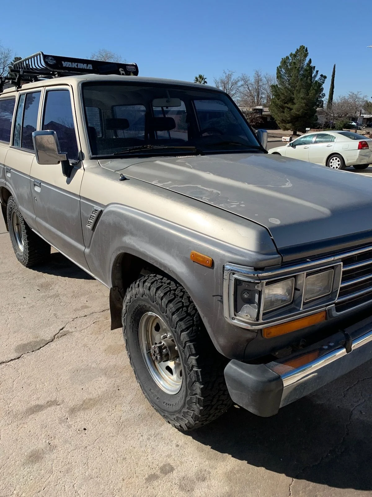

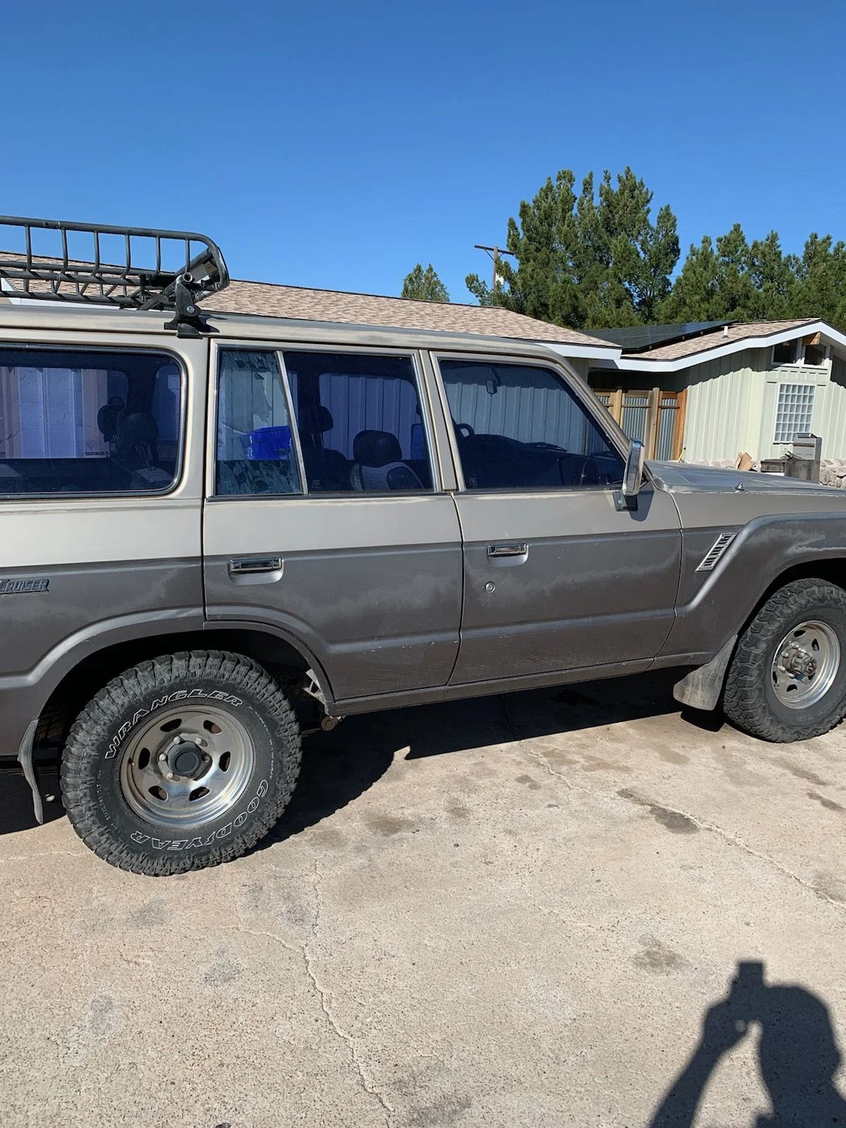

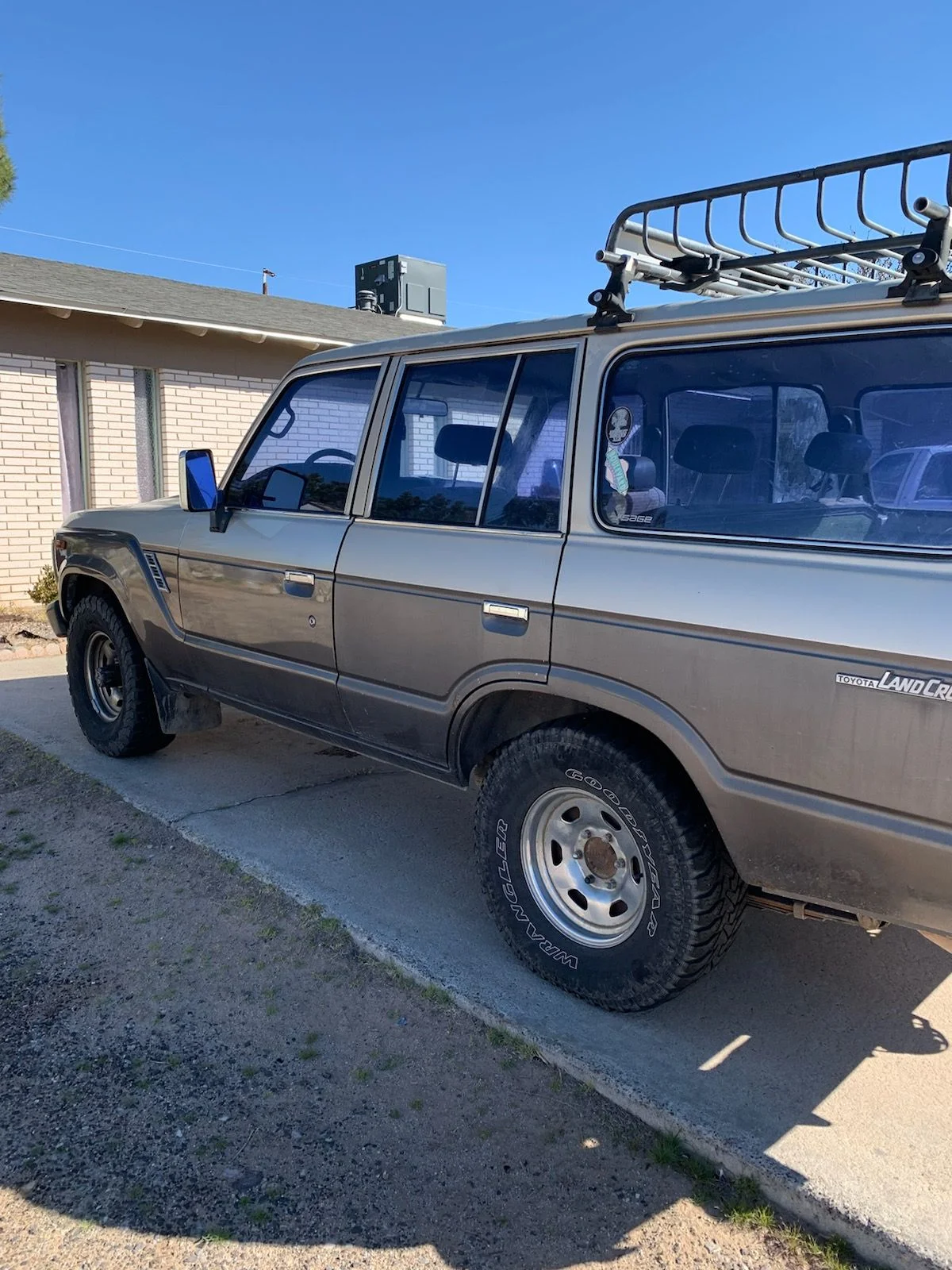

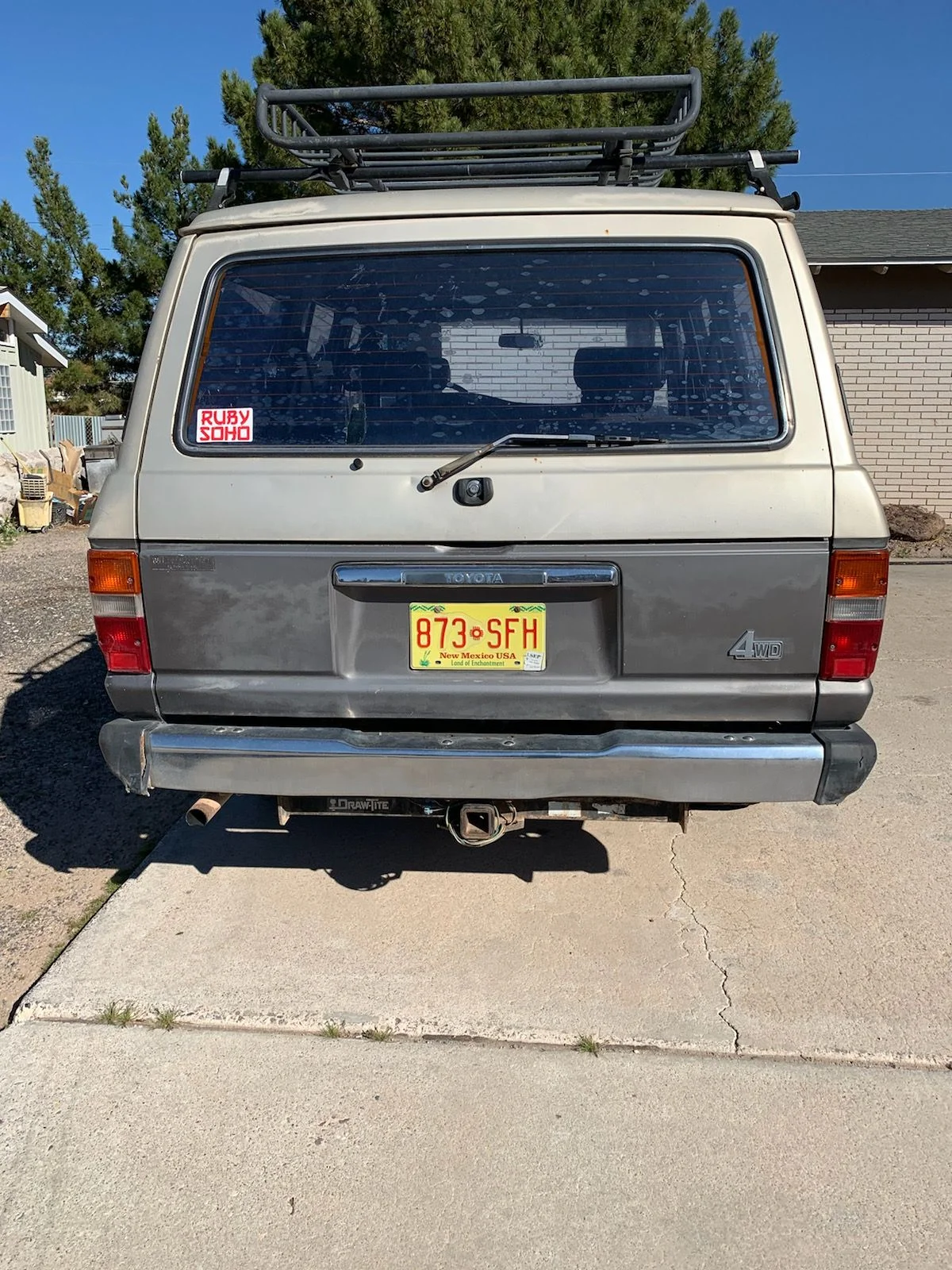

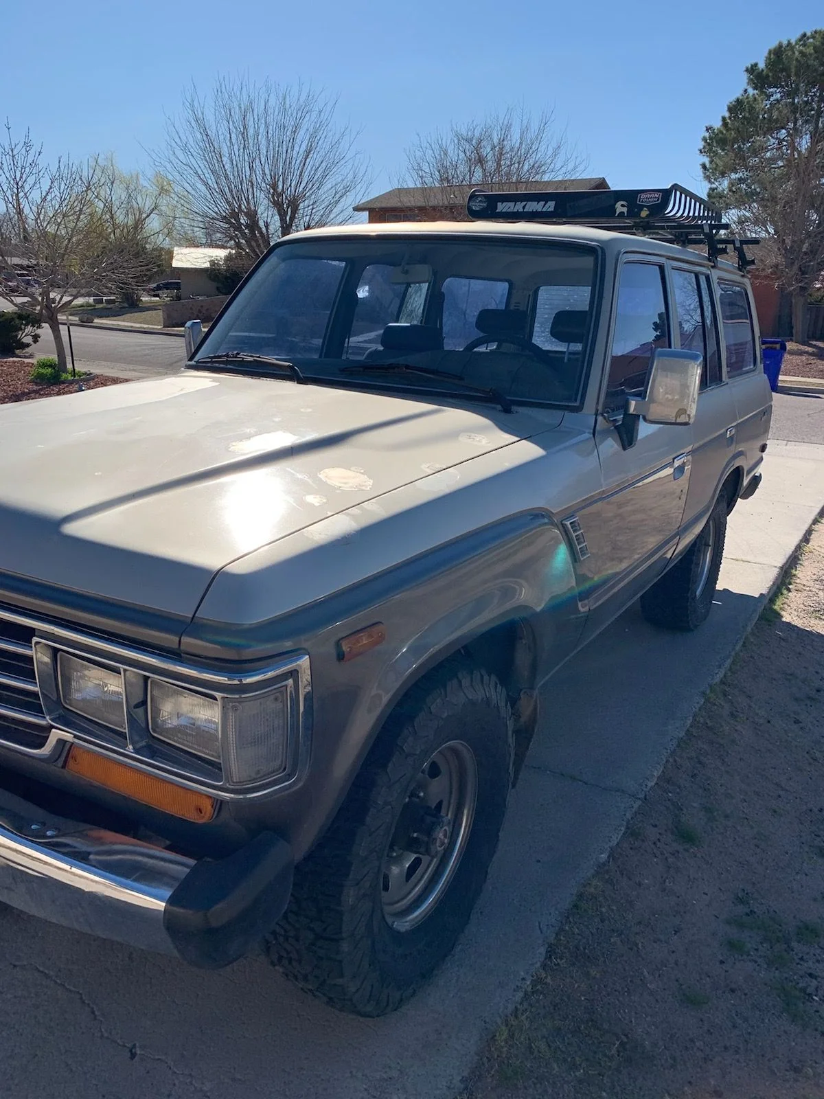

Hi yall. I am about to get a '89 LC. Im trying to get all the info I possibly can. He told me it has a few problems. The major being "the transmission has problems. I will be able to make it to work probably. But it slips on the highway." Starting I'm going to do a filter fluid change. Any preferences for the best additive? He said it a has a t?? (Like t56) But I thought a440 was the trans that came with it. I know he said 4 speed with over drive. Does this sound correct? Possibly looking at rebuilding it if need be. I am fairly comfortable with it. Rock auto has a 275$ kit. Even 3 screw ups is cheaper then buying a rebuilt one. The water pump leaks. Then I believe he changed the 2 front windows from power to manual. It has 300k on it. Missouri first 13 years then 18 in Las Cruces. No rust. Besides what I listed what should I do?? Of course a motor tune up as well. I appreciate everyone's input.

Check the frame for rust, don't take him at his word, look at the frame especially around the rear c channels where they open up, and where the front of the rear springs mount to the frame. At 300k look carefully at the motor, pull some spark plugs and look at there condition. Make sure the head is not cracked and fouling the plugs. Make sure the oil fill cap on the valve cover has oily goo and not dry exhaust carbon in it. Run the motor at various rpms and listen for a miss. Drive it up a hill in a lower gear and make sure there is no power loss.
The torn driver's seat is normal..they all do it on the side. The clear coat is gone, the antennas is broke, the dash is cracked, the glass tint film is trashed, so make sure to consider and point these out when making your offer.
Check to make sure the front knuckles are not leaking gear oil down the inside of the front wheels and tires. A bit of caked on grease is fine, but oil running down onto the wheels and tires means the axle seals are gone and the gear oil can leak out of the front axle.
Look at the spring bushings...where the springs attach to the shackles. If the shackle pin is not centered the bushings are worn and will need replacement along with replacing rusty shackles and pins.

On paper, that FJ62 probably needs $10K in repairs, as well as a paint job. Pay accordingly.
