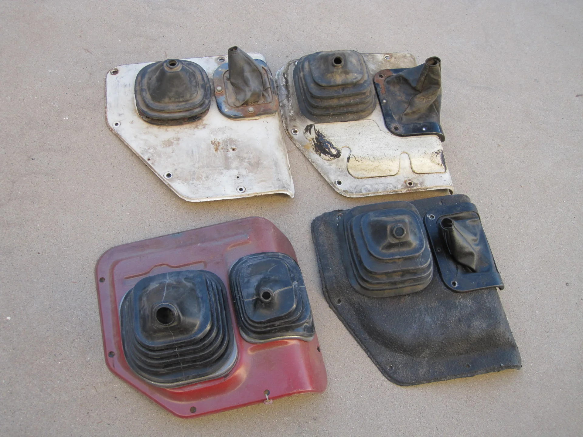

Here are four covers. Upper left 1/79-10/82 40 series four speed. Upper right 40 series H55F five speed. Lower right is 40 series 10/82+ with either a H41 or H42 four speed. Lower is a 4/85-7/87 FJ60 inspection plate which is the same as a H55F. Both four and five used the 3F bellhousing.
If you end up with a 60 series H55F might consider grafting in a 60 series inspection cover.

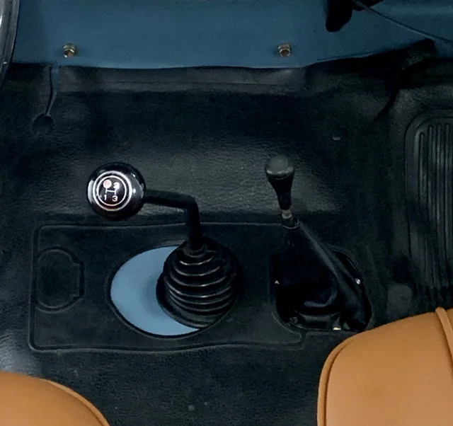

Not sure if this helps, but here’s 10/72 hump with a 74+ floor mat. You can see the off set difference in the cut out.
@KingAir Driver Thanks for the photo. The 74+ mat fits the 4 speed shifter location.

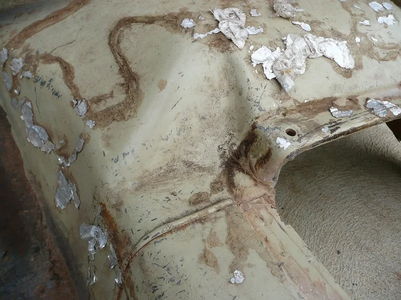

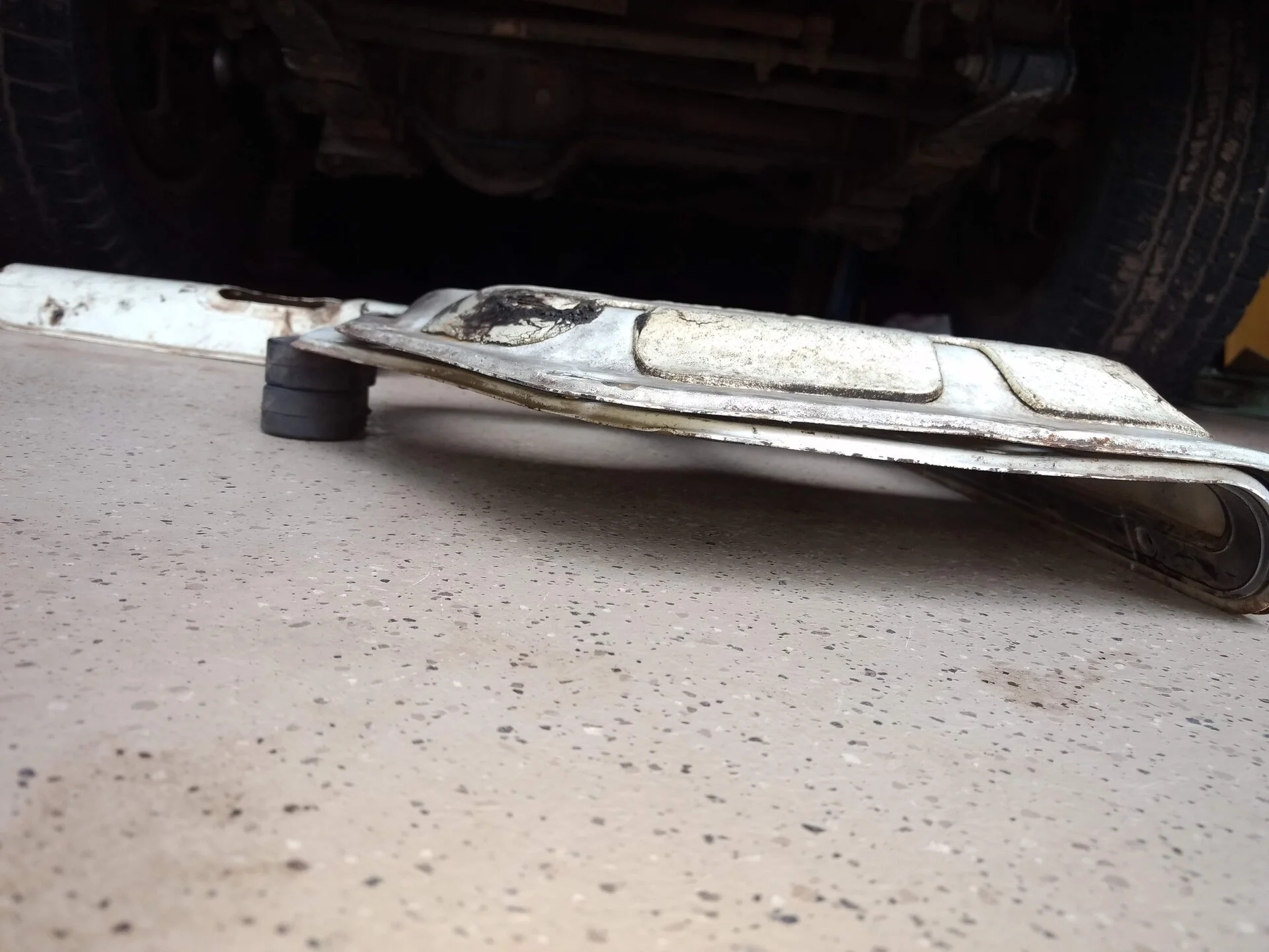

These pictures highlight the change in height in the transmission section of the tunnel 10/82. This was because of the H55F five being used in some 40 series. This change was on all 40 series built. Didn't matter if it had a four or five speed.

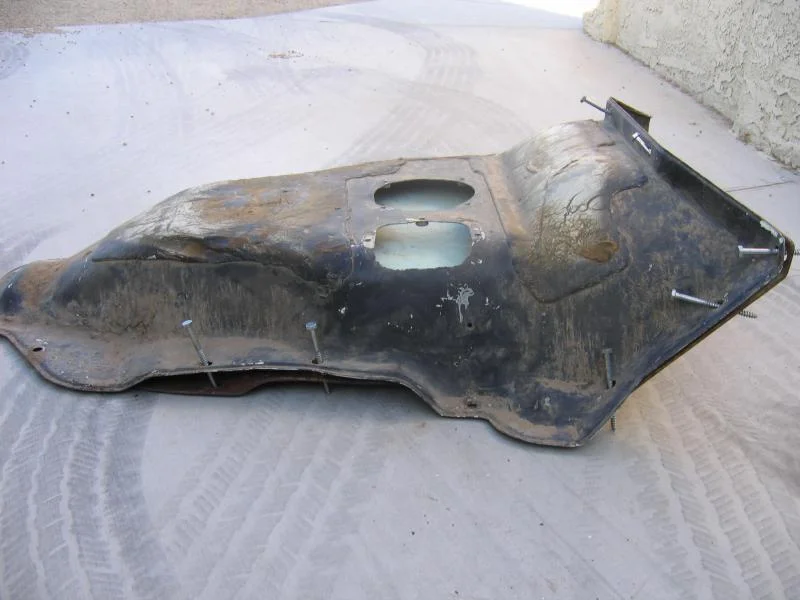

Found this picture I saved off of mud.
Shows a 4/85-7/87 inspection cover on what appears to be a 72 FJ40. The location of the knob for the defrost on the heater and the seat frame would only fit 72. The transmission cover on your 73 should be taller. Best picture I can find showing the difference.
Another thing the 73 model has four fixed nuts on each frame rail for either a three or four speed skid plate. I have found the split case skid plates both four and five speed would use the back three holes.
Another thing the taller transmission hump over the shorter one is why the raised edge along the side is different. While my 73 the vacuum shifter was gone other markets with both three speeds and four speeds still had a vacuum shift option. That's why the raised section stayed the same in the front and got longer in the back.
