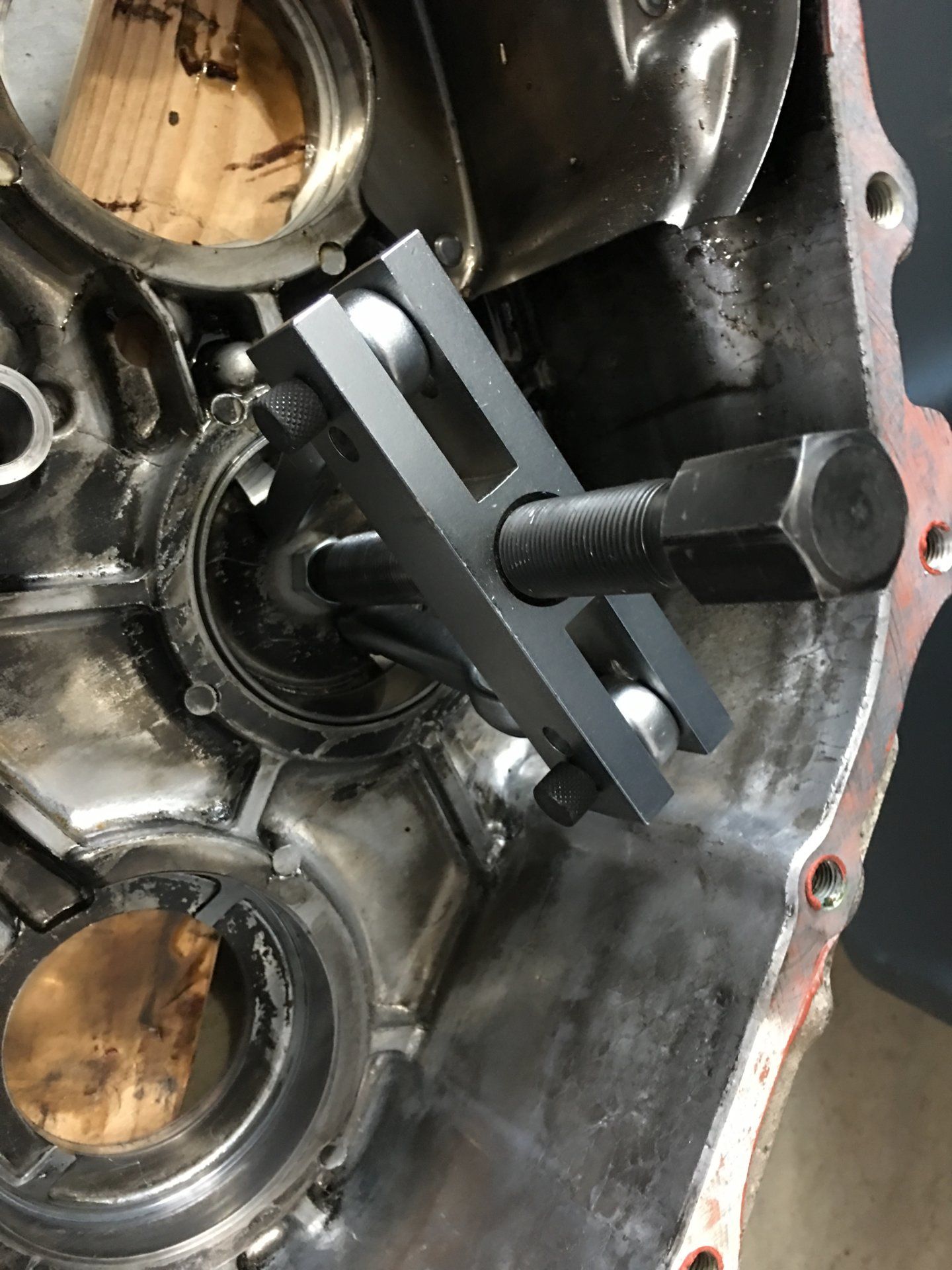

Used a differential side bearing puller to pull the inner race.

Have a large jaw puller, it helps with some gear removals
If your doing the bearing in the front housing, get your patience in order. Its hard to remove, the gear pull is odd and removing the shaft is not at all like the FSM states.

Agreed on the front bearing access gear pull... I had to think on it for a night; my puller that was long enough was too wide to fit that deep. The one narrow enough was too short... I ended up using the flat metal pieces from the large puller to double the length of the flat metal plates of the small puller to make the narrow puller longer. Still just barely fit within the case walls.
I did similar. I hacked together a puller from my steering wheel puller, some allthread rod , bolts and thick washers to get under the gear. Barely worked, but it did. It's the length to get down inside there and the tight quarters that is the catch.
