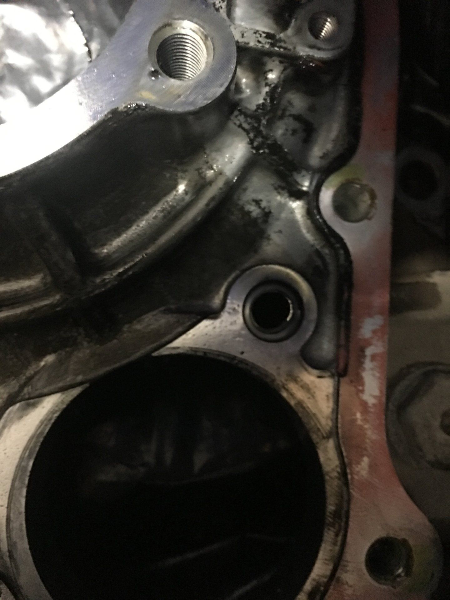

Finishing up with getting the housings bare for cleanup and the front housing is not budging. In working on it one of the pry tabs broke off. Not fun when things like this happen but I wanted to share how it doesn’t always go right to encourage those of you out there in the same boat. So stopping for a break to re-evaluate.

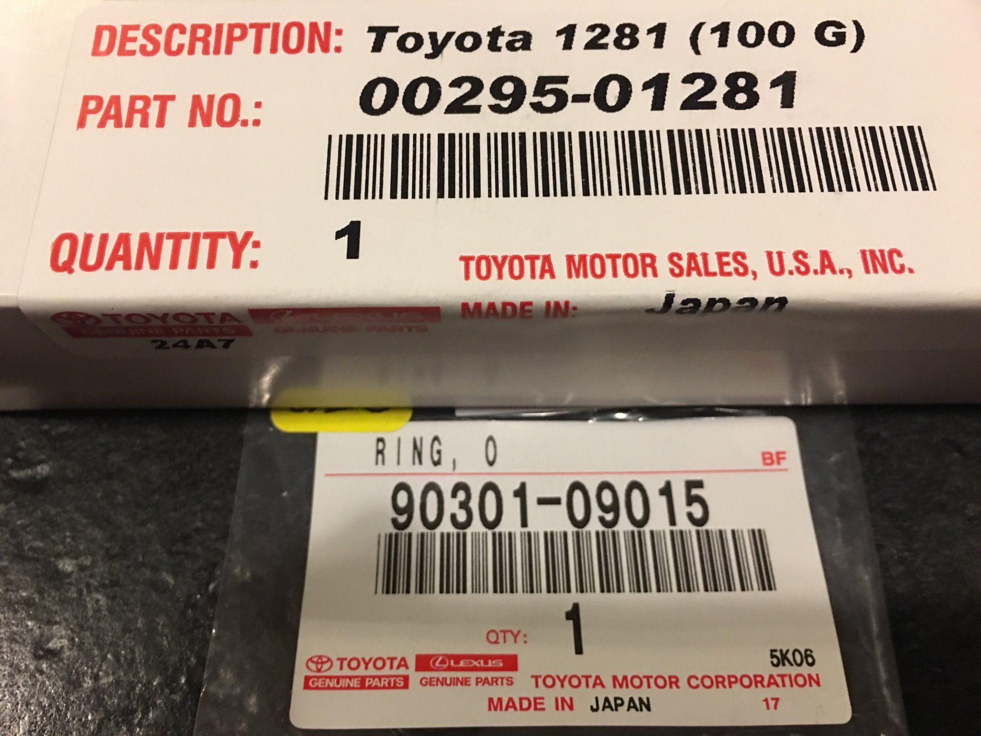

The case has an oil pump and an Oiler tube inside that requires an o-ring that appears to be discontinued. 90301-09015

Well, it turns out the o-ring is available after all. So glad to get an OEM one as I didn’t want to risk a substitute rotting to pieces. Picked up one and some FIPG.

@thetoyotaman, Were you able to get the front housing off? I was having similar trouble when I was doing my front bearing and seal about a week ago. I had to actuate the cdl/4h switch a couple of times and then left it in the engaged position and I was able to get the front off.
(note: you will need to make sure the cdl/4h is in the off position - clutch back to allow for the front housing to go back on smoothly)

Haven’t had time to get back to it yet but thanks for the tip. The housing is in multiple pieces except for that and I’m also having trouble with the shifter on top coming off.
I broke off one of those tabs also. I figured they were there to help pry but didn’t hold up to a tap of the mallet. Used my trusted filed down flathead screwdriver to wedge between the half’s.
So, I'm not missing anything here then? It's just tight. Remove bolts and find something to separate it. Thanks! (Now to find the time...)

While I've never separated that case I have done some Subaru motors before. Getting a butchers knife or any other decent size knife and putting it in the seam then wacking it with a mallet works well. Maybe it will work here too.

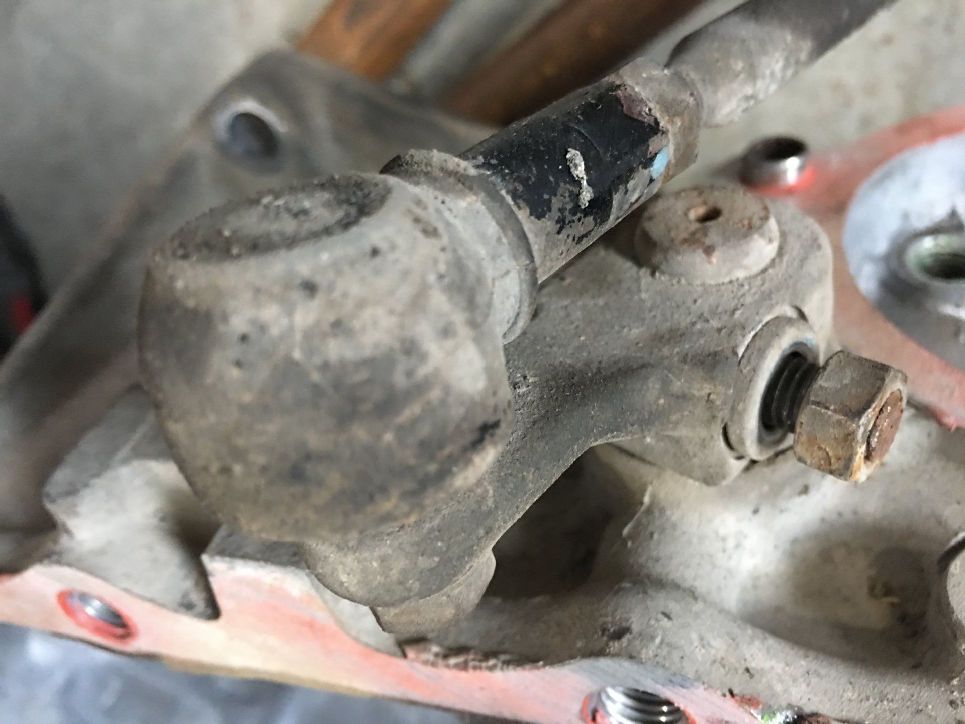

Had some time today to finally get back to this. Sure enough I was able to separate the front output shaft housing with an old engine gasket scraper and pressed out the gear and output shaft with a press. It’s a tight dowel that holds it in. Then I tapped the bearing out with a small punch put on the outer race.
Last thing is how to remove the lever as there is an oil seal in there I need to remove. Any tips here?
