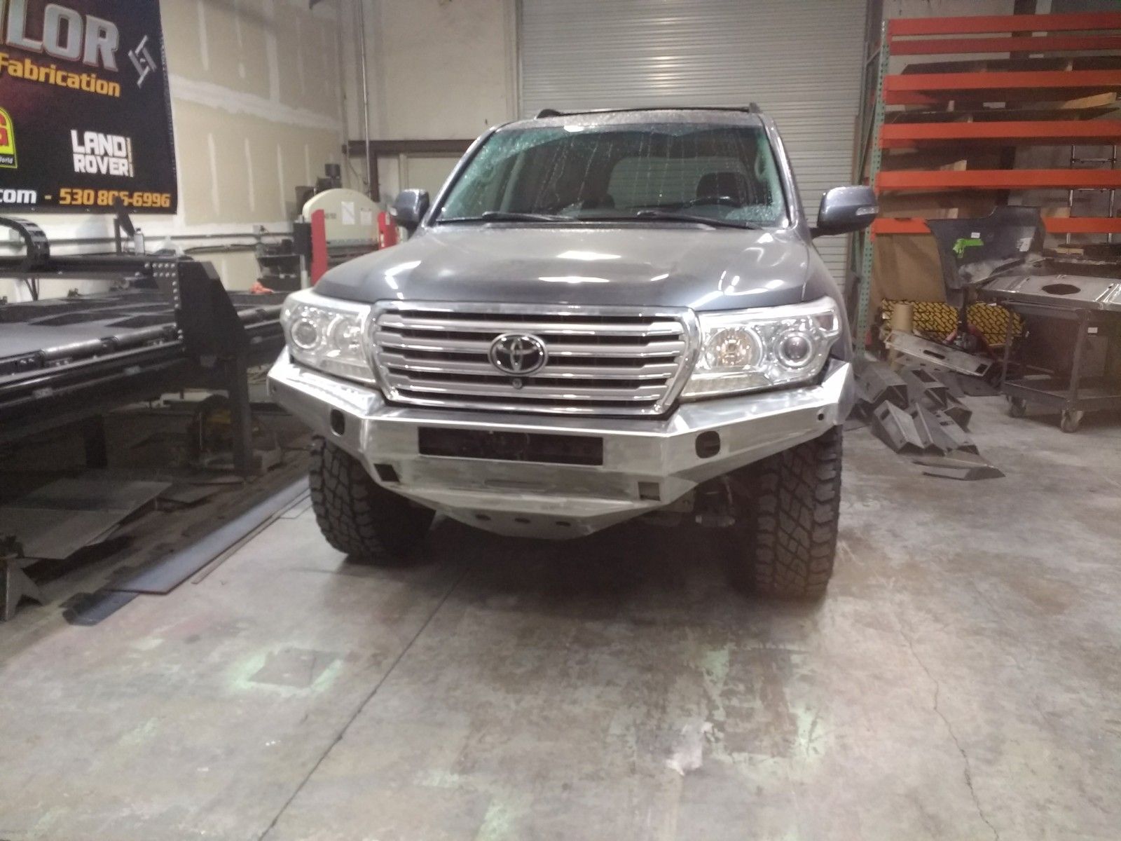

are the fogs beaming straight or following the contour / angle of the bumper wings?
How do those recovery points work? Do you slip a recovery rope though them and attach to something inside?
Traffic in the lanes next to you will love those fog lights Tony!
Outward. They're cornering/spread lights for outward beam, not fogs.
There will be a pin in the middle of the pocket. Wrap a soft shackle around and you're good to go. That red thing hanging is the soft shackle.
