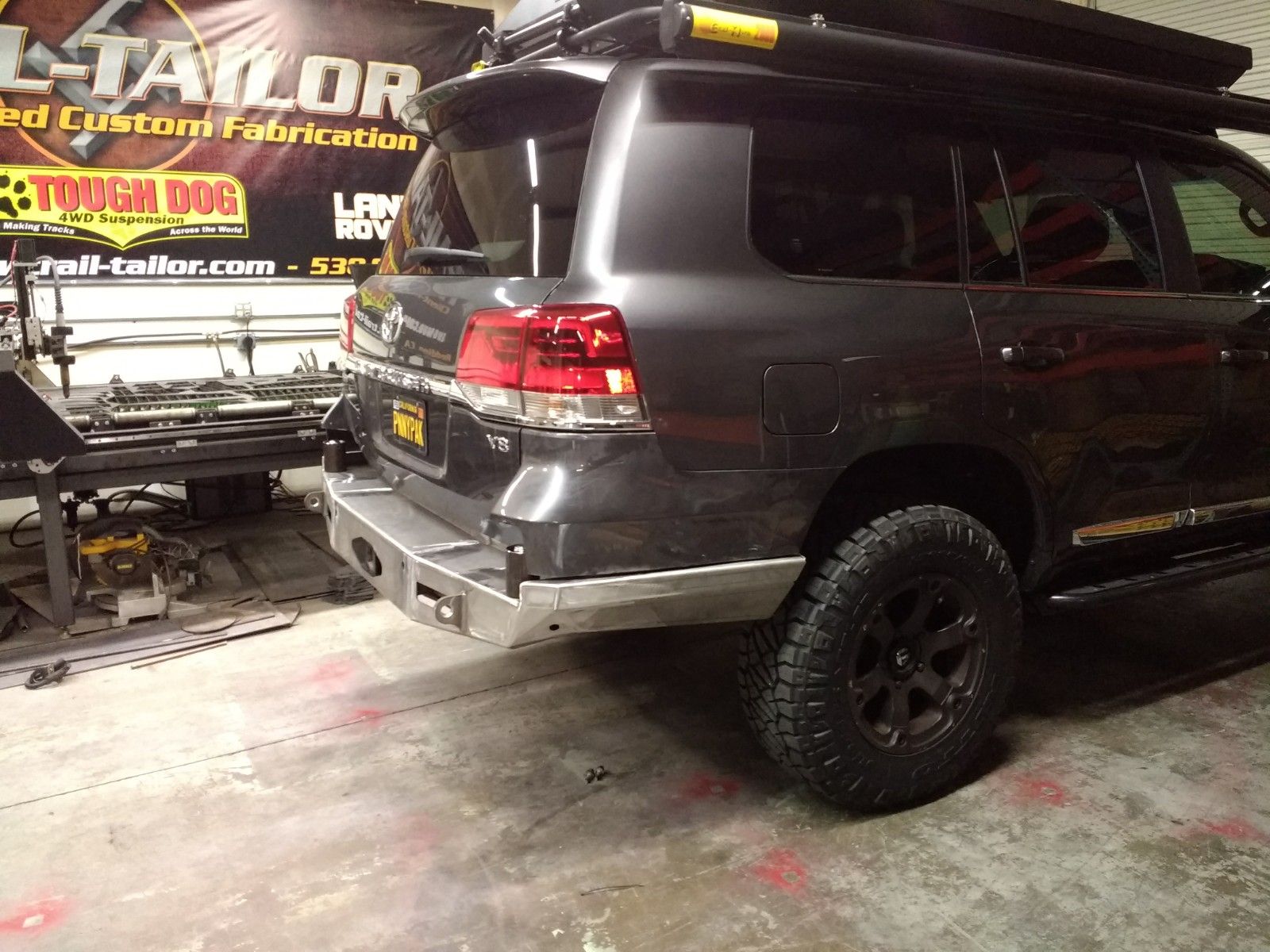

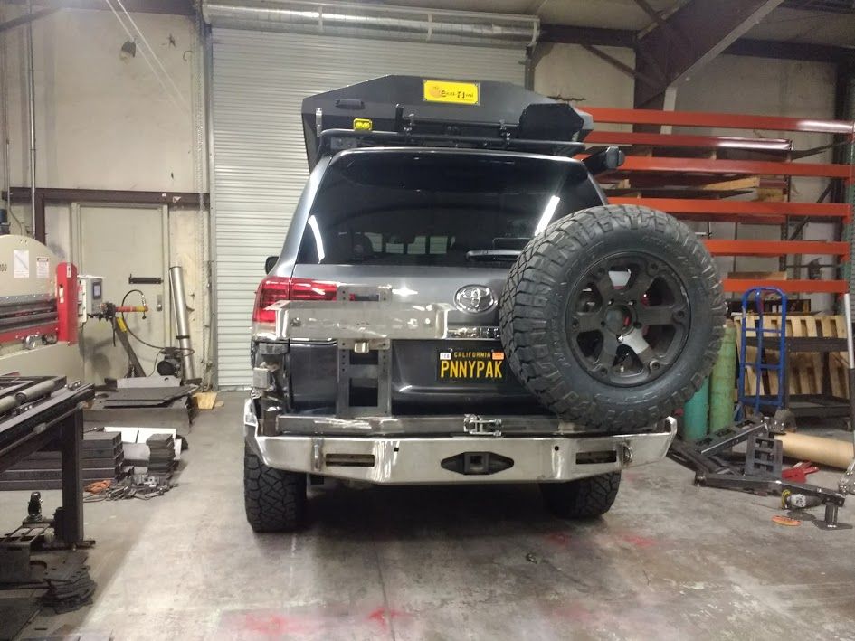

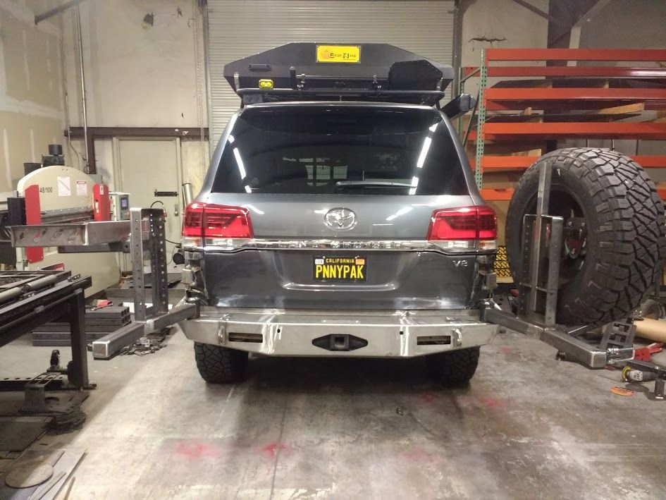

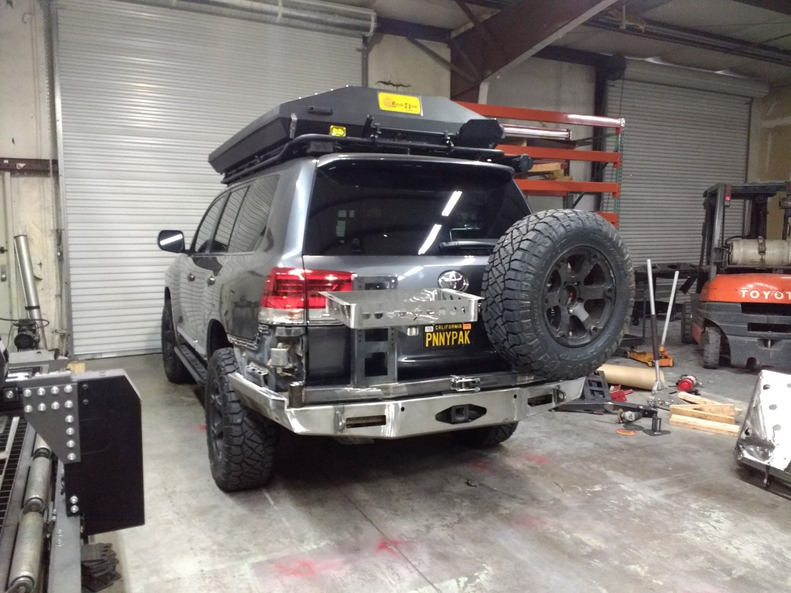

@TonyP rear is finished. @indycole will be finished in the morning. I don't have anything left today guys. Been on a 18 day run and need a afternoon off.
Rear base weighed in at 130# added about 16# over T's old one. Hi-Lift mount is good to go as well.
J
With the cut, tuck and underpan to the frame, the new clearance is 2.38" higher than T's old bumper.
Tony's done gone Hollywood on us and got a butt-lift... :moon: :hillbilly:
Nicely done, Jason! That's some serious improvement.
I like how you extended the full wing to the frame instead of the typical arm supports (am I seeing that right in the photo?). Gotta be super strong.

Thanks Mark! I told T yesterday that I jumped in the forklift and while I was about to fork the rear of the bumper.... I told myself... "well dumbass... yes, it'll pick up the whole thing..." The underpan is bolted and skinned directly to the bottom of the frame... HA!

M, it still has a wing/arm support as well and you are correct the entire wing wraps and bolts to the frame. 10 bolts hold it to the frame.
