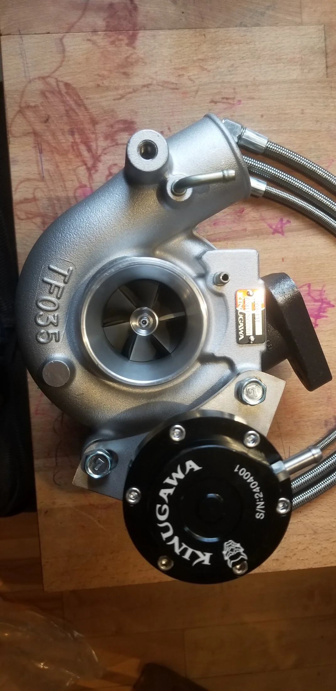

Yes, I can't wait for the Kinugawa package to show up.

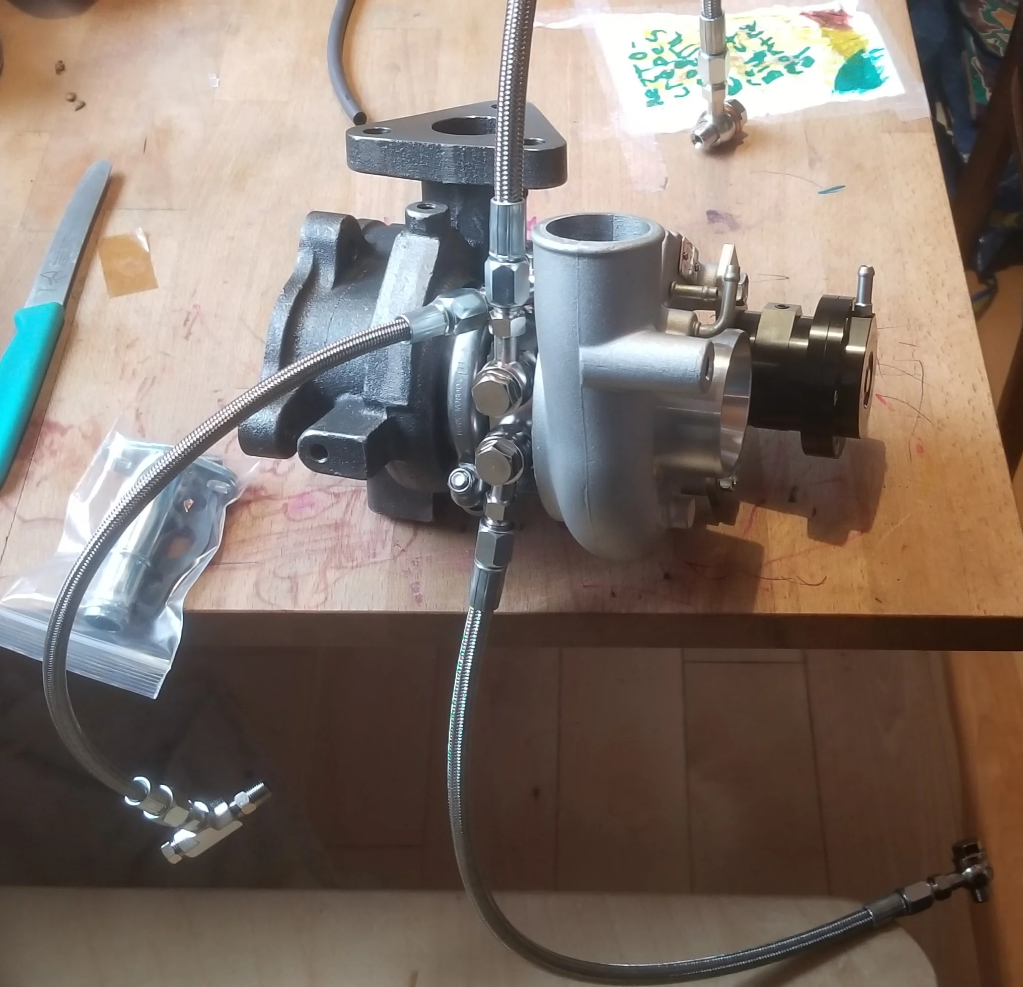

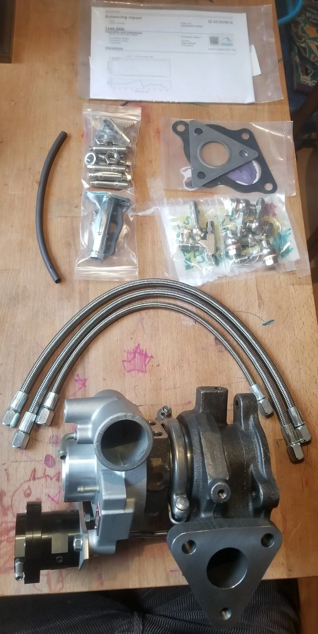

Here it is, no extra duties or brokage charges as advertised, along with all the little bits & pieces to plumb the coolant & oil from the block to the turbo (minus the oil pan return hose & bung into the pan as they don't sell those). Next step, attempt to see if it physically fit inside engine bay using stock manifold, but modifying the stock short section downpipe to attach the TD04-13T.

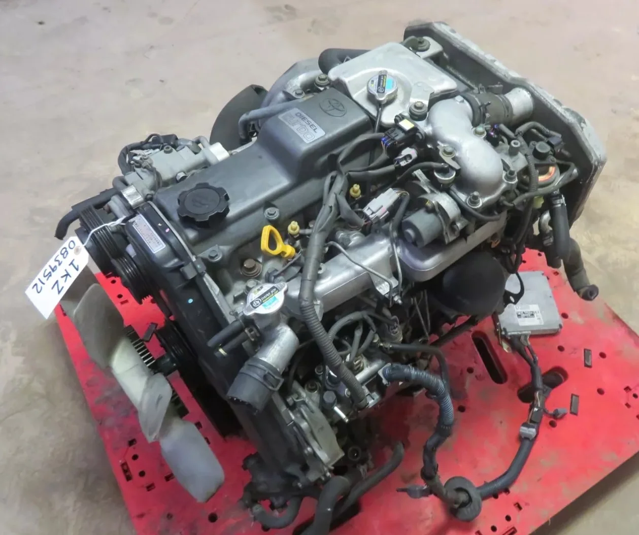

I’m pretty committed to the 1kz swap at this point, dare I say, a bit excited. I got a pretty good deal on an engine which should be getting delivered this week. It came from a hiace and has a factory water to air intercooler. No idea how effective they are, but really cool nonetheless and I want to give it a try:
Biggest concerns are clearance in the front, the top, and of course those damn shifter linkages. If I Can make the 1KZ fit, I'll definitely part out any bits you want.

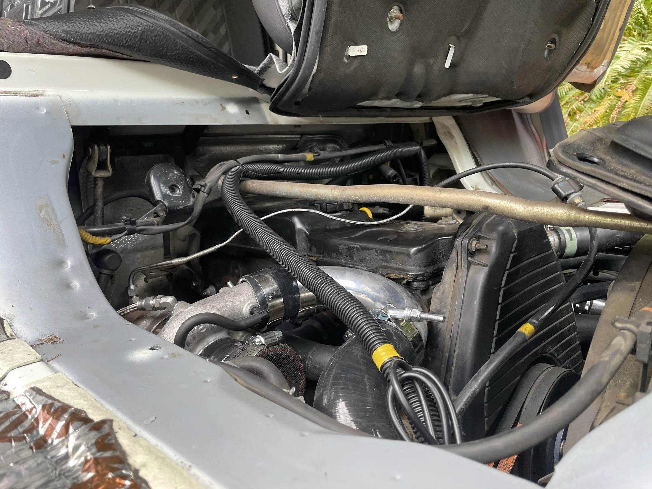

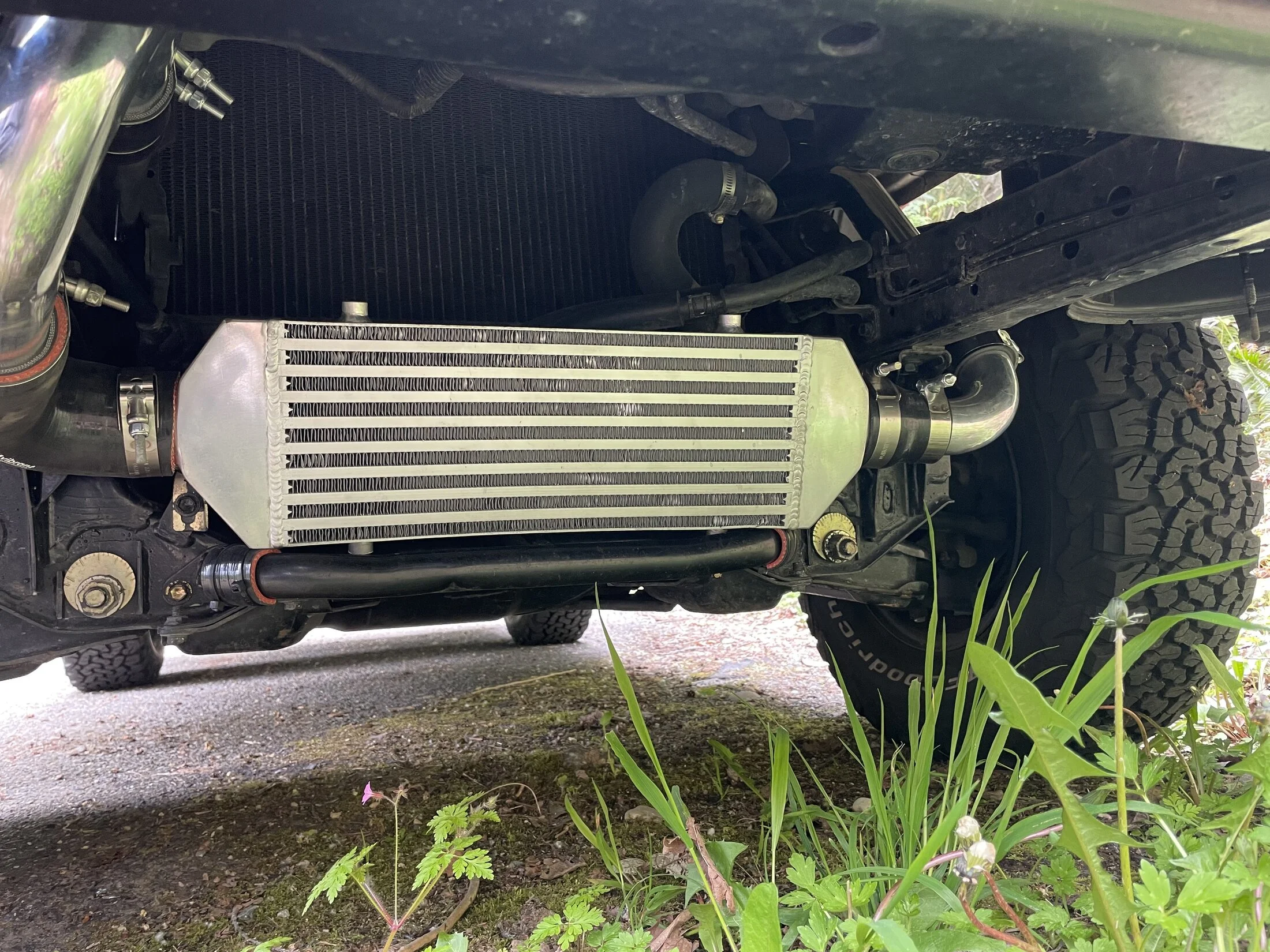

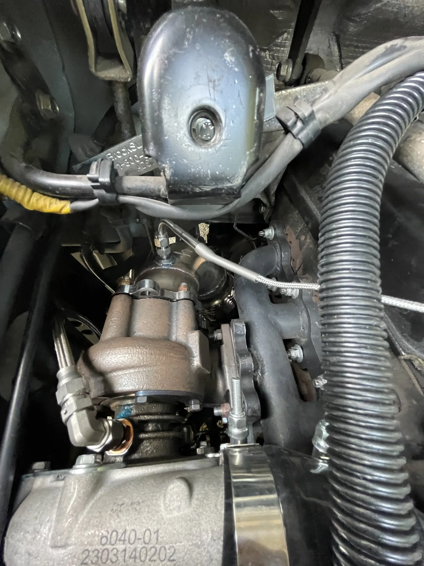

It took a lot longer than I was hoping, but the turbo is finally installed and operational. I still need to find a good solution for the air intake (possibly a snorkel), install boost controller, install boost compensator, and tune the fuel pump, but it currently runs great. Couple of notes on the install:
  • Nether of the manifolds I purchased fit out of the box. This is when I realized it was out of my skill range and took it to a shop. They were able to modify the HD auto manifold to fit the tight space.
  • The shop was able to fit a front mounted air to air intercooler which is awesome.
  • The shift linkage needed to be modified for everything to fit
  • With the modified shift linkage they were able to install a 3" exhaust, even though it's overkill

Do you remember around how much you paid for the intercooler setup at the shop and which shop installed it? I have a 3L Hiace that I added a GT25 to and am running into some heat issues. My EGT's are more than manageble but at highway speeds in the 90-100F degree range my temp guage quickly climbs to 215F+. I have tried looking into a barrel style water to air intercooler that would go over the valve cover but they are all too wide. @utleymu
