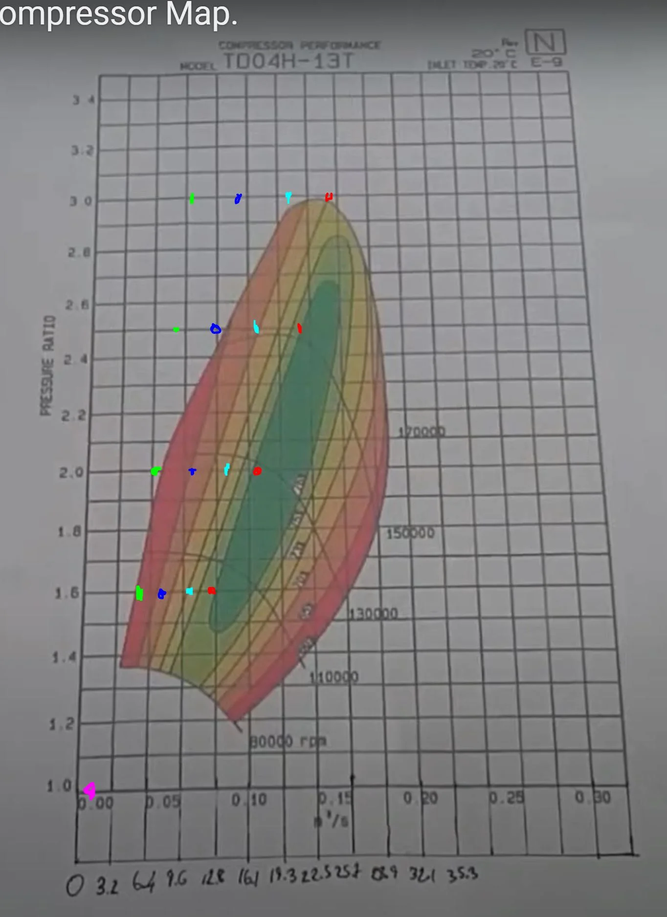

Hello, just wondering if you've got some updates to share about tuning your new setup over the last couple months. How much boost does it use, with the stock unmodified pump? Uphill impression compared to stock?
I'm about to pull the triggers on either a Garrette GBC17-250 or a Kinugawa TD04-13T, just not sure which one... (Did some theoretical calculations & plotted these map...any comments about the potential surge area at low <1600RPM?
My question is, what size wastegate actuator spring should I order (7 or 14 psi?)

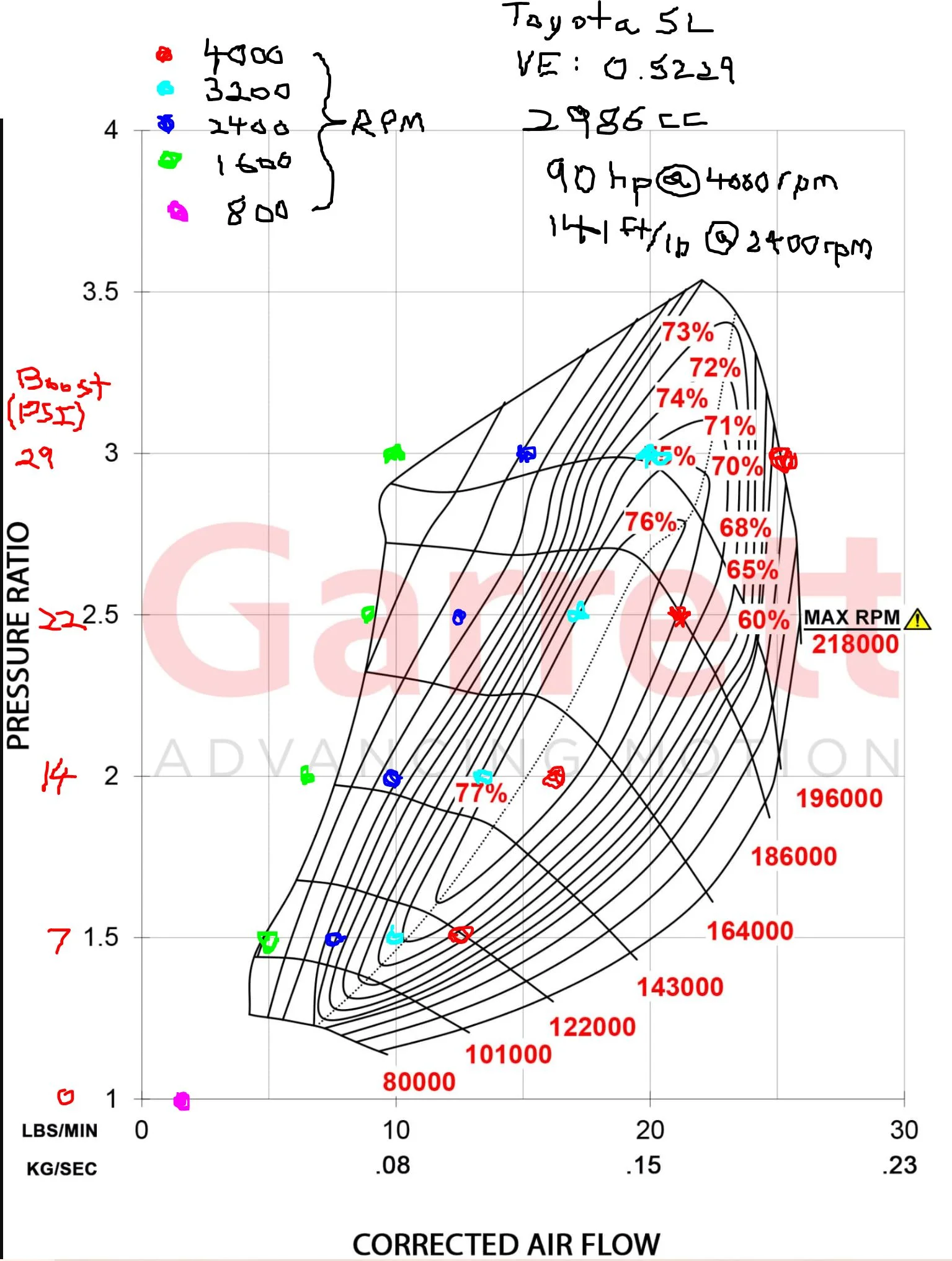

Looks far too big. You aren't going to need more than PR2 and you want the midrange to coincide with the best efficiency islands.

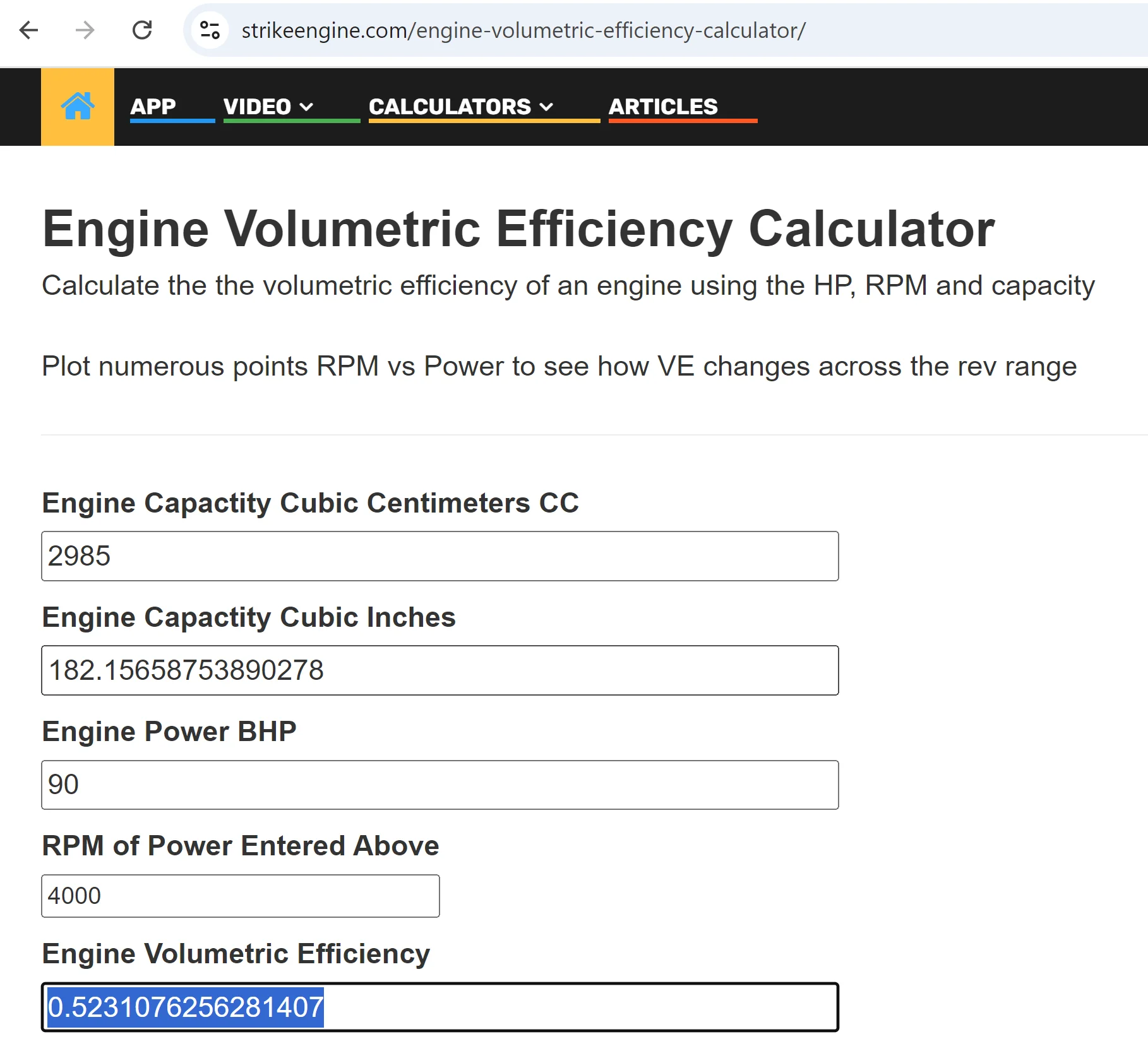

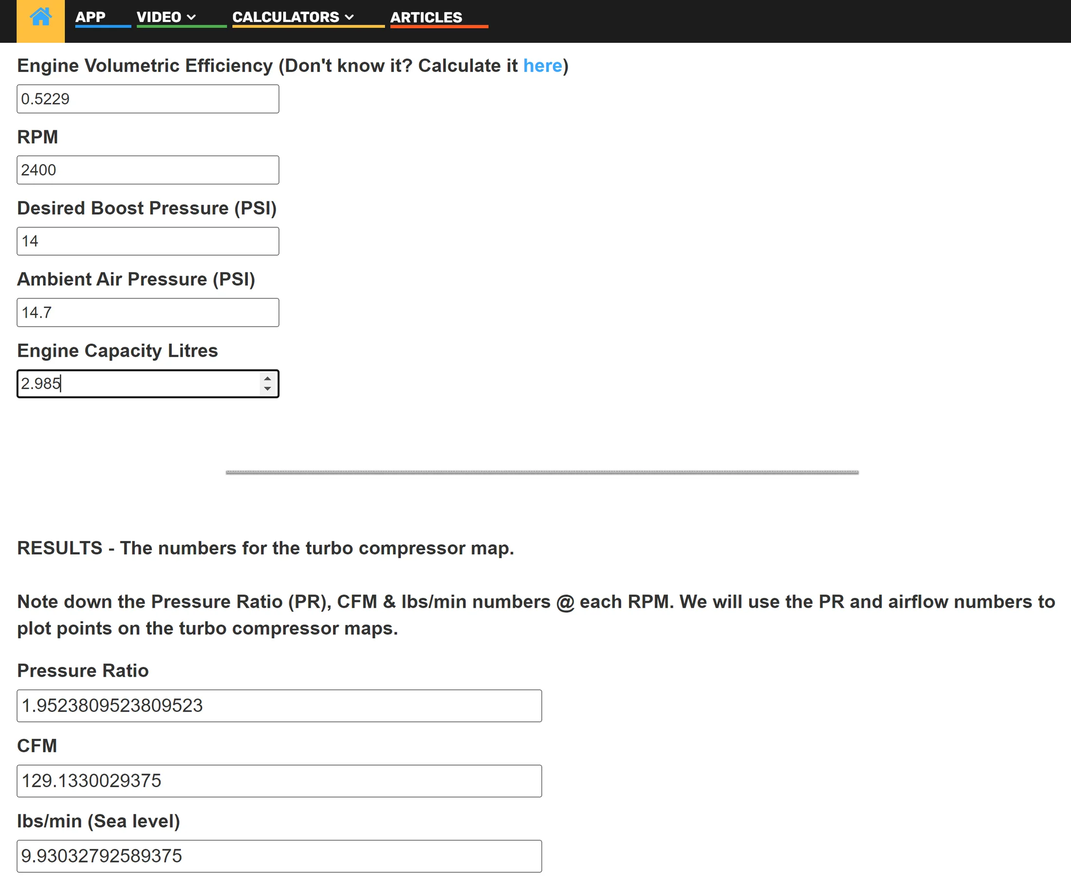

How are you calculating VE, temperature, intake pressure etc?
you want a higher rated wastegate spring than you would think, a bit higher is better to get you what you want
My first scepticism of my calculation is based on the very surprisingly low VE of 52%, based on 2985cc & 90hp@4000rpm (Toyota 5L – Engine Specs - https://www.engine-specs.net/toyota/5l.html), calculated from here: Engine Volumetric Efficiency Calculator - StrikeEngine - https://strikeengine.com/engine-volumetric-efficiency-calculator/
After that I made a table and plugged in the Pressure Ratio (1, 1.5, 2, 2.5, 3) against RPM (800, 1600, 2400, 3200, 4000) into this calculator (Turbo Size Calculator - Find CFM & Pressure Ratio - StrikeEngine - https://strikeengine.com/turbo-size-calculator-find-cfm-pressure-ratio/) to obtain Lb/min numbers, so they can be plotted on the compressor map x-axis.
i.e. 10lb/min from using PR of 2 against 2400rpm
So if my calculation done above is correct, both plots do show GBC17-250 & TD04-13T to be a tag too big for the 5L when surging below 1600pm.

That's a petrol/gasoline engine VE calculator that won't work for diesel. I would use 90% VE for max torque and 80% for max power. Recalculate with those. PR2 is your maximum. I wouldn't go past 10-12psi on an engine not designed to be turbocharged.

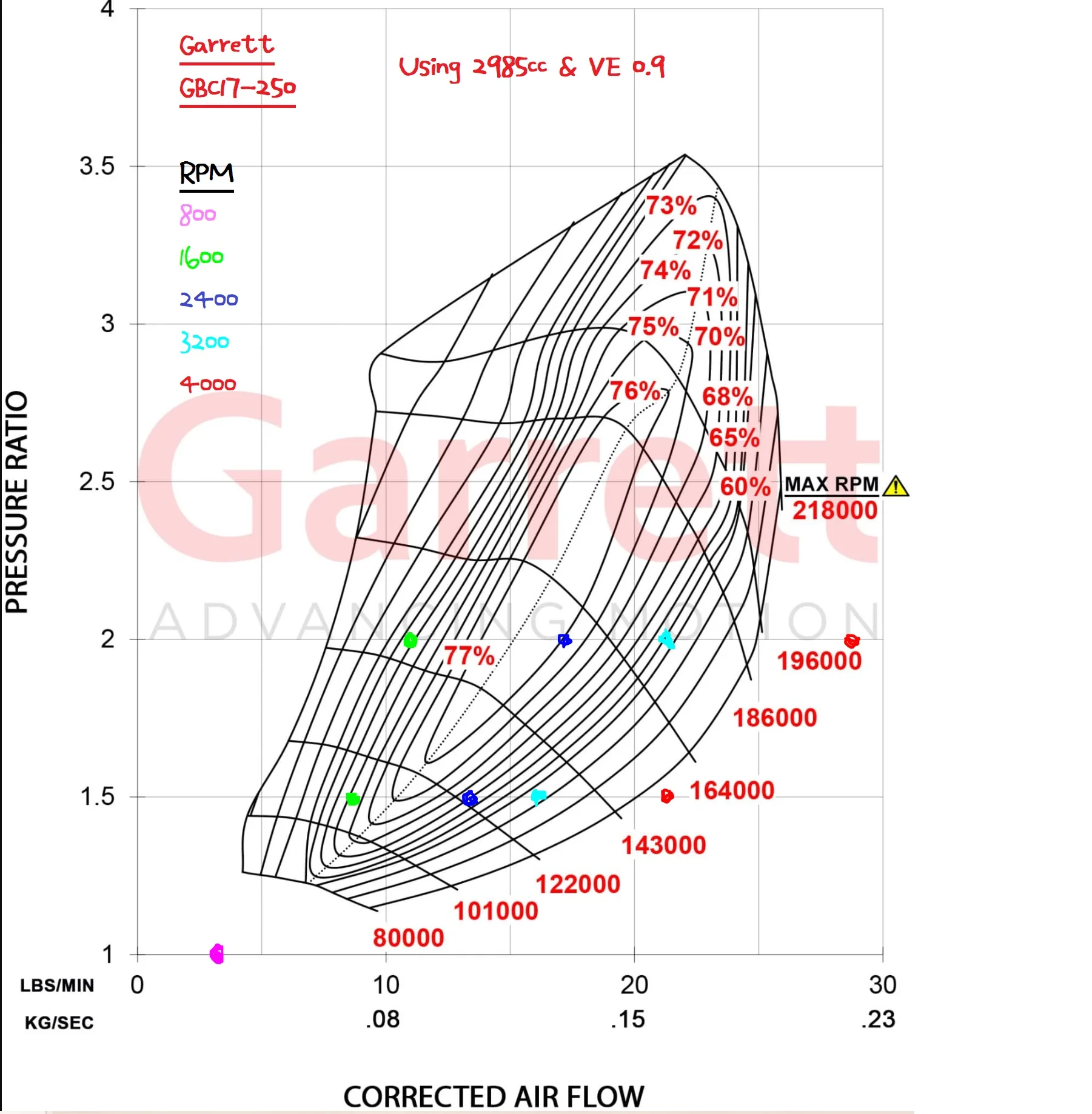

Thank you all for the input. I've recalculated by using VE of 0.9 (not calculated this time) & plotted the points again on these 2 turbos:
On a 2985cc (5L), the GBC-17 seems to choke at 4000rpm while the TD04 is still within its max choke limit.
Just based on these 2 plots alone, what can we conclude on? The points seems to land on the TD04 efficiency island a bit nicer, maybe it's because it's slightly bigger?

TD04-13T compressor is looking good. What turbine size is available?

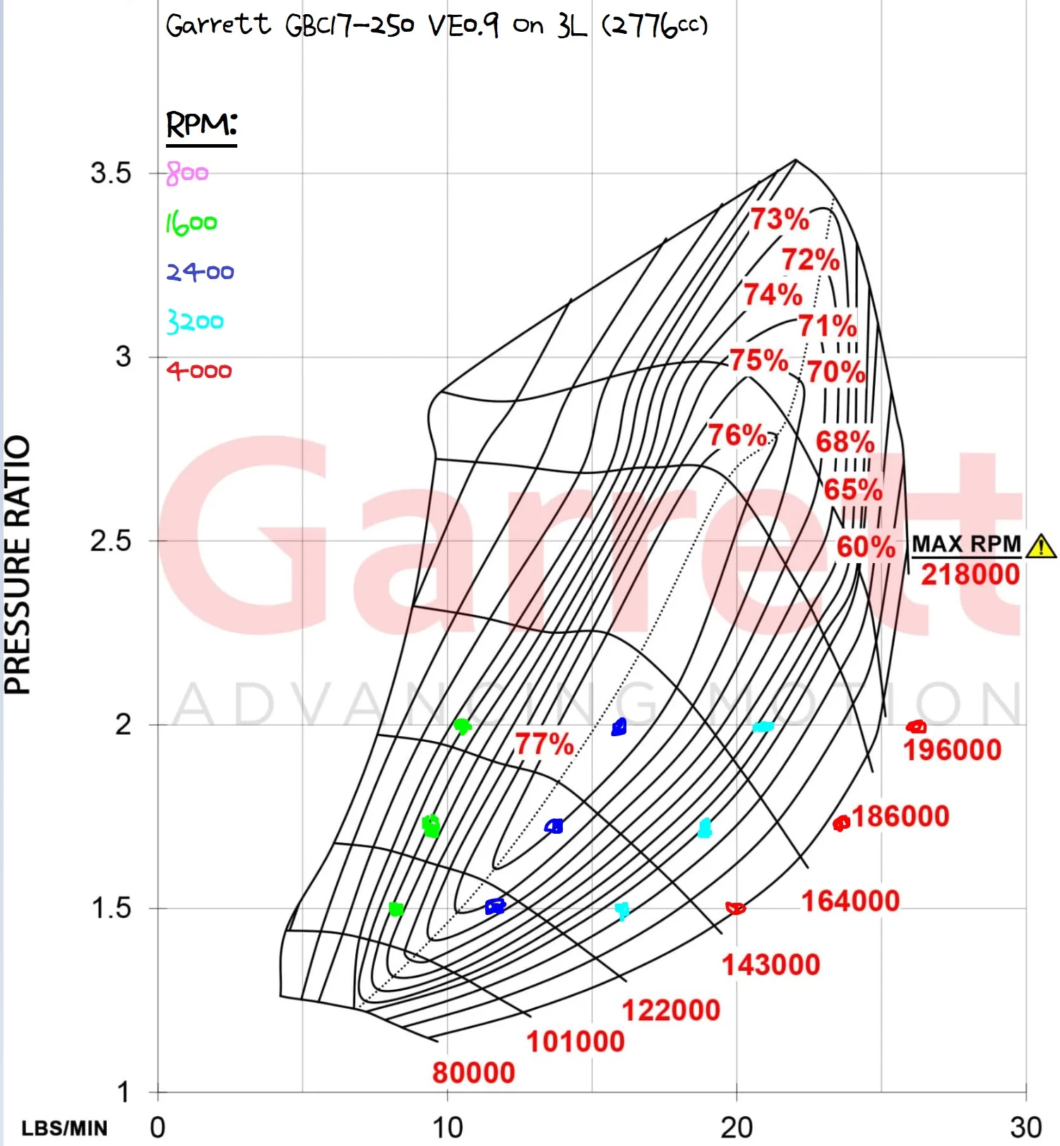

I've included below a compressor map using Garrett GBC17-250 & 0.9 VE for the 3L (2776cc). When reving at 4K rpm, this turbo seems to be slightly less choky on a 3L, than the 5L (notice at PR1.5, it's right on the choke limit).
