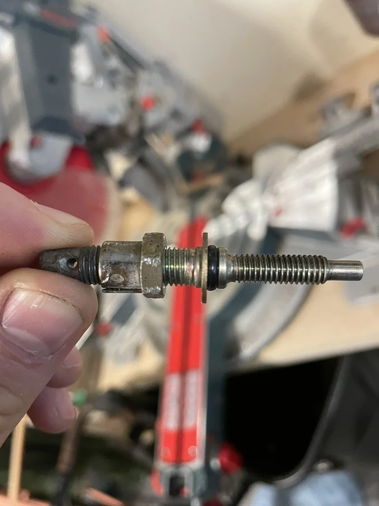

-You've mentioned turning in the fuel screw for 1 turn. Is that the 5mm allen set screw? The fsm (page EG134) says injection volume increase about 3cc per 1/2 turn.
There's only one fuel adjustment screw on these mechanical pumps (that I know of) and it's located on the back of the pump. If yours has never been adjusted, it'll have an anti-tamper ring on it. Some have had success removing the anti-tamper ring while on the pump, I found it easier to just remove the bolt altogether. Just make sure you mark where it was previously set.
-How you are determining how much fuel to add? Just by looking at EGT (<1200F) & no black smoke while driving? I've been thinking of installing a AFR gauge (i.e. https://www.justraceparts.com.au/spartan-3d-diesel-wideband-air-fuel-ratio-gauge) about 1 meter downstream from turbo to measure & tune AFR above 20:1.
Yea, it's a bit of trial and error, but pretty simple since there is only one adjustment screw. I just turned it in an 1/8 of a turn at a time and hit my local freeway climb. AFR gauge would be nice, dyno tune would be even better. I don't know that either is totally necessary. From what I understand, your EGTS are the primary metric. If your AFR isn't right, your EGTS will either be high or low. Low EGT's (running lean, higher than necessary boost) isn't the worst thing, it just means you're running higher boost than necessary. Obviously, high EGT's are what you really need to avoid.

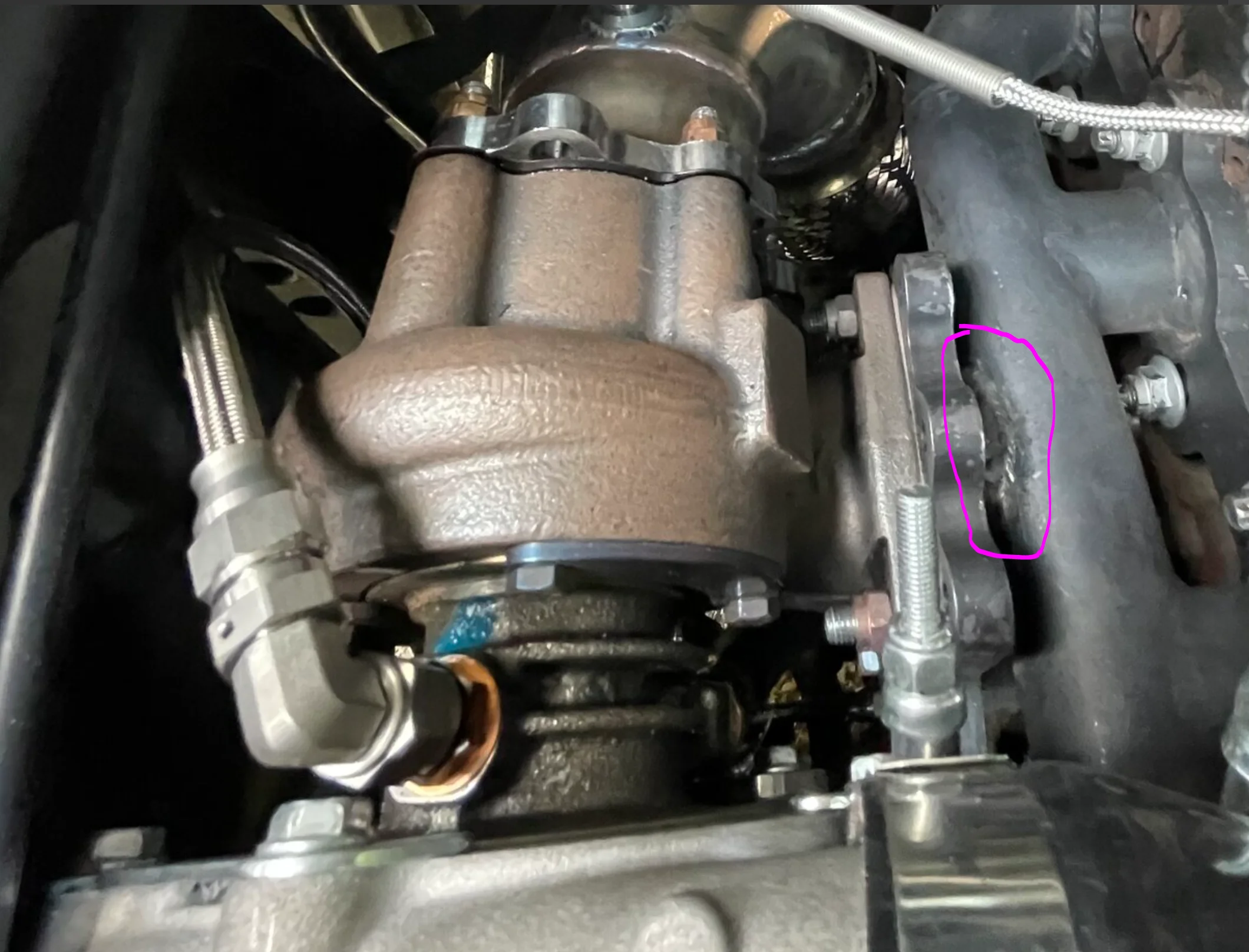

Utleymu: I've had a closer look at your previous posted pic. It seems like your collector tube of the HD exhaust manifold got shorten and angled flat/horizontal to allow your turbo to fit against the frame rail. Is that what I'm seeing? How much clearance is there behind your downpipe to the cab?
That's correct, basically moved the turbo lower (to avoid hitting the top) and closer in to the engine (to avoid hitting the tire well wall). Off the top of my head, I'm pretty sure there is still some clearance between the dump pipe and cab. The issue is, that's where all of the shift linkage components are.

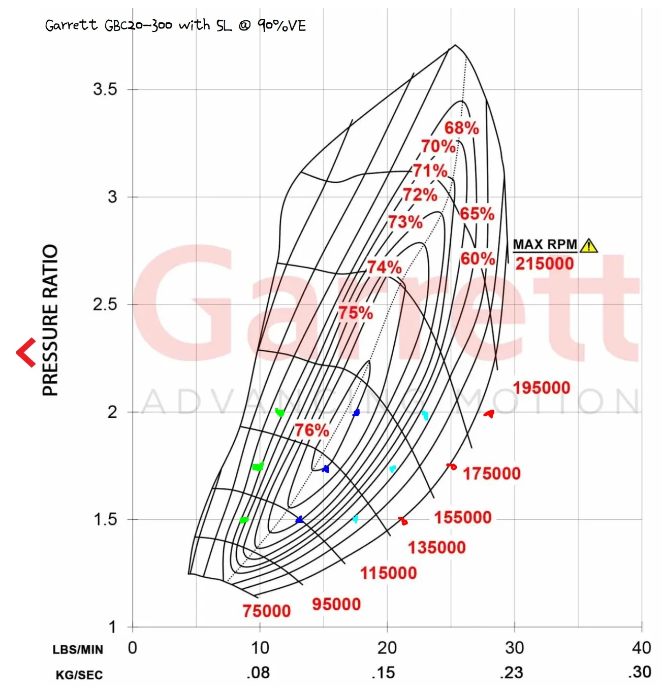

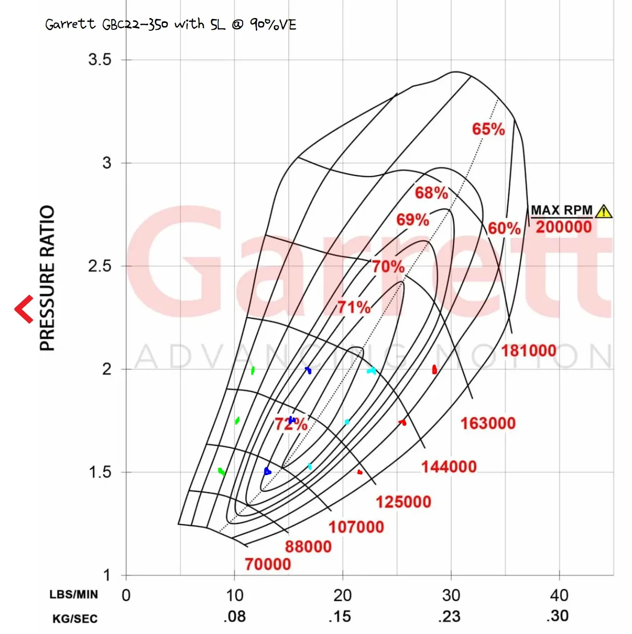

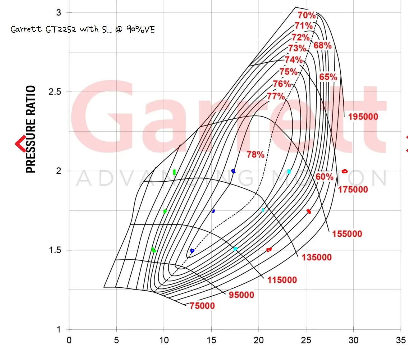

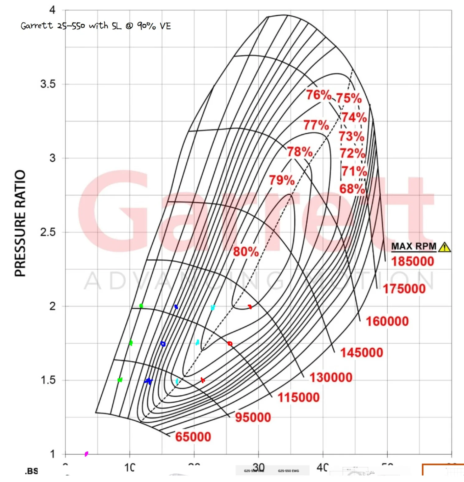

Another option you might want to consider is the gbc20. I believe it is the same physical size as the gbc17, but might be a better fit for your larger displacement 5L. I'm not sure how the TD04 dimensions compare, but smaller is going to be better when it comes to getting everything packaged.

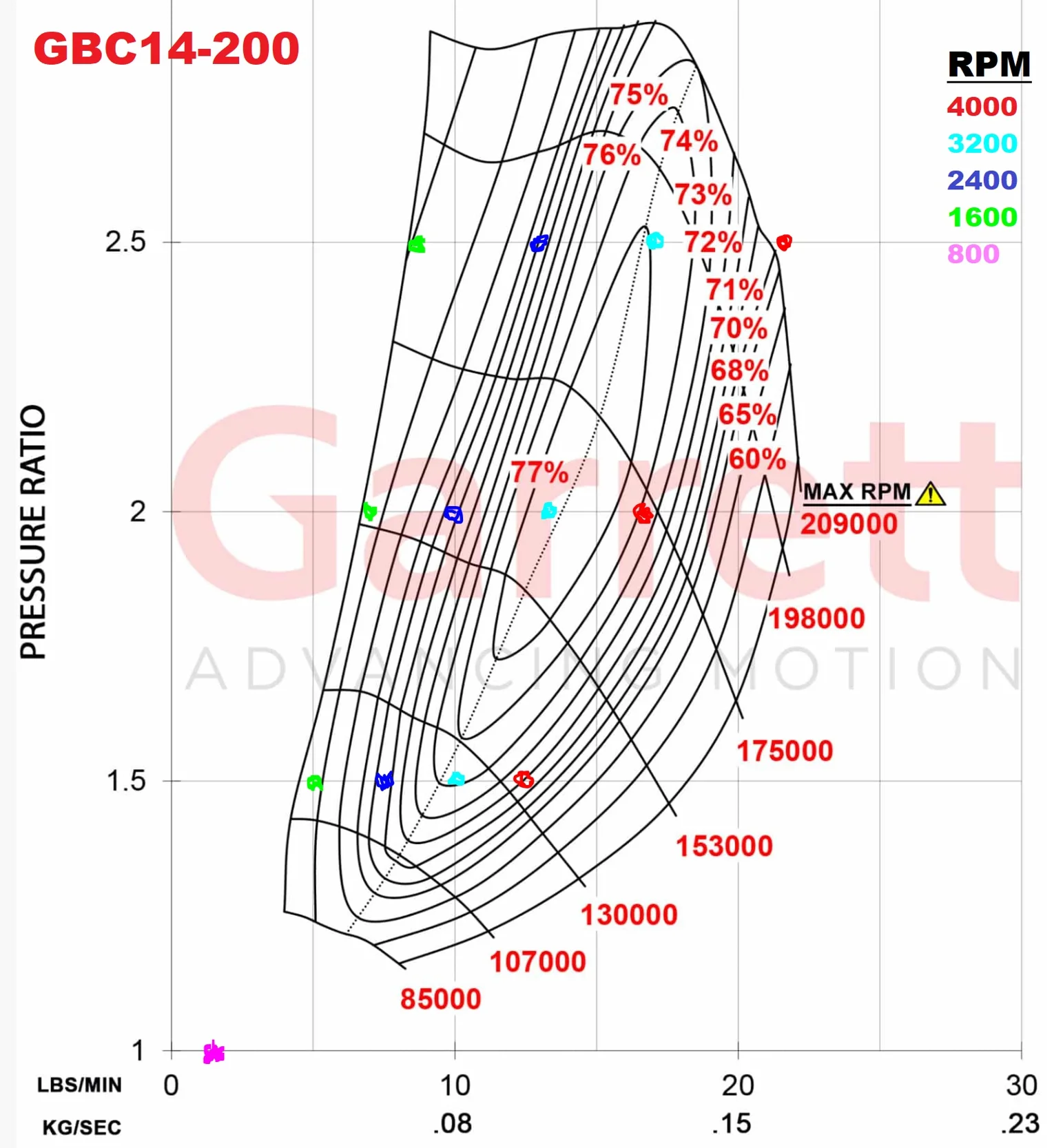

For comparison,
Here is the GBC14-200 for a 5L:
Here is the GBC20-300 for a 5L:
Here is the GBC22-350 for a 5L:
Here is the GT2252 for a 5L:
Here is the G25-550 for a 5L:
There sure is a lot of turbos out there...which one looks best?
