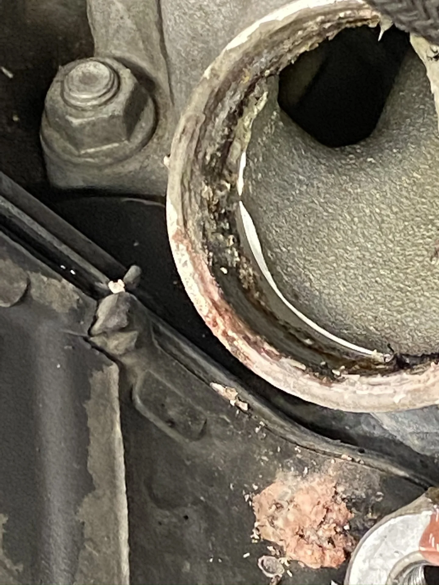

I used a red sealant there, looked like I had pink coolant leaking, always thought another color would have been better
If that's the orange/reddish Toyota FIPG, it's transfer case sealant. Used on transfer case and transmission.
Mine was siliconed at the O-Ring and the mating surfaces of the Water Pump too. Almost impossible to remove either item. And it was done at a dealership!
I recall when you busted that one. :frown:
I too have seen where dealerships glued in O-ring. Very bad practice, which "almost always" traps coolant, causes pitting and leaks.
Shops also often use FIPG 102/103 oil in place of 1282B. Another very bad practice. Why would they; Well, either they don't read the FSM, which clearly states 1282B sealant, or just don't want to spend the extra for the very pricy FIPG 1282B
I've also seen (from east coast Dealership (in rust belt)), where they've greased the O-ring for assemble. That seem to work well. Me, I just use FSM method which is dish soap (Dove) & water. I keep a spray bottle with dish soap & water in the shop, works well!

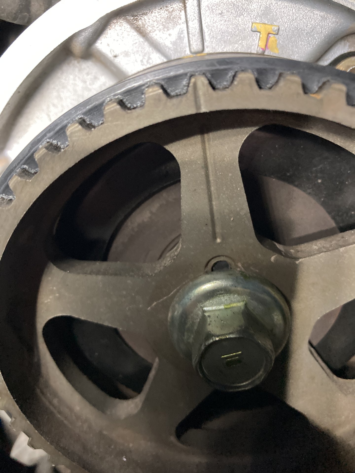

From the FSM page it looks like after the t-belt tensioner is installed (and pin pulled), they crank the engine over 2 revolutions with just the crank bolt in place, not the crank pulley. I like this idea, but I am afraid of turning the engine counter-clockwise when I loosen the bolt? I would hit the wrench very quickly/sharply to minimize turning risk.

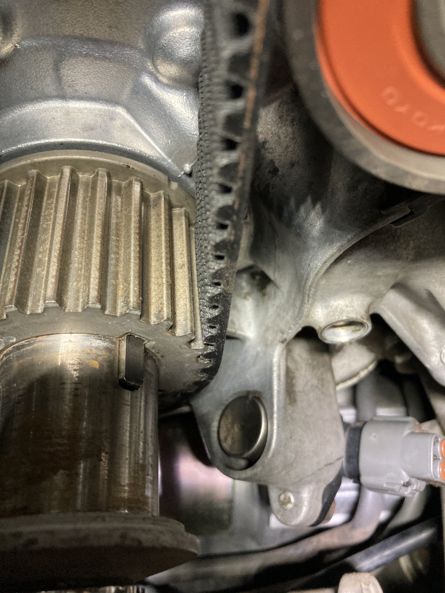

Understood that the marks on the belt will not line up again for many revolutions, but look at the marks on the crank and cam sprockets.

Rubber mallet is only tool I use to remove water inlet housing. Sometimes these, especially when improperly installed, really takes a lot of hammer blows to free them. Anything other than rubber, will damage the water inlet for sure!

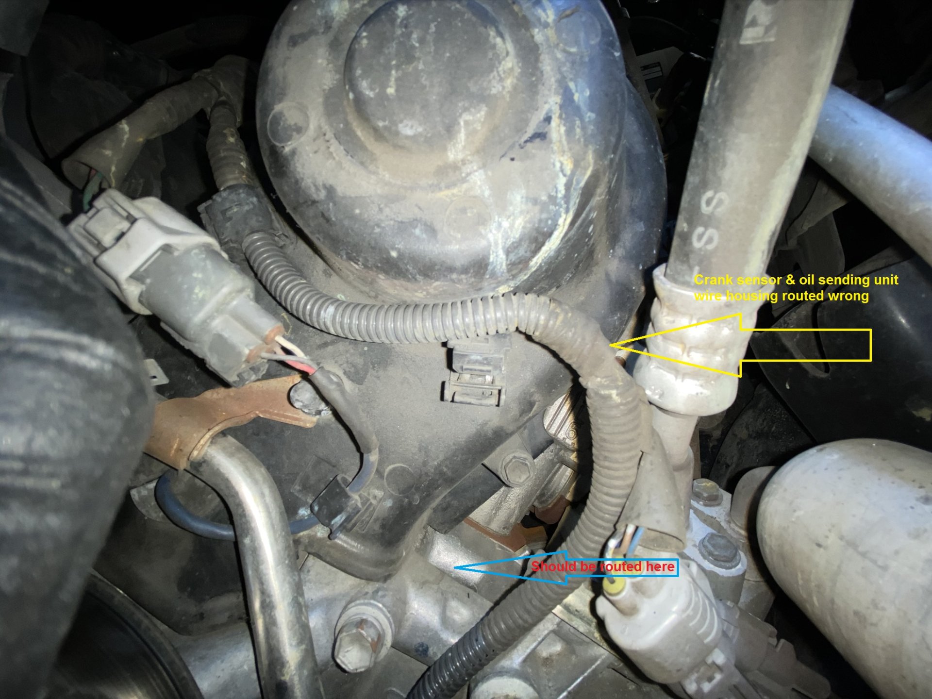

I'll just reiterate one thing: That's where the crank & oil sending wire housing is routed. It tucks in before/behind fan bracket.
You can see the wire here to the right, routing down and attached to crank sensor. The bolt loosely fit there right of wire housing, is one of the fan brackets lower bolts.
Wrong routing seen here, where wire housing routed in front of fan bracket. Which then may rubbing on drive belt, cutting through to wire(s)

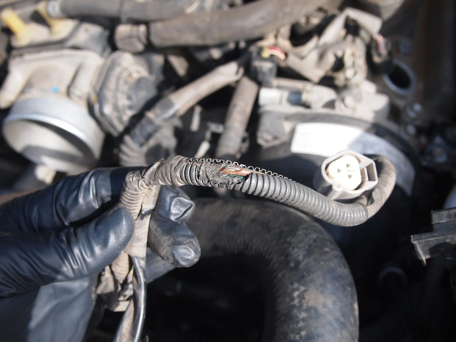

This one which was improperly (in front of fan bracket just tucked in) routed, wires did rub on drive belt. This can result in a no start condition (crank wire cut) or faulty oil press reading on dash.

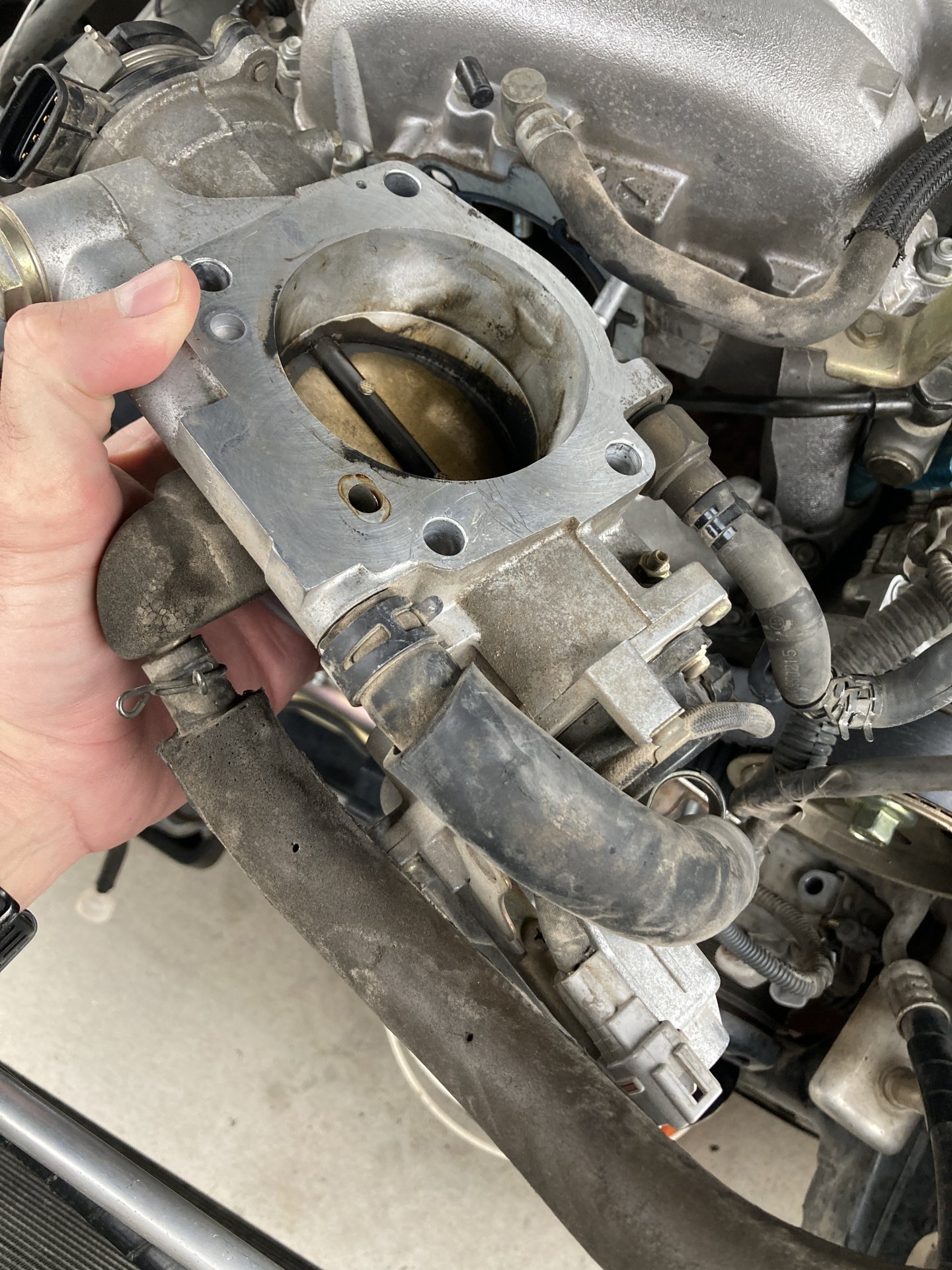

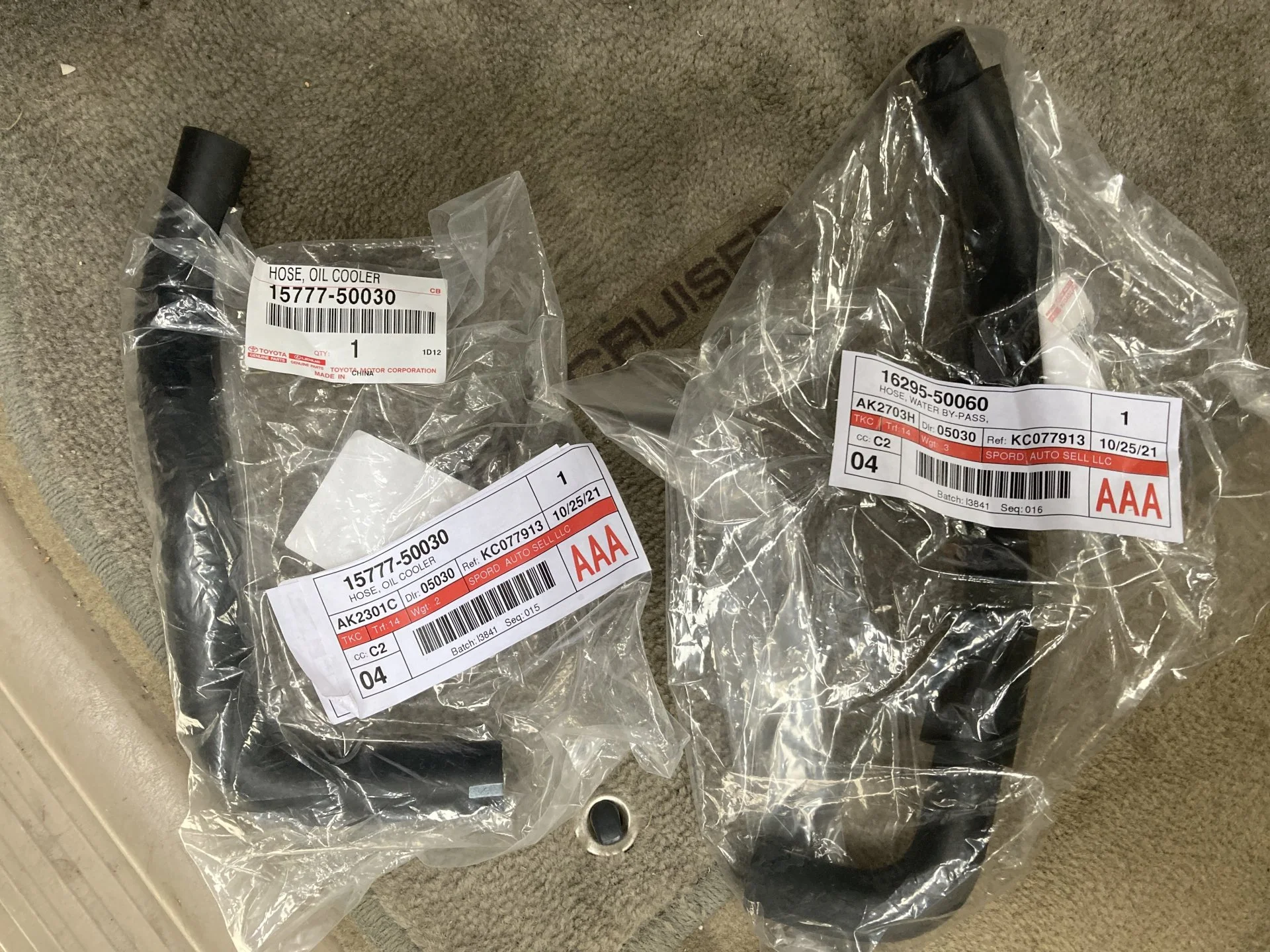

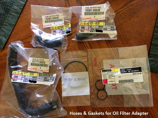

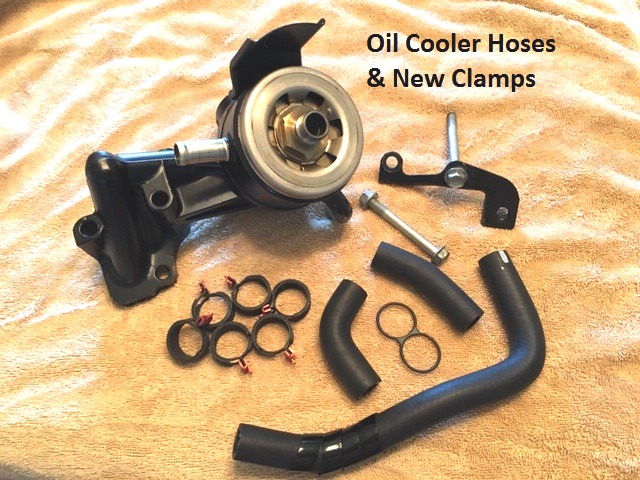

I went to pick up hoses at the dealer today. The 2 short little hoses for the oil cooler look correct.
Then there is the top hose for the oil cooler...
PartSouq called for 15777-50030 - Hose, Oil Cooler, so that is what we ordered.

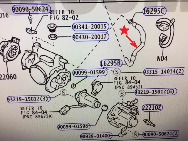

In trying to get the hose that goes from the throttle body to the front coolant bypass hose, we ended up ordering 16295-50060 - Hose, Water By-Pass, No. 7. This is not the hose that goes to front coolant bypass pipe, but it does look like it might be the hose that goes from the throttle body to the oil cooler pipe.
Help!
I can return the unused hose if it is still in the bag.
Any guidance on how to confirm? The Throttle body does not have another port for an additional coolant hose. It only has ports for oil cooler, coolant by-pass, and PCV.
I will peel the old one off the TB and inspect as well.
Trick to removing water inlet, is a rubber mallet. I've had some glued in and mallet has works every time (knock on wood);)

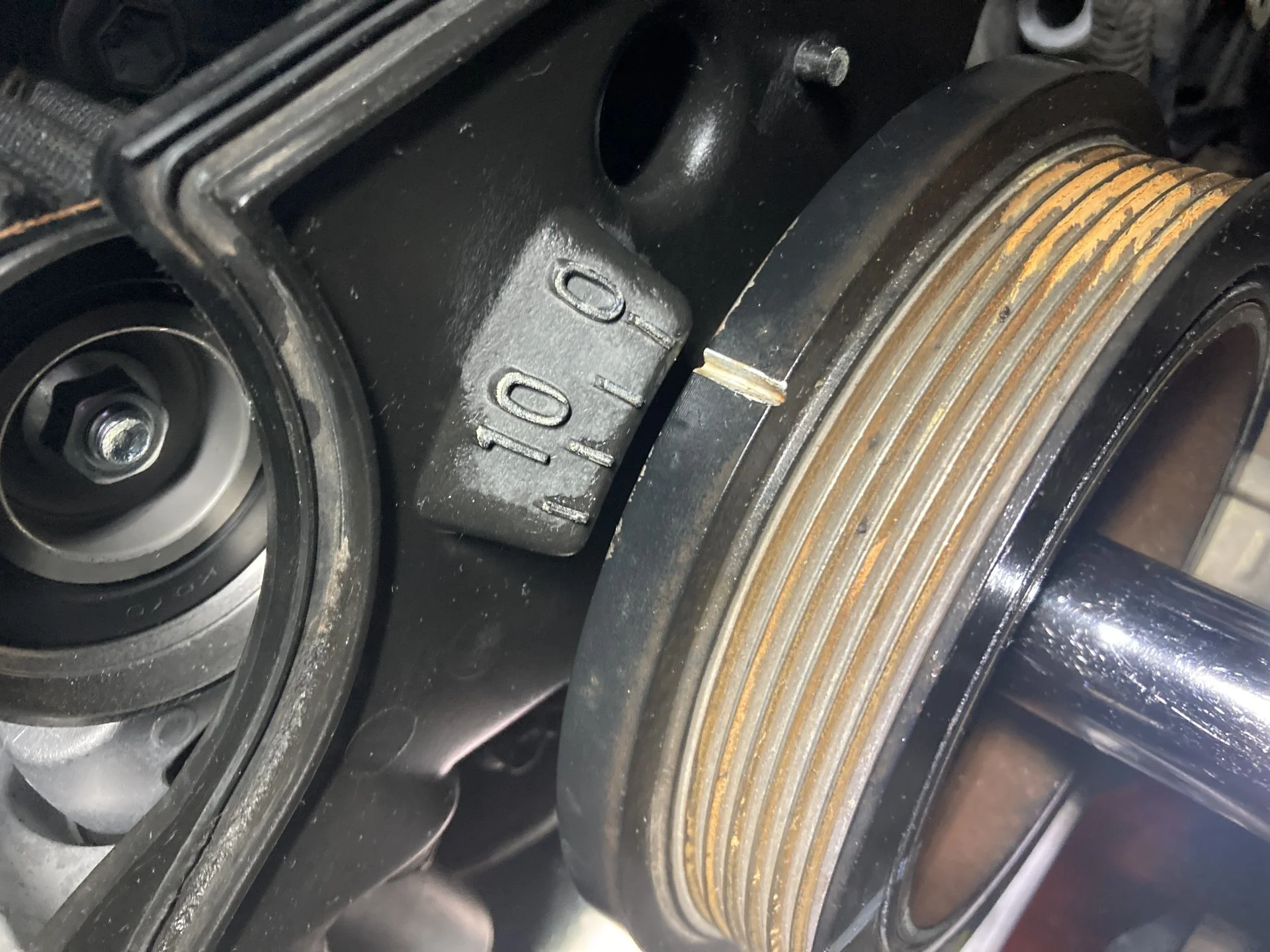

I install timing belt tensioner, after T-belt and both it's pulleys installed and torqued in. I then rotor crank 720 degrees and check that timing marks (hard marks) are dead on. Which tensioner needs to be in for test. (Note: belt marks will not line up again, once crank turned). I use hard marks of crank sprocket and on oil pump housing.

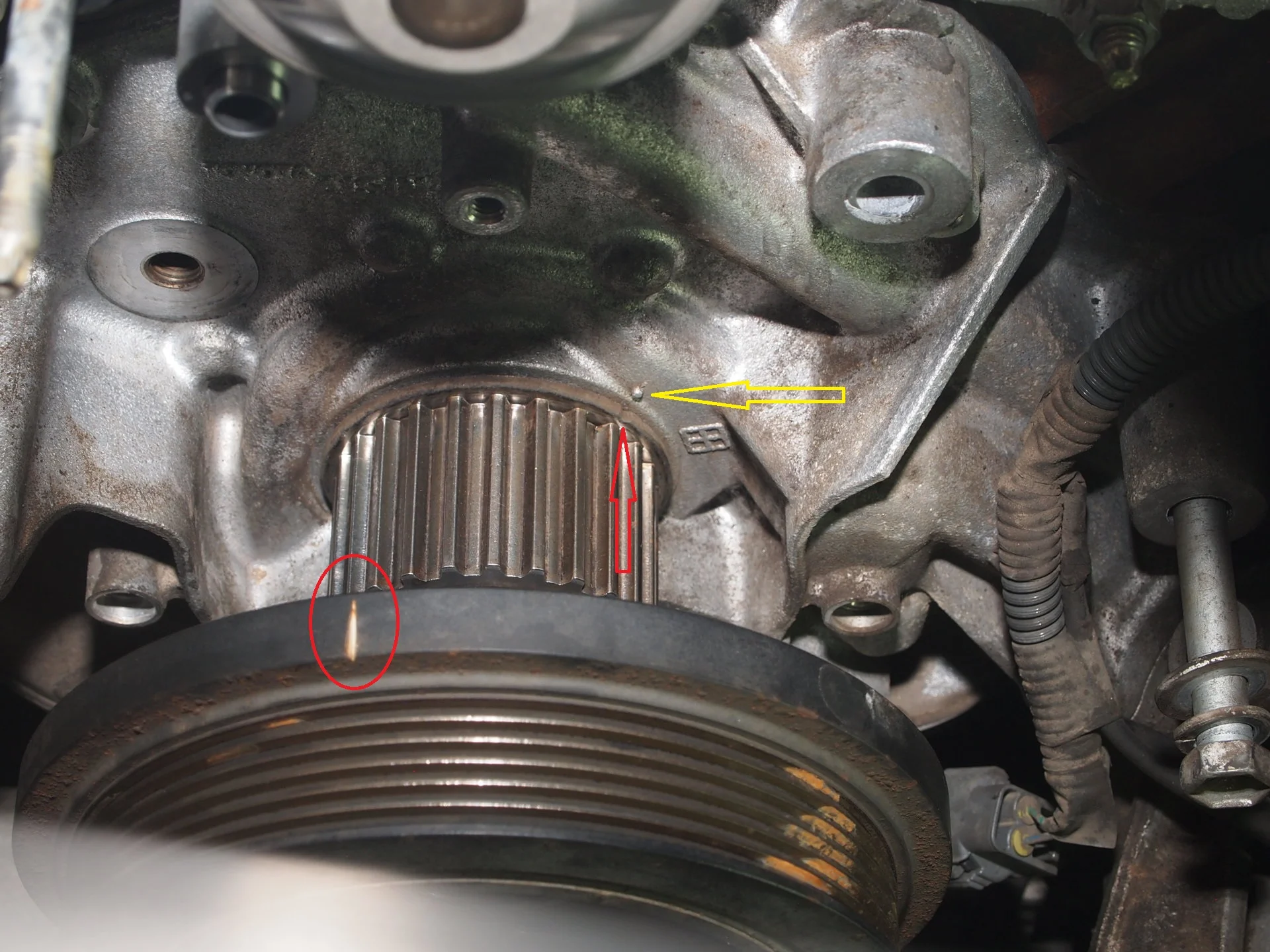

Note also; cam timing marks are the straight lines, not the "T".
Crank hard marks, posting here again.
BTW: I set crank and cams marks dead on, before installing T- belt. Not the ~50 degrees. But either way works just fine.

Oil Cooler hoses should look like these:

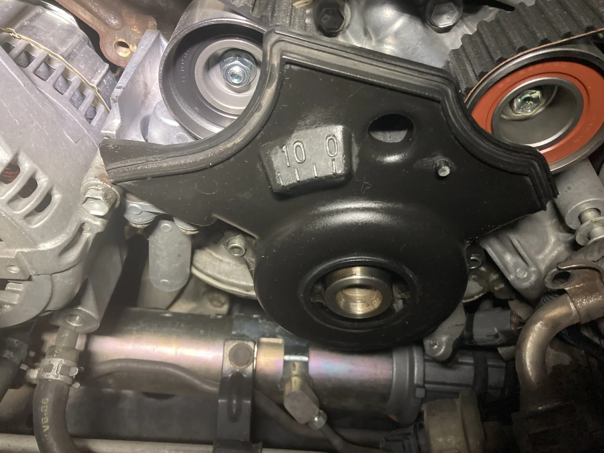

Another question - I did some more work last night - put the reluctor ring, front cover, crank pulley and crank bolt on.
I thought I would turn the engine over a few more times. So I went to put it in N with the shifter interlock bypass (battery is out), and as I was moving the shifter into N, it occurred to me that I don't think I put it in N the night before when I installed the tensioner and turned it over.
Is this possible? If I put the truck in N, and then removed the battery, will the transmission go into P?
Or did I damage the transmission by turning it over while the tranny was in P?

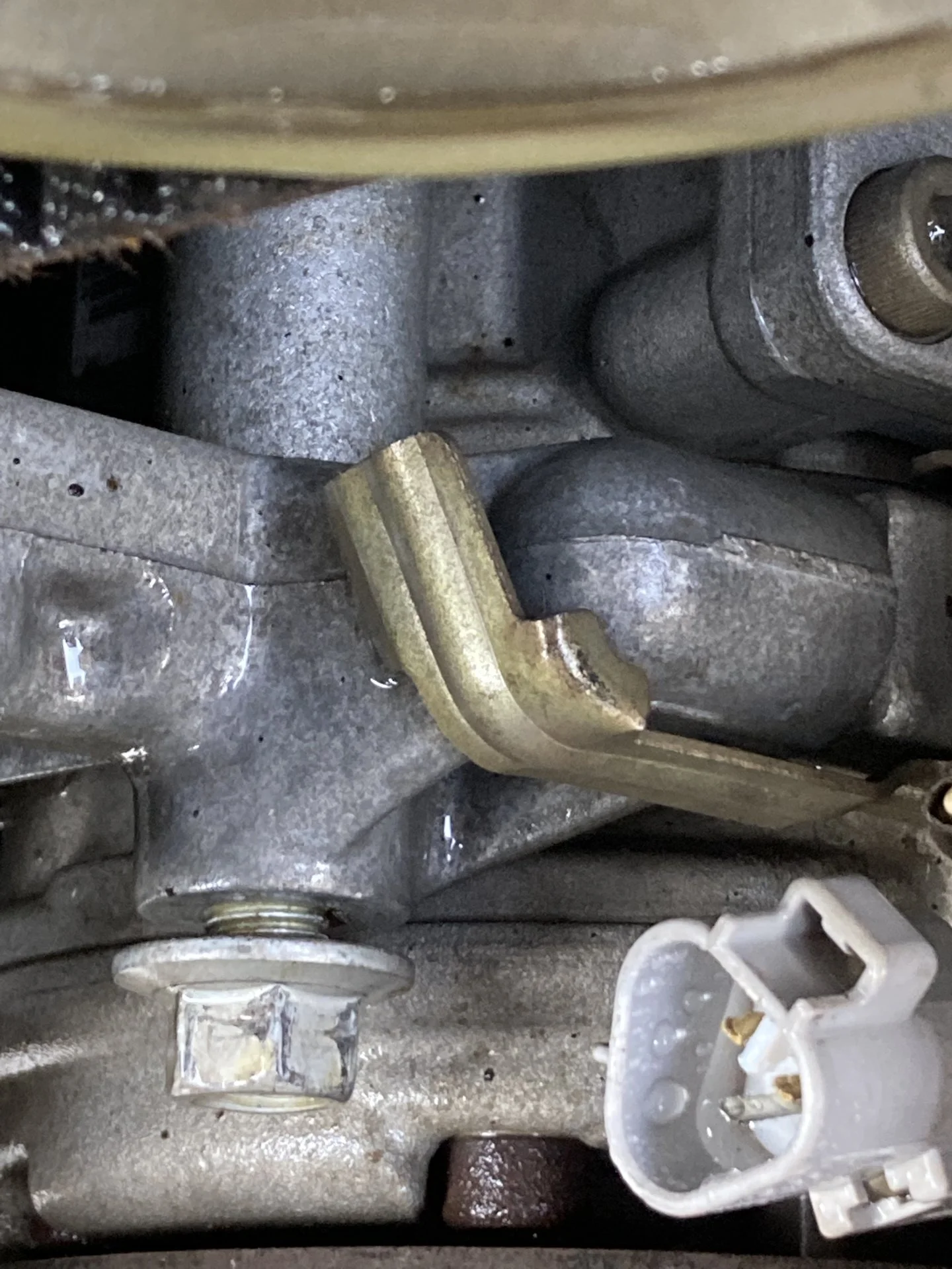

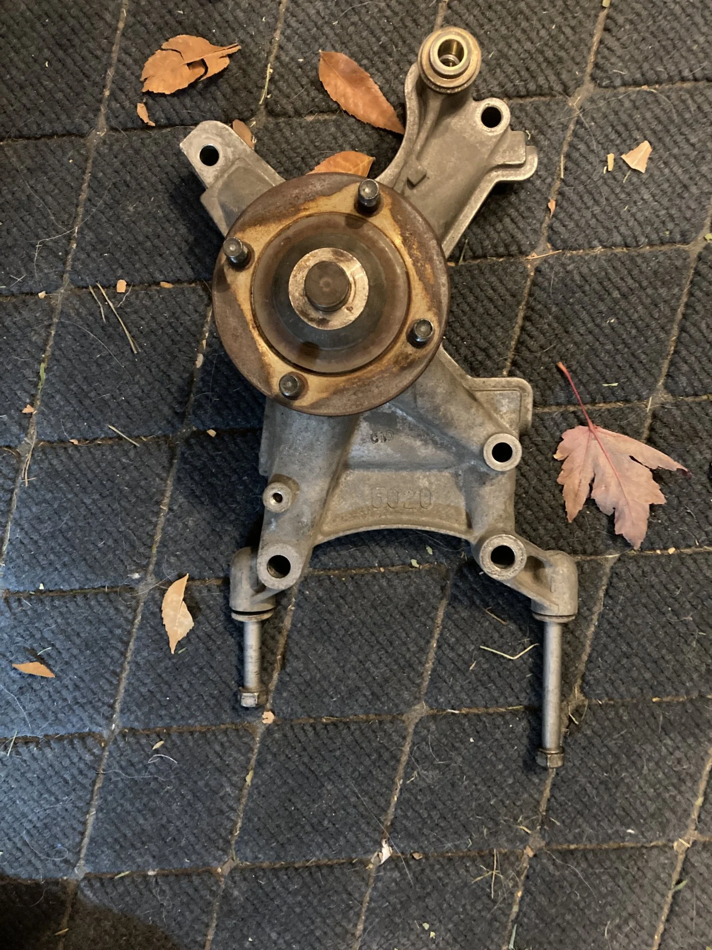

I took some pictures of the bracket you have to bend to move to get the fan bracket off - mentioned earlier in this thread by @scottm who credits @spressomon :
Here is the bracket in its normal shape:
Here it is after I bent it just enough to get the fan bracket off:
One more picture for the morning...
Here is the fan bracket with the 2 bolts that come in from the driver side. These must be removed in order to remove the fan bracket. These bolts are 2 of the 3 mounting bolts for the AC compressor.
It felt like it was going to be difficult to remove these bolts, so I just left them in place in the AC compressor body. After I removed the fan bracket, they both fell out.
The longer bolt goes up top, the shorter bolt underneath the AC compressor.

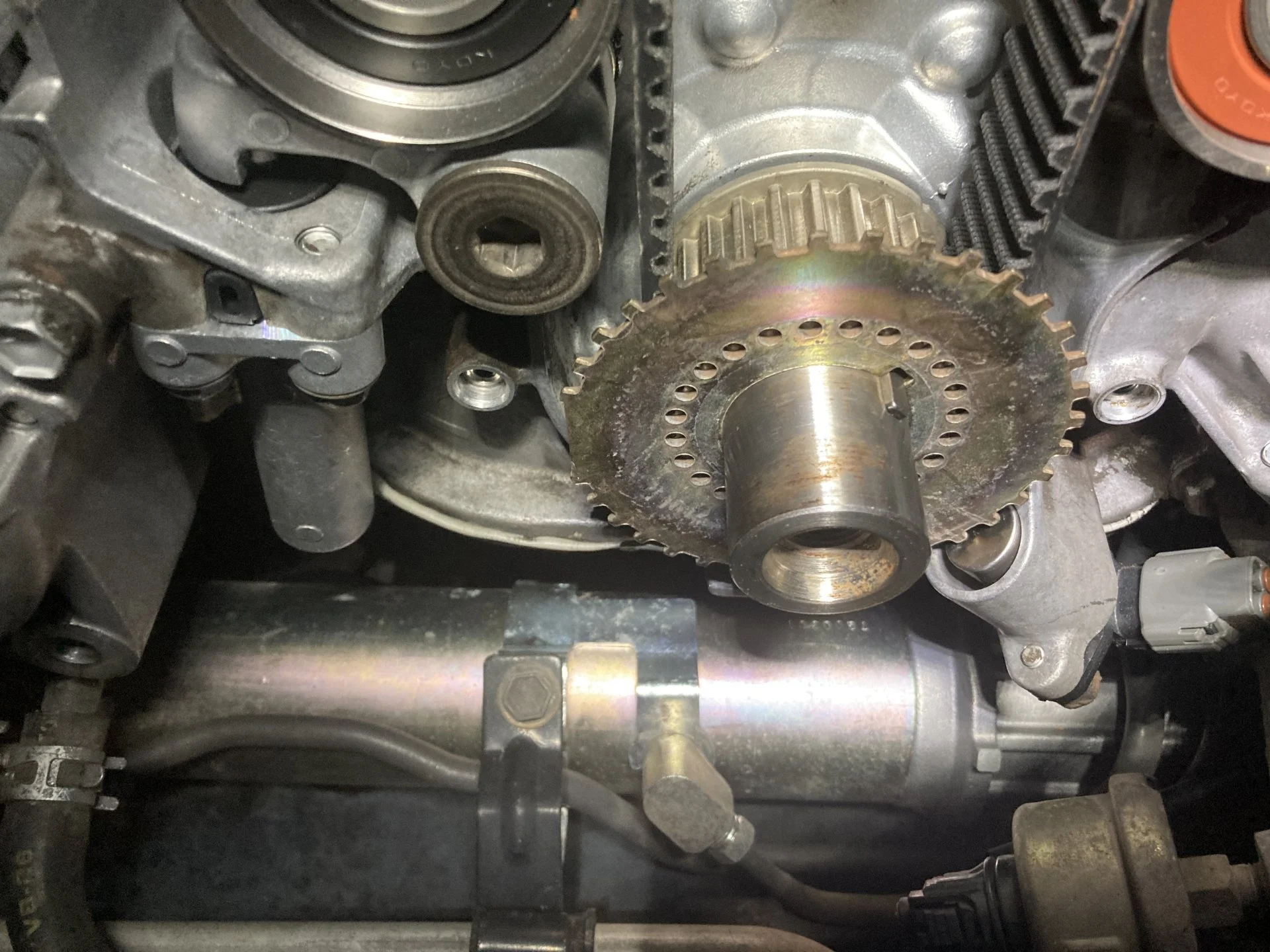

Speaking of things falling off/out, there is a spacer washer that sits behind the timing belt tensioner pulley.
When I removed the t-belt tensioner pulley, this washer/spacer stayed behind for a moment, and then fell off. I heard it hit the driveway, so I looked under the truck and it was rolling away! I went to the back of the truck just in time as it rolled out from underneath.
Had I not heard this fall off, it would have rolled down the driveway and out into the street!
Do not lose this:

You're good. Park and Neutral are essentially the same thing except 'park' uses the parking pawl and won't let the vehicle move.
That would be the water bypass hose at the throttle body.
?Where? My throttle body only has provisions for PCV hose, oil cooler, and the smaller hose that goes to the bypass pipe.
16295-50060 is much larger than that hose that goes to the bypass pipe:
