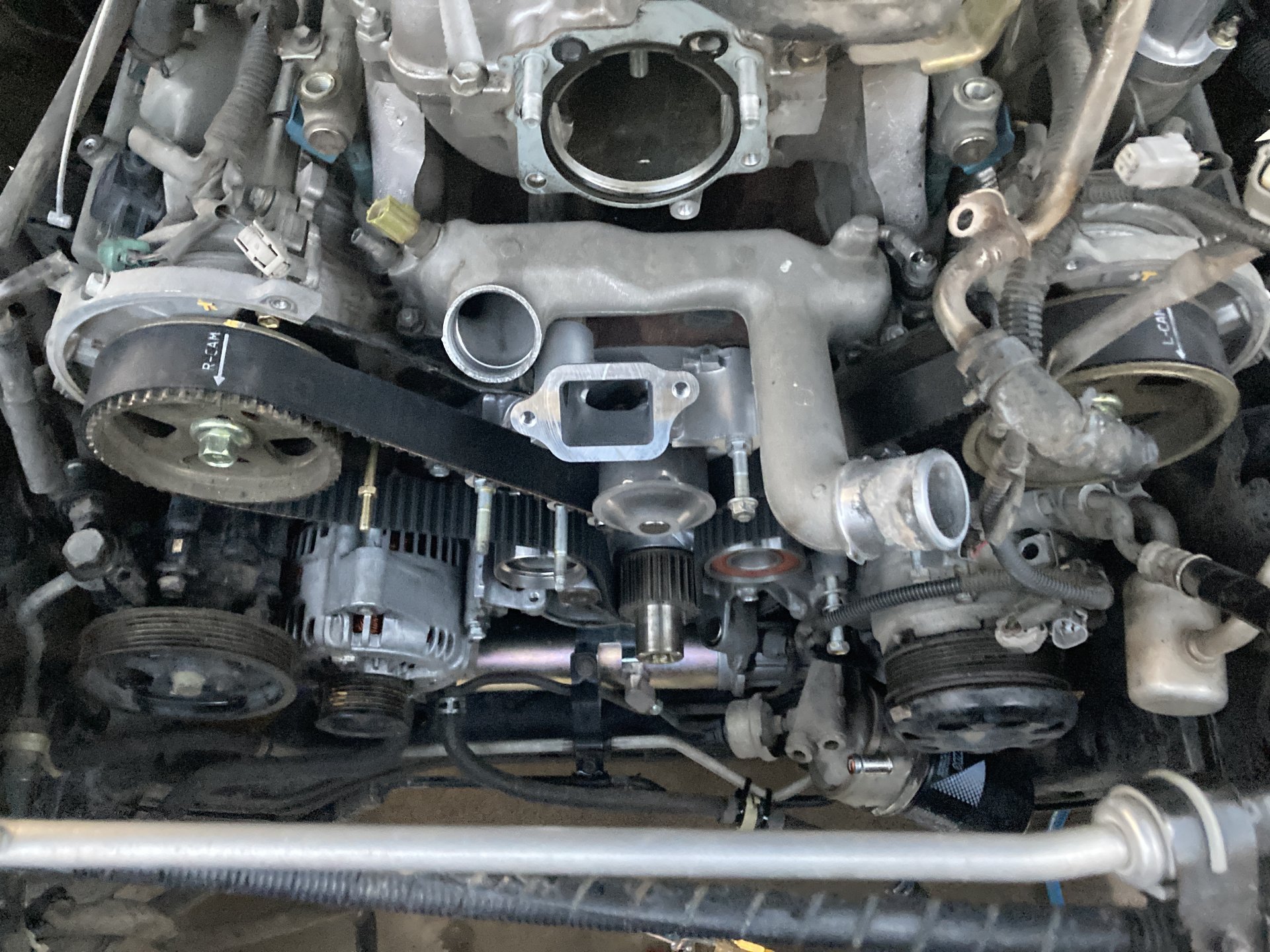

You can see where someone previously buggered up the factory hose clamp, left it in place and used a worm gear clamp. The replacement hose is coming tomorrow.
Unfortunately, I had to destroy the small hose that goes from the bypass pipe up to the throttle body, so I get to see if the dealer has this in stock as well.
I am thinking I should just replace the 3rd oil cooler hose (the longest one that connects direct to the throttle body) while I am waiting for parts. The throttle body gasket looks old as well, so replace that!
This part was really frustrating - to get the front coolant bypass pipe out I had to pull the front fuel pipe that shares fuel with the passenger side fuel rail.
I finally separated the thermostat housing from the bypass pipe, but I did not have enough time to clean off the old FIPG and lay in a new bead.
I thought it would be good to get the new water pump in and timing belt on, but I was hesitant to rush things out of concern that I would miss something if I got in a hurry.
Will I cause myself any problems if I finish the timing belt process - install lower belt cover, guide washer/reluctor, crank pulley and tensioner before I replace the thermostat housing?

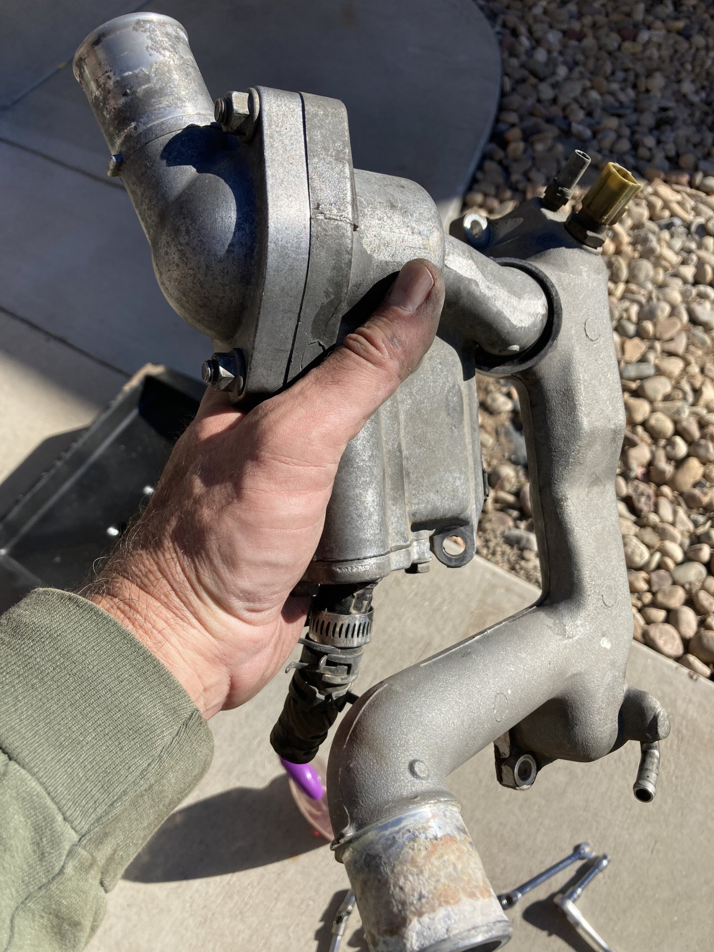

This slowed me down quite a bit - I could not separate the thermostat housing from the front coolant bypass pipe:
Yeah, mine actually broke off and I had to replace it. It had been 'siliconed' in place (water pump also) when the previous belt had been replaced (by a dealership no less).
Trick to removing water inlet, is a rubber mallet. I've had some glued in and mallet has works every time (knock on wood);)

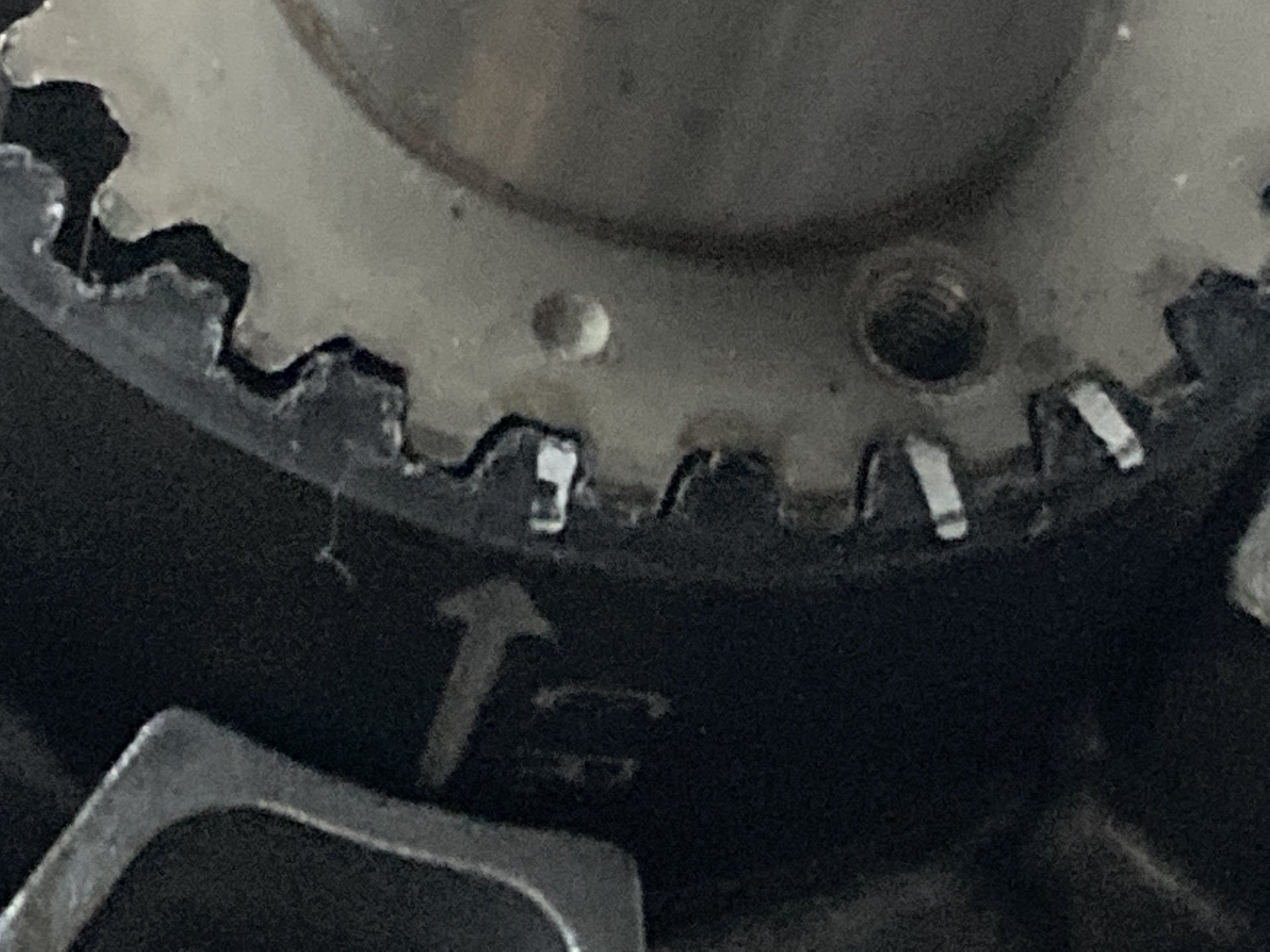

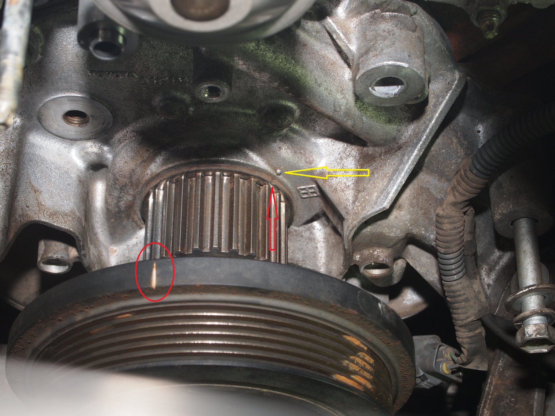

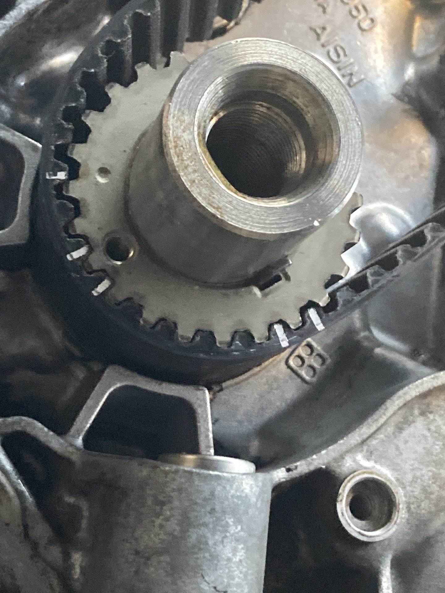

I install timing belt tensioner, after T-belt and both it's pulleys installed and torqued in. I then rotor crank 720 degrees and check that timing marks (hard marks) are dead on. Which tensioner needs to be in for test. (Note: belt marks will not line up again, once crank turned). I use hard marks of crank sprocket and on oil pump housing.
Note also; cam timing marks are the straight lines, not the "T".
Crank hard marks, posting here again.
BTW: I set crank and cams marks dead on, before installing T- belt. Not the ~50 degrees. But either way works just fine.

I finally separated the thermostat housing from the bypass pipe, but I did not have enough time to clean off the old FIPG and pay in a new bead.
No FIPG goes there. O-ring only.
I took as he meant "water inlet housing" groove. Terminology gets confusing sometimes ;)
I took as he meant water inlet housing groove. Terminology gets confusing sometimes ;)
Mine was siliconed at the O-Ring and the mating surfaces of the Water Pump too. Almost impossible to remove either item. And it was done at a dealership!

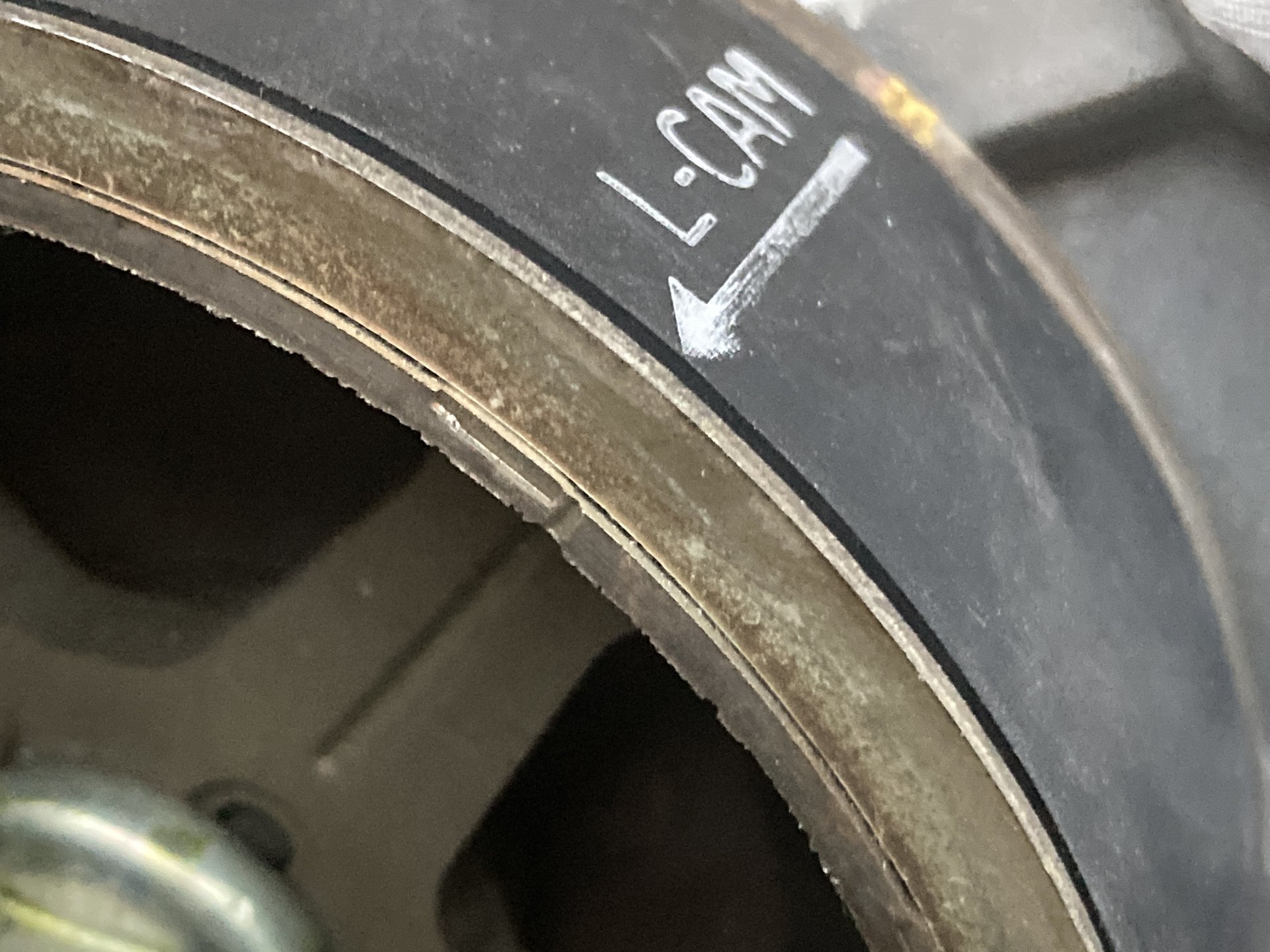

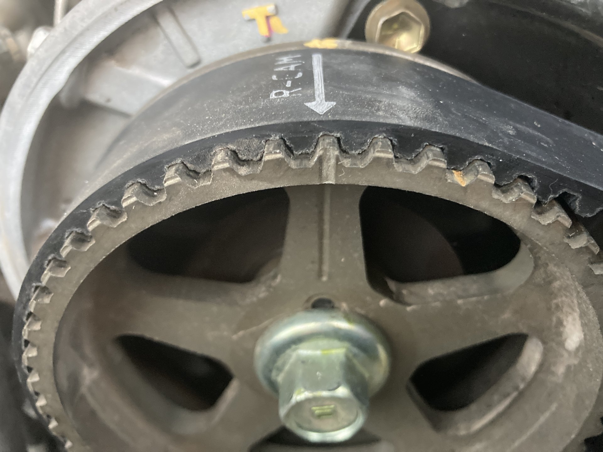

From the FSM page it looks like after the t-belt tensioner is installed (and pin pulled), they crank the engine over 2 revolutions with just the crank bolt in place, not the crank pulley. I like this idea, but I am afraid of turning the engine counter-clockwise when I loosen the bolt? I would hit the wrench very quickly/sharply to minimize turning risk.
Understood that the marks on the belt will not line up again for many revolutions, but look at the marks on the crank and cam sprockets.
Correct. Look for your witness marks to match up...indicating all is well (timing).
Yes, just bump the wrench/ratchet/breaker bar. I also 'lightly' clamped the belt to the passenger side cam pulley on mine with a padded pair of vice grips. I wanted to be sure nothing would move and it didn't.
Correct.
ALL of the marks will not line up for many, many, many.....revolutions. But the marks on the crank will.
