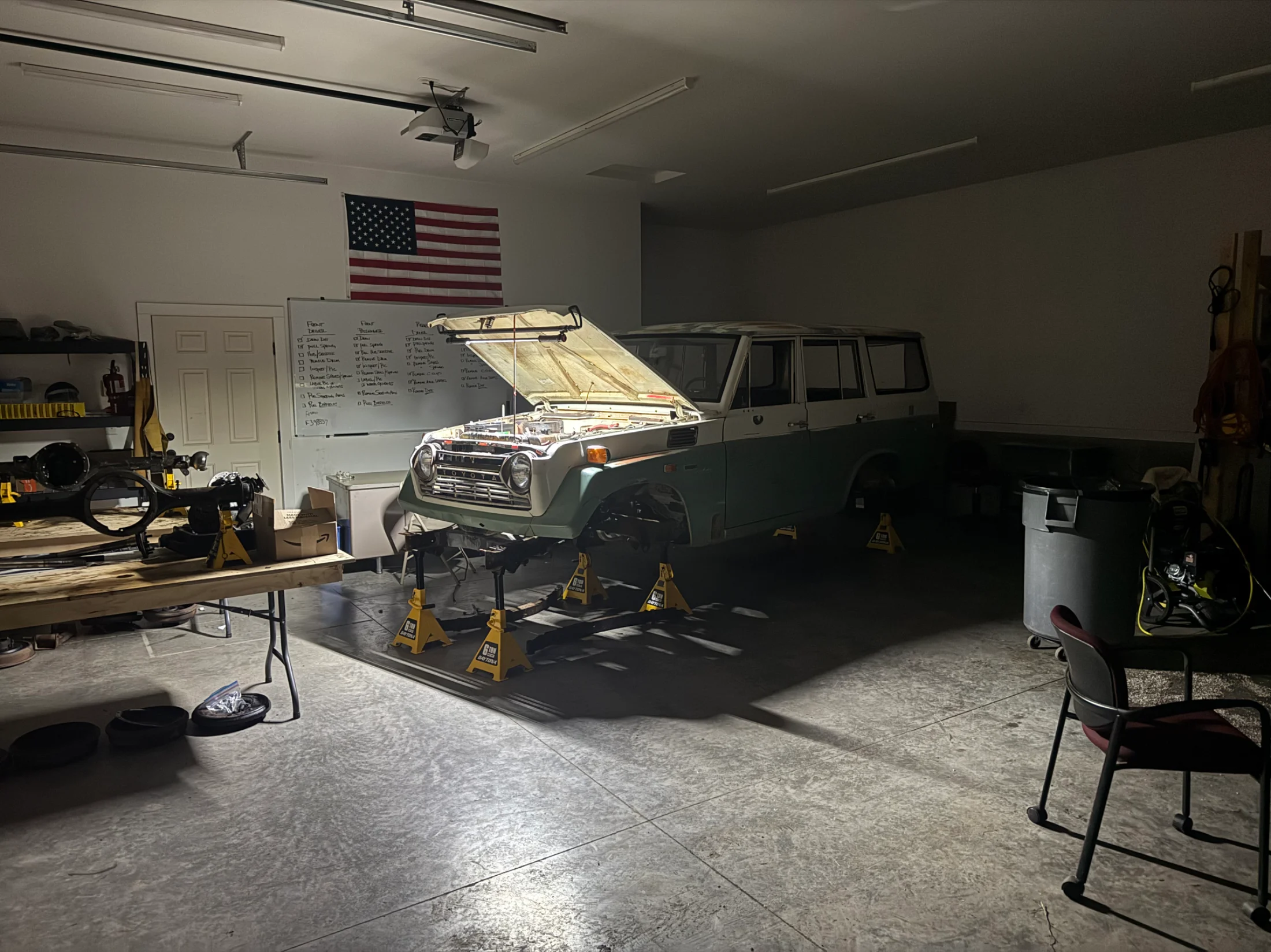

Leaving her alone for a while, gonna focus on the 40 for a few days that I have off next week. Might sneak in to buff some paint. Our new engine bay hood light rocks.
That's a great picture. I love seeing the flag on the wall above the Pig - perfect!

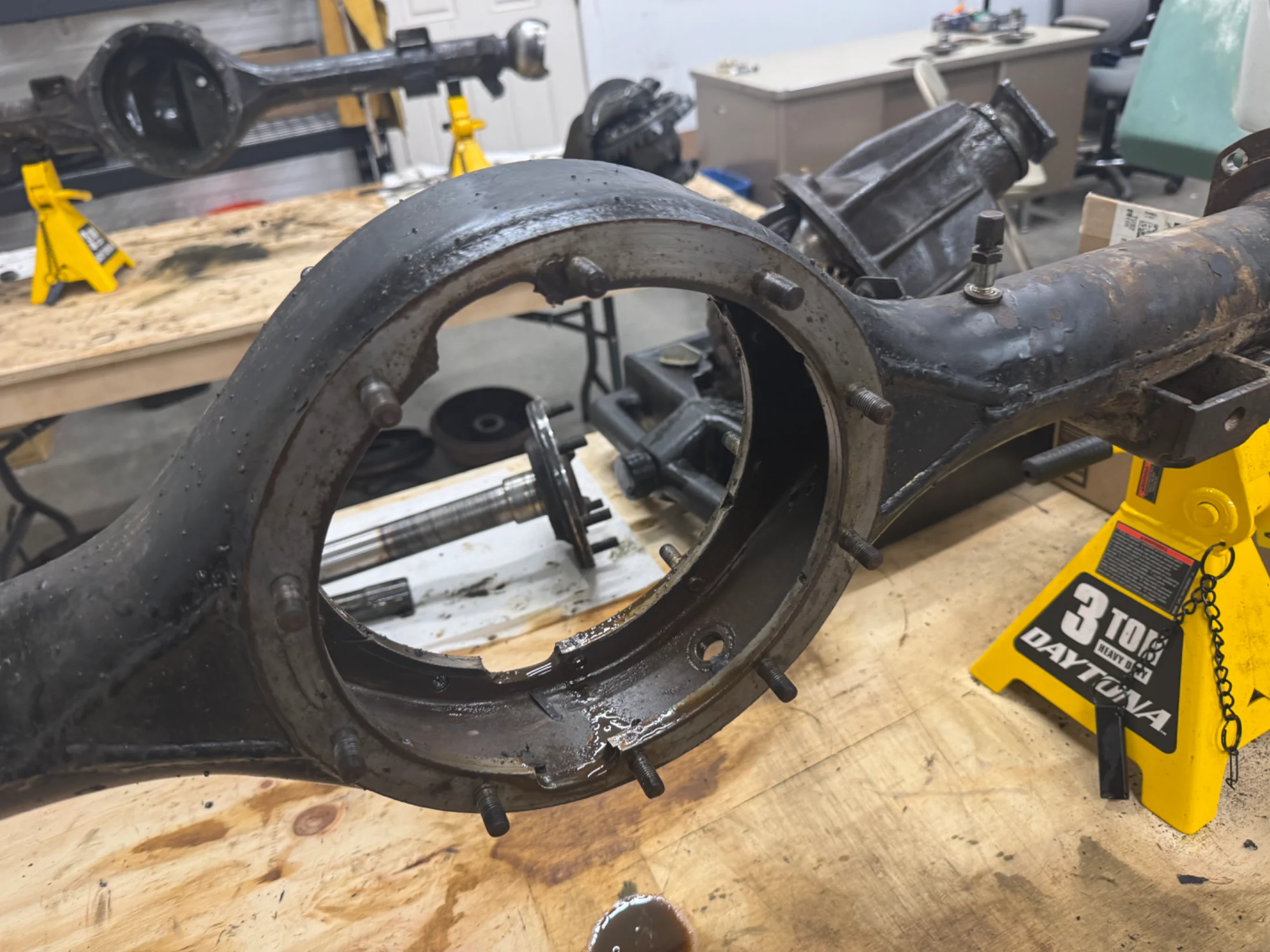

Diffs will need a little more handwork, they take some abuse with slinging 90wt oil. But for the most part they’re clean.

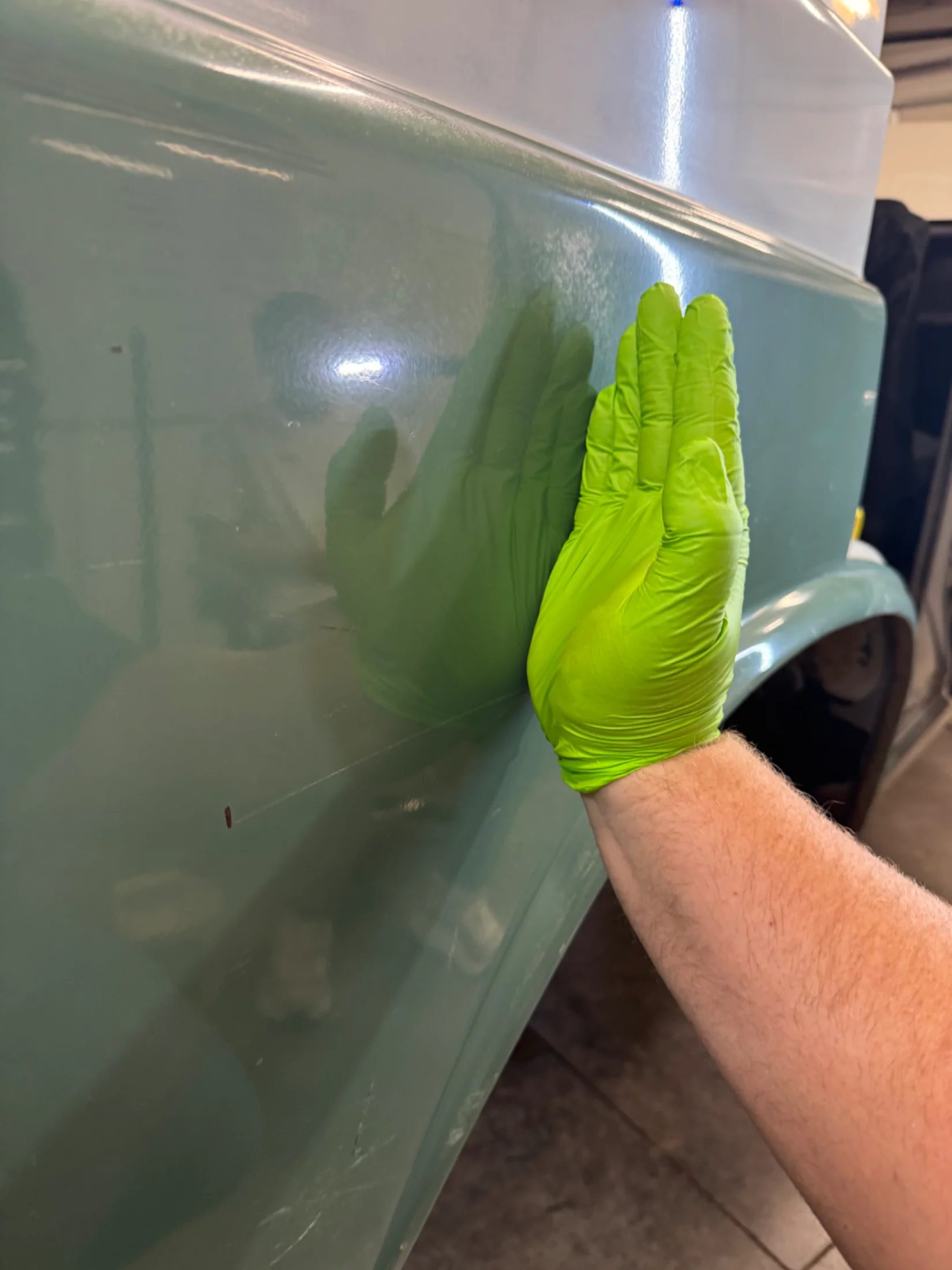

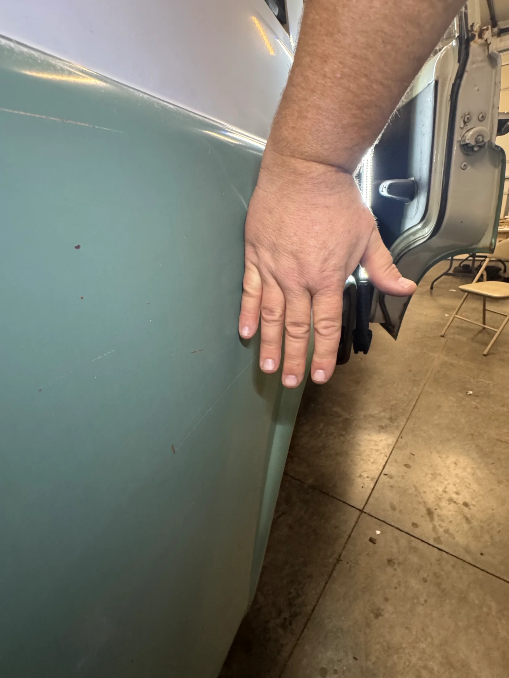

I used some Meguires Pro Speed Compound on a coarse cutting maroon foam pad from Meguires also. It’s a true compound and could use an actual polish and wax but I don’t think I’ll give any more time to the paint at this time. Maybe a sunny warm afternoon this summer in the shade.
The paint is super thin in spots and I was lifting a TON of color with each pass. I was excited to see the surface rusty spots didn’t lift in terms of color. I like the patina.
Hood before: cleaned but faded and dull.
Here’s a half and half shot after one pass.
After a full pass on both sides.
Rear passenger quarter before pic:
After a full pass:

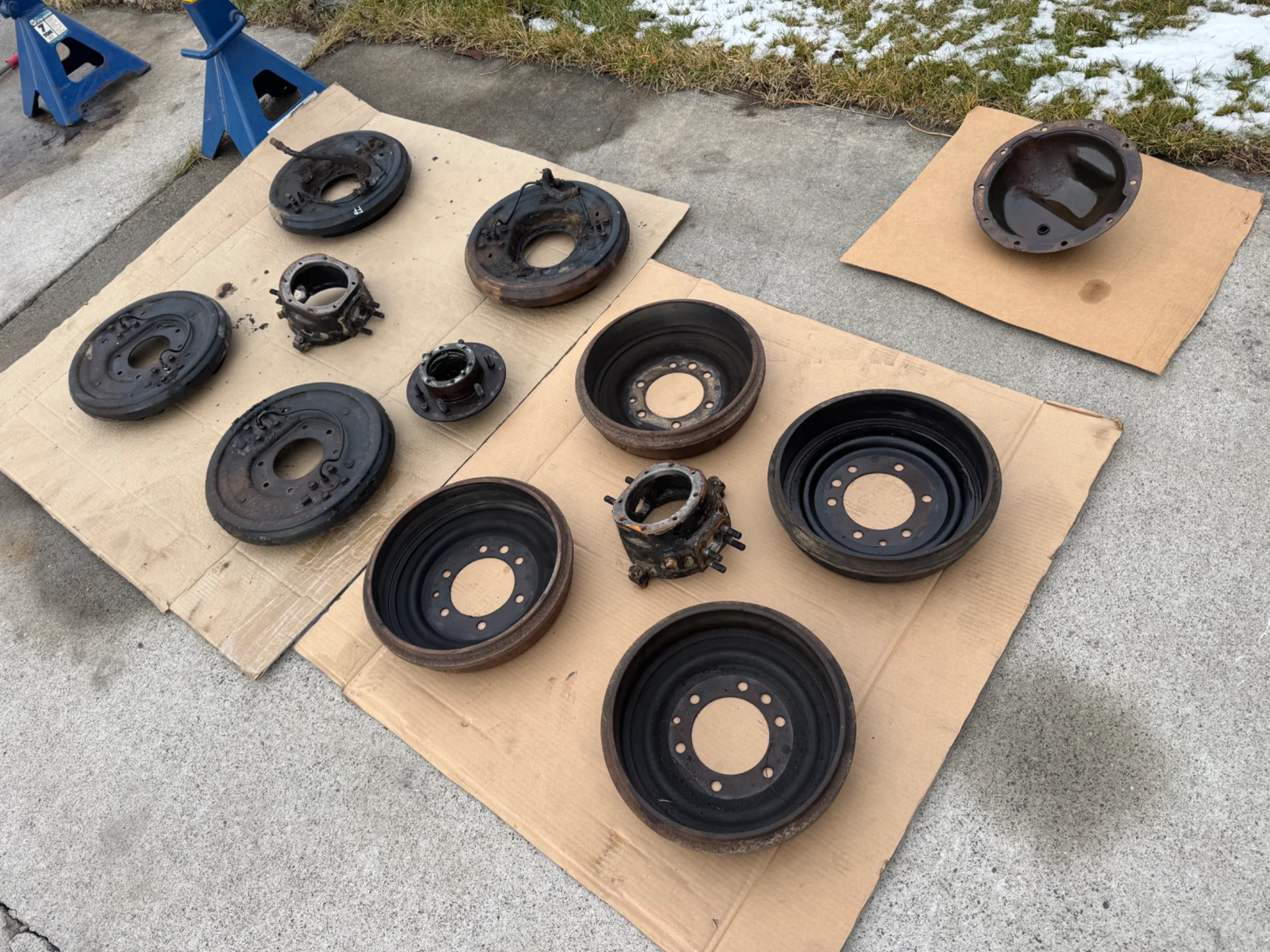

Laid everything out on the driveway, gotta keep some order on the brake parts so I know where everything g goes when I’m done. Then I fired up the Hotsie.
The cardboard seems to soak up some grease.
Sprayed with degreaser… that’s sure to kill grass too. ;)
Pumkins cleaned up nice! But here they’re a greasy mess
Fire away. Steam clean, spray, wipe off my face shield… repeat.

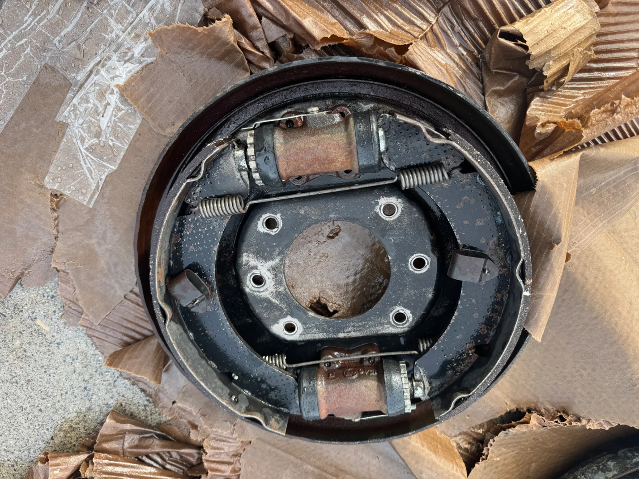

The brakes seem to be in better shape than I thought. I’ll have the drums turned and buy rebuild the wheels cylinders as a project.
Brakes look a good bit better z any tricks for keeping which cylinder goes where for disassembly?
After a wash down eveything gets a once over with compressed air and left to air dry. I’ll show a few more detailed pics when they get moved back to the shop.
