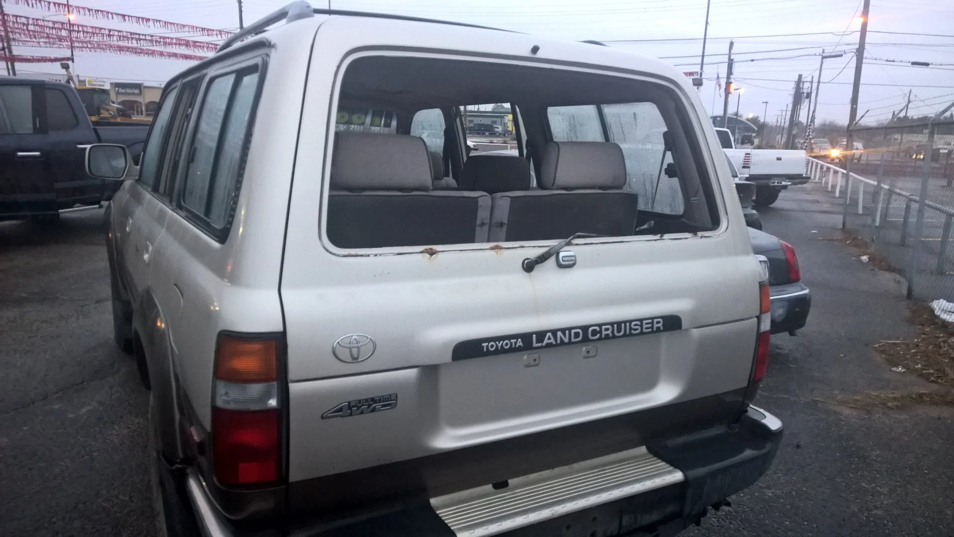

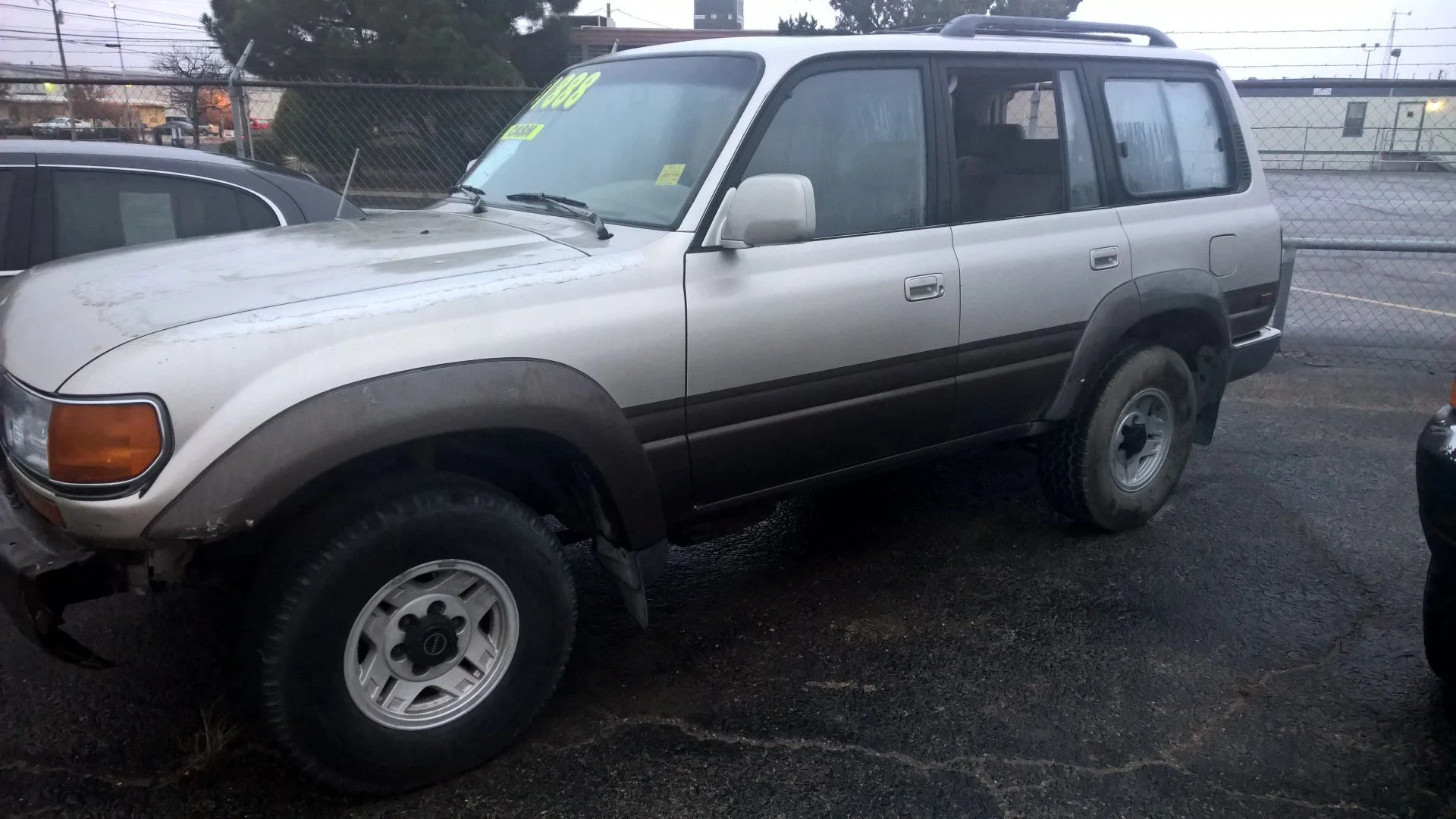

saw this in town today. Needs radiator, starter and u joint. Interior is in good shape. Rear hatch glass is busted and both rear door windows as well. Guy wants $1000. Seems like a deal to me. It's a 91 with 274000
I'd get it! If anything it's worth more than that in parts. Or repair the couple hundred dollars worth of items it needs and drive it.
The rust on the hatch would give me some concern and it needs a bumper as well. Depending on how long it has been open to weather, coupled with mechanical issues, I'd start at $500 and go up.
rust is surface only. This is a west Texas truck so rust isn't bad. But who knows what I will find if I get.
Looks just like mine, minus the rust and missing glass. I'd try to nego down a bit from the 1k, it will need some work. How is it mechanically? Is there a leak at the front axle? Does he have many service records for it? Use these as battering rams to get the price down.
Depends on what you're looking to do with it. If you're looking for a cheap truck to build and use long term, I'd say go for it. If you want to try to fix the outstanding issues then sell it, you'll never come close to making any money on it. The 91/92 models just don't go for as much as the 93-97s... If that thing was in very good running condition with proper maintenance I don't think it'd go for much more than $2,500... Mayyyyyyyyyybe $3,000, but that seems like a stretch...
I would imagine that fixing all 3 windows, radiator, starter, u-joints, and miscellaneous other maintenance will take at least $1,500 if you do the work yourself...
Motor oil, ATF, respective filters, diff fluid, transfer case, rebuilding the front (I'd wager this is a definite with the mileage), new vac lines, coolant, misc bulbs, plugs, wires, brake pads/shoes. Even the small sh!t adds up quickly. Try to get it as cheap as you can so that you can have a great toy without scaring your wallet.
