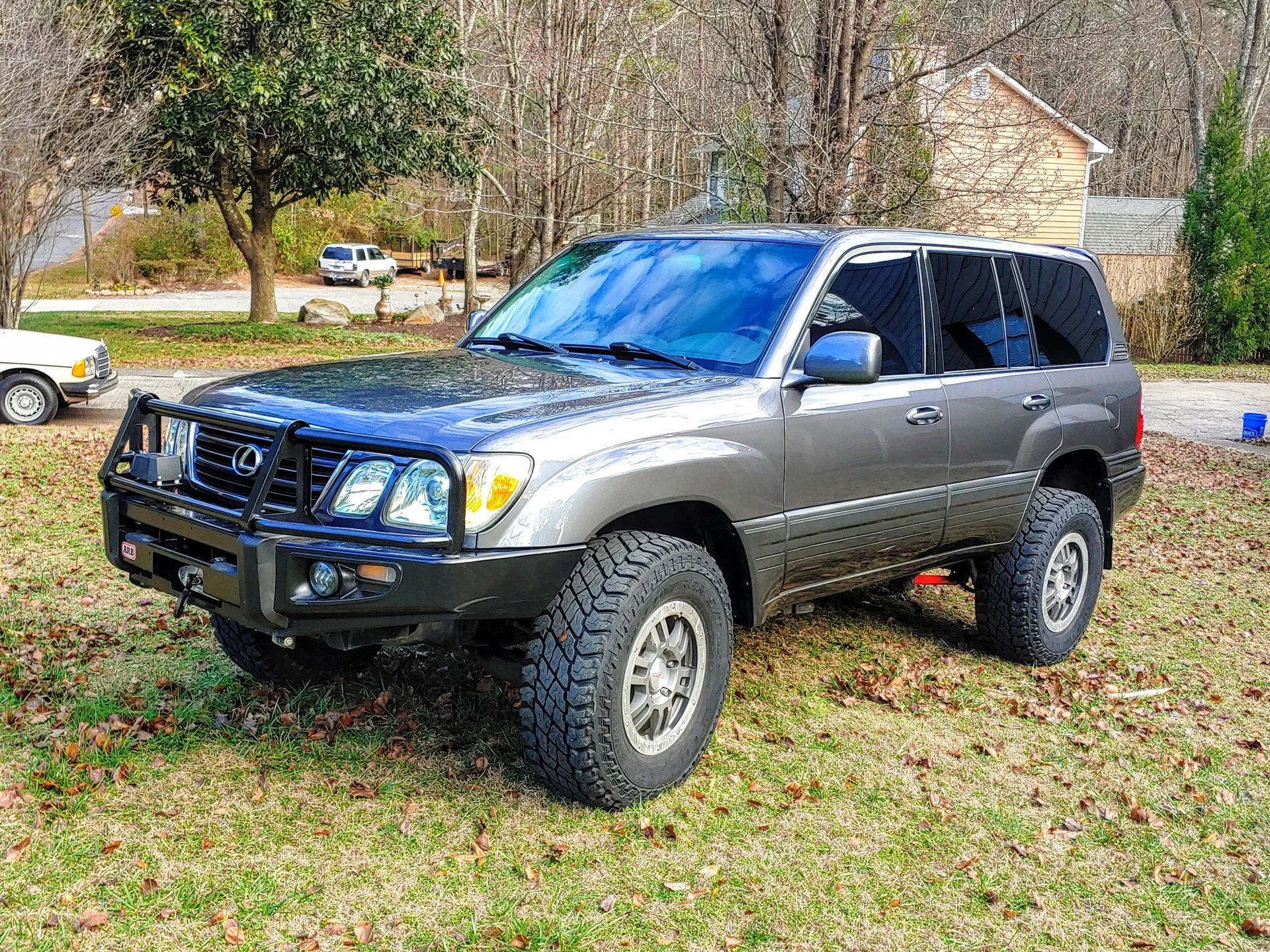

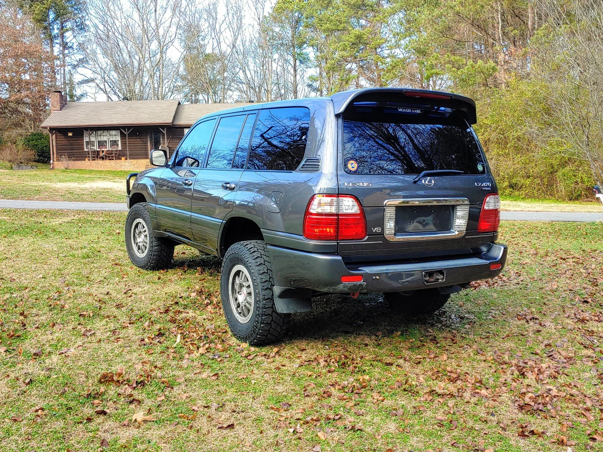

That's a great size. I had ST Maxxs in that size for a couple years. Not too much rubbing. I would go with a +25 personally, as I think it looks better and you don't have to worry about contact with the UCA. My wheels are 17x8.5 +27 so you can get an idea:
10mm delta is not much of a difference between the two offset specs. I guess it would be decided on your personal preference if you like your wheel/tire poking out the body more (+25 ET).
My Rock Warriors are +50mm, plus a 1.5-2" spacer (can't remember). Exact same tire size you're asking about. They stick out from the body about an inch, maybe a little more. No rubbing at all.
